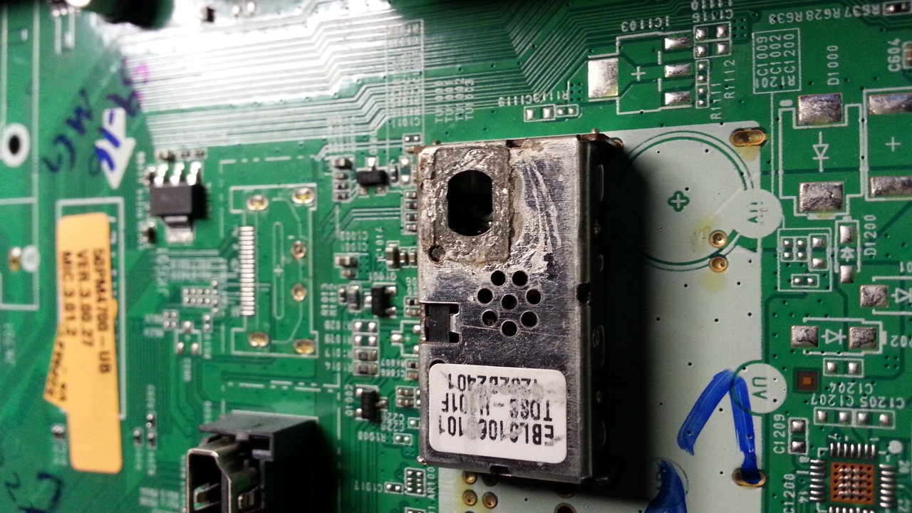

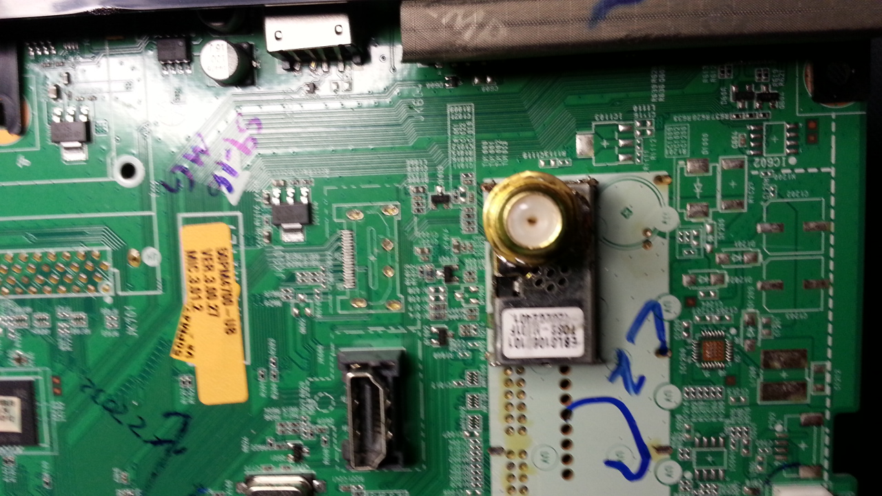

Now being the curious type I wanted to see what the pic was like so I went to plug a coax into the antenna port but couldn't find it. Seems the PO/joker/bozo managed to shear the connector right off the tuner module! I could replace the entire board (not!) or even the module but I think this one cries out for a "workaround". Will post pics when I get to it.
