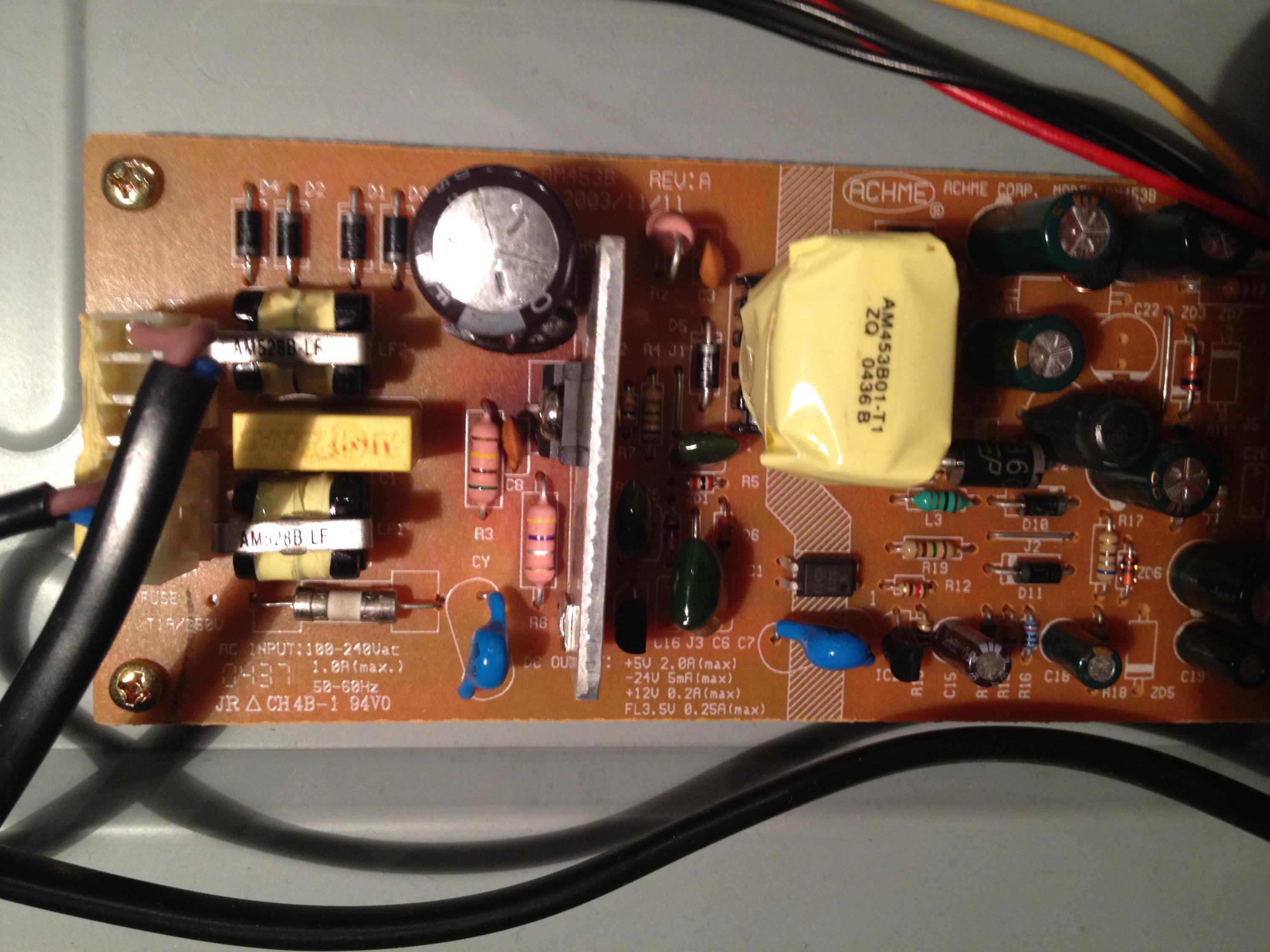

    An old DVD player went blank all of a sudden. The big 33uF/400V cap is swollen and the fuse is burnt. Would it help to replace those two or is there some other problems to be expected? Electronics recycle is also an option.

    check the 4 diodes
