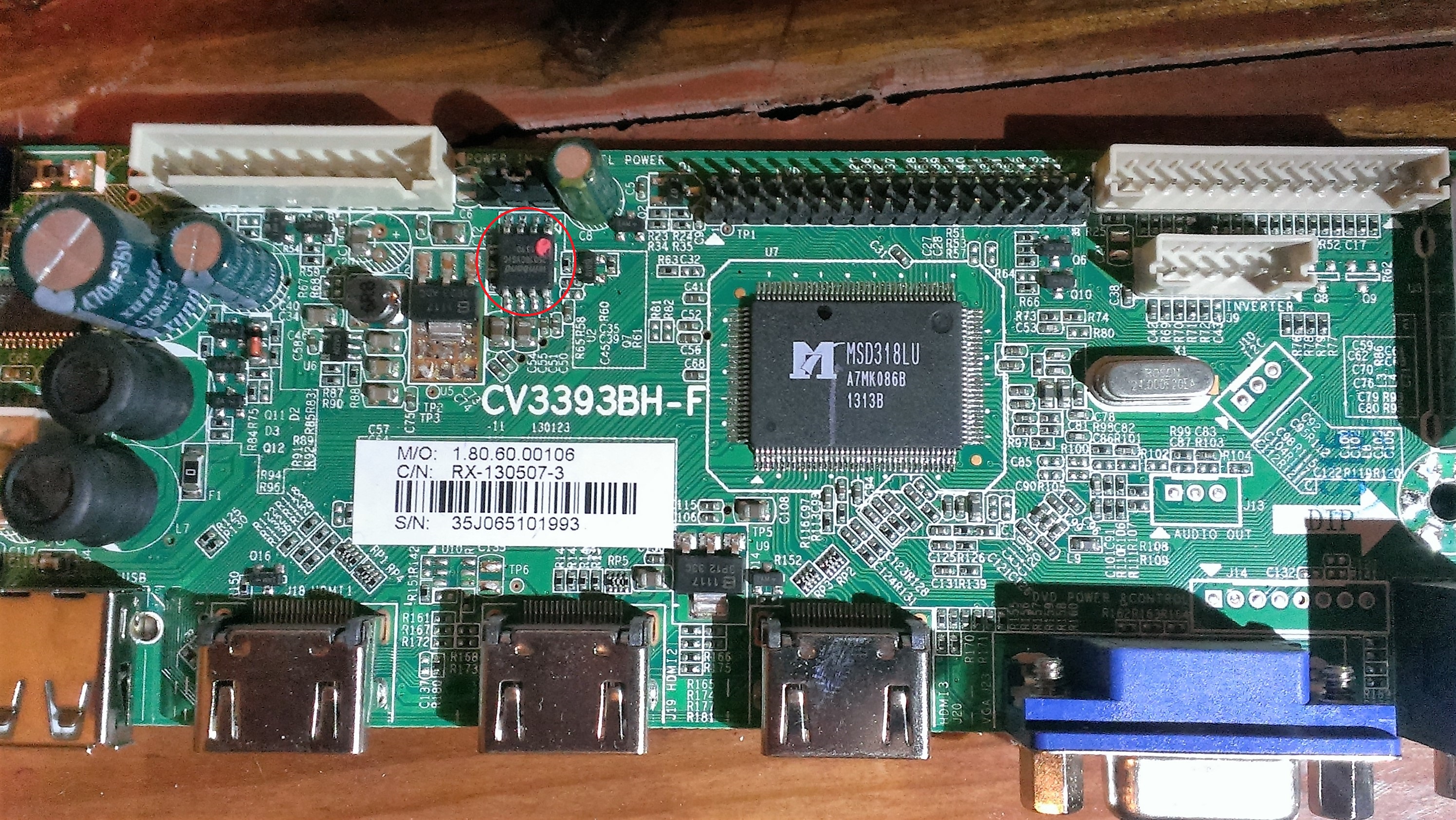

I'm working on a Seiki SE50FY10 that has sound and no picture. Power supply is fine but isn't receiving the signal to activate the LED backlights. I have narrowed it down to the main board. From what I can tell, the EEPROM (U2) on the main board would be the first fault in this. The part is an 8 leg IC that is a WINBOND 25q16cvsig. Does anyone agree with me? And, does anyone have a cross reference for it? I want a higher quality IC that is compatible. Thanks!

 Are you aware that the W25Q16CVSIG IC needs to be programmed? AFAIK, Digikey only sell blank ICs.
 In any case, before ordering a part on suspicion, I would at least measure the supply voltages on the main PCB. Check the voltages at the LDO regulators and the coils.Comment
