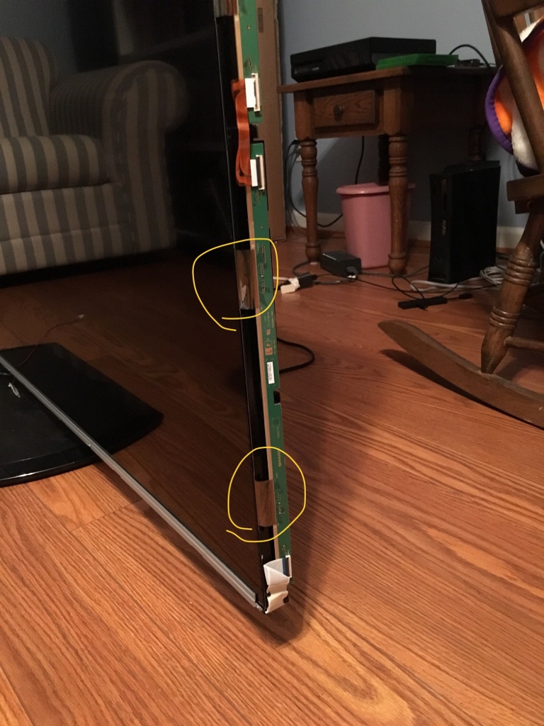

    Am I pulling them out of the LCD part or pulling the cable off the side board?
    • budwich
      • Jul 2015
      • 3097
      Re: Sharp Aquos LC-70LE650U Turns on and works but displays is slow
      All the cables on that side of the set have to be CAREFULLY pulled away from the panel. Good luck in your operation... fingers crossed for the success that I and others have had.

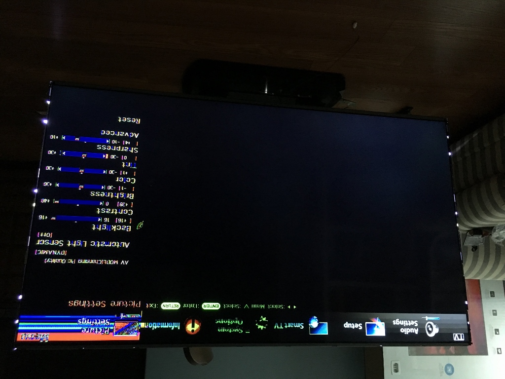

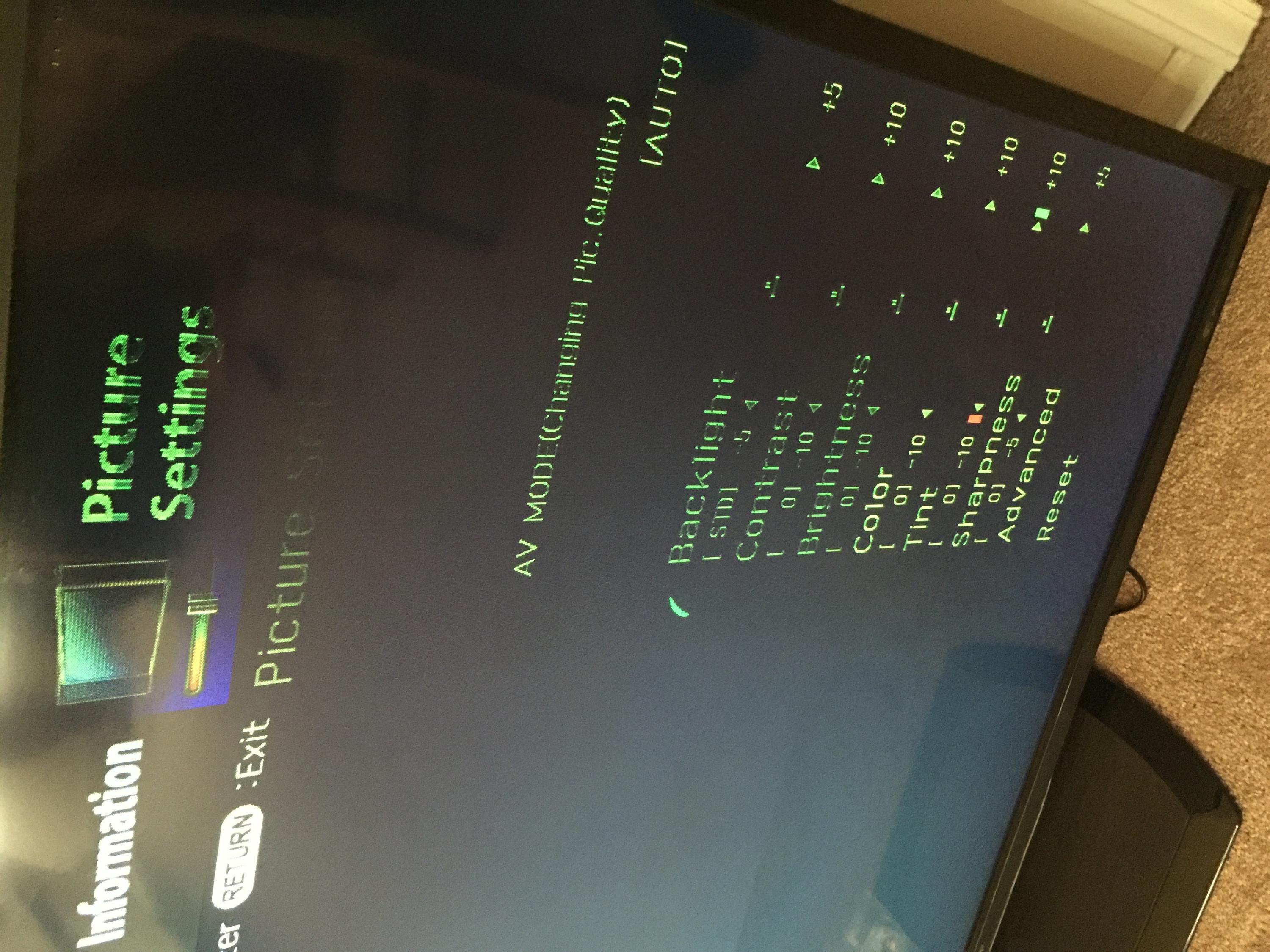

                      Sorry for the delay in responding. I went overseas and didn't check the thread until this week, plus I had not subscribed to notification.
                      Attached are some pics of the TV. It looks pretty similar to the previous user's TV.
                      After I first disassembled the casing, when I touched the right side circuits, the picture would flutter. I cleaned the ribbon cables and it seems to have stabilized the picture to what is seen in the attached pics. Thanks for the advice.
                      • freakaftr8
                        • Oct 2012
                        • 3743
                        #31
                        I wouldn't mess with the right side drivers I would just strip them right off. Another user on this forum only had one small line and after messing with the right drivers he destroyed the whole panel sadly. Messing with the right drivers that are already shorted can undermine and take out the left drivers leaving the LCD panel useless.

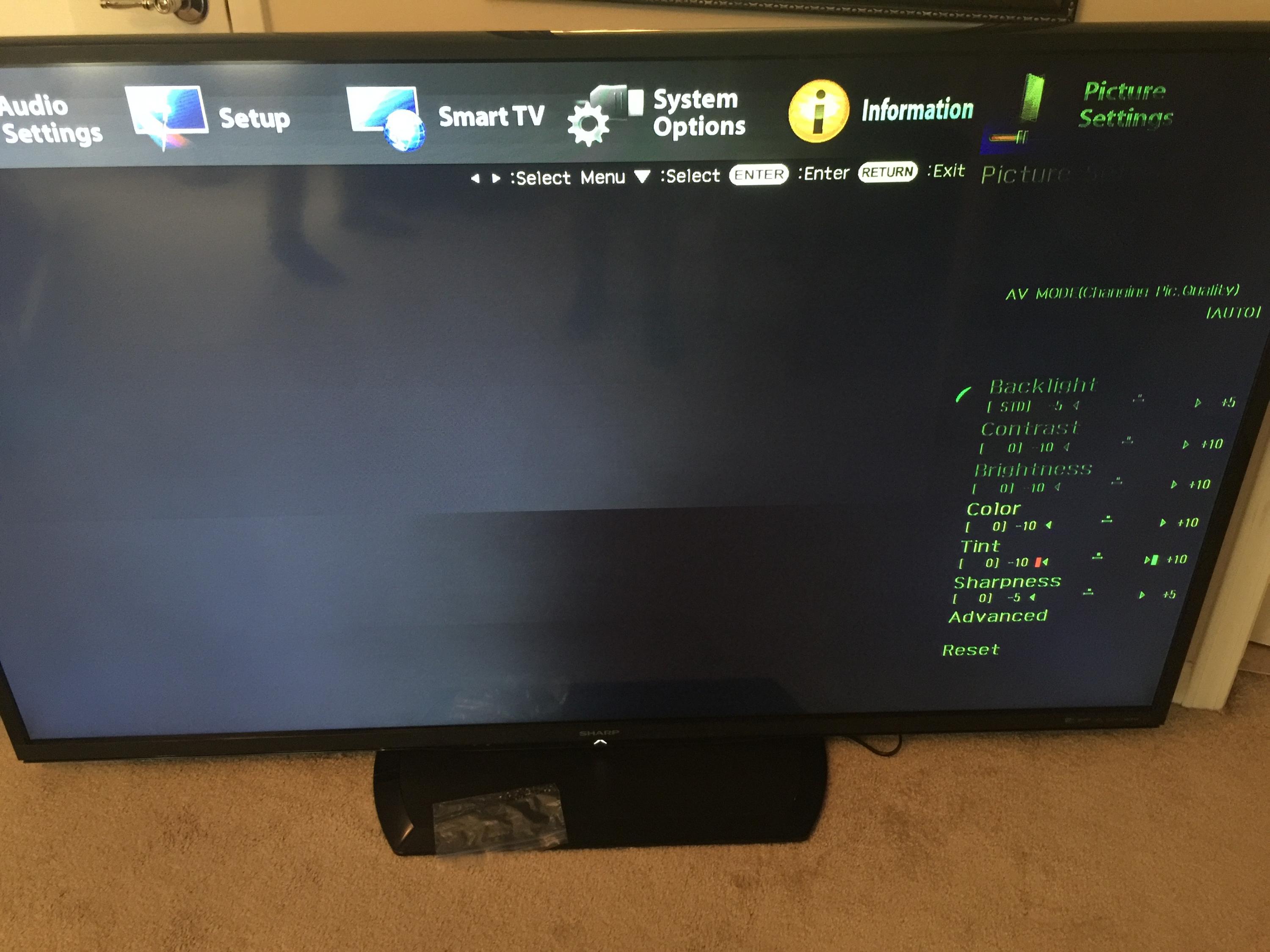

                              OK. I realized my earlier pictures were actually with with some of the right side interconnecting cables disconnected. The attached picture shows all of them attached with the netflix splash screen displayed. The right quarter of the screen is distorted.
                              Also, when I took the right side T-con cable out, the right side was completely white. Similarly when I took the left side T-Con cable out, the left side was completely white.
                              I took pictures of the right side tab drivers and circled the ribbon cables I believe I should pull off in yellow circles.
                              Before proceeding, I just want to confirm that is the recommended path, given the new picture I uploaded.
                              thx
                              • freakaftr8
                                • Oct 2012
                                • 3743
                                #35
                                No. Apparently your gate drivers are ok! If in fact that is the picture you're getting with everything connected your gate drivers are fine but you're tcon needs replacing. replace the tcon and you will be golden.
                                  Sounds great! I will order and replace the T-Con and report back my findings. Thx.
                                  • Kimbrelt
                                    • Feb 2018
                                    • 12
                                    #37
                                    Just wanted to report back. I replaced the T-Con board as suggested and got perfect results! Thanks much for the assistance. Who knows how long it will hold up but for now the picture looks great.

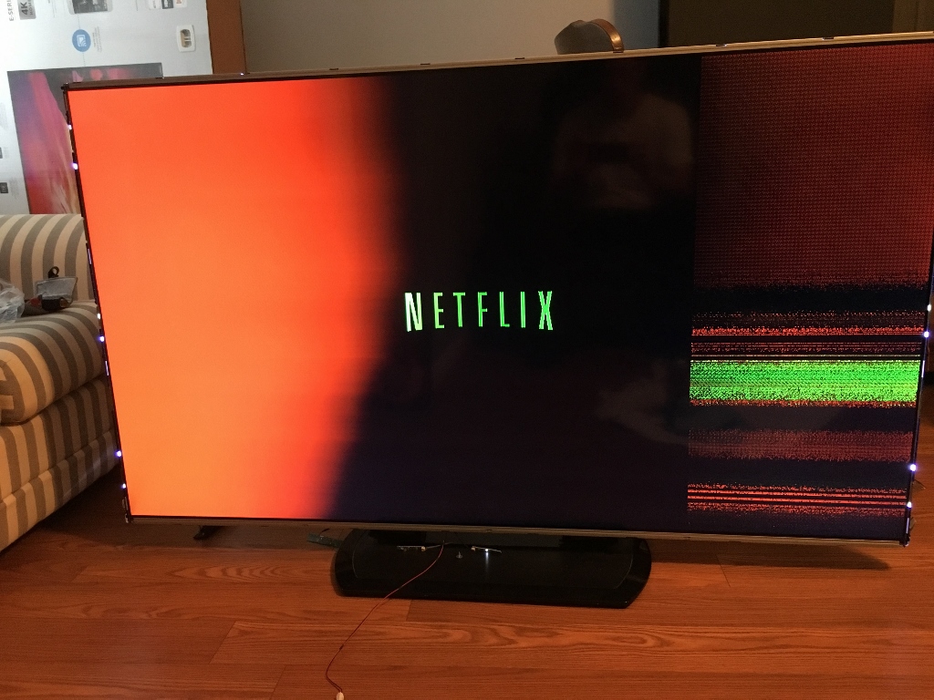

                                        Hi all!
                                        First of all thanks for all the information and help, you guys !
                                        I have the same model with a similar issue but I wanted to make sure if the issue is related with Tcon or bad driver. Here are the details ;
                                        • Initially, TV wasn't turning on, no backlight, no picture, solid led-light.
                                        • Removed back cover, applied small pressured to Tcon and TV start showing "3-short 1-long" error on led-light.
                                        • Removed right strip (left connected) from Tcon, no backlight, "3-short 1-long" error on led-light.
                                        • Removed left strip (right connected) from Tcon, image on right, full white on left (see image), tv functioning normally on the right side.
                                        • Removed both strips from Tcon, backlight on, no error.
                                        • Connected both strips to Tcon, no backlight, "3-short 1-long" error on led-light.
                                        I'm wondering if this is just a Tcon board issue or a bad driver. I can buy and replace Tcon but not sure about how I can identify and remove driver (not sure what it's called).
                                        Thank you so much for the help!
                                          although the test of removing the tcon to panel cables is good... it doesn't tell all the story as you can't see what if anything is happening on the "disconnected half". A better test is to look for the small ribbon cable at the bottom corner of the panel... it connects the bottom edge boards to the side edge boards. This cable in "unpluggable" allowing you to disconnect it / reconnect it carefully. This will isolate the side of the panel from the bottom and you will get a better picture of what is happening as there should no longer be a "white half". try that "test" and post the results. go from there.
