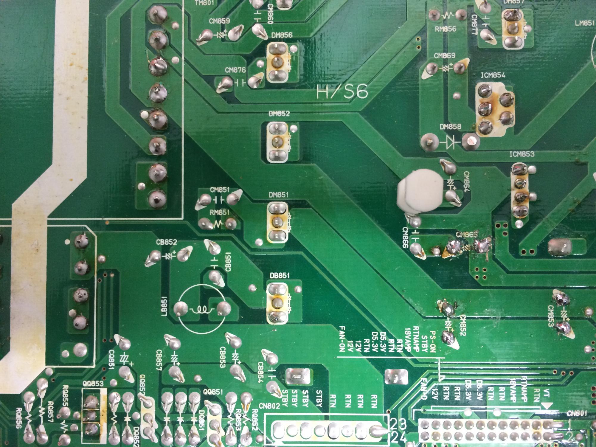

    Currently working on a huge 63" Samsung plasma. Symptoms as follows - as soon as power is applied, the relay on the PSU board clicks and the blue power light comes on. 2-3 seconds later, relay clicks again, light goes off. Repeat ad infinitum. Tried disconnecting y-sus, same symptoms. Tried disconnecting y-sus AND x-sus, same symptom.
    Can't see any obviously bad caps on the PSU board or any blown FETs. There are a couple of bulging caps on the y-sus board (huge 680uF 350v ones!) but otherwise all looks ok.
    Va comes on and sits at 65v during the 2 secs that the board is energised. Vs and Ve don't come up though, both reading 0.3v or thereabouts. Vsc also absent.
    Any ideas?

              Re: Samsung Plasma PS63p76FD power cycling / relay clicking - PSU board?
              Thank you Andrew. I loaded Vs as you described with 100w bulbs, disconnected everything except the AC input, shorted PSon to gnd and VsOn to 5.3v with 22ohm resistors as before.
              On switch-on, everything acted as it did without the load. Relay clicked on, bulbs came on brightly, then after 2 seconds the relay clicked off and it shut itself down again. The only difference this time is that when you remove and reapply the power, it stays dead unless you leave it unpowered for 15-20 seconds before trying again.
              I've taken some close ups of the bottom of the board around the connector to the main board. I'd already tried to reflow anything that looked suspicious an had replaced some of the electrolytics with spares that I had lying around, hence soldering looking a bit messy!
              The board is a bn96-003637a, also labelled as PSPF771F01A
              Thanks!

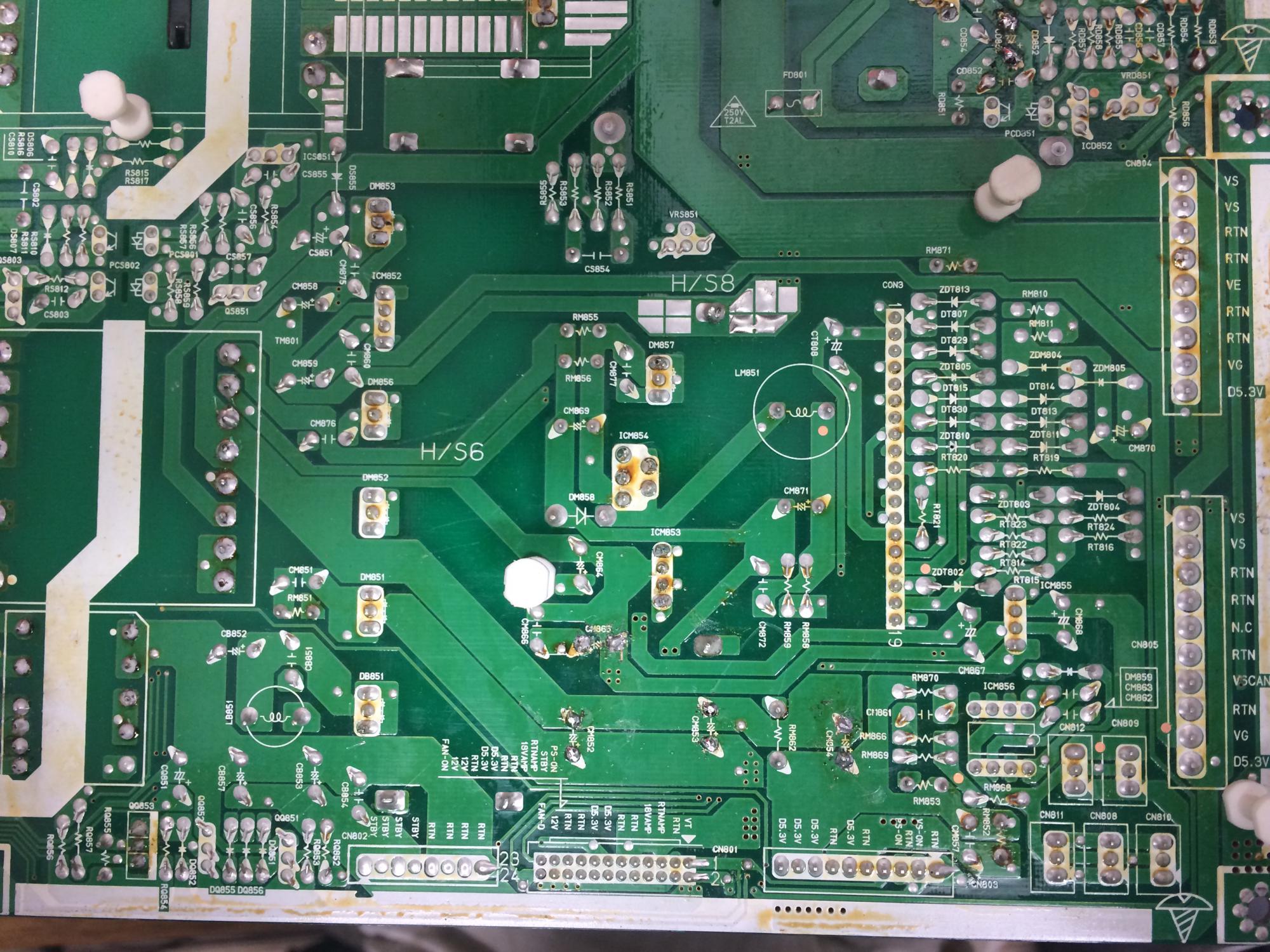

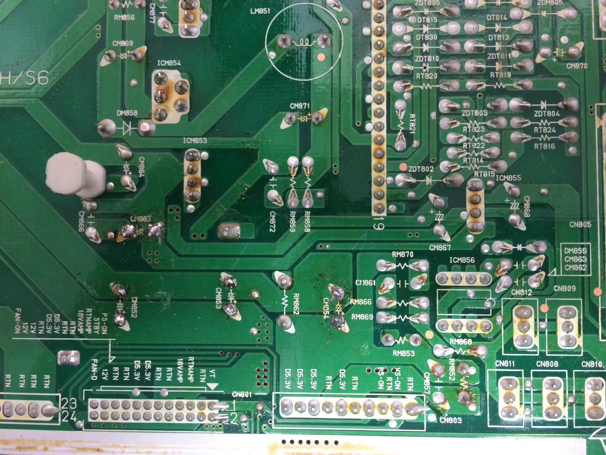

                          Dragging this one back up to the top again after leaving it in the garage for a month or two!
                          I have tried replacing the opto-isolator - no luck, it does exactly the same. There's something very odd going on, as the set behaves normally whenever I am probing the voltage on the dc side of the opto. Somehow the voltmeter probe is causing a transistor or IC to stay switched on. This still happens even if the other leg of the DVM is waving around in the air!
                          I'm wondering if one of the small ceramic (poly? not sure, they're orange and squareish with rounded corners) caps is below spec and the tiny amount of additional capacitance in the DVM could be temporarily sorting the problem?
                          Any ideas? Pics of the board in question to follow later.

                            • Electronic Handyman
                              • Apr 2016
                              • 58
                              From your pics I can see that that PSU has some bad connections.I think whats happening is when the soldered connected hits certain temps the set will work but when it gets too hot etc the set shuts. I've seen this with more then one Samsung.I'd strongly suggest that if you've the time and patience go over all the soldering connections, especially at the hot spots.If you look on the left of the psu you can see cold soldering connections, remove the old solder and re-solder them.I personally go over the whole board and try to solder every soldering connection I find.Takes time but it makes the sets usually work better and last longer too.
                              This is again just my opinion but that set is a few yrs old and is bound to have bad caps, I'd replace all the caps located near the hot spots on the PSU and if you've bulging caps on the y-sustain board change those.Use good quality capacitors that are Low ESR. I'd also check all it's soldering connections and re-solder especially the hot spots.Remember to replace all the big caps on that board.
                              Note since you mentioned something regarding the set suddenly working after doing so trouble shooting that again tells me bad caps and bad soldering connections.
