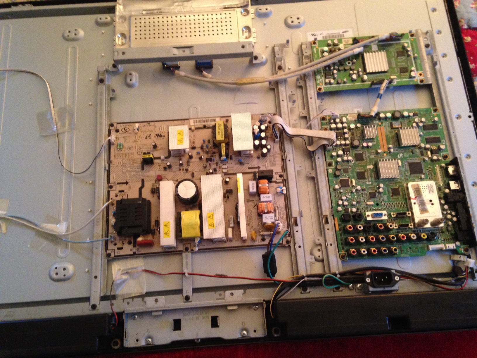

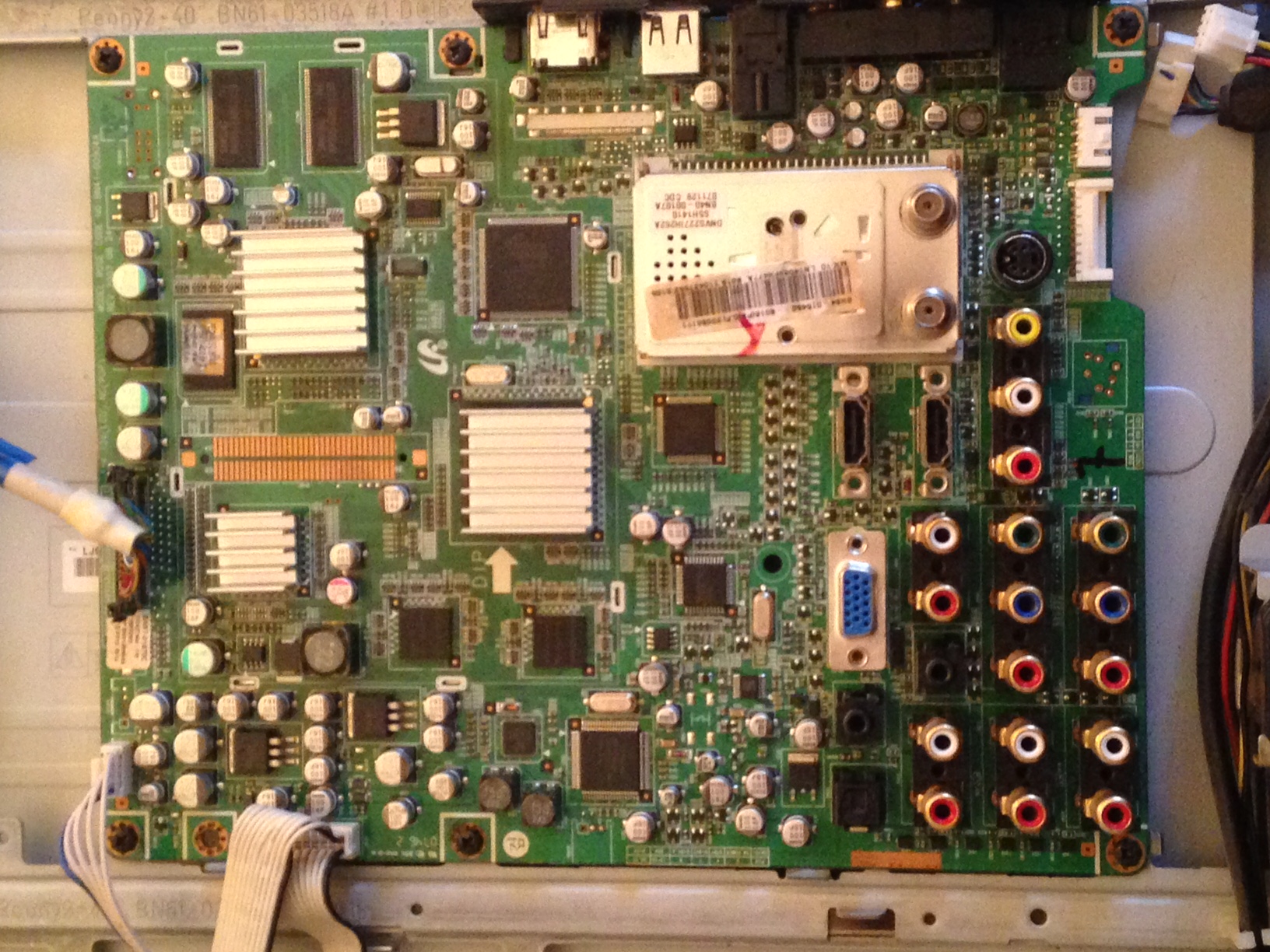

    Samsung LN-T4069 No video, Sound OK, backlights Working.
    A little background information first. Last year I had a Samsung LN-T52xx TV that had the same symptoms, All voltages were good. No video, backlights worked, and sound was ok. Budm, Tom66, and a few others concurred that the problem is either the T-conn or the Main Board. I decided to go with the T-conn as the board to replace. After replacing the T-conn, The TV worked perfectly. It's been 10 months and still working. Great job by Budm , Tom66 and a few others on the forum.
    Now, the current problem. This 40 inch Samsung started with a similar problem. Video would disappear, sound OK and backlights working. It would be very intermittent. One day it works ok and next day no video. Finally, the frequency became shorter and shorter and then NO video any time TV was turned on, sound OK, backlights working. Just before the video went blank for good, and not come back on, the video would flicker every two seconds. It did this for a couple of days, then completely stopped producing a video.

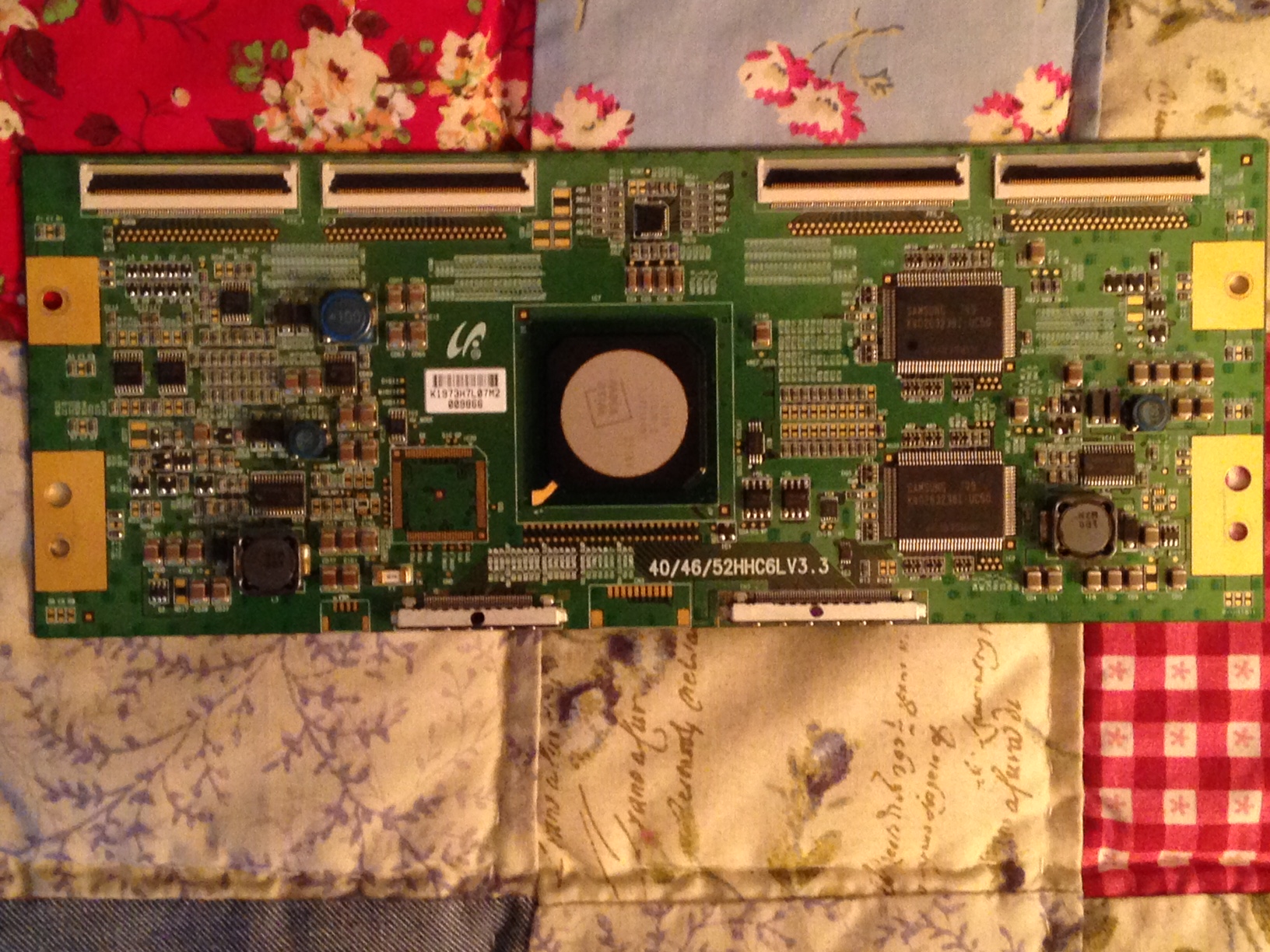

    I ordered a T-conn. Installed it, and the TV worked on power on. I reassembled the TV. My wife used it that night, after a half hour of being on, No video, sound OK and backlights working. I reinstalled my original T-conn, it would not work on power on, no video, sound OK and backlights worked. I assumed I got a bad T-conn as a replacement.
    Ordered another T-conn, installed but this time I did not reassemble TV. Power on, good video. I waited. Twenty minutes later, video began to flicker every half second. Then the video came back, twenty more minutes, video went blank, sound OK, backlights ok.
    Now I'm questioning whether the T-conn is really bad. One thing I noticed while I was doing the testing, the metal cover over the Main Board was extremely hot to the touch, not just warm. Also, there is the FRC board mounted above the Main Board. Could that be a possibility?
    Sorry to have rambled, but I think the complete story needed to be told. I ordered a Main Board during the interim and I'm waiting for it to arrive. Any comments and suggestions are appreciated.

    Re: Samsung LN-T4069 - no video, sound ok, backlights working
    When the picture disappears, does the screen turn grey and blotchy or does it just go black?
      johnboy1313,
      Just goes Black, no visible light from the screen. backlight is on as you can see it from the back with and without the backside cover of the set on or off.
        Have you done a search for the model number? There are several posts regarding this set and no image. I've got one I'm working on right now too. My screen is grey and blotchy. I found a few posts that said to change the FRC board. I didn't pay a whole lot of attention to other posts. You might find one or two with the same issue.
          johnboy1313,
          I did see those posts. the FRC is definitely a possibility because it connects directly to the T-conn. I've never heard anyone complain or have a remedy for an FRC board. I think it's going to be either the FRC or Main Board. I thought I'd get more responses from others that have had this experience before.
          I did order a Main Board that I'm waiting for right now. Ebay is full of FRC's and they're not too expensive. the Main Board cost me $35.00+free shipping. I'll definitely keep an eye on the back of the board after power up to see of the replacement Main board gets extremely hot as the original.
          I know I can go out and get another 40" for the bedroom, but it's the challenge and hope for success that I keep at it. True, it's a 7 year old set, I'll set a limit to my $$$ spending.
