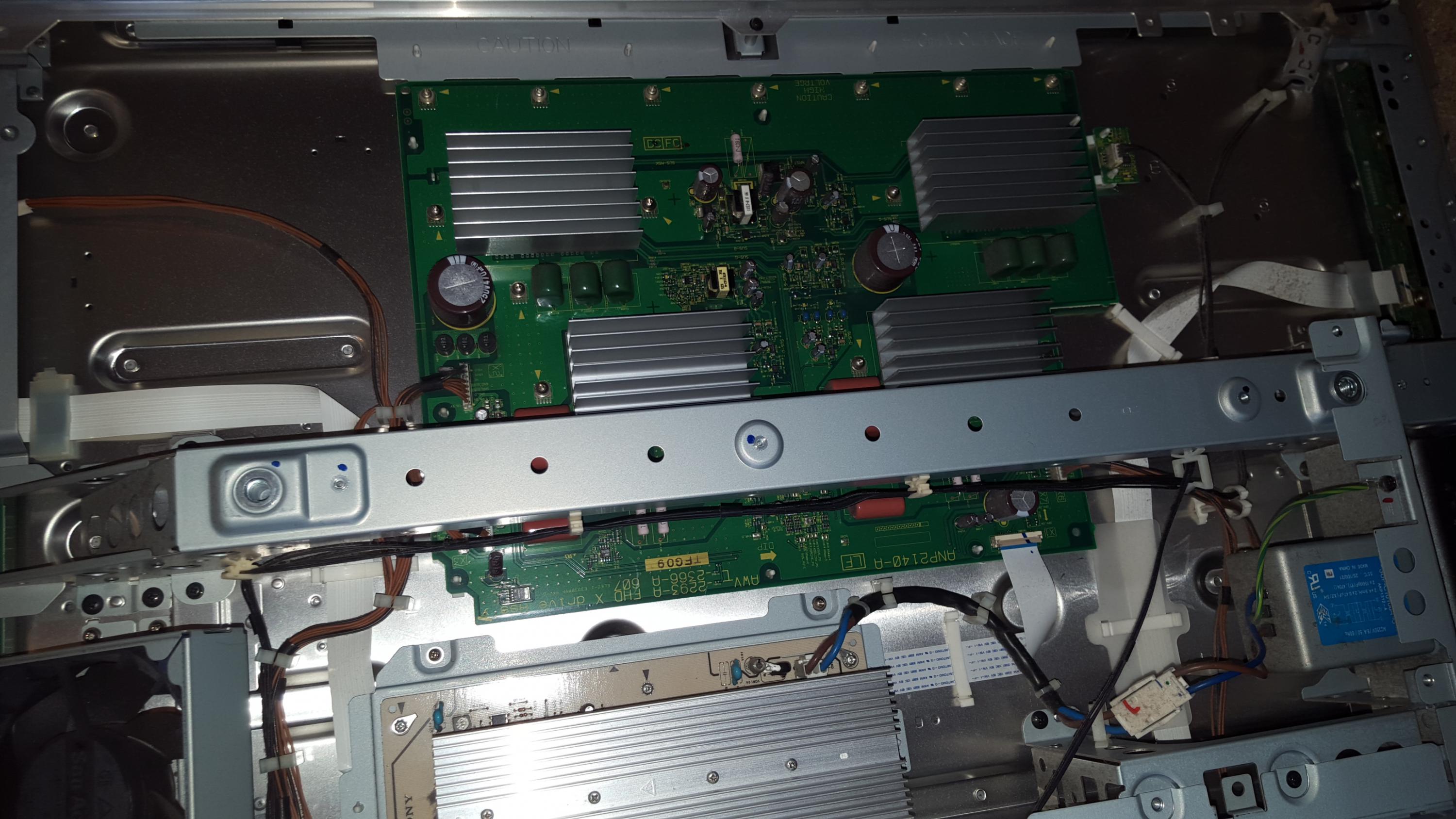

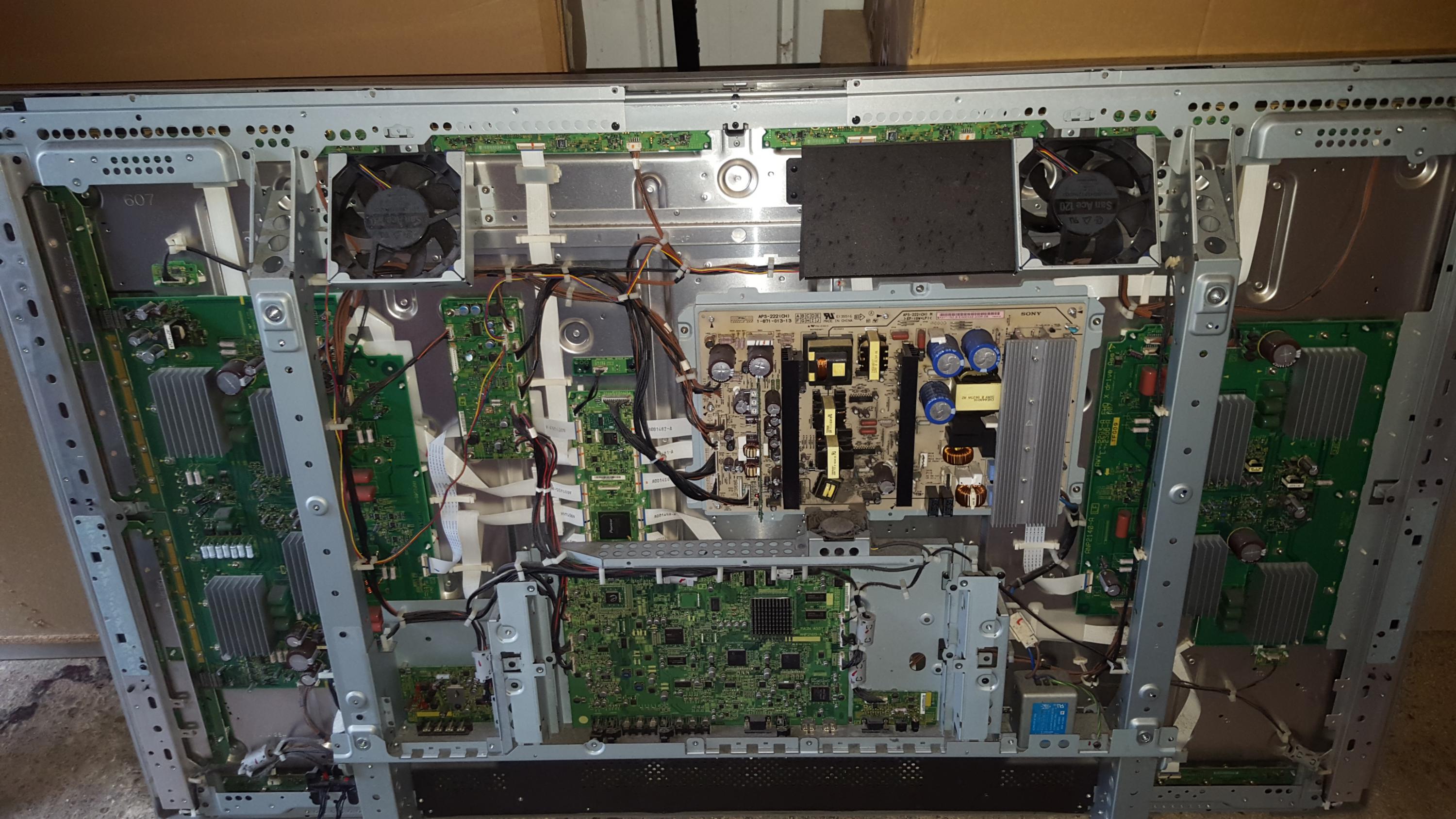

    i have this beast (really heavy)being dropped to me this week its a friends tv which i said ill try and have a look for him its working fine but with SCART,HDMI inputs there is no picture being displayed
    was just wondering if anyone has come across this model before ?
    ill post pictures as soon as it arrives
    thanks

    Re: NEC PlasmaSync PX-60XR5G
    Pictures uploaded

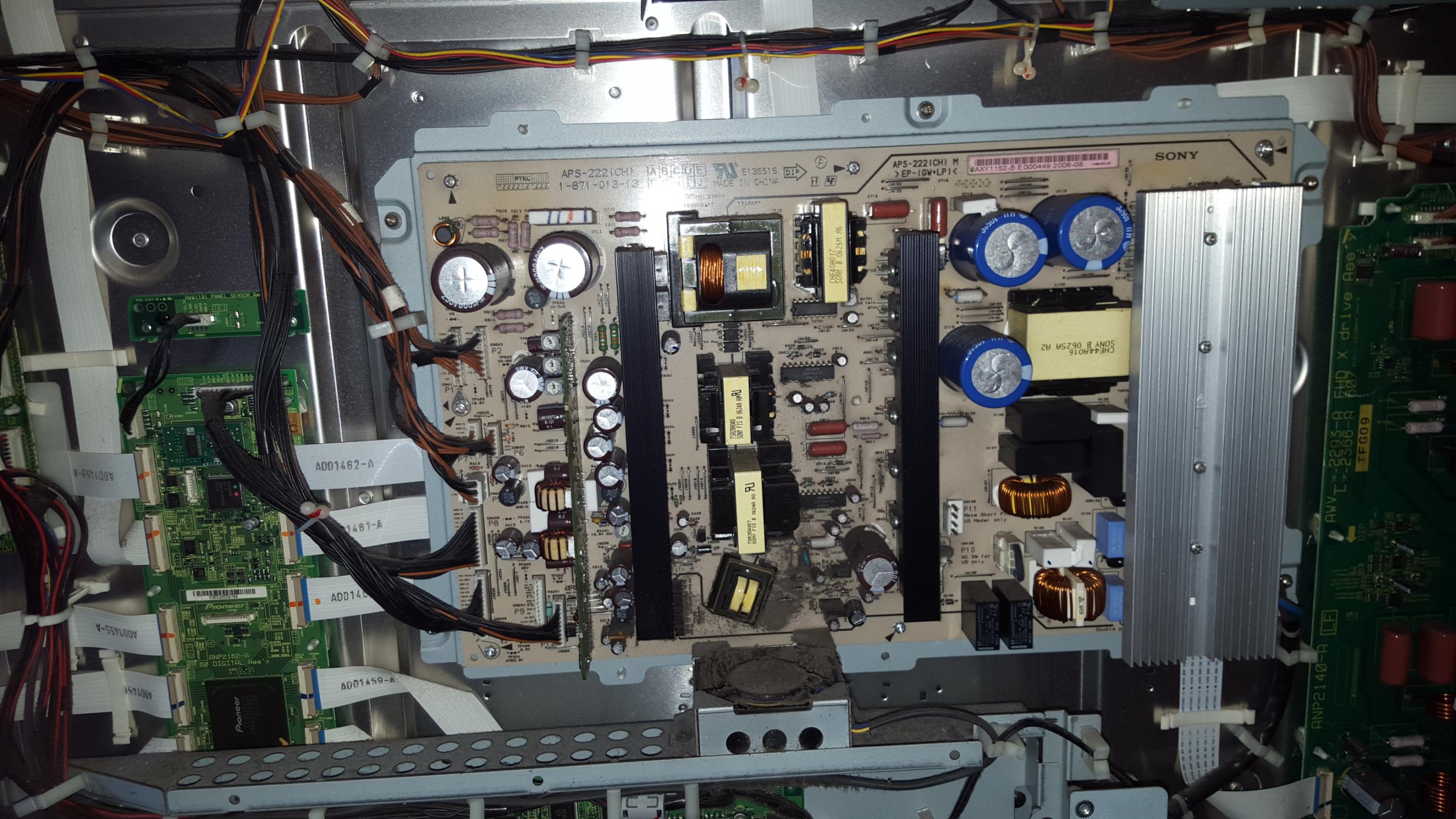

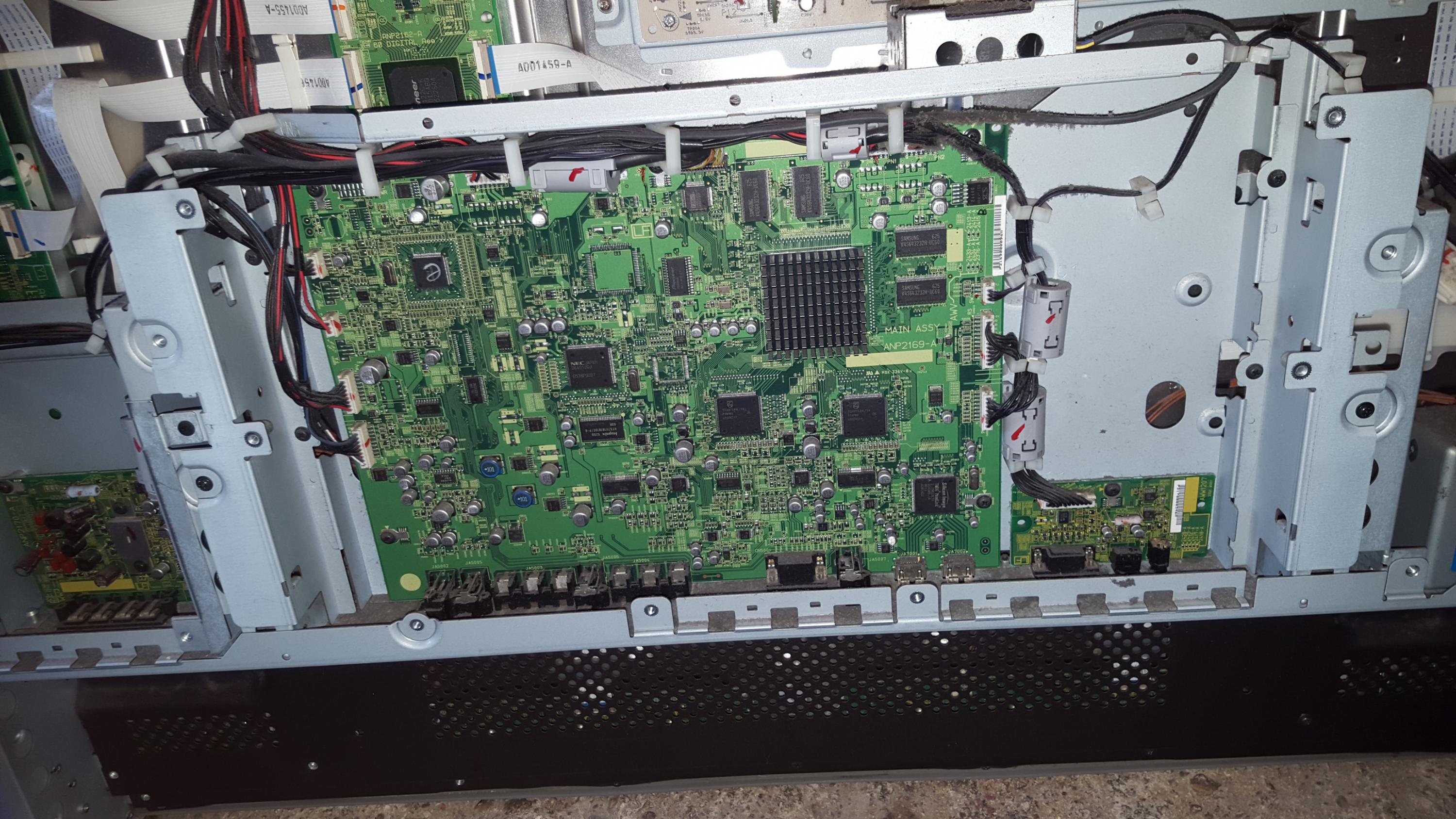

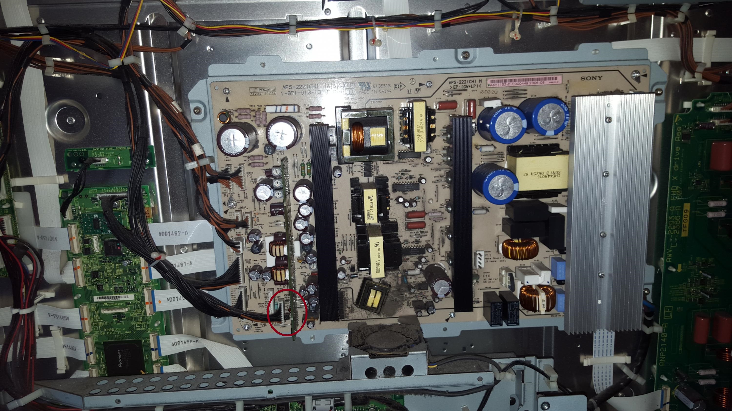

      tested some voltages but it seems on the digital board all capacitor voltages are low and there should be 10 volts readings which are zero which turns on the fans or does this only activate once the tv gets hot ?
      im wondering if this could be causing the tv too not to be working via all inputs ?

          have you tried a factory reset? incase the user has messed with any settings
          not yet but just asked my friend he said hes not messed with any settings the inputs just stopped working,but its strange that even all the Electrolytic Capacitors with Various Voltages are low and in the picture ive uploaded i have no reading of one point going to the main board which should be 10 volts also reading 0 volts
          and even the 10 volts going to the fans are reading 0 volts

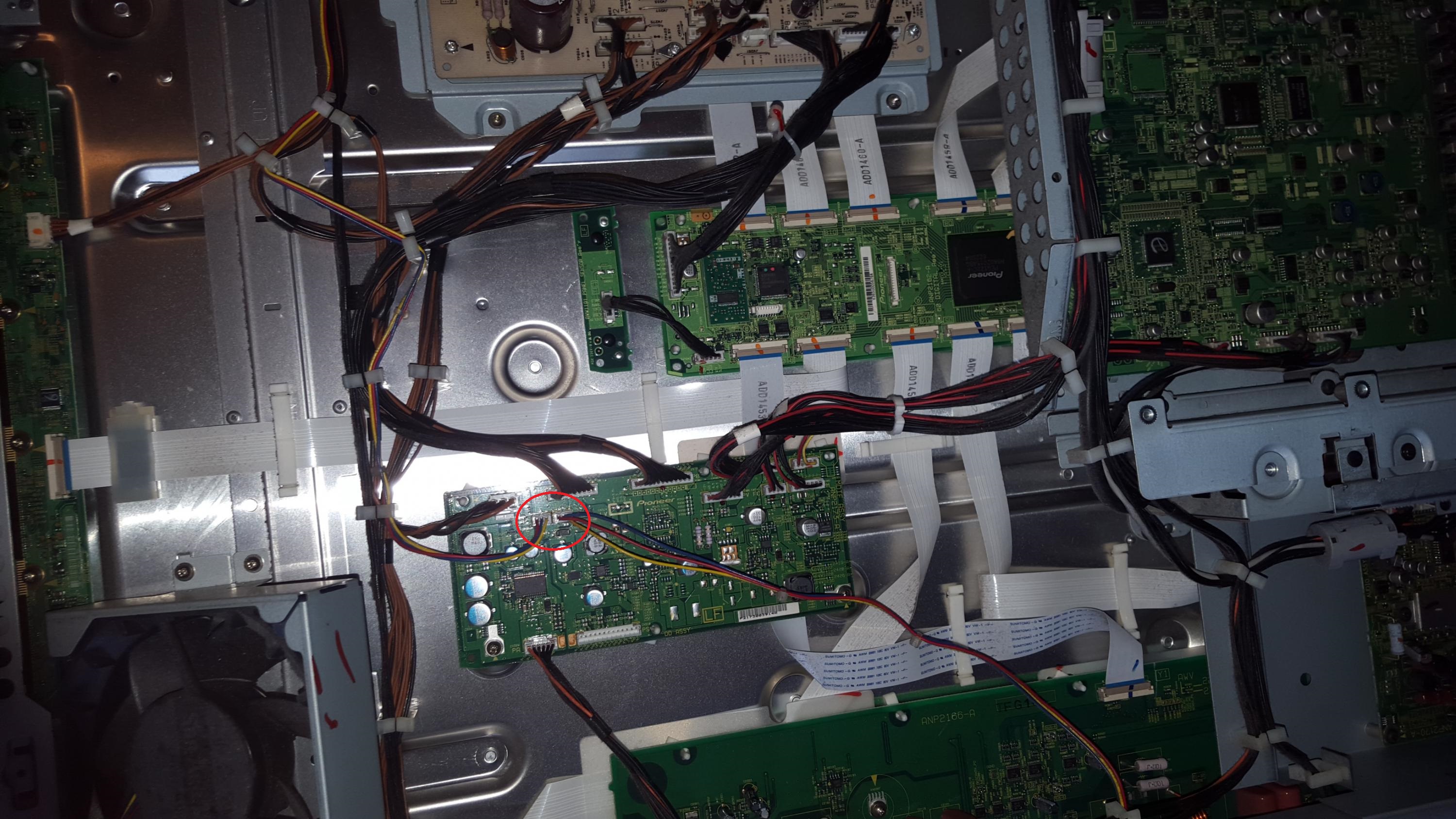

            picture uploaded
                    Tom should the fans come on from the start all when the system warms up ?
                    • diif
                      • Feb 2014
                      • 6978
                      • England
                      I can't speak for this TV but with the LG plasma I am working on the fans don't come on with switch on, just after a bit.
                        My dad has a PX-50XR5G (great TV, over 10 years old and still good) and the fans come on immediately after it powers on, a couple seconds before the display primes.

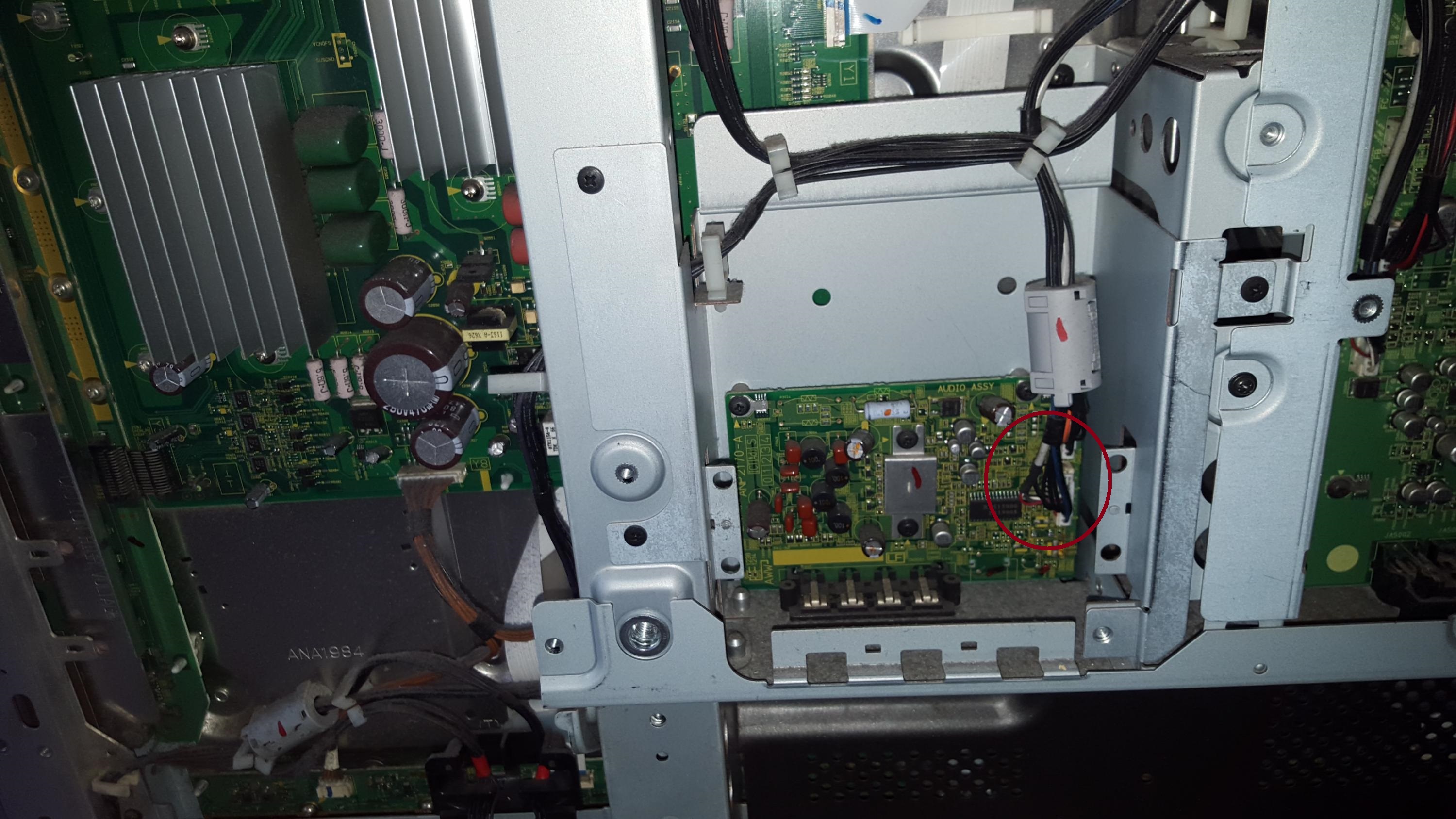

                          So with the fans not working which is linked with the 10 volts being dead maybe start with the power supply voltages ?
                            Unplug the little audio amplifier board (has speaker connections), see if that sorts it out. That was the fault with my dad's TV.
                            • sordids999
                              • May 2013
                              • 2161
                              • uk
                              Do you mean unplug these connections tom ?
                                Yes
                                • sordids999
                                  • May 2013
                                  • 2161
                                  • uk
                                  no tom unplugging both cables just gives me a red warning light on the power supply light up and the tv will not turn on
                                  so i tried one at a time which worked but no fans switched on
                                    Strange, because my dad's set has been running for the good part of 3 years with those cables out. It was a shorted amplifier causing a protection fault. The TV turned on with a no signal screen and occasionally would display an image but shut off immediately.
