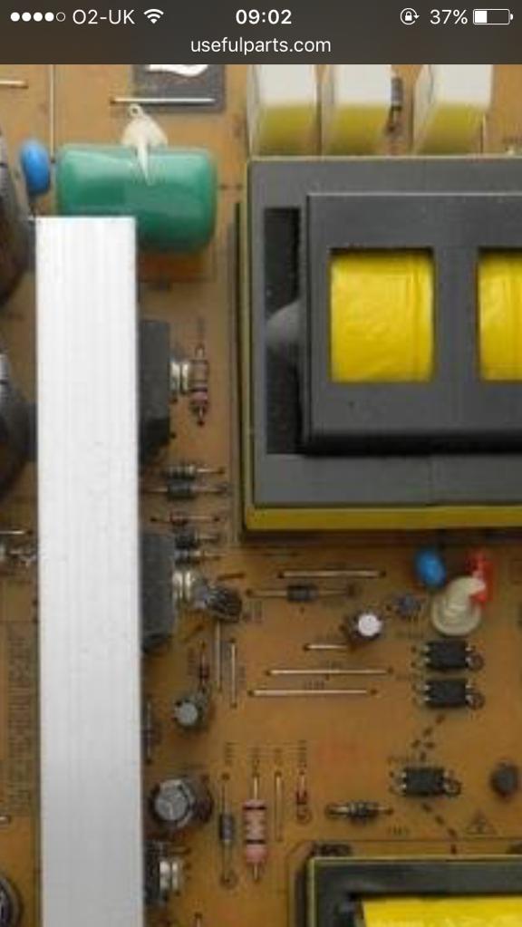

    My LG plasma 50ps30 has problem. Turn on button It has blink blue led
    3 ,4 times then back stanby orange.I can hear buz from powersupply but no relay click
    no vs, va. It has Relay on 3.3v , vg on 3.3v , but down ov when standby led goes orange.zero v on AC detect
    Check all fuses are ok. The board is EAY60704801 Thanks

    Check the FETs in this picture for s/c
    If they are shorted there are several parts that will need replaced.

          I do not know why relay never click.I hear buz from pfc section when turn on but not any voltage out.There is only standby voltage.
          There is no short fets, all fuses are good.
