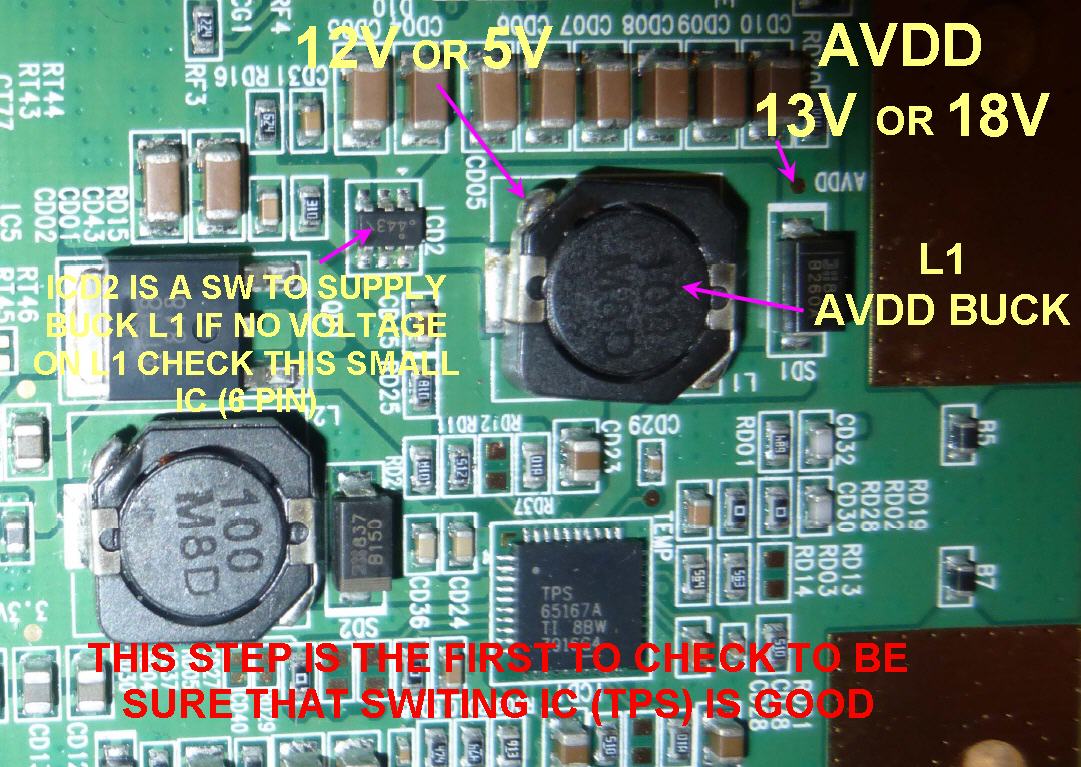

                      #50
                      Re: T-con Samsung identifying problem
                      HI ALL
                      till now this samsung not repaired why we do repair step by step .
                      first step is shown in the pic >
                      if you do it first it will insure TPS65167A IS GOOD after that we can continue.
                      thank you
