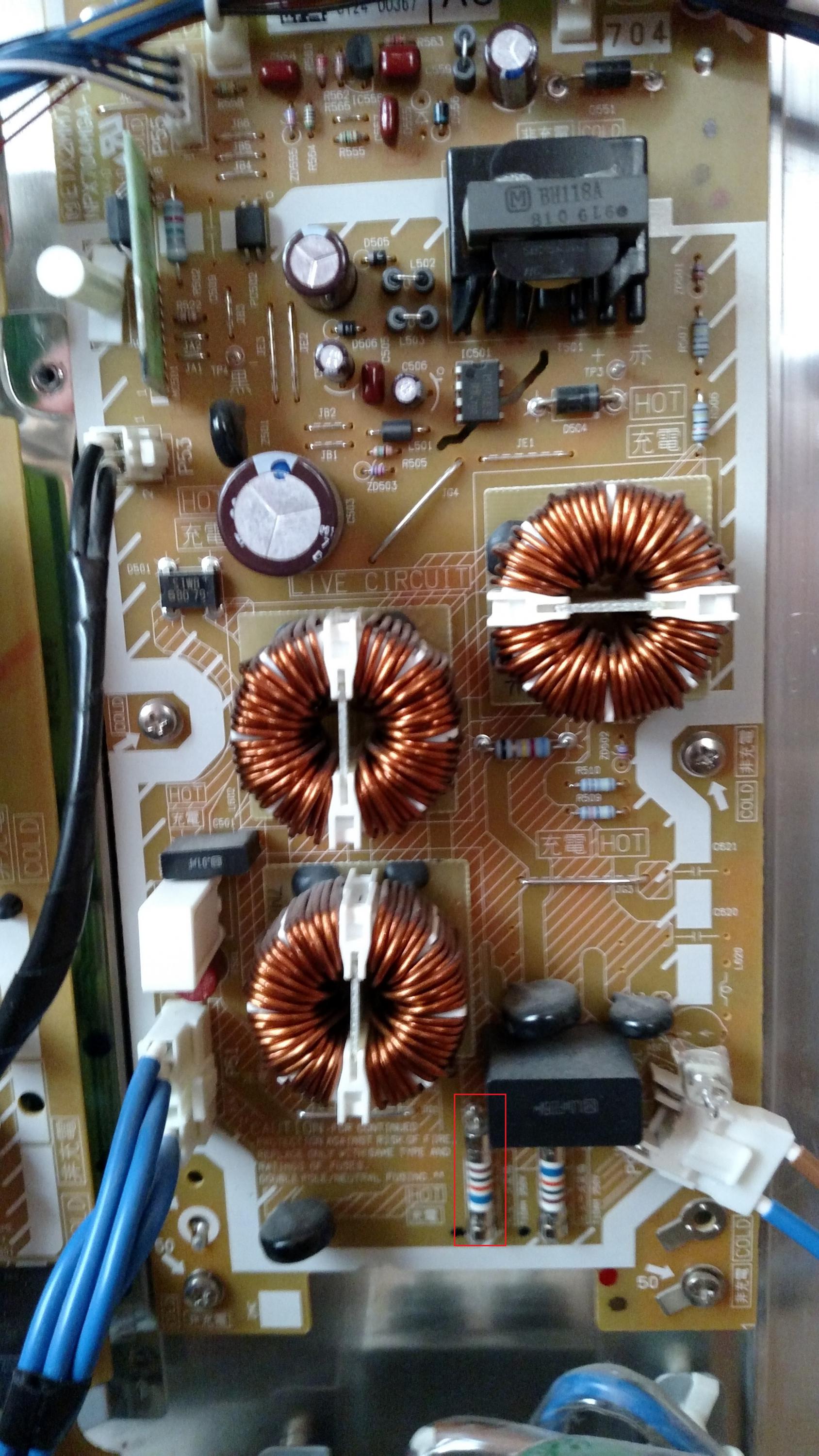

                          alright..decided to go back to class 101 - check fuses.
                          All had continuity except for 1 on the "P" AC board - see red box in attached pic.
                          Is this a fuse that can be had off Mouser or Digi-Key or is it some Panasonic magic fuse?
                          Does anyone have a link to the proper replacement?
                          don't know if this will be the only issue...but hopefully...

                            Re: Panasonic TH50PZ80U - power button
                            Probably something else is wrong, fuses rarely blow without cause. It can happen, it's just unlikely.
                            You can try putting a light bulb across the fuse - 100W or so - attached to wire clips - if it glows then there is a problem. If not, set may actually turn on although I doubt you'll get to the stage of having a picture with the bulb in place. But then you can replace it and test it again.
                              any idea what that particular fuse is protecting?
                                That protects the entire TV. It's one of a pair of main input fuses.
                                  interesting...we had bad storms here of late wonder if it got hit?
                                  Do they work in series or parallel?
                                  guess I will order 2 fuses in case there are larger issues...
                                    The fuses work in series, one for live and one for neutral.
                                    Lightning rarely causes fuses to pop without doing other damage. However fuses can sometimes fail without obvious cause.
                                      guess I will replace the fuse and see what happens...at least at that point I will only have a few $$ in it...
