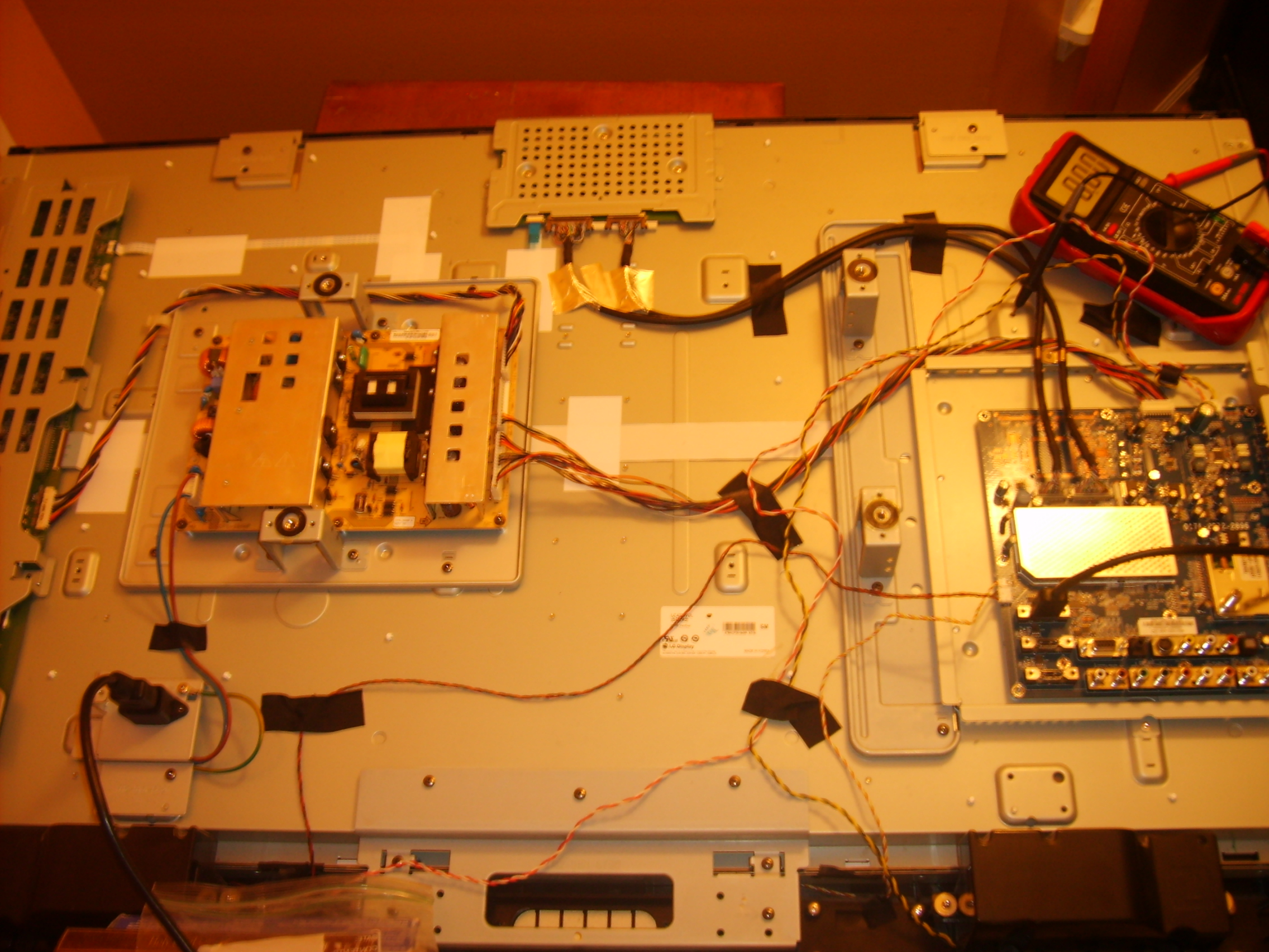

    I tried plugging the Roku in, but received the dreaded "Purple screen of death". I still had a few ground screws pulled off so I don't know if the main board is fried and the 1.0v is a small symptom, or if the Roku or HDMI cable is the problem.
    My question is ... is there any reason I shouldn't just tap into the PS On signal to run both, or might that overload it? I'm still trying to walk the circuit back to see if it's a faulty voltage regulator that I need to switch out, or if it's something coming from one of the major chips that would need a whole new board.

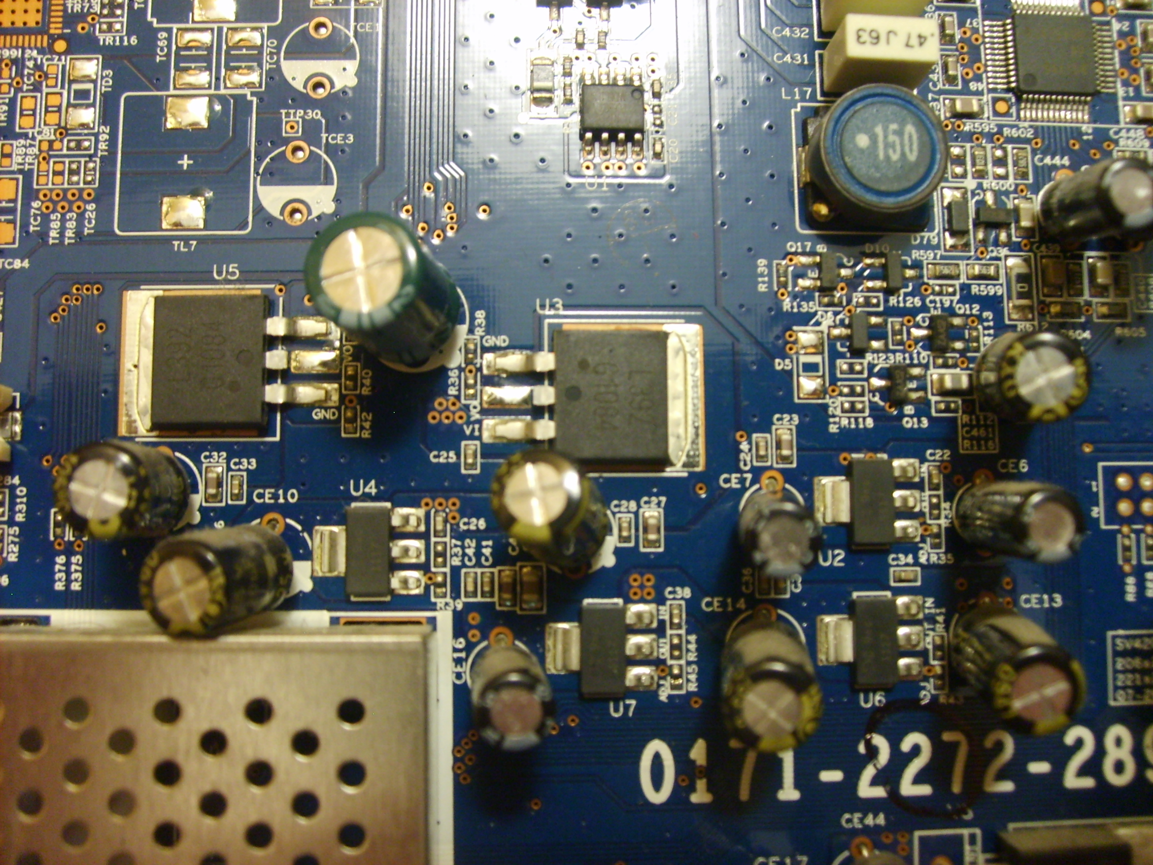

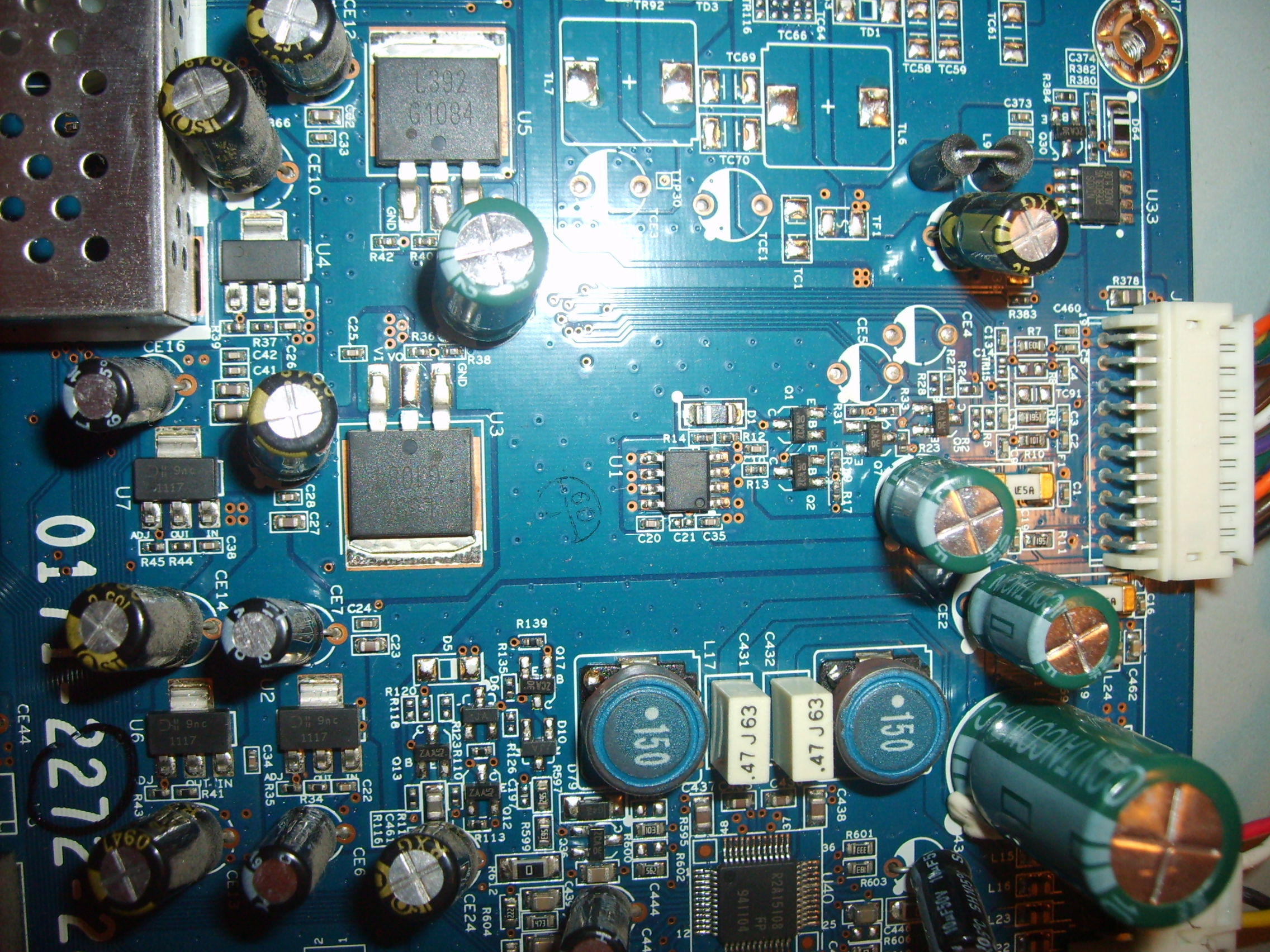

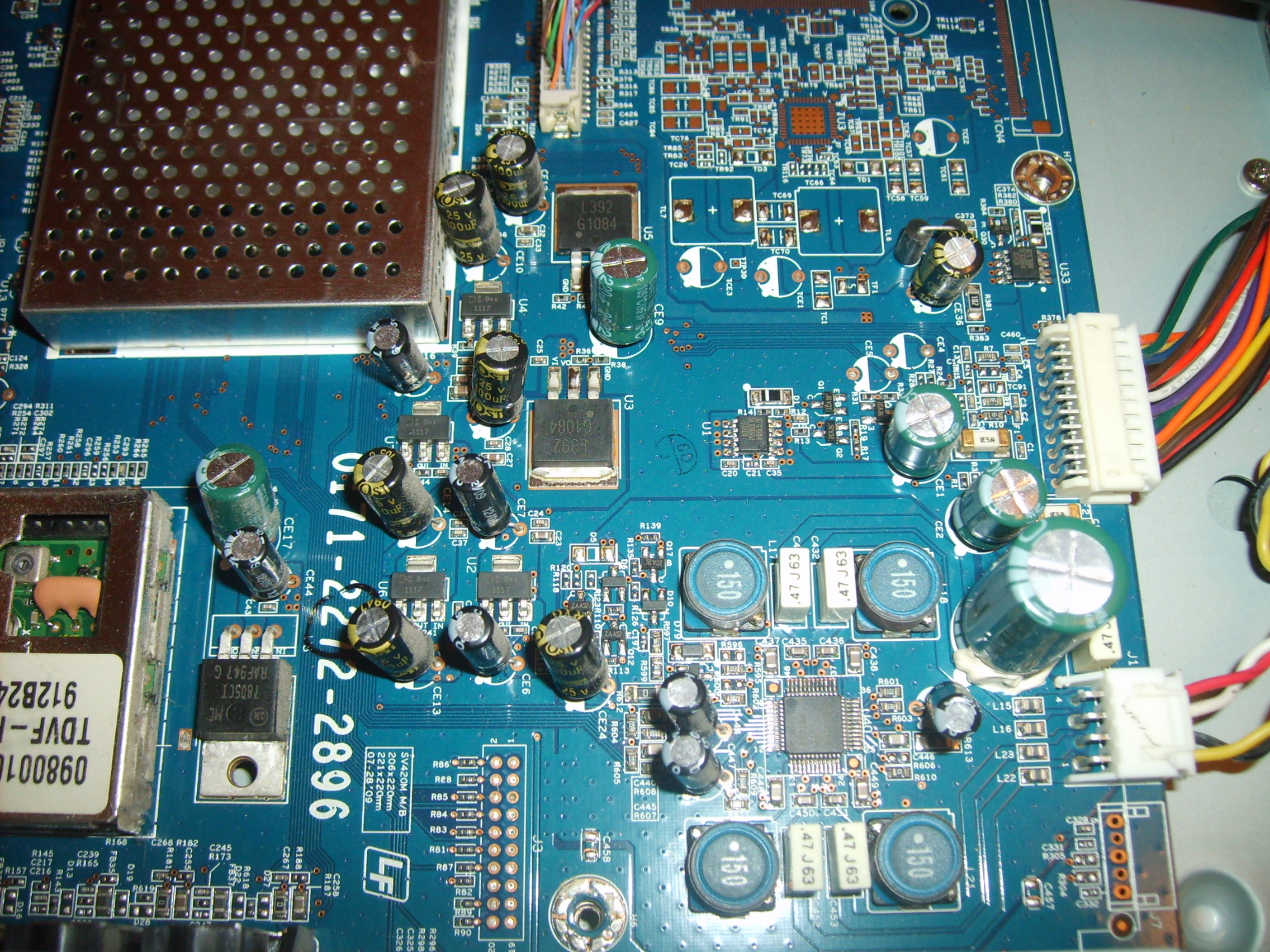

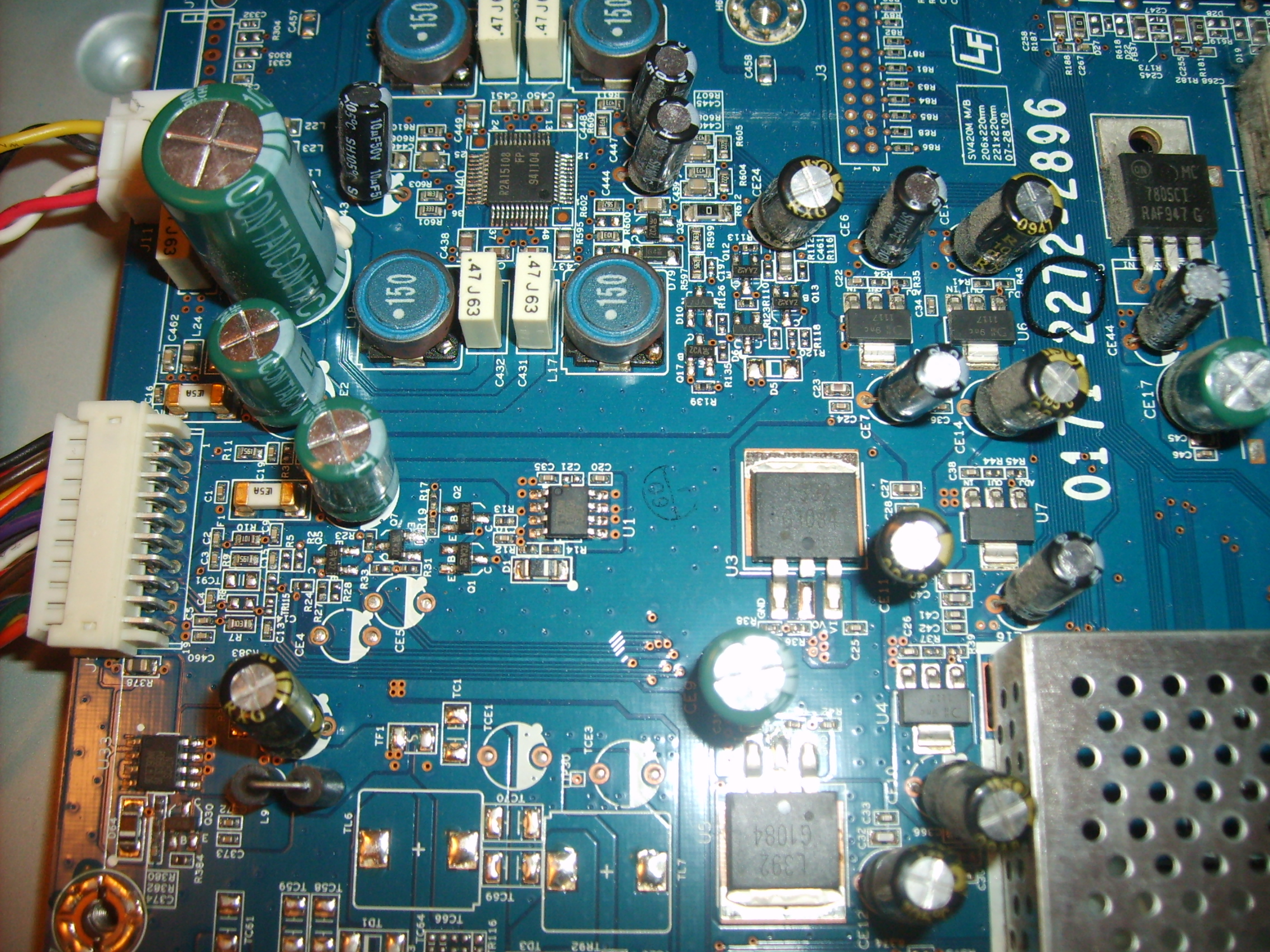

            Attached are pics. I'll annotate them later.

                that big green cap on the main board looks like the top isnt flat!

                  1000uf 35v cap is all good. I think it's just the angle of the picture.
                  I did find that one of the 1117 voltage regulators (U4) doesn't have any voltage on pin 1. Don't know if that's because a feature isn't turned on or because it's fried. I'll try to capture all the voltages from the various pins and try to trace back where it's getting the 1.0v from when I get home tonight.

                      I think I've followed the trace with 1.10v to the underside of the RF shield. There is a jump in component numbering of the regulators on the board; I can't seem to find U8 to U19. I'm assuming they're all under the RF shield and behind a white plastic square. I'll unsolder it tonight and see if I can find the one that's probably giving me trouble.

                              Like I said before, I was able to turn on the TV, wait a few seconds for the power supply to stabilize, and then disconnected the BL-On line from the main board to the power supply and jumpered PS-On pin to the BL-On pin. The whole thing lit up. Screen looks good with no cracks / fluttering / fading / etc.
                              My Roku showed the menus and I could queue something up to play, but it gave a purple screen when I hit play; from what I understand that means it couldn't make a secure connection to the HD processor. It could just be the cable I was using, but it could also be that the busted voltage regulator may be connected to other parts that need more juice.

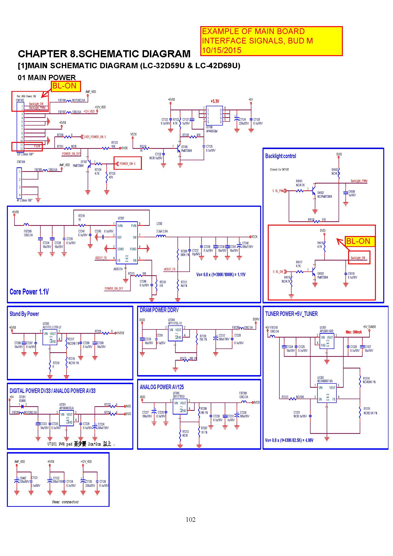

                                      I have little experience with flat panel TVs and monitors, but I have repaired thousands of electronic devices, including several hundred CRT based displays. That said, I'm basing my statements on budm's advice. AIUI, he is suggesting that the BL_ON circuit might look like the following:

                                      He has asked you to trace the circuitry immediately before and after the BL_ON pin, on both boards. You would then measure the voltage into the base resistor (Rb). If the MCU is driving the base correctly, and if the collector is sitting at 1V rather than 0V, then this would suggest that transistor Q is faulty (low gain).
                                      If the Vcc supply were low, then one would expect that the TV would have additional symptoms.

                                        Thanks FZABKAR, that is he typical interface for the BL-ON, PS-ON circuit. It is just a matter of tracing the trace from the BL-ON pin to see where it goes, the switched transistor should be close by the connector, that is what I do when I do not have the schematic of the board, it is time consuming so what else can you do. Some time there will be two transistors if the processor is Active HI. The one you draw is Active LO.
                                        Just need to find that switch. Sometime I spend hours or days or weeks reverse engineering the boards.
                                        See example of how Sharp TV does the interface, very simple. and it also why YOU DO NOT TIE THE PS-ON AND BL-ON pins directly to the 5VSTBY when you still have the main board connected.
                                        The transistors are NORAMALLY ON so when you connected 5V directly to the PS-ON, BL-ON pin you will dump big current through the fully on transistor and it will release the magic smoke. That is why you must disconnect those signal wires back to the main board first before forcing on the power supply board. Always use resistors.
