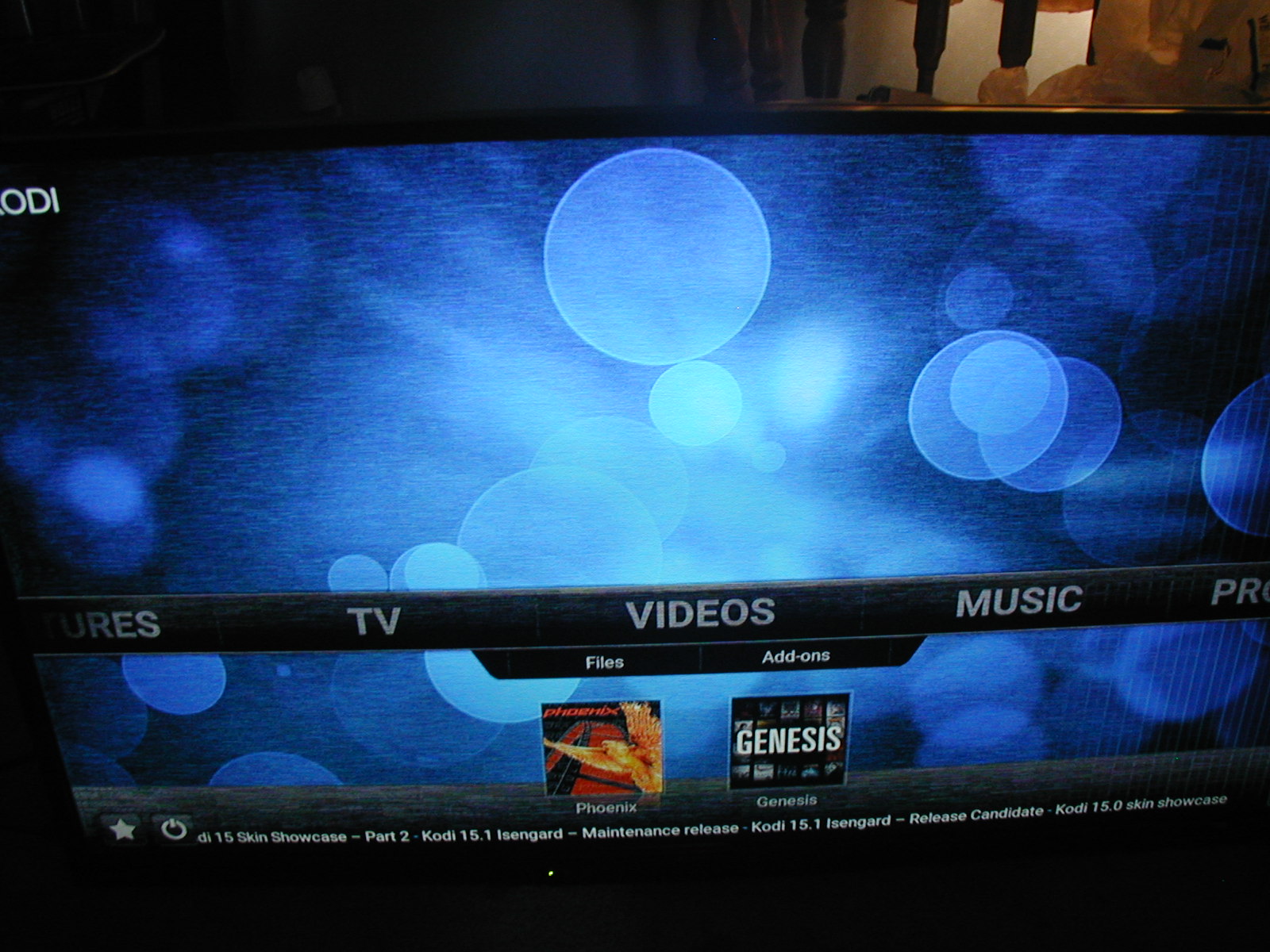

    Hi, like to get some advice. I have a snowy like picture on all inputs and tv driven menu's. The blue screen has no noise when a non used HDMI is selected. I bought a main board and was worse than the one I had so now I am not sure.
    I read somewhere if just the inputs were noisy and menu was good its a mainboard, but if both menu and inputs were bad it could be the Tcon board. Don't know if that is true or not. Thanks

      This is a pic, you can see the noise. Even when it boots up you can see snow in the big red letters that say SHARP

        I guess your Sharp isn't that SHARP anymore! try a new tcon

              Yep looks like a tcon issue to me too
              The dead giveaway is the lines that are forming on the right side of the screen going vertically you can barely see them but they're there

                Thanks, yes I was thinking the same thing with the lines.

                  T-Con fixed it.
