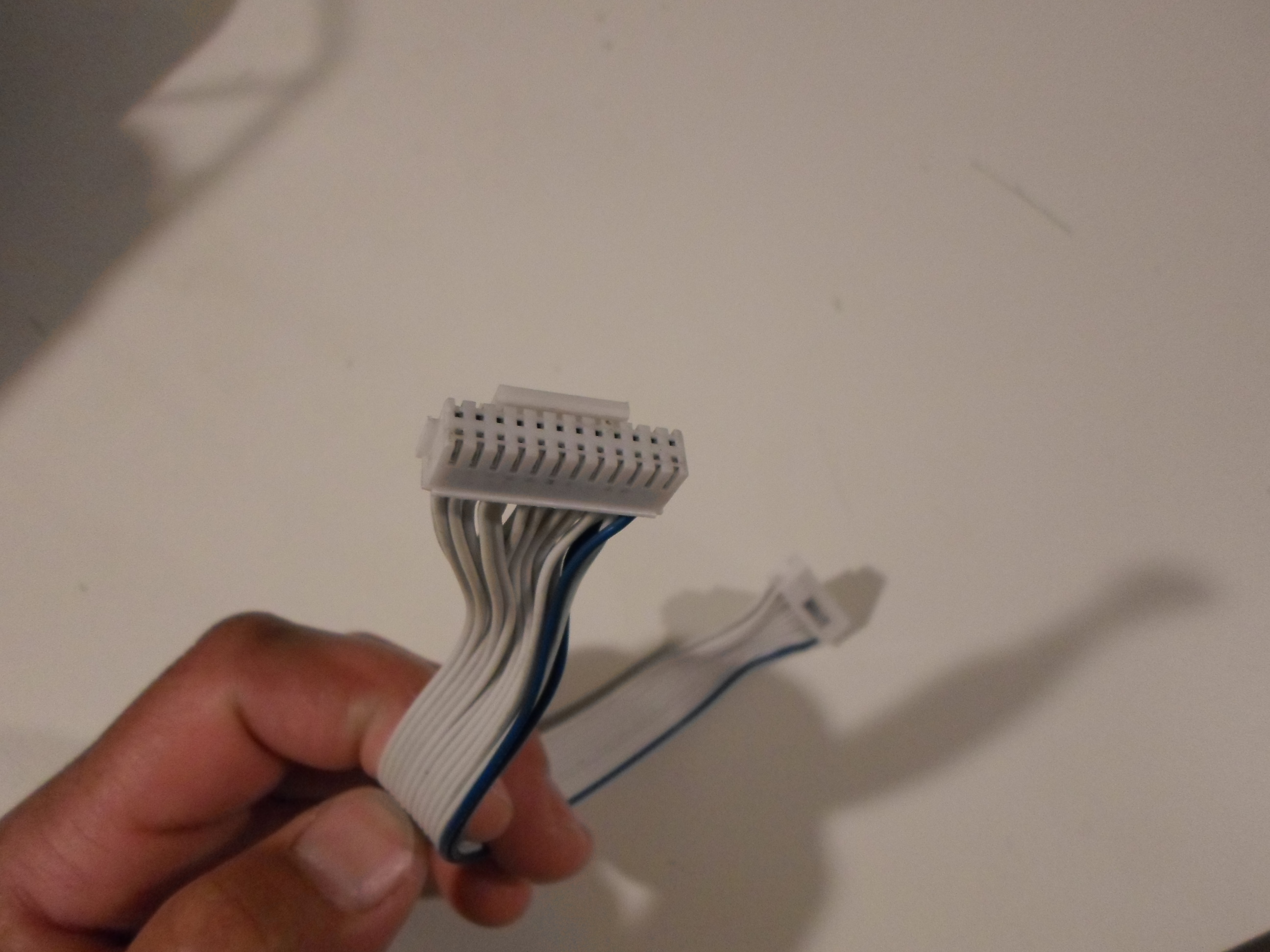

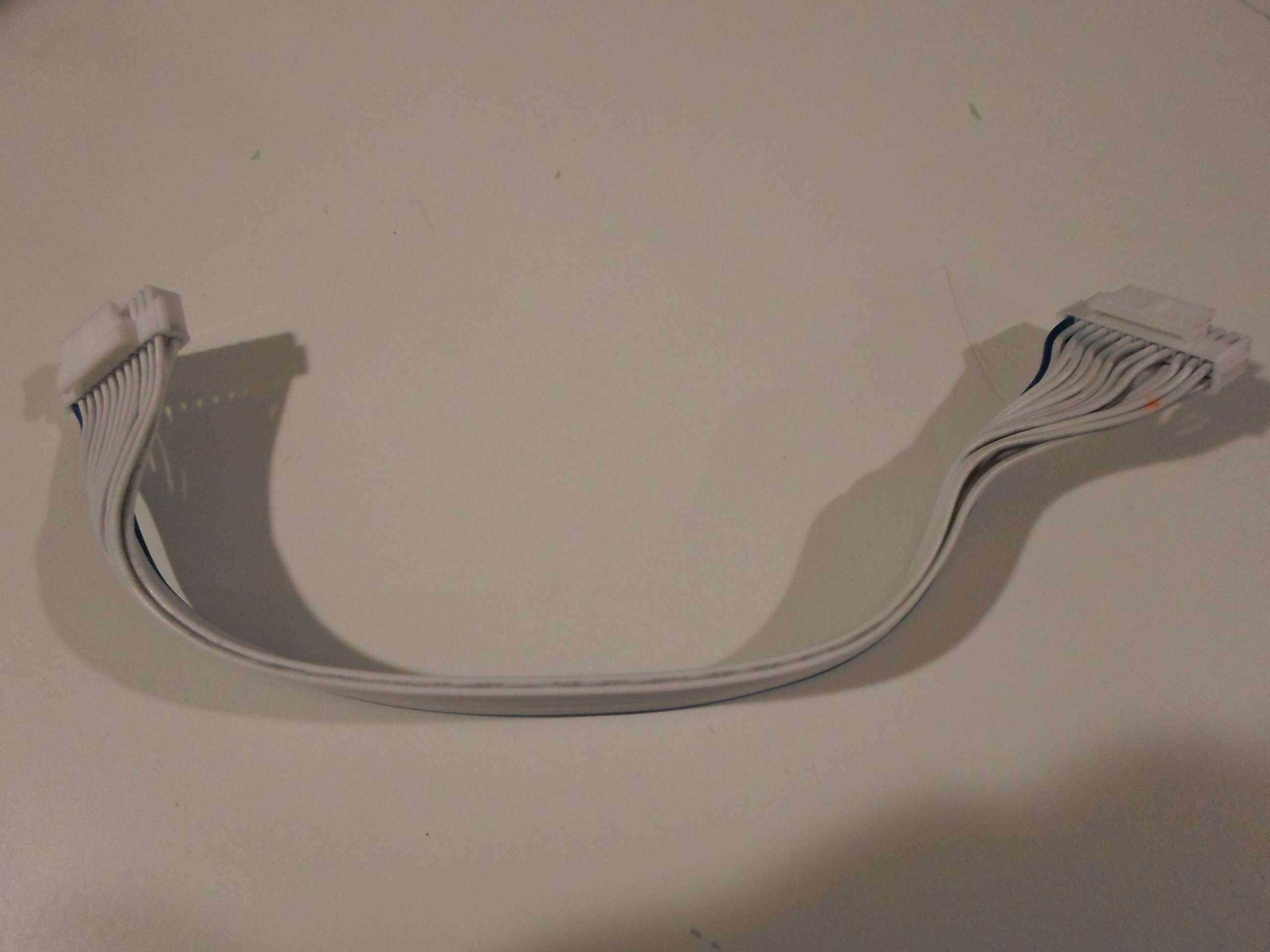

Need help finding part # for this wiring harness from LN46A500T1FXZA and many others.
  • kevinm34232
    • May 2012
    • 1884
    This wire set goes from PS board to main board, used in many different Samsung models with power boards like BN44-00200A, BN44-00202A, etc.
    Another popular model is LN46A550P3FXZA. Trying to find the part # rather than searching for model #s, if any help would be appreciated or if you have any please let me know as well, thanks!

      Re: Need help finding part # for this wiring harness from LN46A500T1FXZA and many oth
      I might have the cable. Just chopped 60 tvs up this week for parts and scrap. Let me know how many pins and the length. I will dig through the scrap wire bin and post some pics. You can pick which one you want for postage cost...
      • kevinm34232
        • May 2012
        • 1884
        That's it thanks! Looks like BN39-00802F. It's 24pins, 2 rows of 12.
