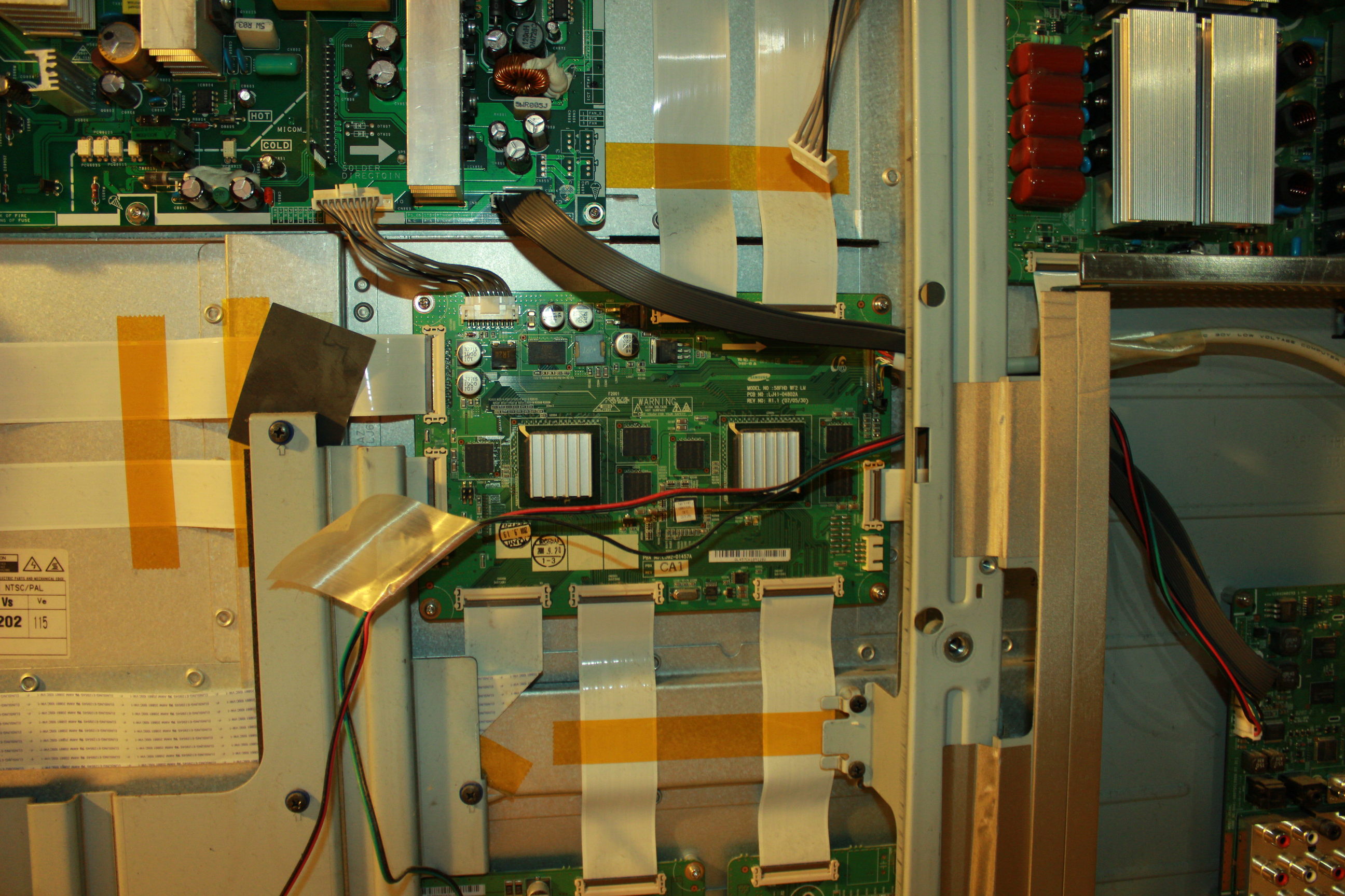

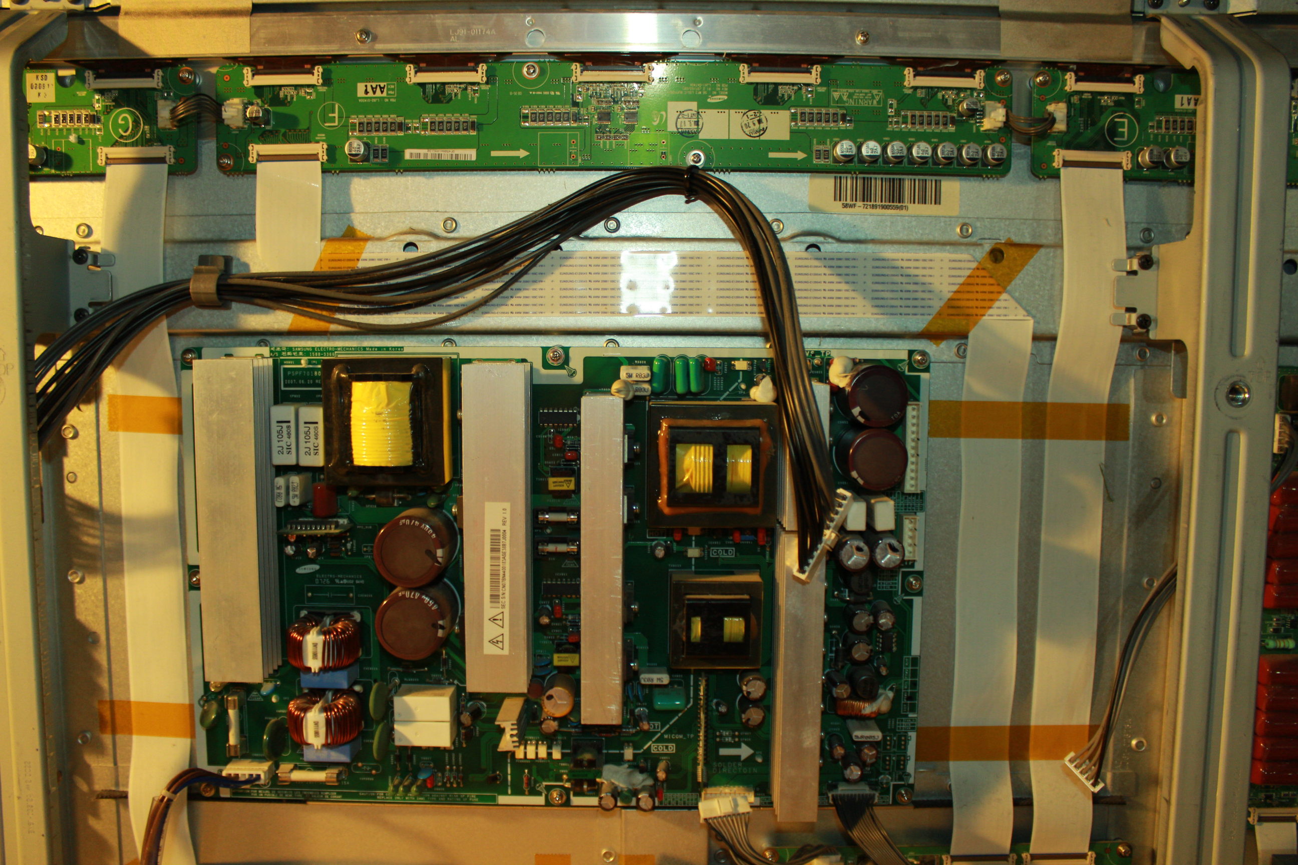

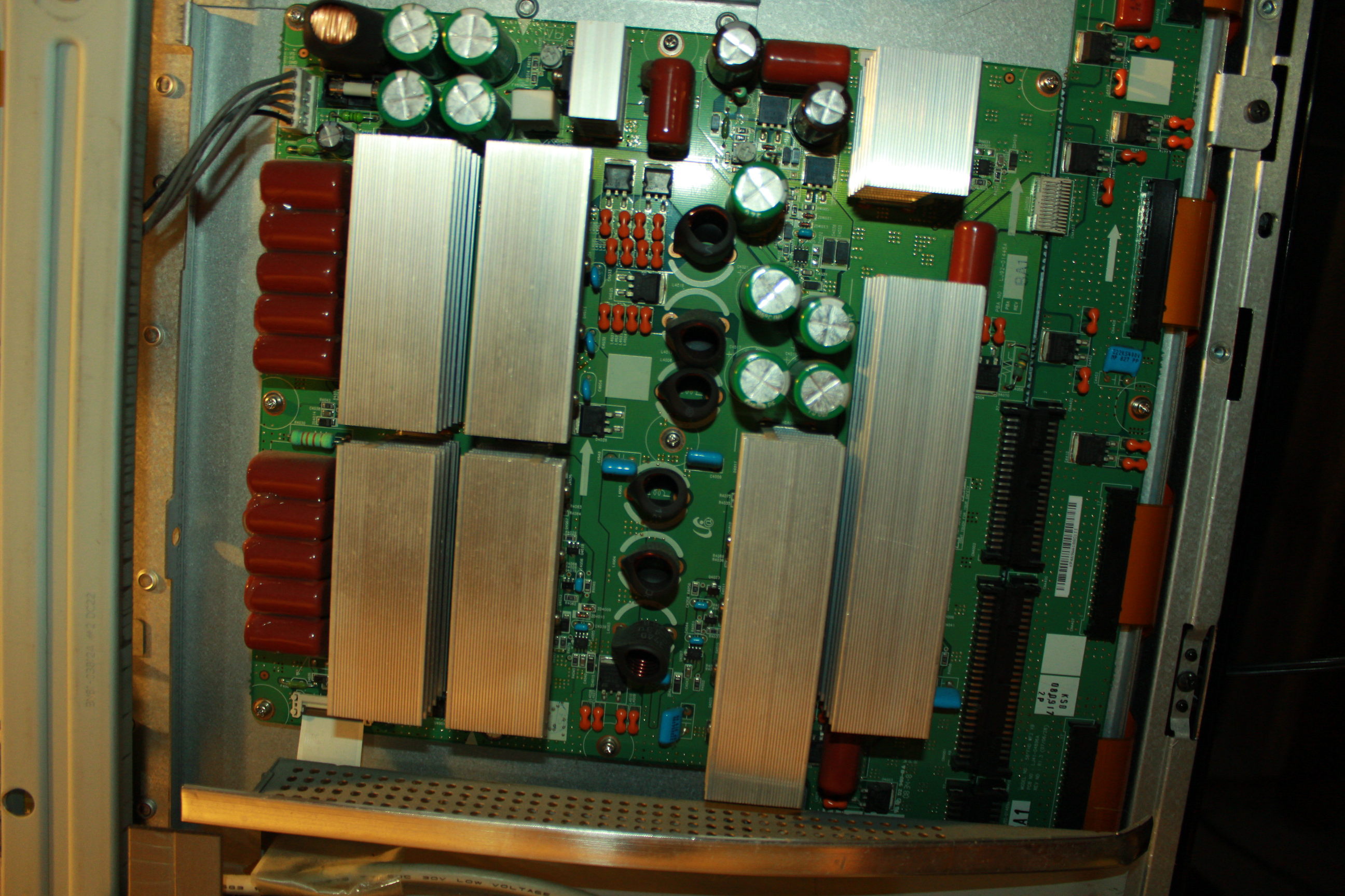

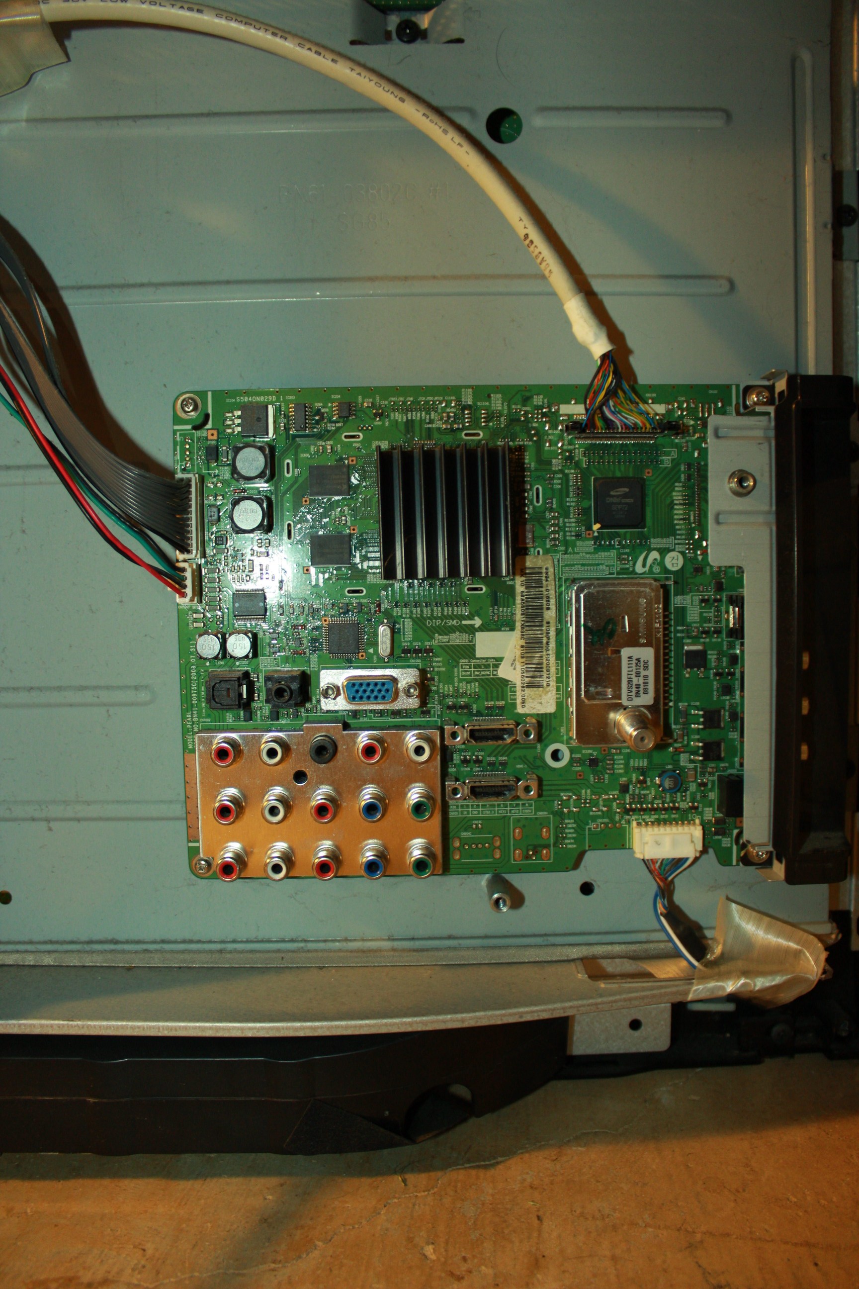

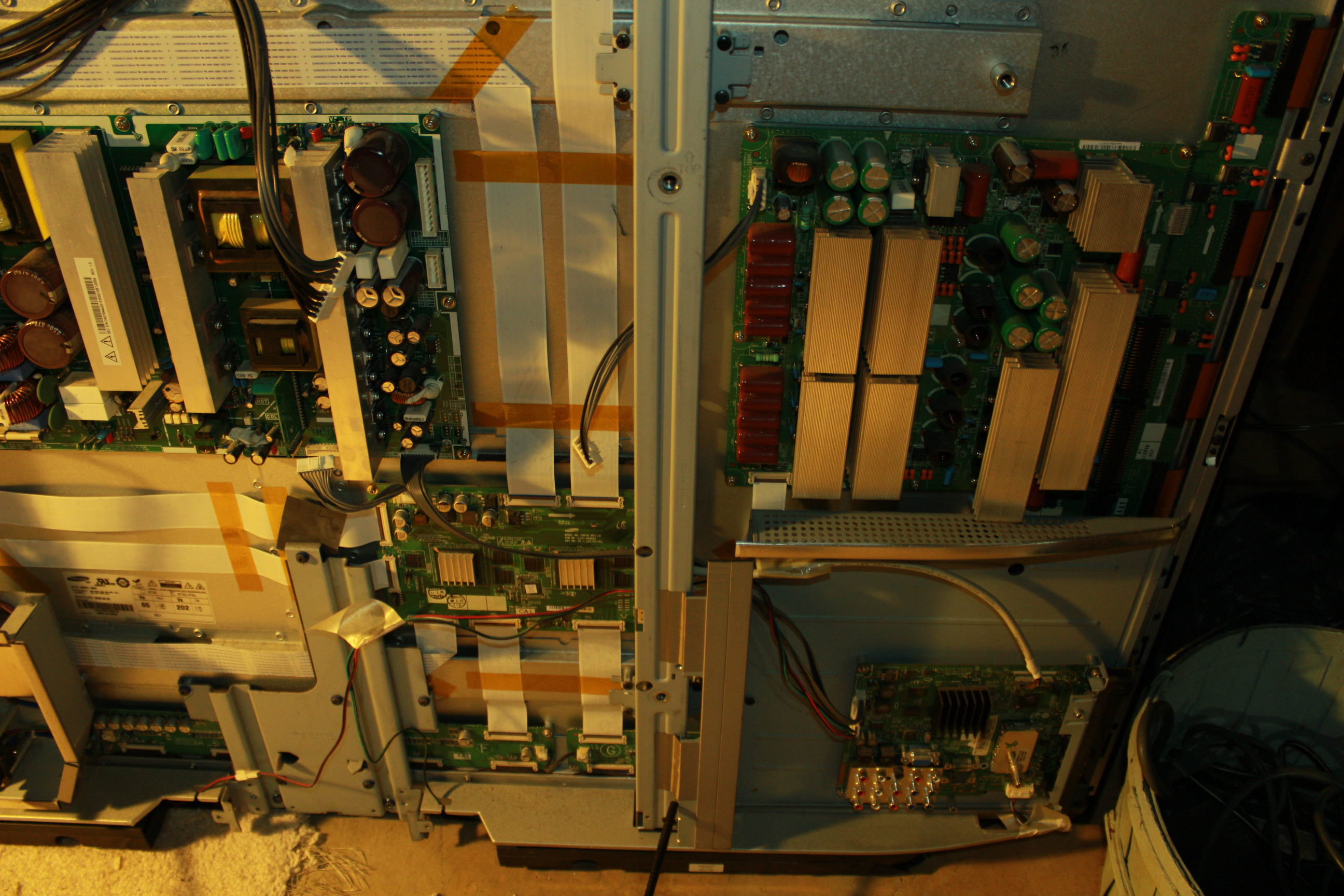

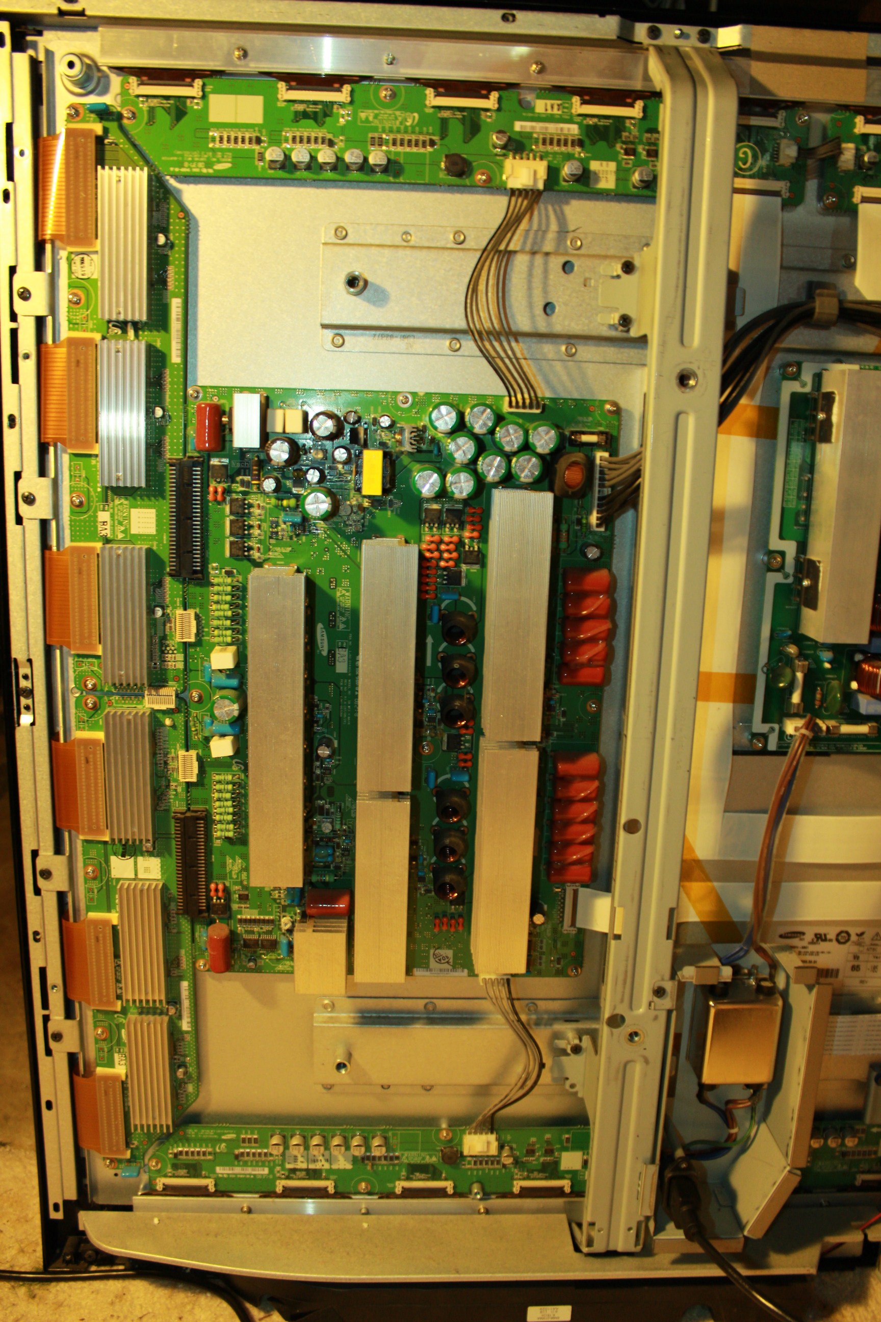

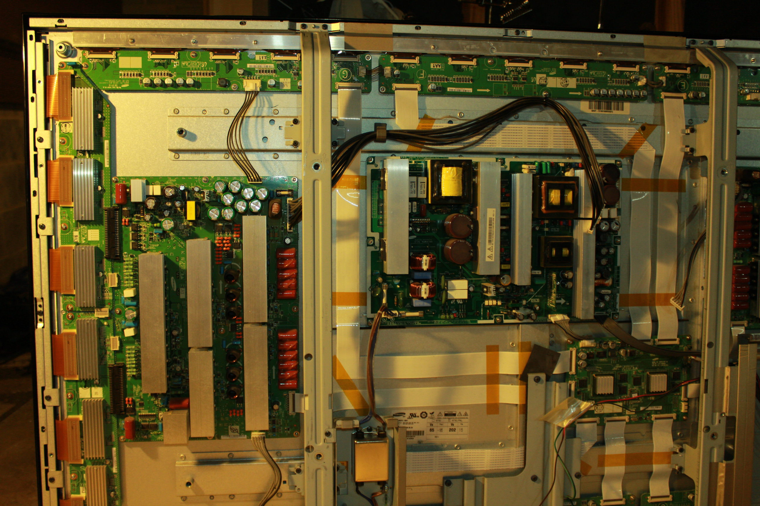

    OK so i received this broken beast after the people didn't want to pay for the power board which was defiantly one of the issues..* it would just do this humming noise over and over no voltages where right at all.* I have someone who wants to take it off my hand but wants me to fix it too. So first thing i did was get the power board. Put that in and here's where i'm at. 1. with everything Ysus, X, mainboard, and logic plugged in It clicks and I see the green light on the logic for a split second as the power board click and it goes out again it does this either 3 or 4 times before it stops completely and i have to pull the plug. 2. If i remove the Y, and X power cables with the logic and main still plugged in.. exact same thing.. 3. If i keep everything unplugged besides main board i *only sometimes* get to hear the chime but it constantly resets itself over and over.
    Thanks ahead of time for the help that i can get.

    Re: pn58a550s1fxza weird issue
    Posting pictures of the back of your tv showing the boards with clear pictures may help you more with fixing your problem
      sure .. here we go...
        had an interesting startup.. I tried to get it to boot up again after waiting a hour or so.. i finally got it to boot again with just the main board plugged .. after i had it booted i plugged in the logic board to see if it would kick it off I got two blinking leds *the right one and the left bottem led* they both blink simultaneously. i'm gonna post youtube to links to what it is doing in a little
              You need a new mainboard
