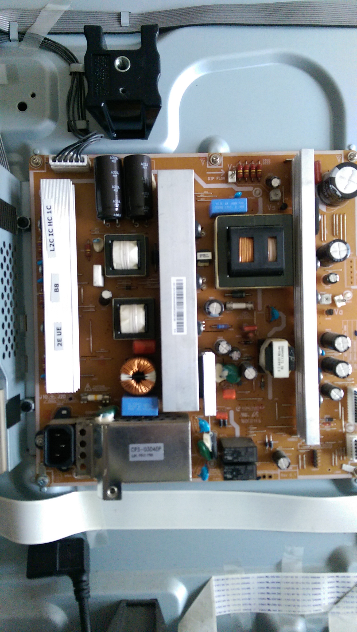

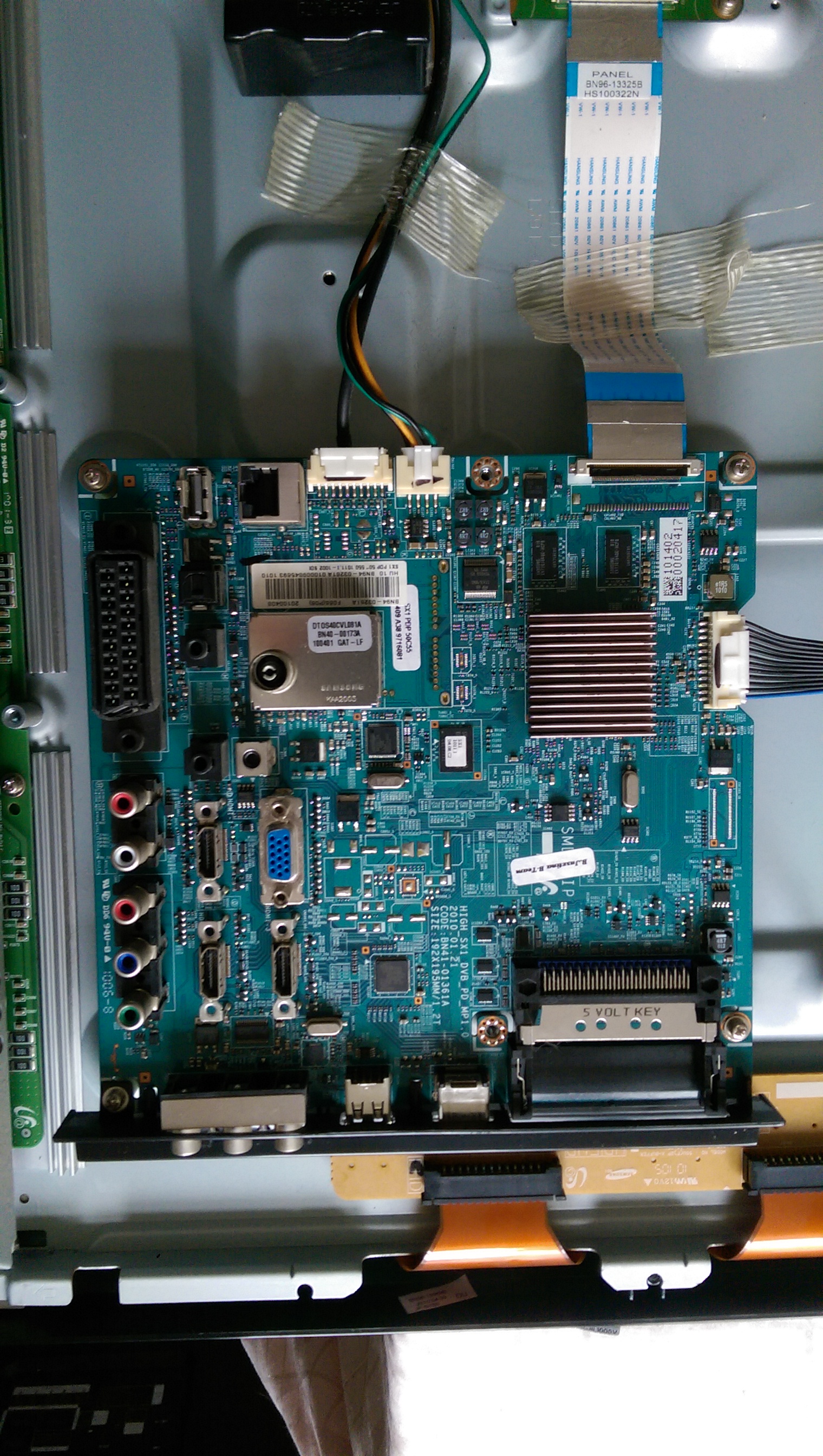

    Re: PS50C550 sound but no picture.

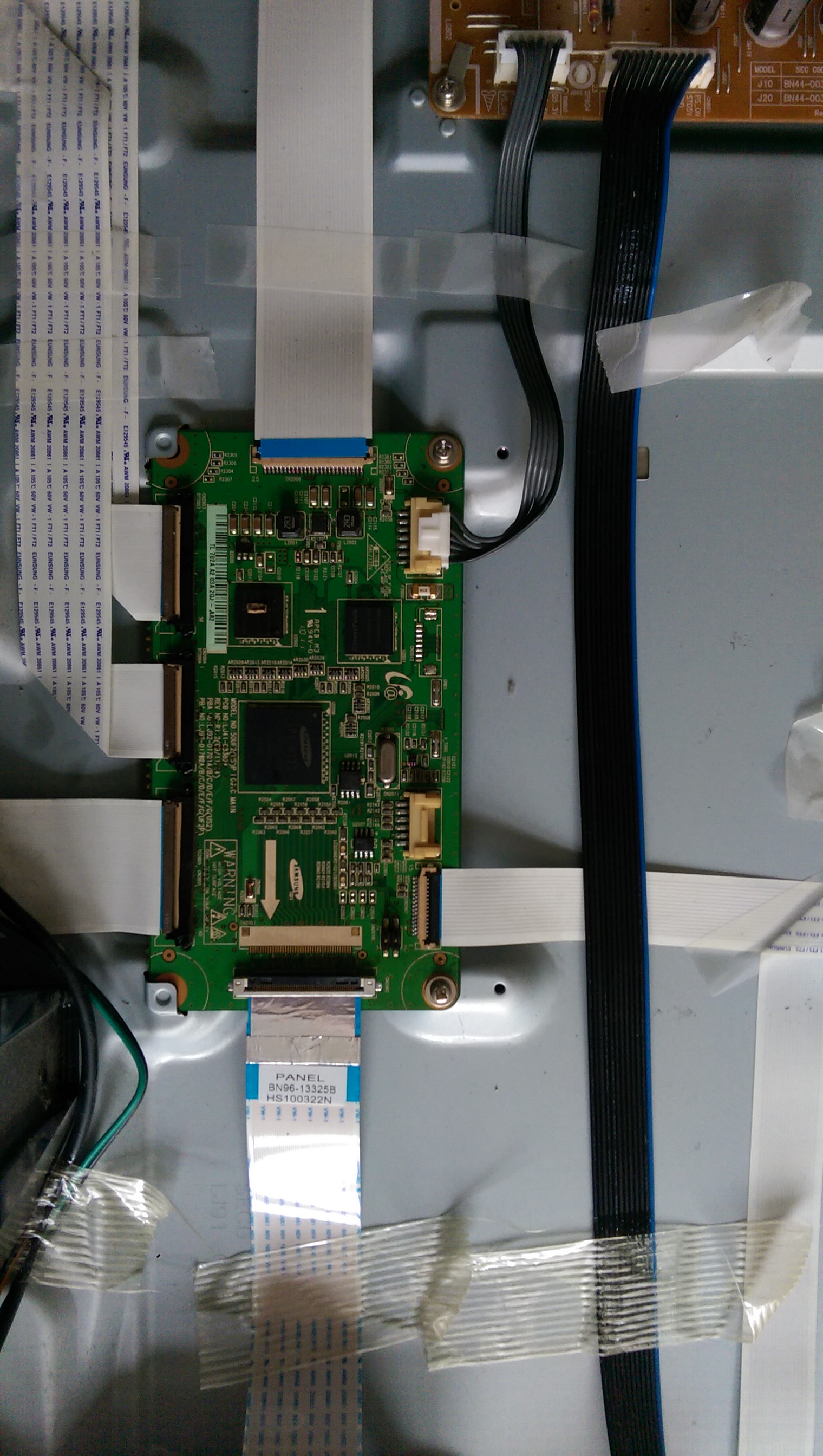

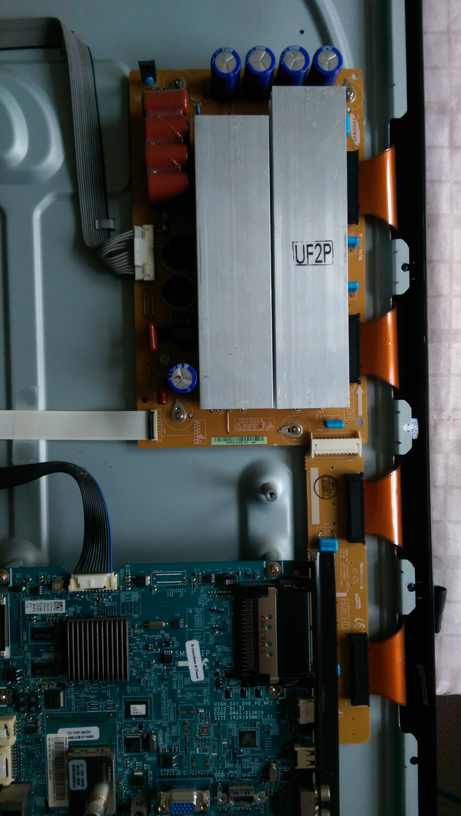

    Posting pictures of the back of your tv showing the boards with clear pictures may help you more with fixing your problem
    • niblettr
      • Jun 2015
      • 98
      yeah, sorry. see attached. Its a Samsung.

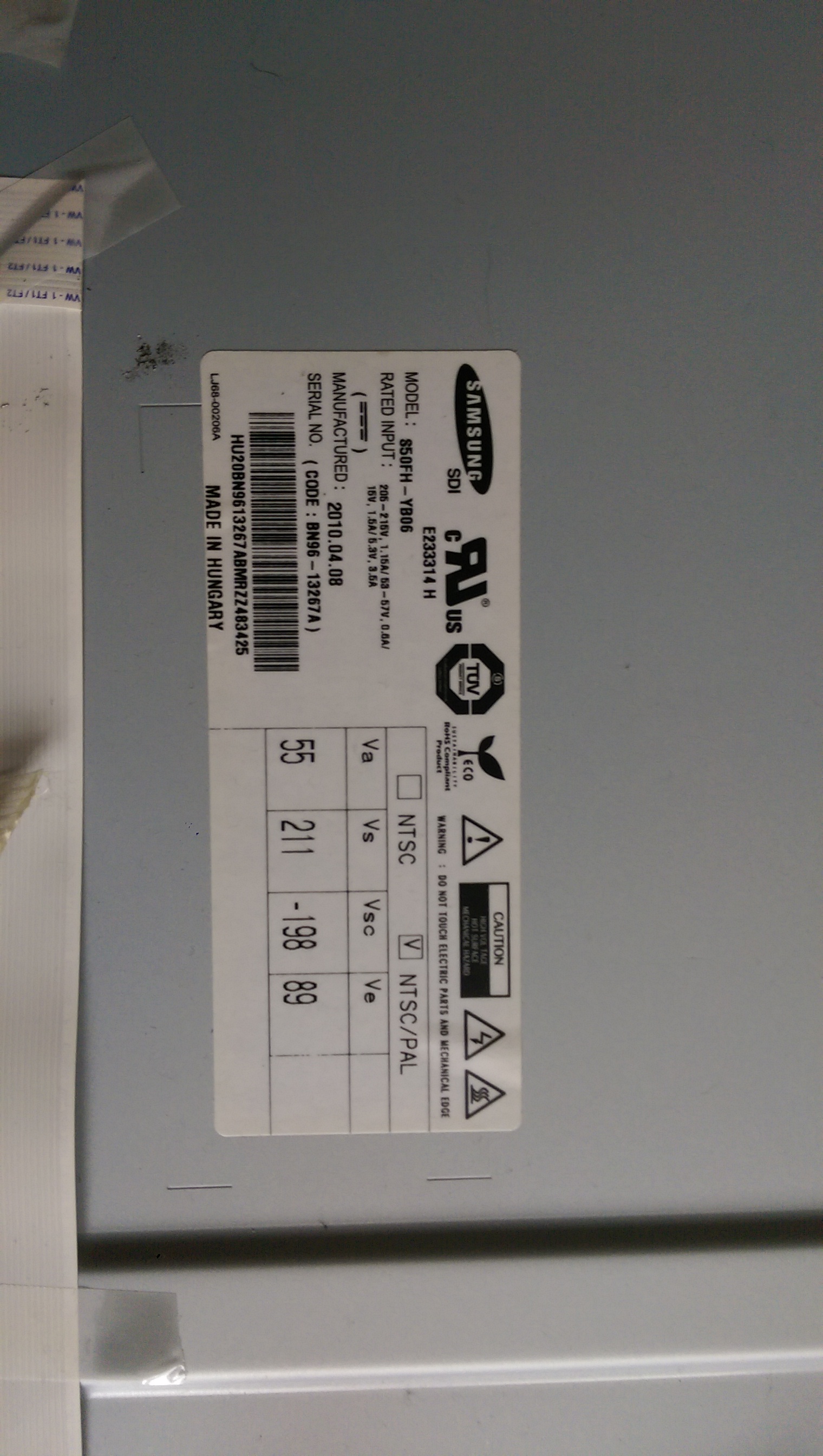

        On powering up, Vs reaches 210V, Va reaches 55v then drops quickly back down to 0.
        If I disconnect the ribbon cable from Tcon to Ysus and cycle the power to the panel, VS stays at 210V, Va stays at 55V. Vsc also measures -199V.

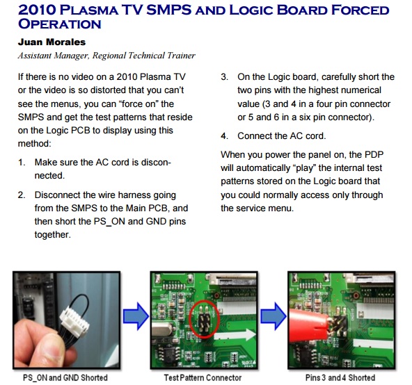

          Also, how does one bring up the test pattern? I have another Samsung tv that kinda works (vertical lines which there is nothing you can do about it.) and I tried every combination of jumper settings on the Tcon board but cant get the test pattern with LVDS cable disconnected.
          • niblettr
            • Jun 2015
            • 98
            Anyone? Ok, I managed to get test pattern on another samsung. (It worked all along I just didnt wait long enough for it to kick in.)
                  I'd jump the power supply on without the mainboard connected.
                  Then try test patterns again.
                  • Hamie
                    • Apr 2014
                    • 1383
                    I can't see the legend table in your pictures on the power supply.
                    Usually it would need jumped:
                    ps-on to ground.
                    and
                    vs-on to 5v stand by.
                    • niblettr
                      • Jun 2015
                      • 98
                      Ok, will give a shot.
                      See attached, is that what you mean?

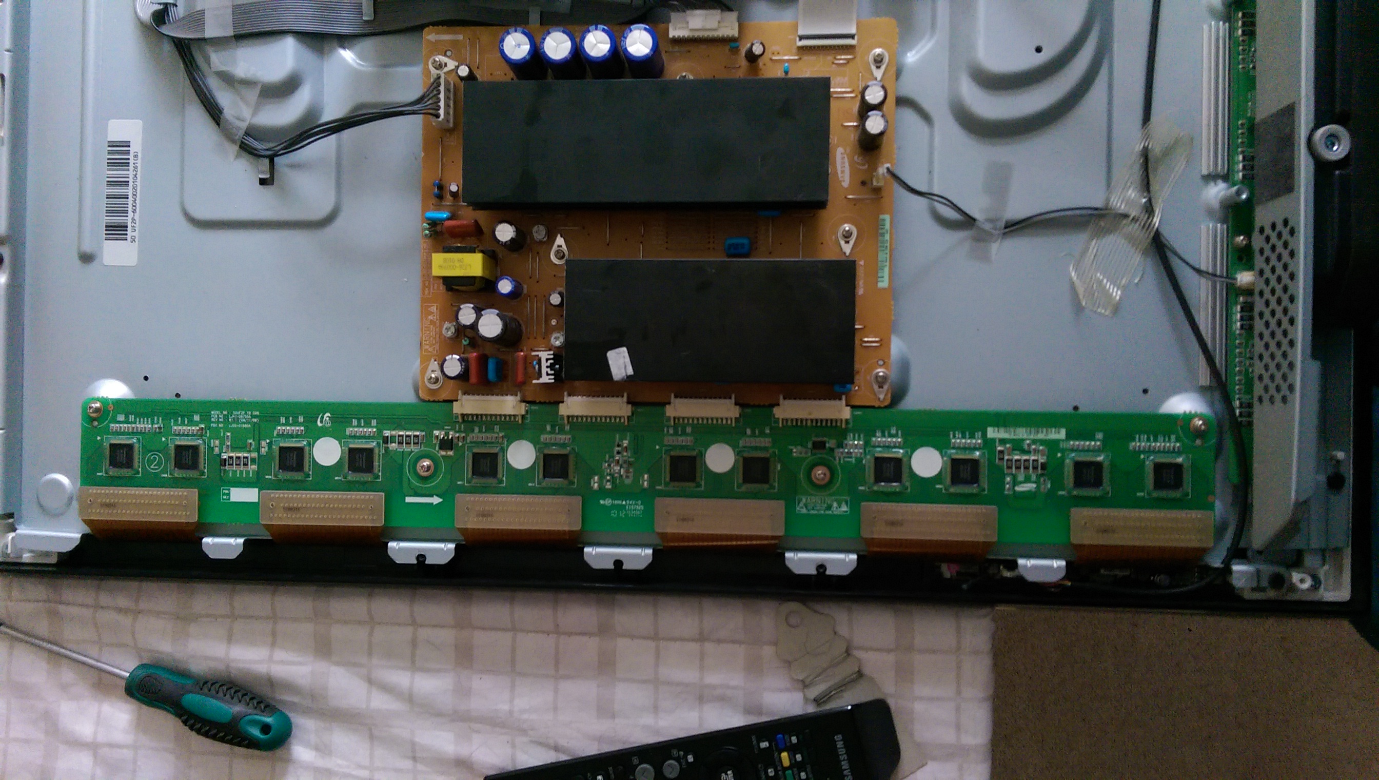

                        There's a problem with the Y-SUS or Buffers.
                        Cable from Control-Board (No 'T-Con' on a PLASMA) Isnt called LVDS. Its just a cable. LVDS goes from M.B. to Cont board.

                          Tried but still same result.

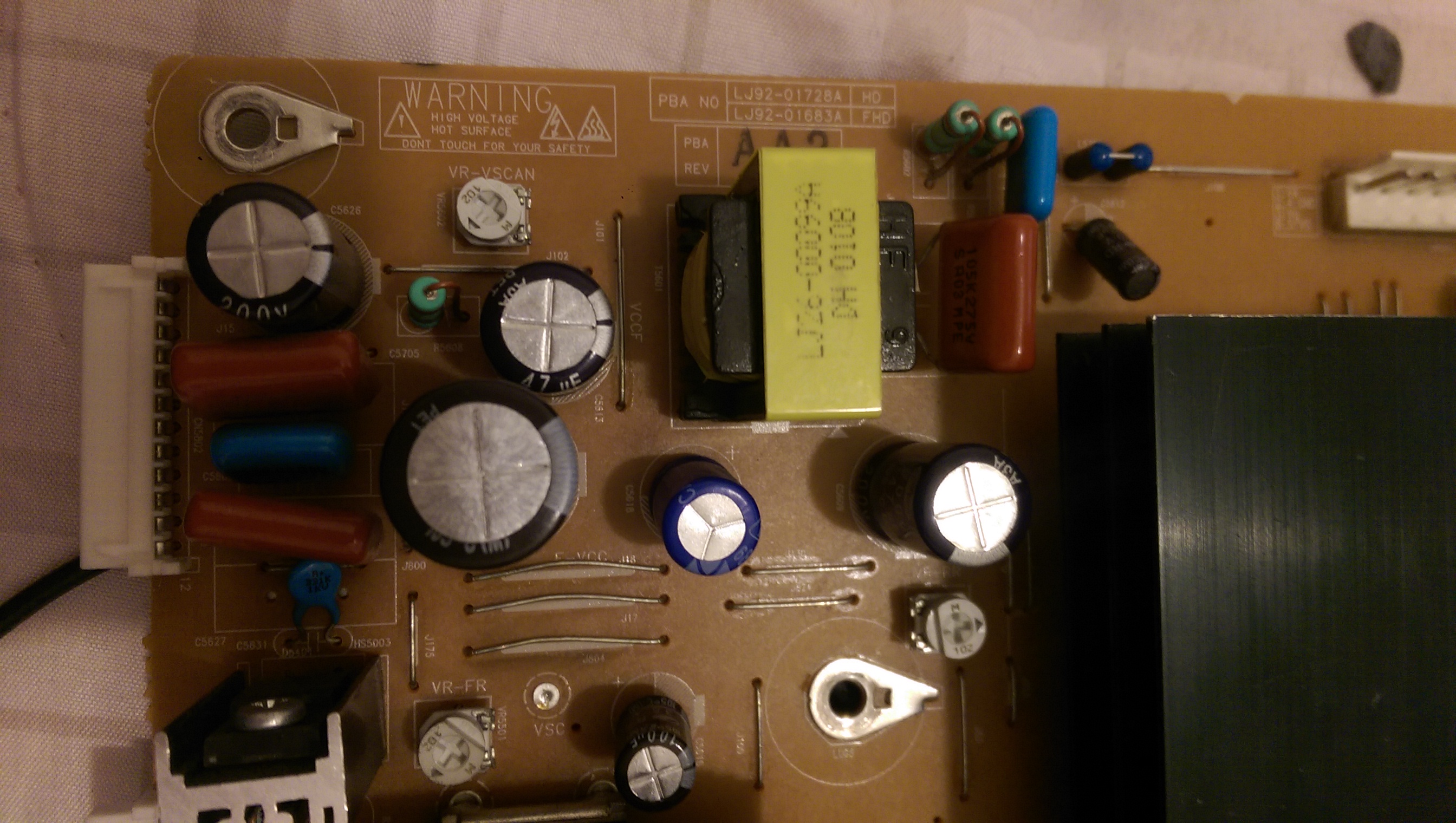

                          I put the resistors back on the control board and the unit powers up with fault detected as before.
                          The fault obviously lies on the Ysus because I get that same condition with everything else unplugged.
                          Tried tracing the fault line on the board to see what drives it but its very confusing at the moment.

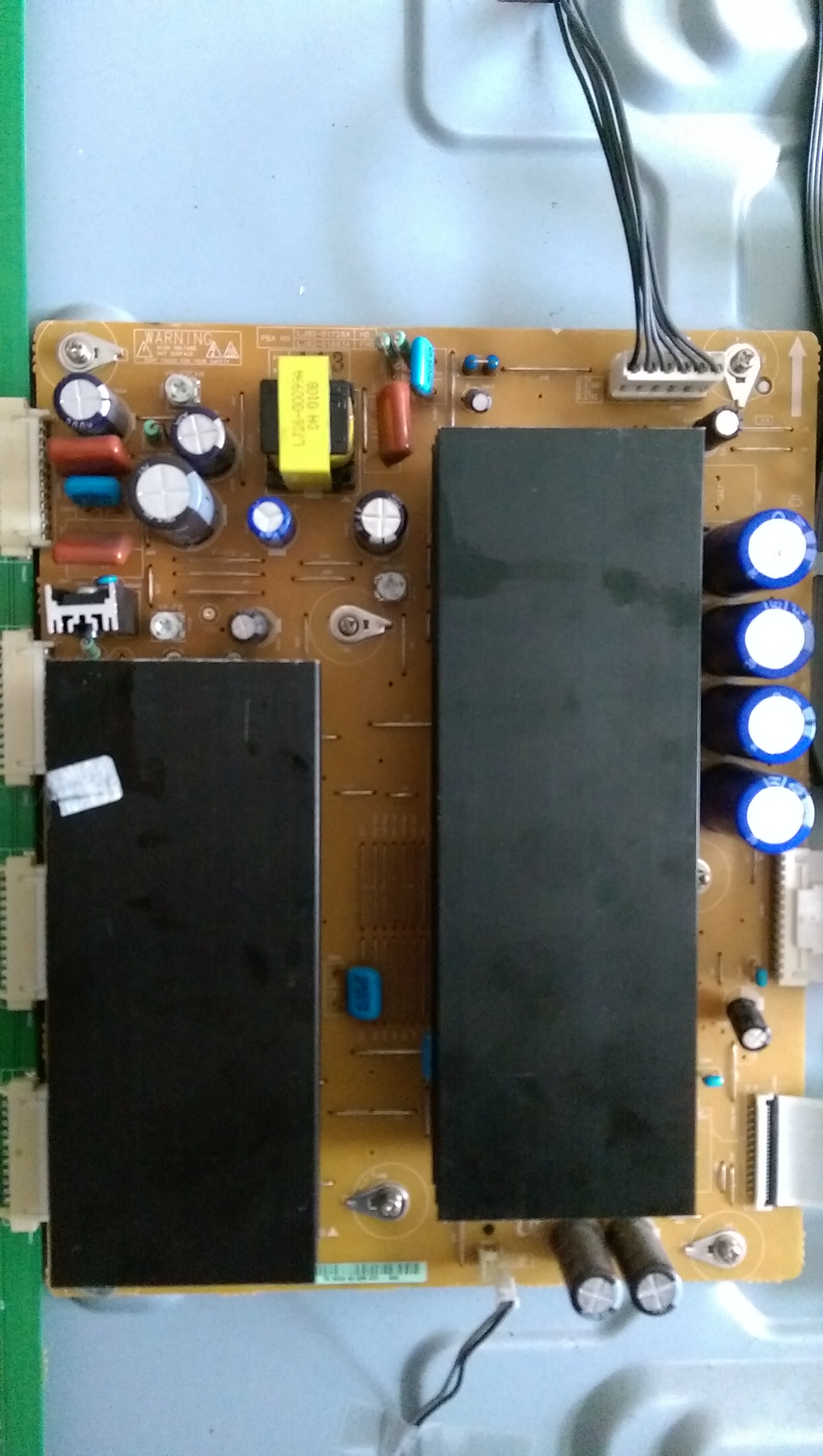

                          Also, there is a transformer on the Ysus that gets very hot but voltages that it is producing look good (i think) -ve large value?

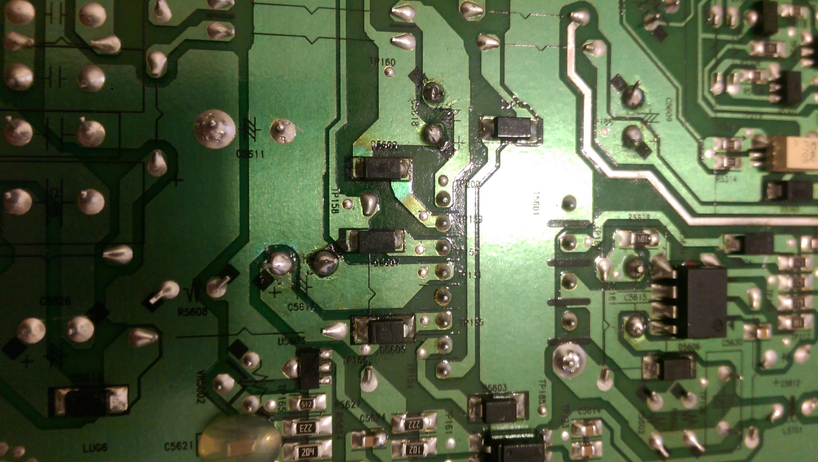

                          • niblettr
                            • Jun 2015
                            • 98
                            In the attached is the transformer I mean. Also you can see on the opposite side of the board you will notice localises heating around one of the diodes near the transformer. Diode still measures fine btw. I also replaced the eletrolytic capacitors around that area.

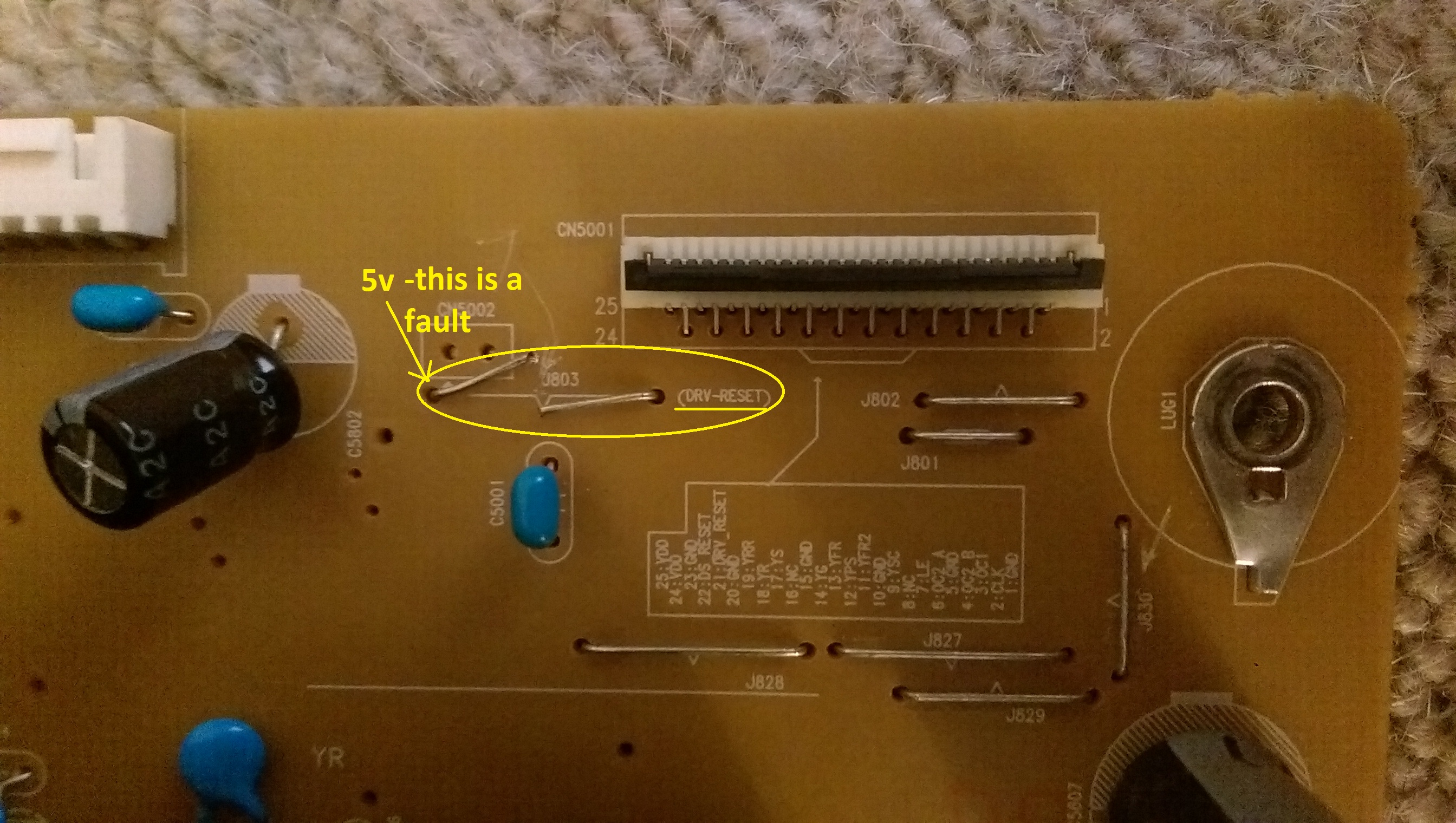

                              Attached is now how I achieve proper power up.
                              What happens is that DRV reset it driven high by a fault, the control board detects DRV RESET and asserts DS Error high.
                              DS ERROR drives output enable of octal buffer that interfaces control board ribbon to Ysus. So in effect DS ERROR disable signals from control board.
                              Struggling to understand what drives the DRV RESET line.
                              I'll post some pictures of the PCB traces showing DRV reset.
                              • niblettr
                                • Jun 2015
                                • 98

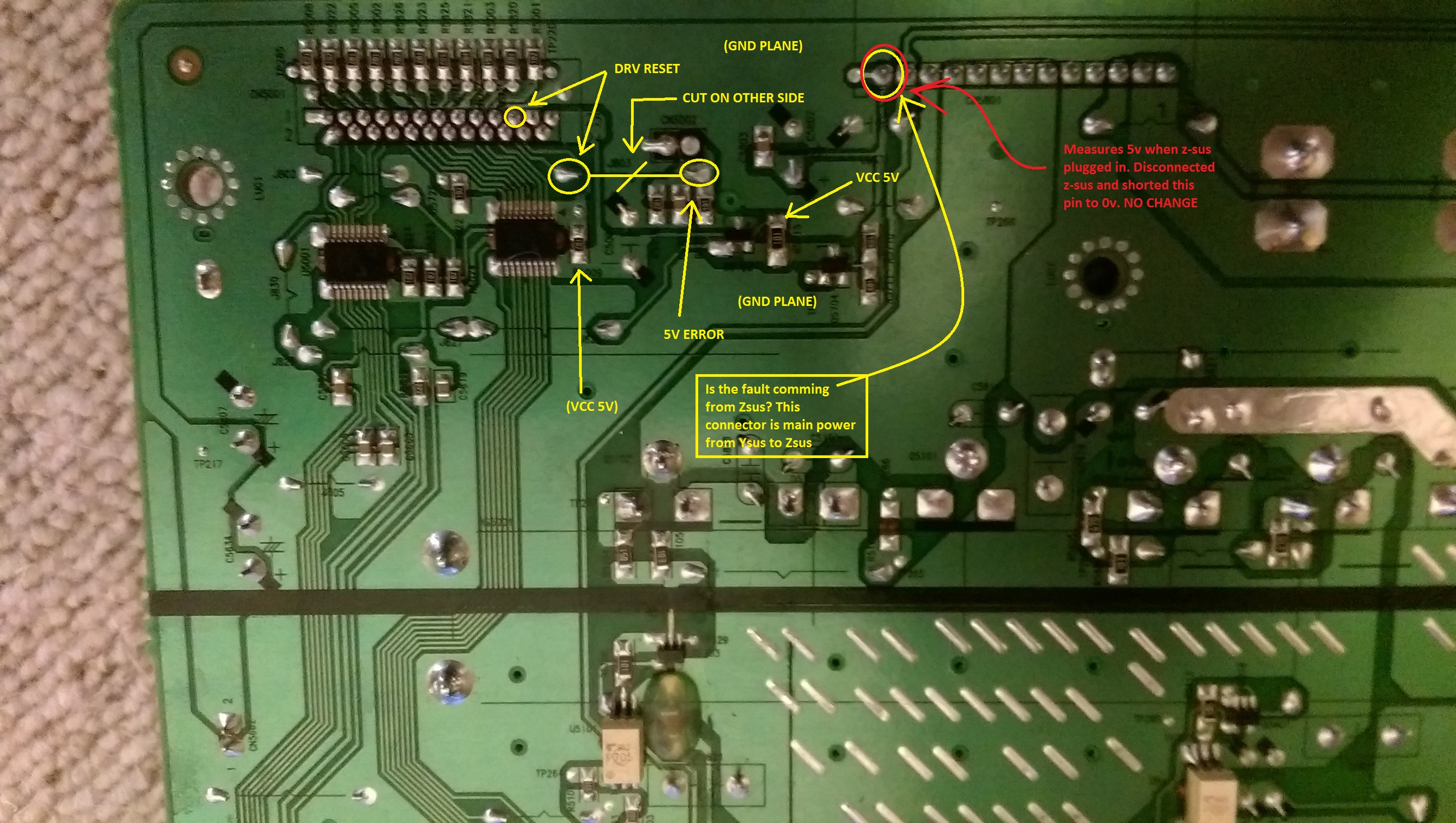

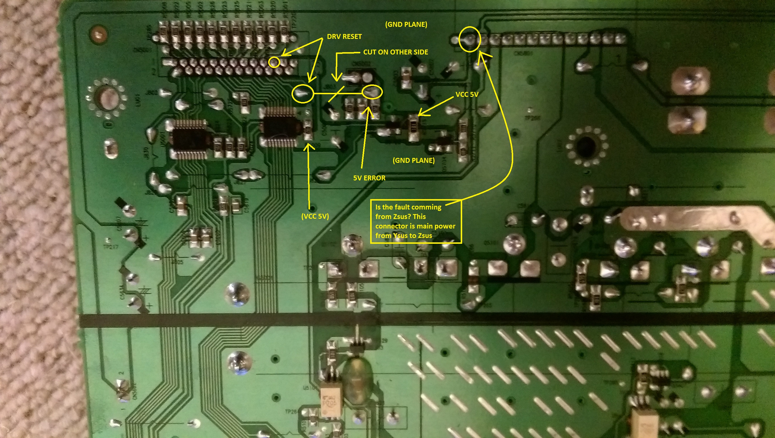

                                see attached traces of back of pcb with highlighted labels
                                • niblettr
                                  • Jun 2015
                                  • 98
                                  See more notes highlighted in red in attachment.
                                  • niblettr
                                    • Jun 2015
                                    • 98
                                    Does anybody know what error Does DRV_error detect?
