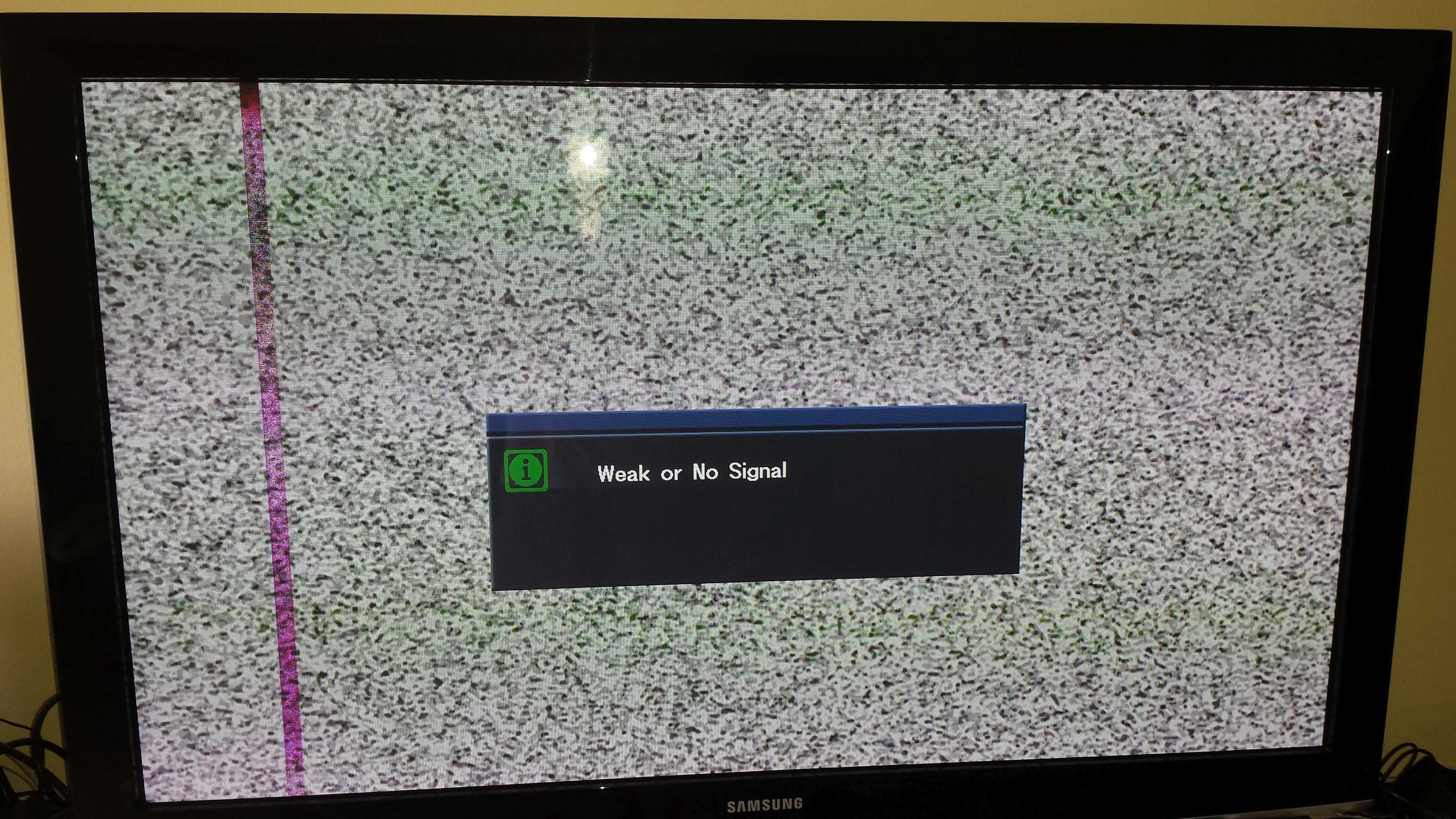

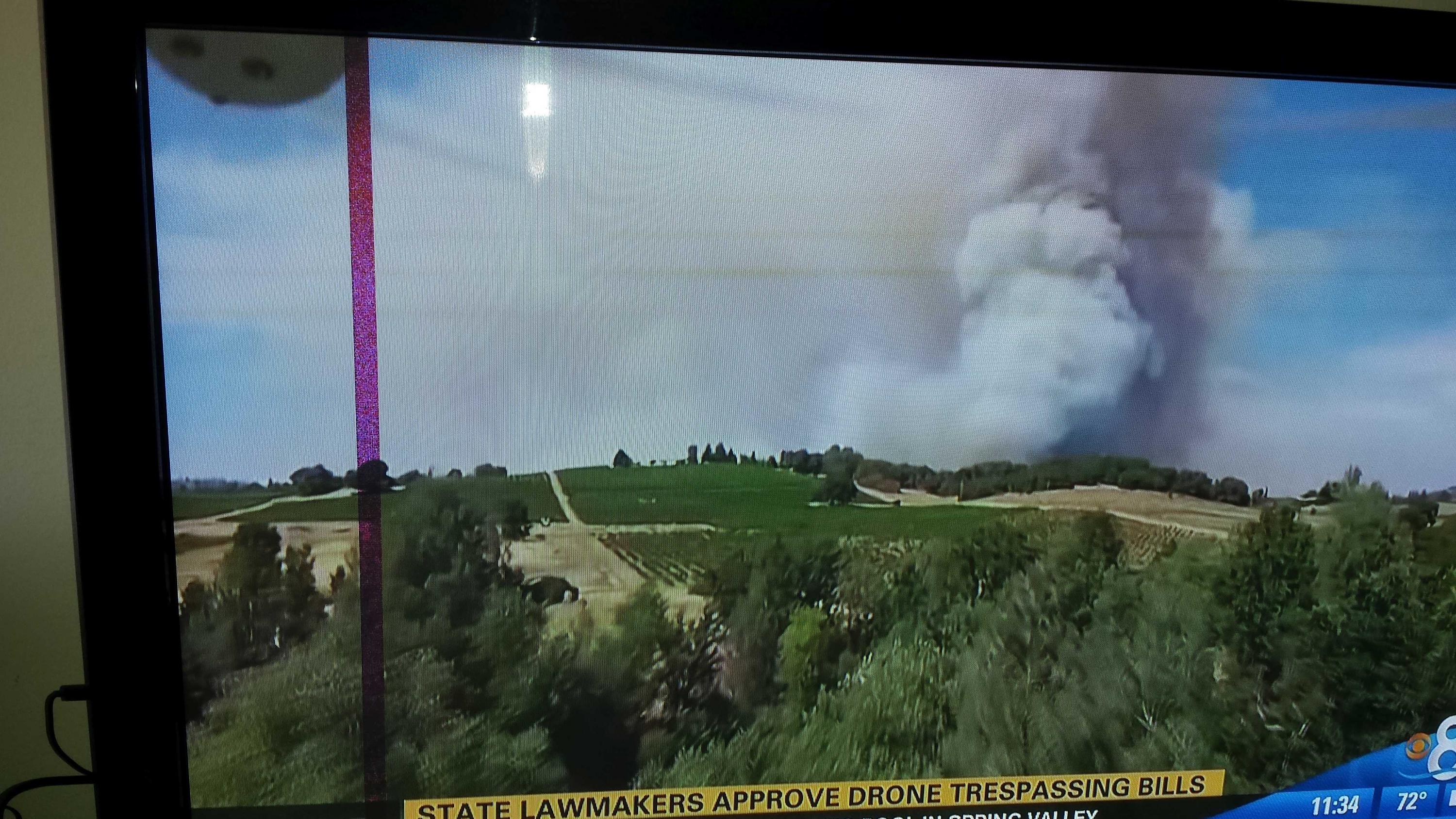

    Samsung PN50A450P1DXZA - red vertical line
    My Samsung 50 inch Model PN50A450P1DXZA started showing a vertical red line on the left side of the screen a few days ago.
    Has anyone experienced the same issue? I have seen another thread where someone had a problem with a black vertical line within the middle of the screen, but my case seem to be a little different. Any help is appreciated.
    Also,
    Is there a way to tell how many 'TV-hours' has been used? I heard that this can be shown in the 'service menu', but all combinations that I have tried so far will not let me get into this menu.
    Thank you very much.
  • ReeceyBurger123
    Never Give Up !
    • May 2014
    • 7325
    • Britain
    Re: Samsung PN50A450P1DXZA - red vertical line
    Hi unfortunately thats a failed panel and it wont be fixable sorry.
