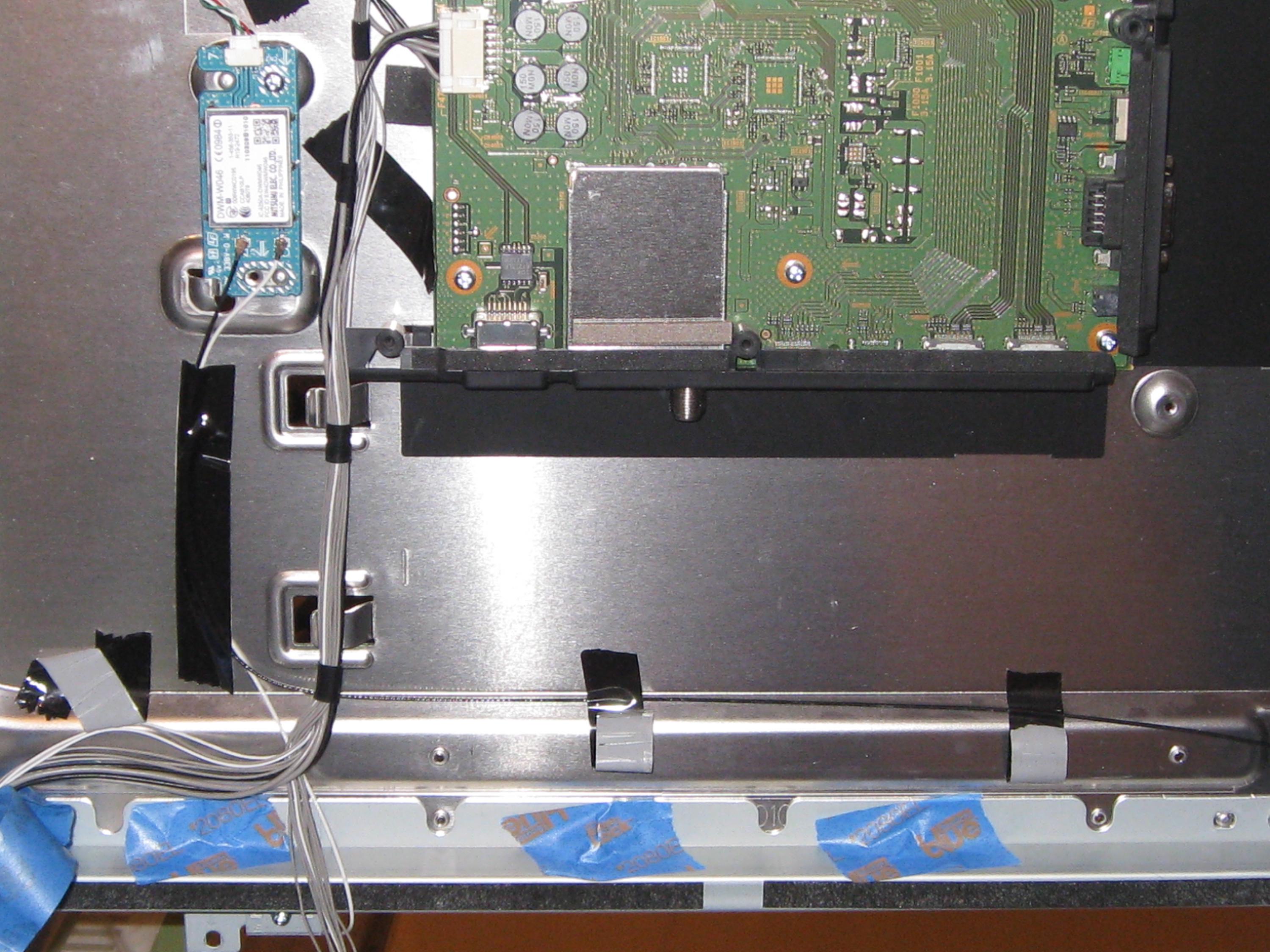

    Sony KDL60NX720 when turned on had a dark spot on top of the screen, then would turn off and blink red light 4 times
    Bad LED strip? That's what I thought. Took apart. It has 4 LED cables plugging into the LED board, I was going to swap two cables to confirm but I could not get the cables off
    Then decided to take two led strips off the front and swap the connections at the other end but they do not have connectors, they are ribbon connected
    Before I took it apart it would come on a few seconds then turn off, had a dark spot
    When I powered it up when first disassembled it showed the same issue but I had the press the power button a few times, each time I did I would see the bottom leds dimly light for a nano second then go off, then the third press of the power button the LEDs came on for a second, except the dark spot, then turned off (the dim area was part of a strip not all of it, I see no brown spots on the LEDs)
    Now when I do the same test, the first two times the leds on bottom dim for a nano second, then on the third try ALL (even the dark area) the leds come on for a nano second then turn off. When they all came on except the dark spot they were on a good 2 seconds, now when the ALL fire they last a nano second then turn off.
    I have to unplug the power each time to get it to work again.
    Is this the LED driver board the 4 leds wires go to or the board below (tcon I believe) that has a ribbon from the LED board going to it, then two ribbons out of the bottom of it to the LED screen?

      Re: TV LEDS come on a brief second, then off
      Yes I have it all apart now.
      I powered it now and after the 2nd or 3rd press of the power button all the LEDs flicker on one time only, then turn off. I do not have the front LED connected to see if I get the 4 red lights, I can go check if I need to. That as what it did before I took it apart.
      When I first took it apart and powered it on, after pressing the power button three times, I would get the same results as I did before I took it apart. All the lights except part of one strip came on for a couple seconds then turned off.
      So when the problem first happened, the lights would come on longer than they do now, now they just blink once, BUT now they all blink, before part of one LED strip would not light,.
      The lit LEDS are all the same brightness when on.
      When it tried to fire up the first couple times I see the bottom leds very faintly flicker, then the turn on the third time I press power.

            Sorry, the board that drives the screen at the bottom is covered by the stand it is currently on.
            The picture has never been a problem though just the backlight.

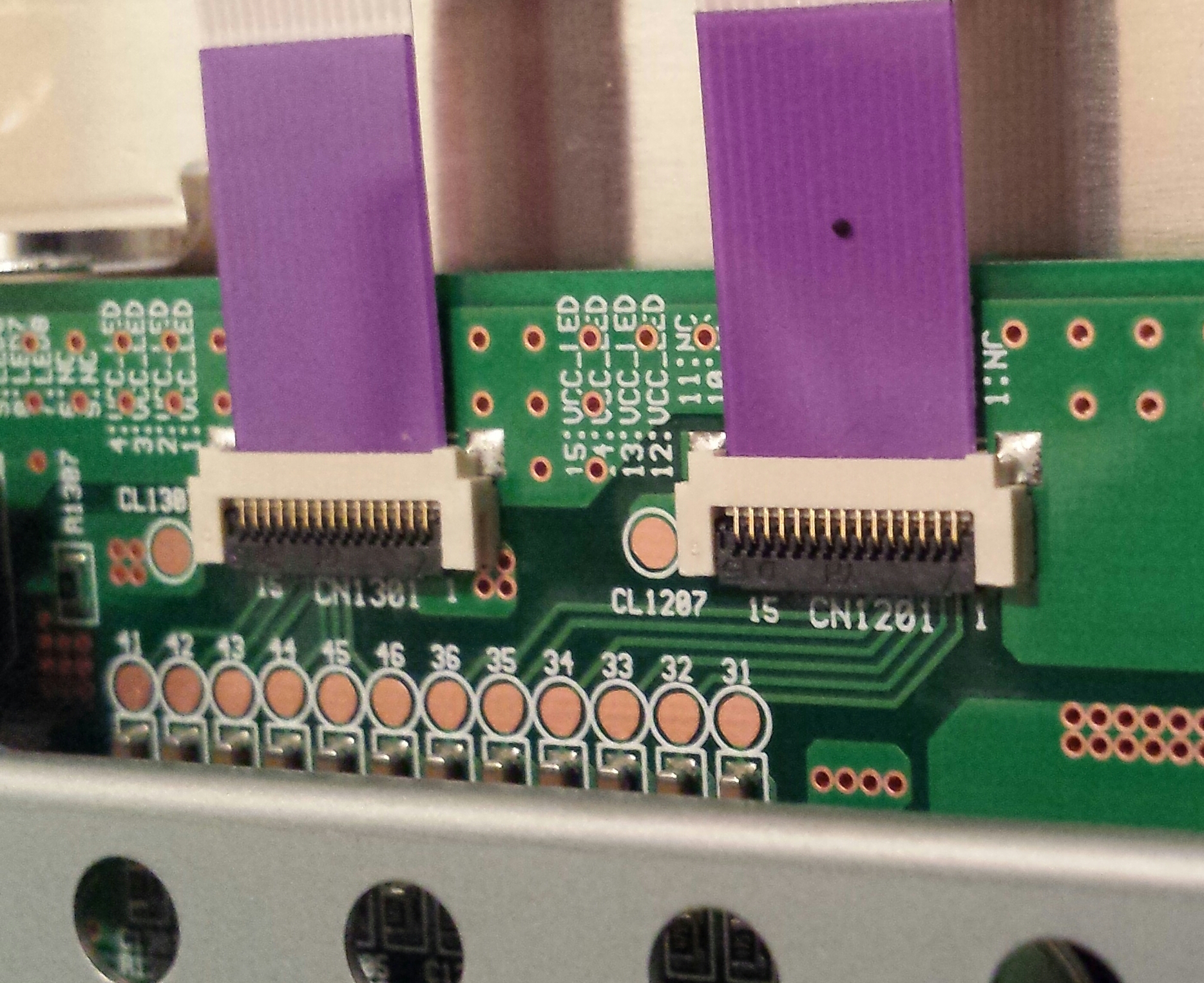

              On the secondary power supply I would suggest.
              Grounding BL_ERROR signal wire off of the connector cable.
              This will bypass the error signal
              And see how the picture is displayed.
              Will instantly show which is the offending led if you have and issue with it.
              It should be marked on the board BL_ERR I think.
              Just double check on the scematic and report back.
              etc..
                the connector I have cricled should be it ..

                  I see the bl_err wire on the connector you circled.
                  To confirm. You want me to jump a wire from this connector while it is still connected, correct?
                  Or do I disconnect it and then jump a wire from the wire connector to the TV frame?
                  The same bl_err connector is on the main power supply board also. That wire connects them together.
                    Disconect and ground it
                    Removed it from the connector plug where I have cricled.
                    And tape it to the back of the metal chasis and that will ground it.

                      I pulled out the bl_err wire from the connector you have circled, the one on the smaller power supply and taped it to the back of the tv metal frame
                      Nothing changed.
                      Press power and nothing
                      Press power again and the leds faintly light a nano second
                      Press power again and the leds (all of them) light 100% bright for a flicker then off
                      Press power again and nothing
                      I assume that grounded it. There is a black and white wire that appear to be screwed to the frame the way it was built, they come off a small circuit board that comes of the board that has the HDMI, etc connectors. Not saying this is wrong just stating what other wires are screwed to the frame.
                      Anyone has any ideas what I need to replace?
