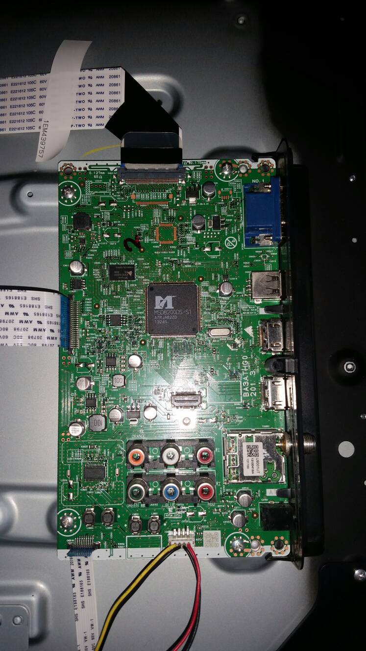

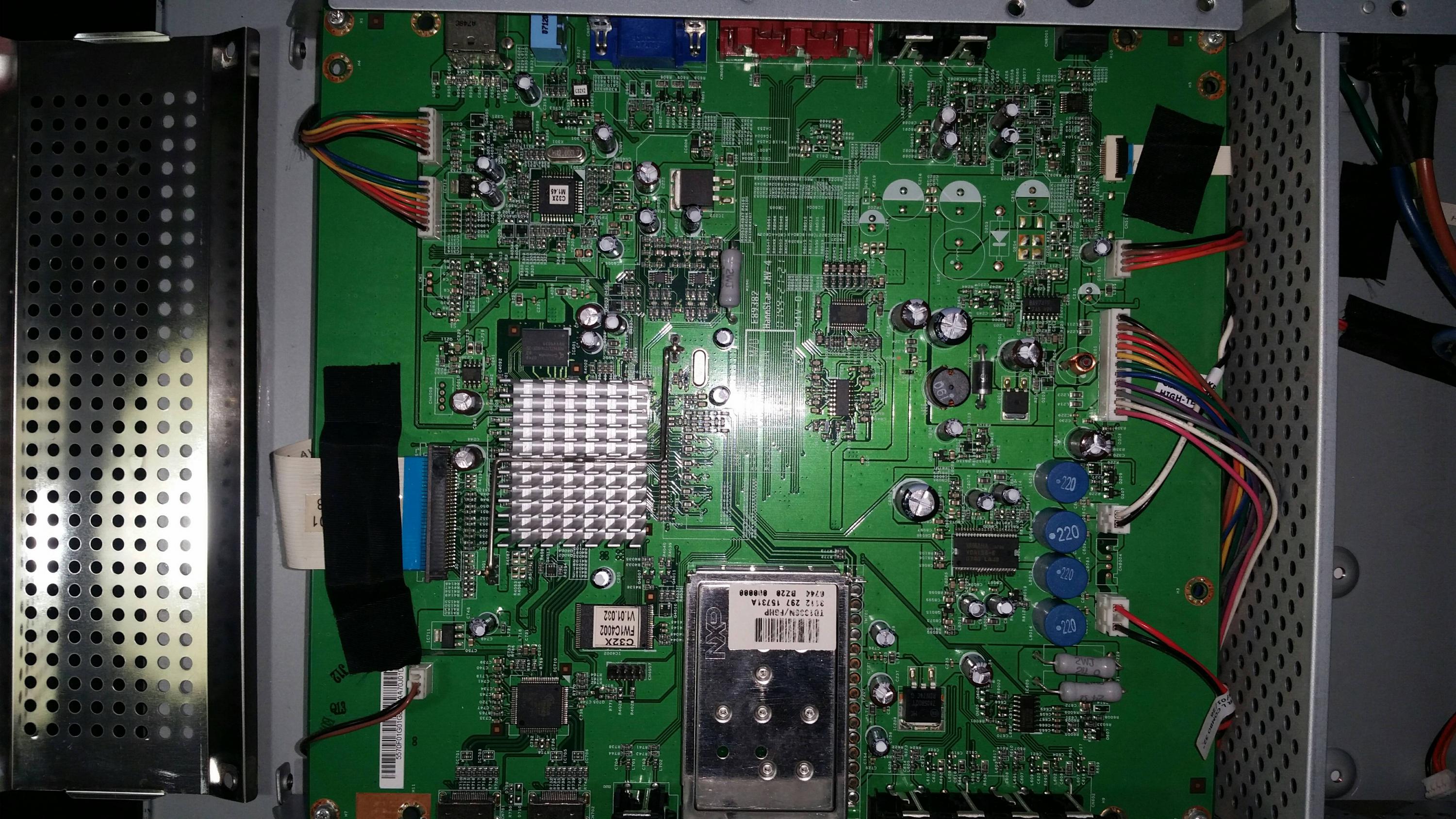

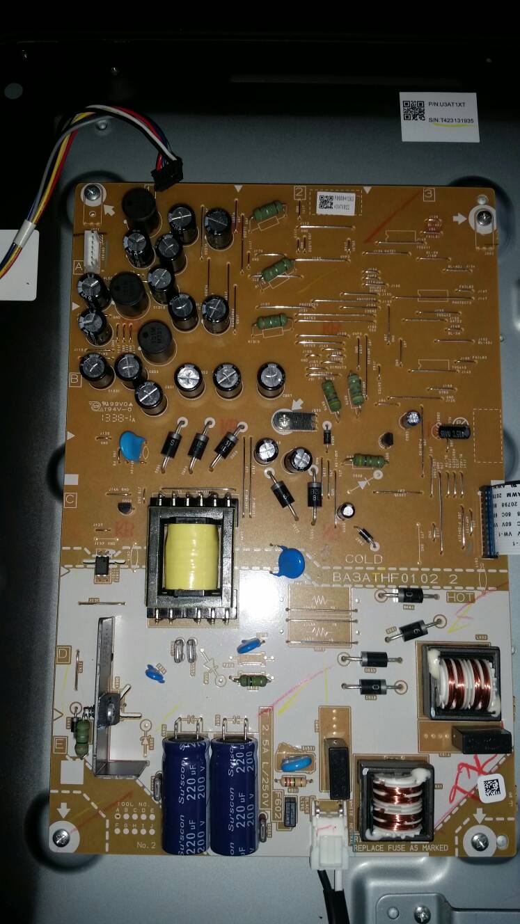

      Images attached.
        Re: Emerson LF391EM4F blinking red nothing else

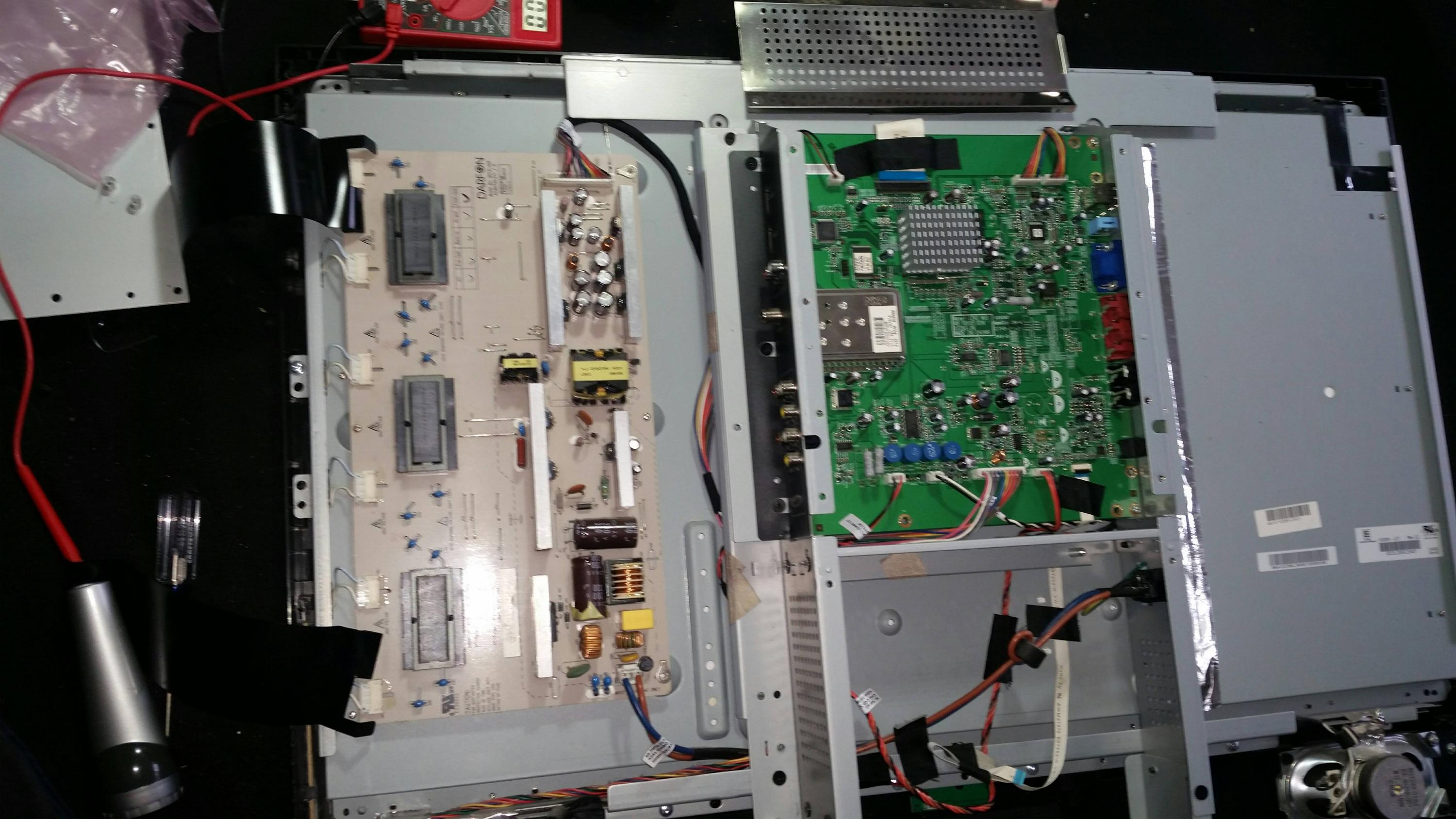

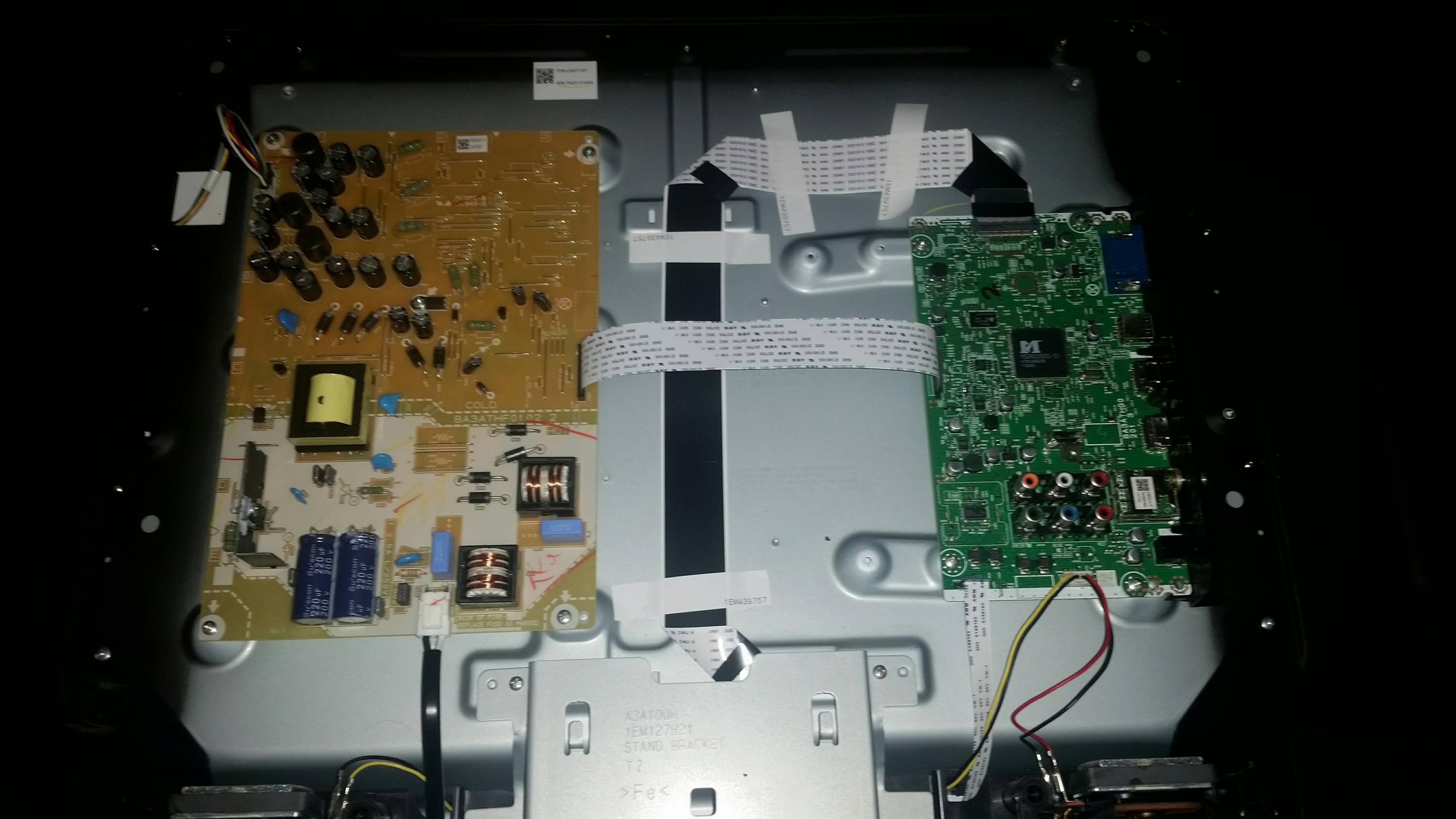

        The pictures of the whole back side of the TV too please so we can see how all the boards are connected together.
          Ok, here ya go. Thank you.
          I found a main board for <$30 on ebay, I went ahead and pulled the trigger.

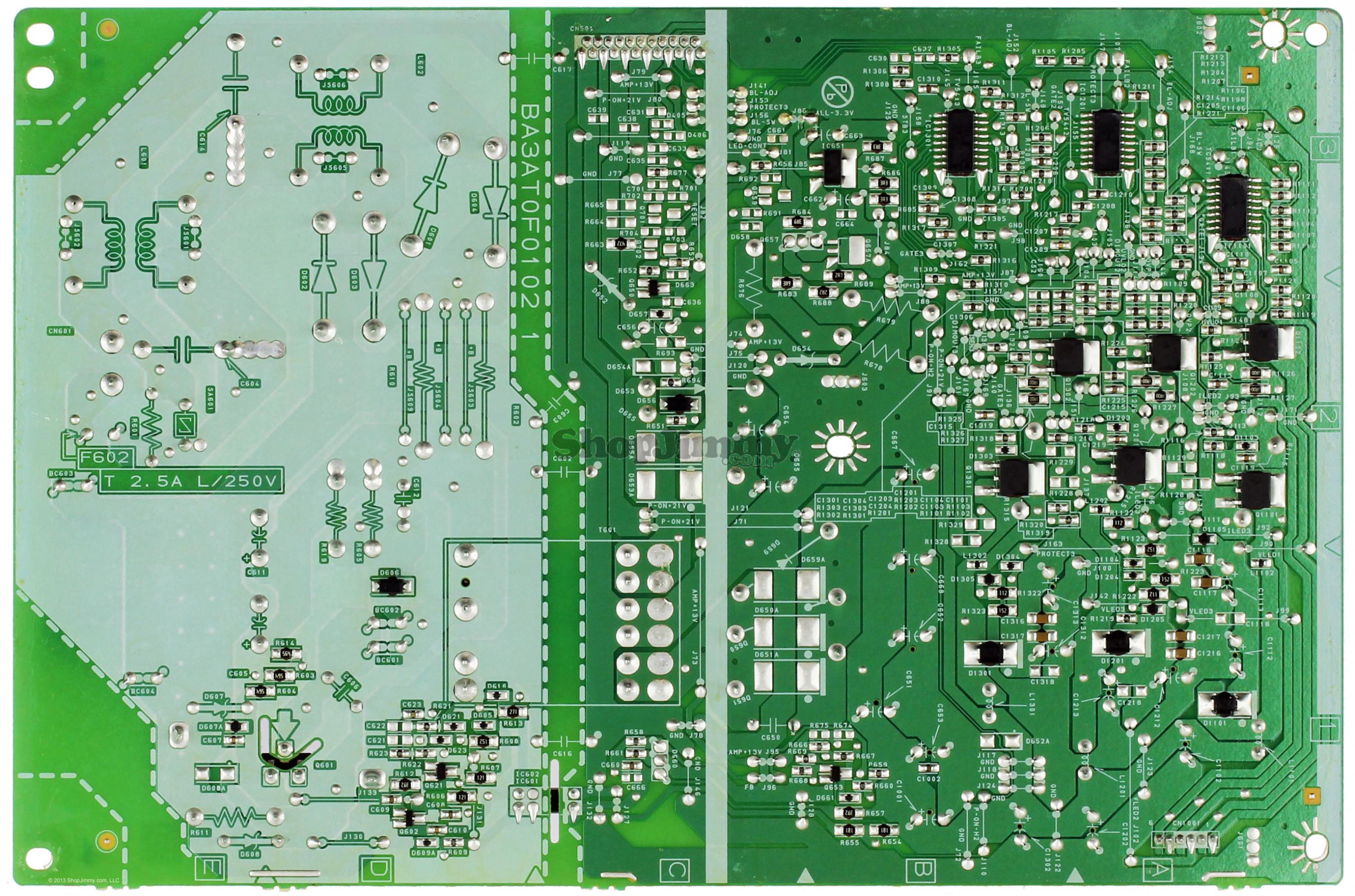

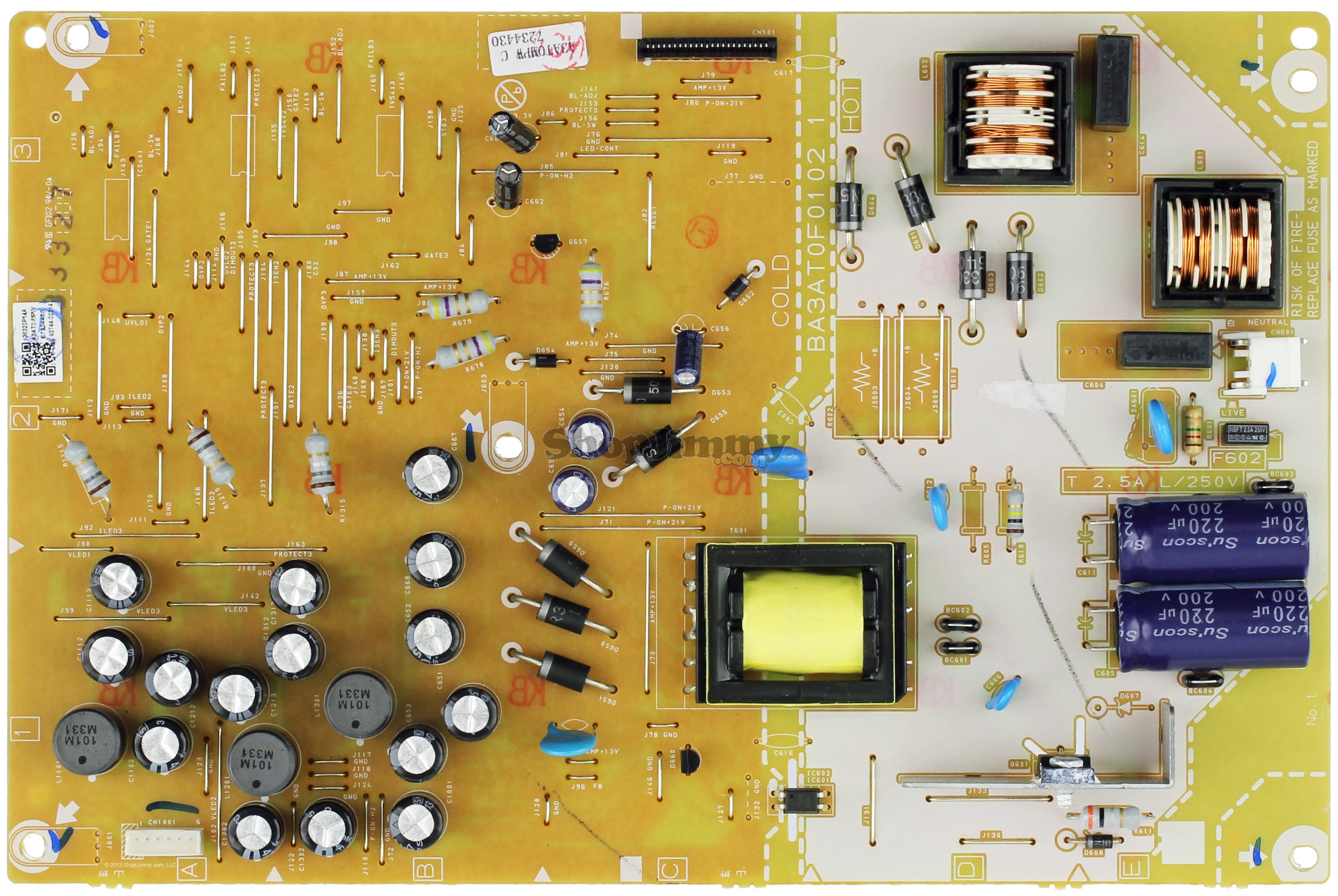

            So it only has one power transformer to supply the Voltages to all the boards.
            Since you are getting the blinking RED light that means the power supply is running but we do not know if the Voltages are fluctuating so it makes the light blink or there is problem in the power supply or in the main board.
            We will need to test the Voltages at the connector on the power supply that goes to the main board.
            http://www.shopjimmy.com/catalogsear...rson+LF391EM4F
            I would start checking the DCV on those jumper wires (close to the black connector) which have the labels for them to tell you what the Voltages should be and also the control signal names.
            Also check ALL the diodes in the secondary side of the circuit.

                              The PS-ON is fine (2.0V), the 13V is fine.
                              But the main board is not sending B-SW (BL-ON), BL-ADJ, which makes sense because you have blinking LED lights right now.
                              The PROTECT3 = 0.4V I am not sure if that is normal or not.
                              I do suspect that you have main board problem.
                                thanks budm, wanted to give you a followup and let you know it was the main board, got it in today, and got it working. Thank you very much!!

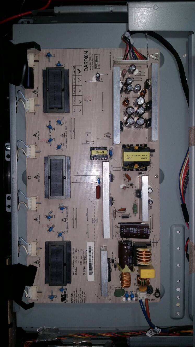

                                It has no lights, no power, no anything. He says he "thinks" it was struck by lightning but not sure. I pulled the cover off and was looking for signs of gross voltage overload and it looked fine, no blown or swollen capacitors, brown spots or charred components of any type. A cursory look on the net seemed to say there was a problem with the caps on this unit on the Power board but they all looked normal to me.

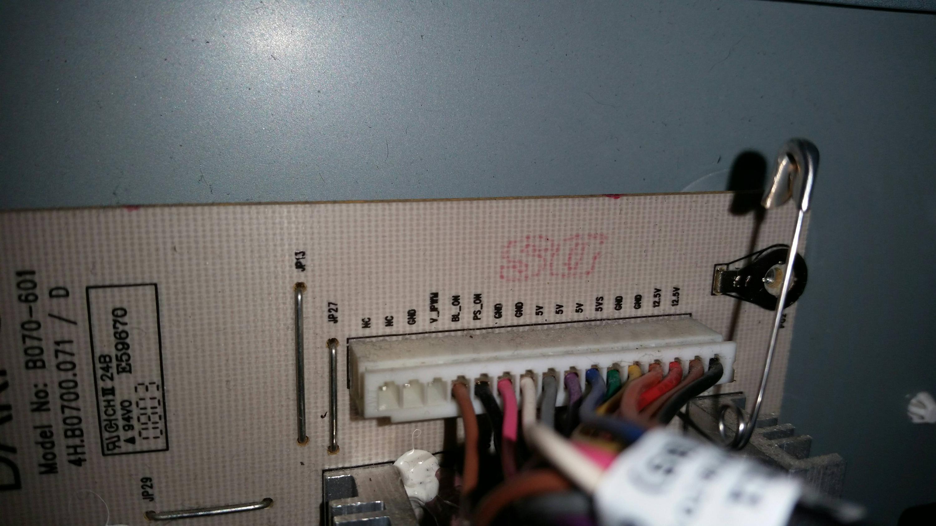

                                my readings are from the power board to the inverter is "from right to left"
                                13.45
                                13.45
                                .02
                                .02
                                5.49
                                5.49
                                5.49
                                5.51
                                .03
                                .02
                                4.98
                                .01
                                3.16
