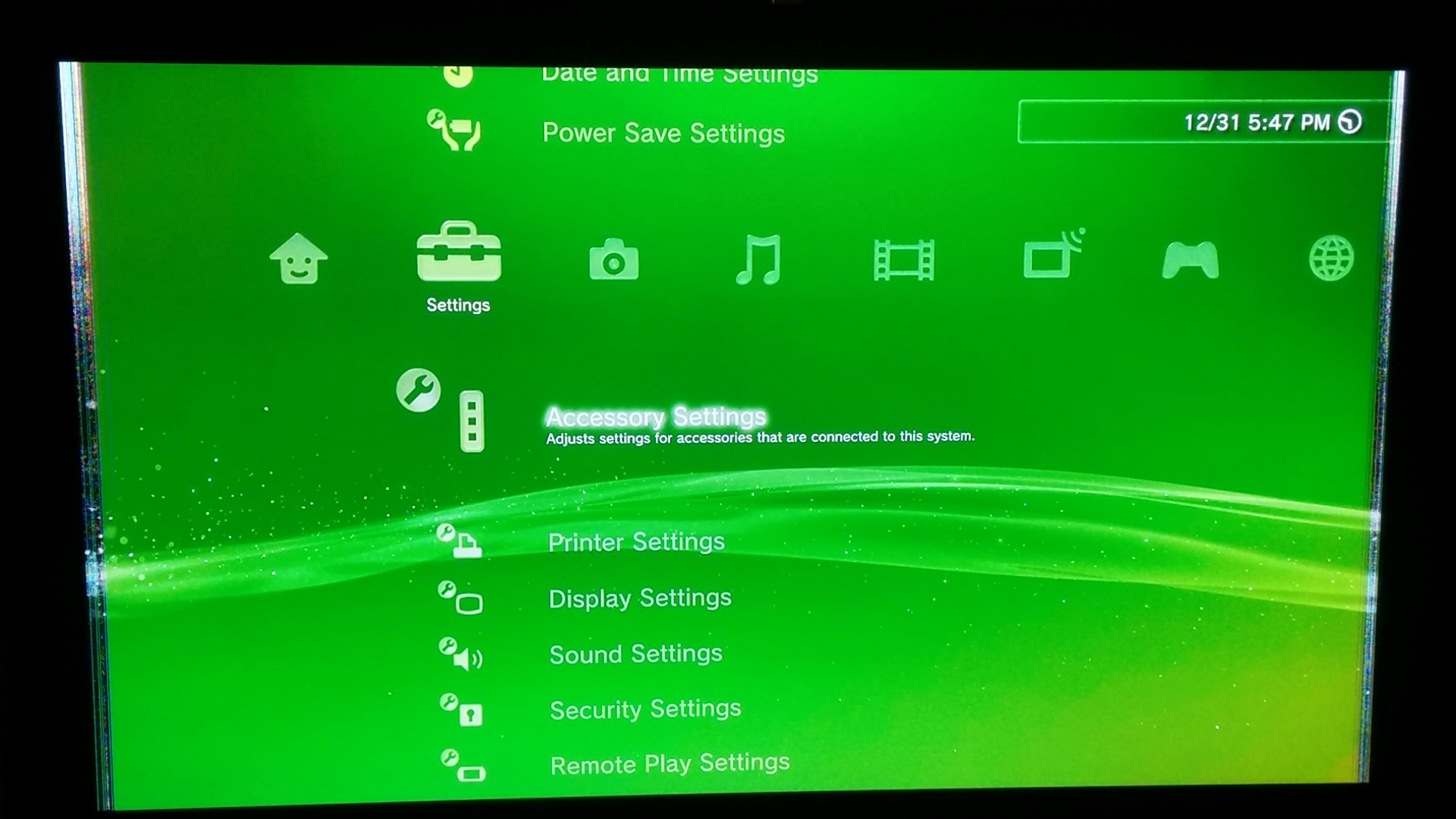

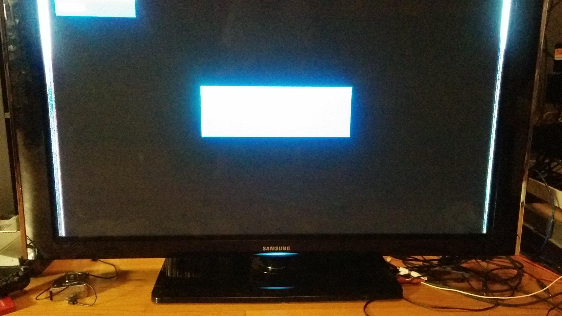

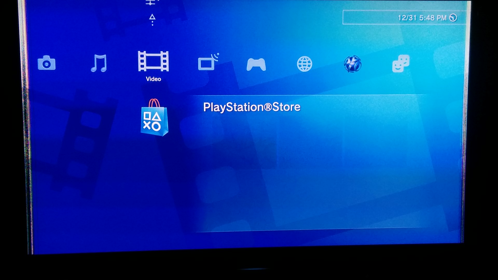

    Hello everybody! I acquired a non working Samsung fp-t5084 plasma.
    It would click incessantly trying to turn on. Upon opening her, one capacitor was clearly bulging, I replaced JUST that one (10v 2200uf) with a 16v 2200uf. The TV fired right up! GREAT..
    Now I see another issue, 2 vertical color ridden, pixelated bars about 3/4" wide on both outside edges of the screen. The Image is still slightly visible through the pixelation. The rest of the screen looks pretty great!
    I've checked out a few voltages on the PS and everything tested so far seems to be in spec.
    I know this can be a dead panel, but I have a feeling it's a loose connector or something minor. Any and all help is appreciated.

    This is almost certainly a bad panel.
    You could try reseating the connection on the lower f-buffers.

      Could The Buffer board be faulty? Would that be the only way to narrow down the health of the panel?
      I was under the impression that panel faults are usually static, and single color? These bars are rather static, but they are 'sparkly' and still showing an image behind the distortion?? any other diagnosis I can do?

          Either a bad panel, or control board but most likely panel let's see a picture of this fault.
          Usually lines that don't have any cross hatch pattern inside of them or just single lines or multiple single lines sporadic that's usually a panel if it's a quadrant or a bar that is discolored or translucent usually control board.
