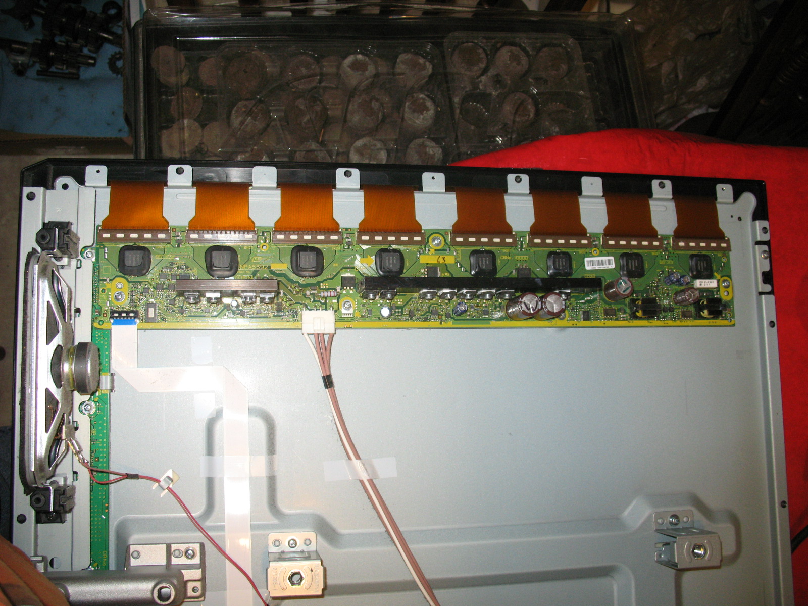

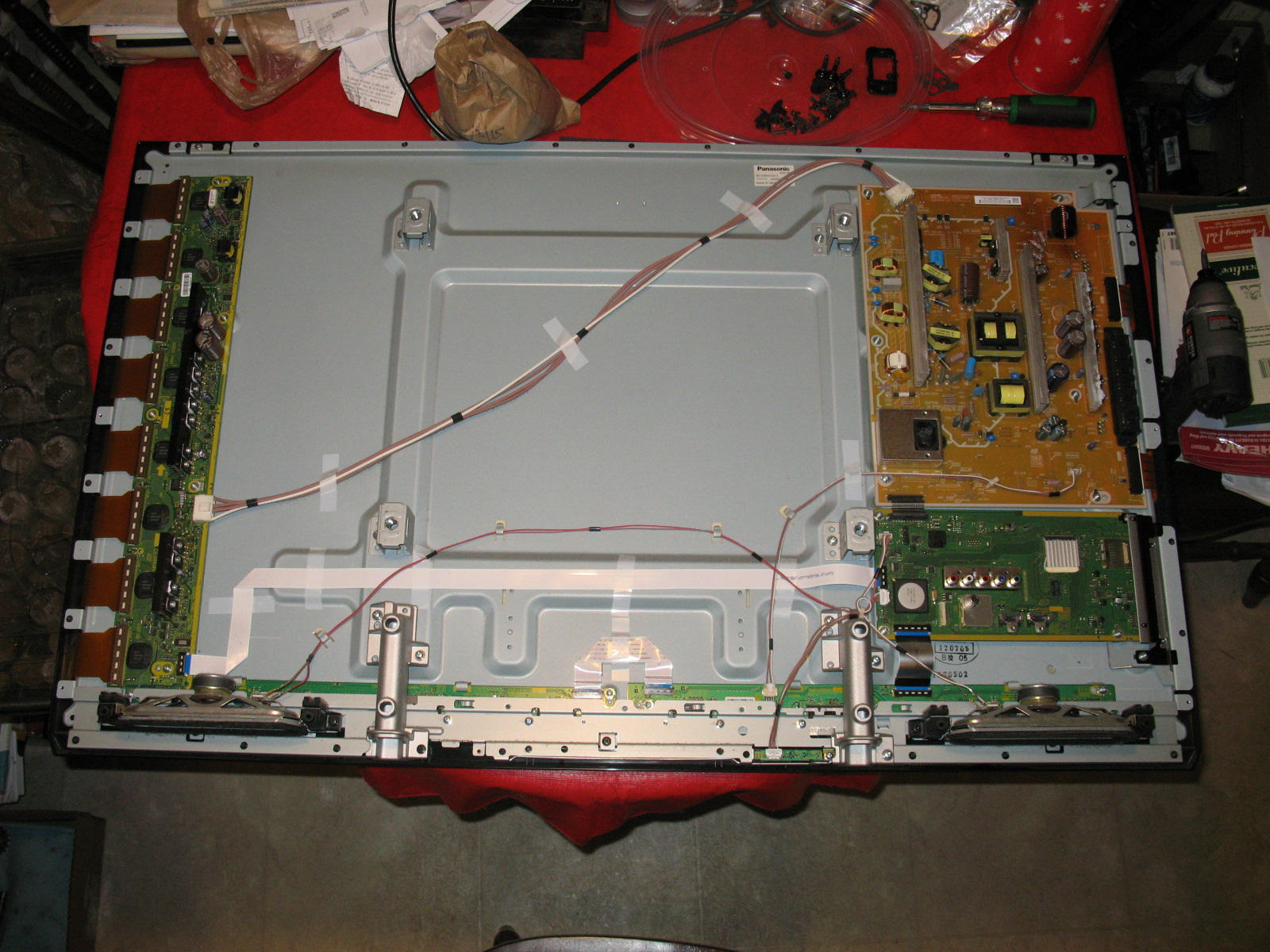

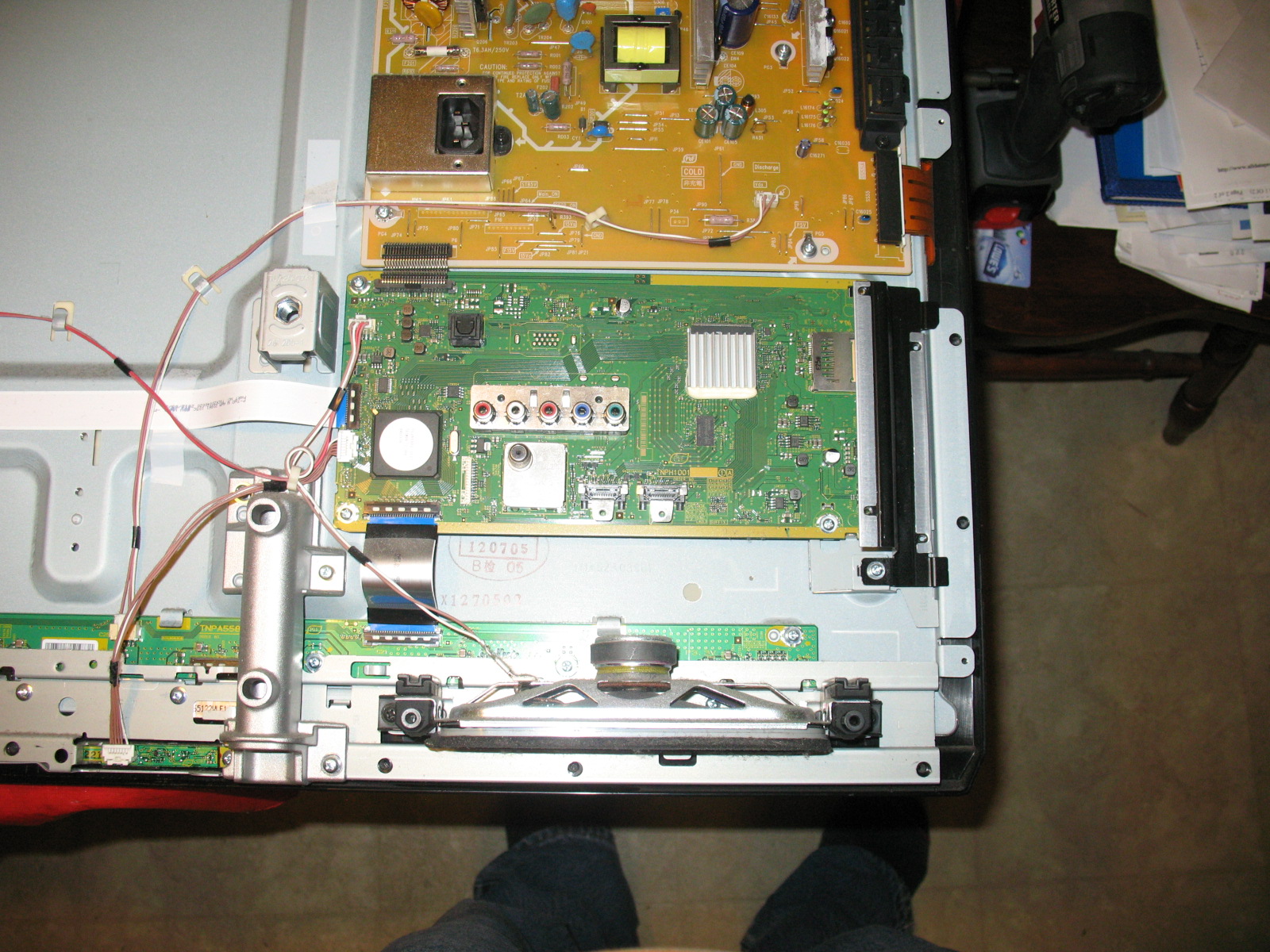

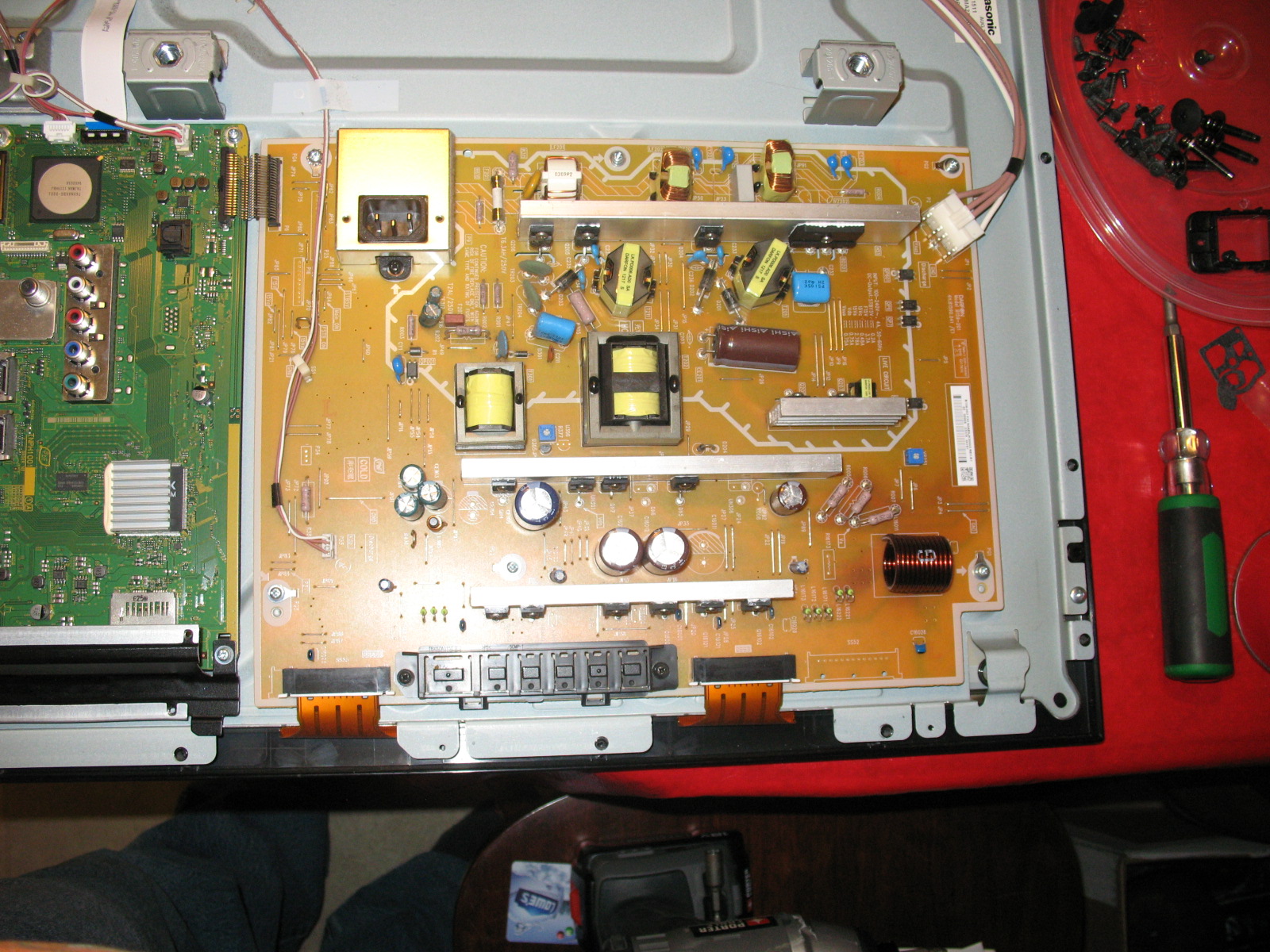

    Last year with the help of this forum (and moduslink) I was able to repair a Panasonic 42"plasma tv and I'm happy to say that tv is still doing fine. I recently acquired the above mentioned tv TC-P42X5 ( August 2012)with the following issue, no picture. The sound works, you can change channels when connected to a cable tv coaxial cable and the backlight works. You cannot see the menu and I inserted an SD card to check if that could be seen, it cannot. I haven't been able to find an online manual yet and this tv is internally different than the last. if some of you could push me toward a starting point i'd appreciate it. I have the back off and of course there are no obvious dangling connectors just waiting to be reconnected. There also don't appear to be any swollen caps or loose screws.
    thanks,
    Pete

    Re: Panasonic Plasma TC-P42X5, no picture
    sounds like A board issue.
        Ding, ding, ding!!!! We have a winner. Once again TW2005 you prove you know your stuff, even if it was a guess. I purchased a new/refurbished "A" board (TNPH1001UA) from a vendor (not ebay) installed it, reassembled the tv and now it's working like it should. Thanks again for helping fix yet another tv, another saved from the trash can!
        Pete
