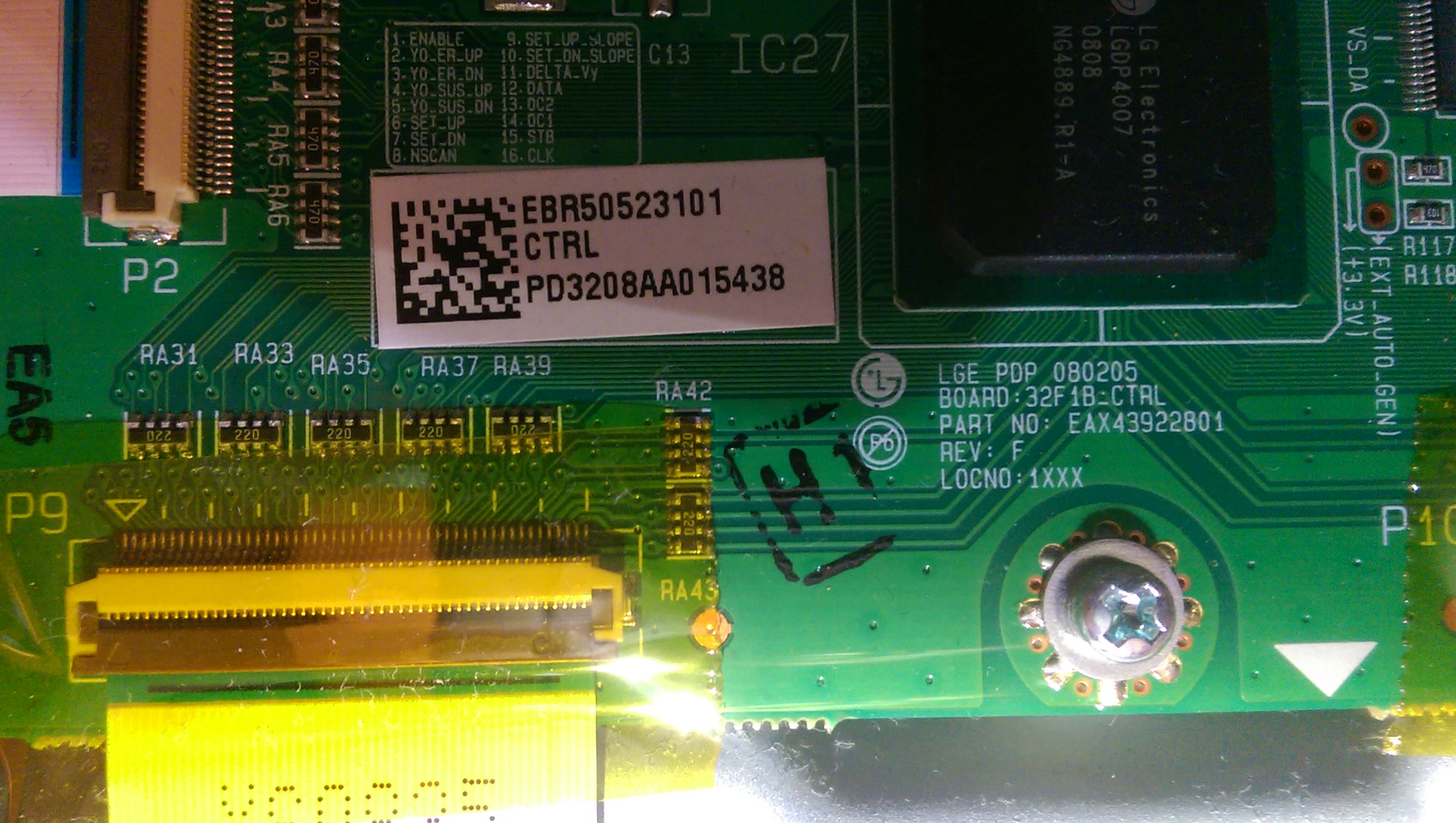

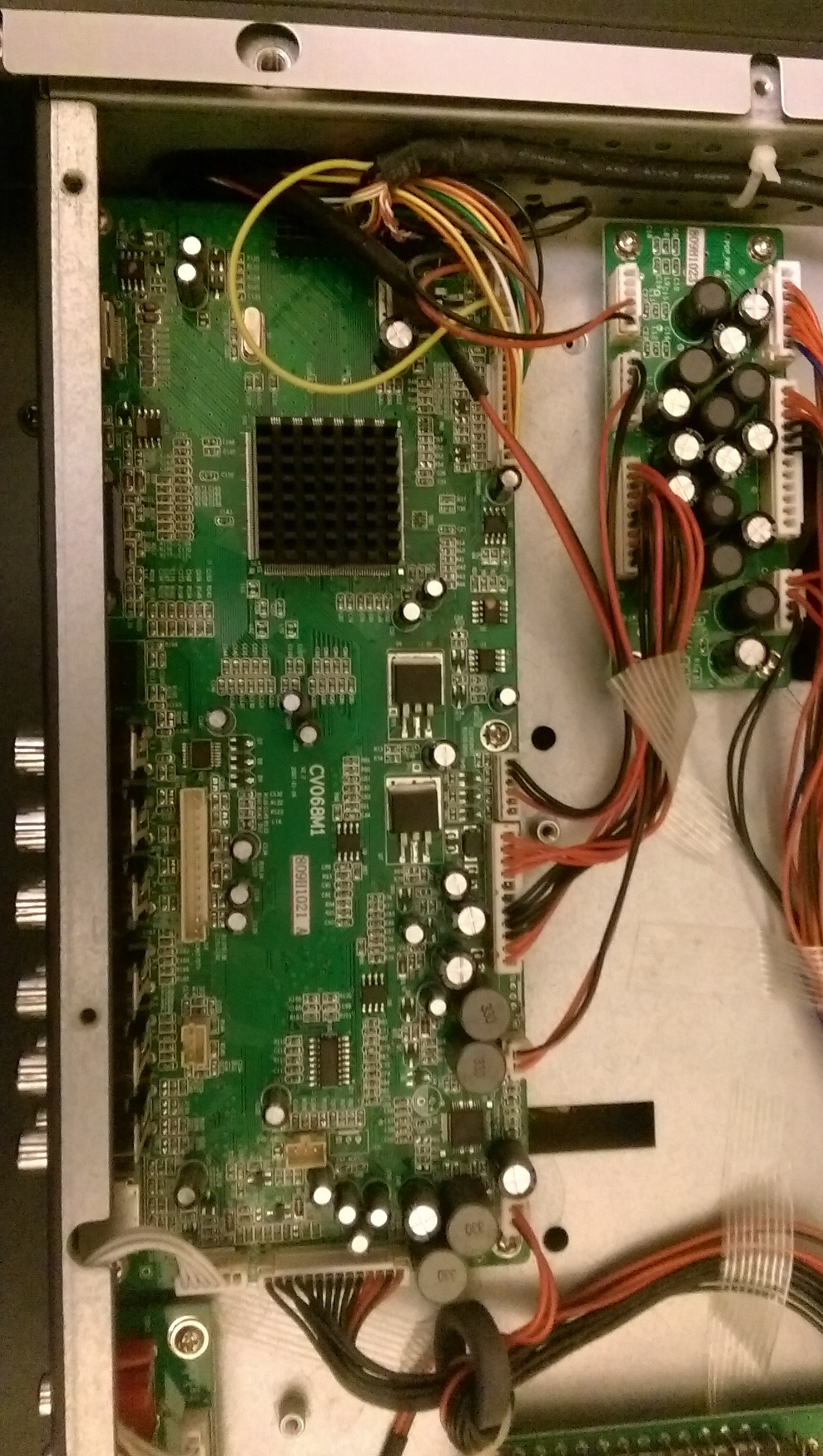

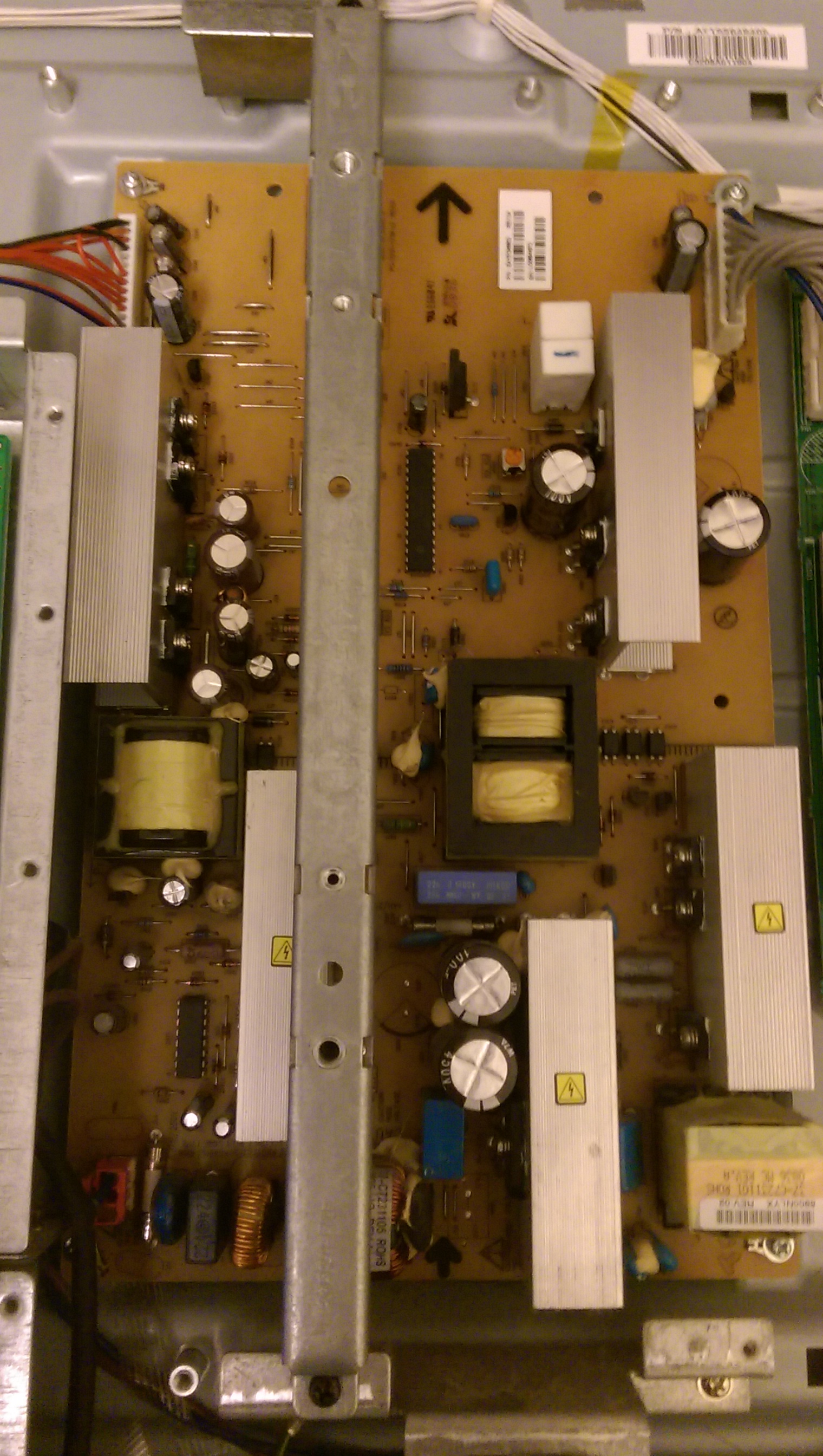

        Re: DSE G3292 (Rebranded LG) 32" Plasma screen going black.

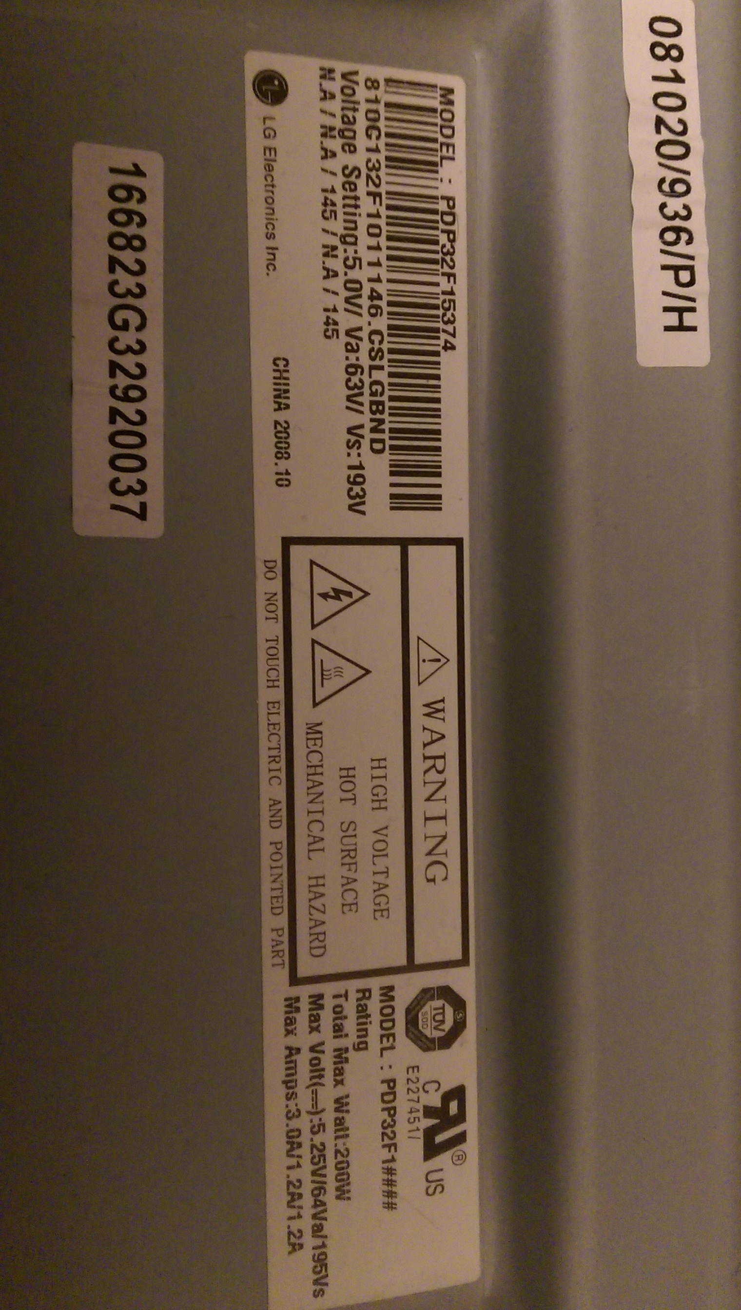

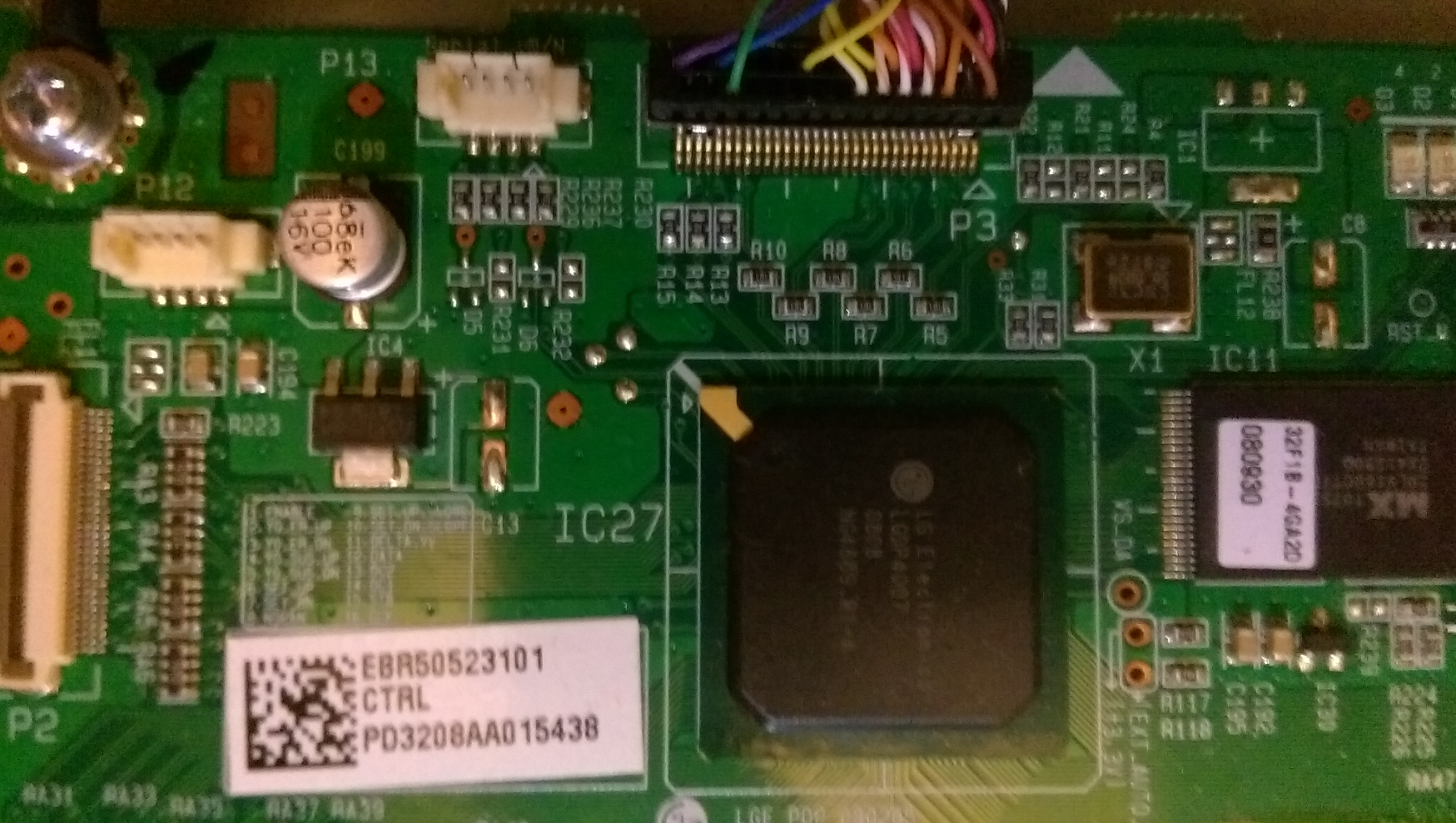

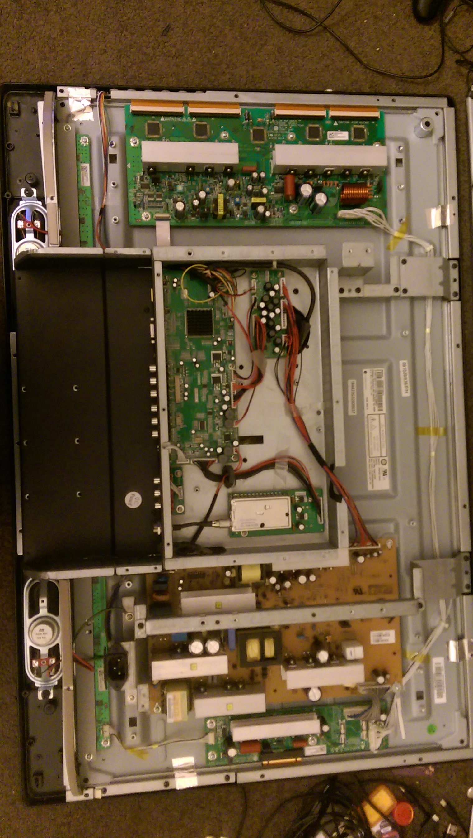

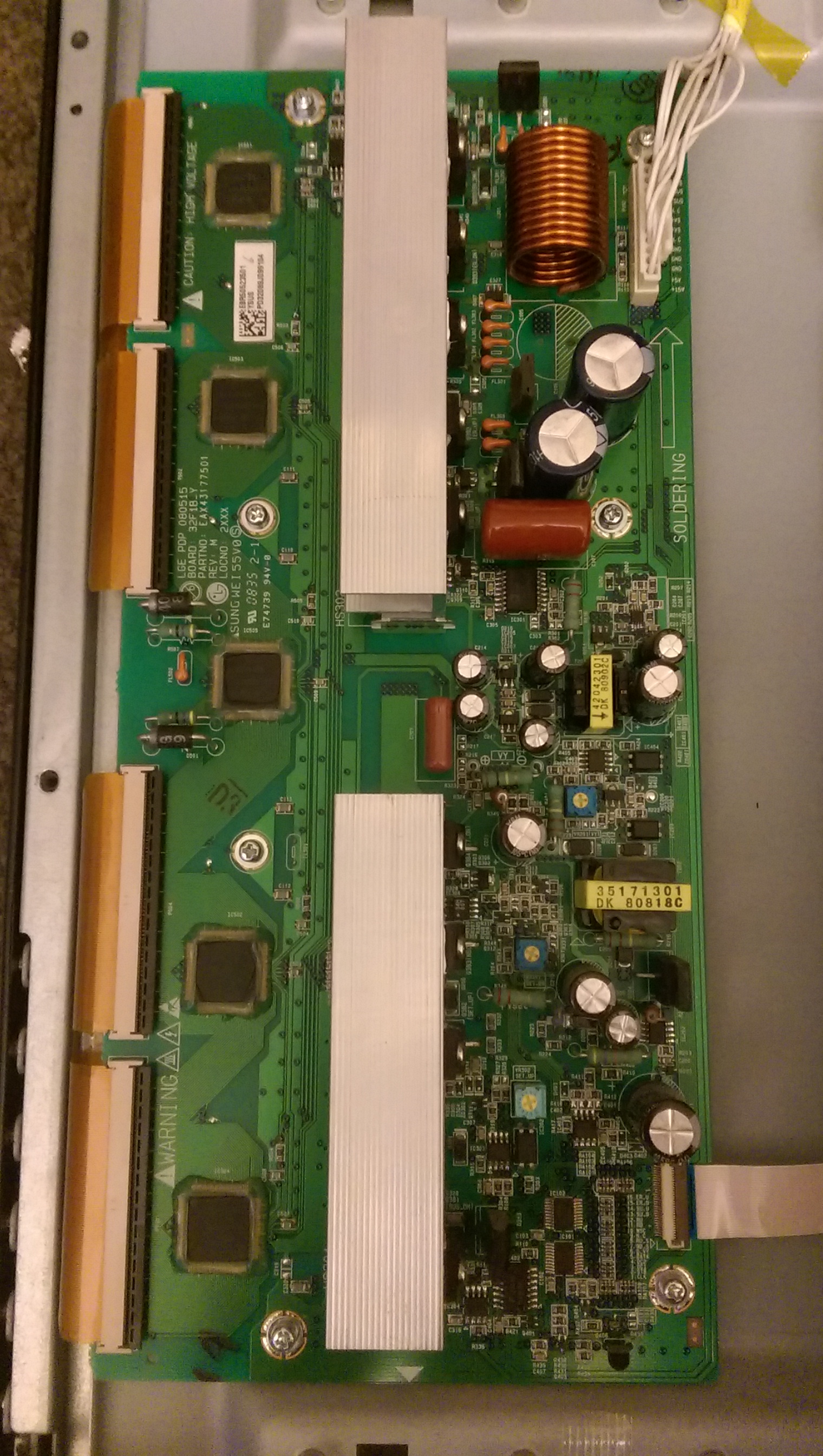

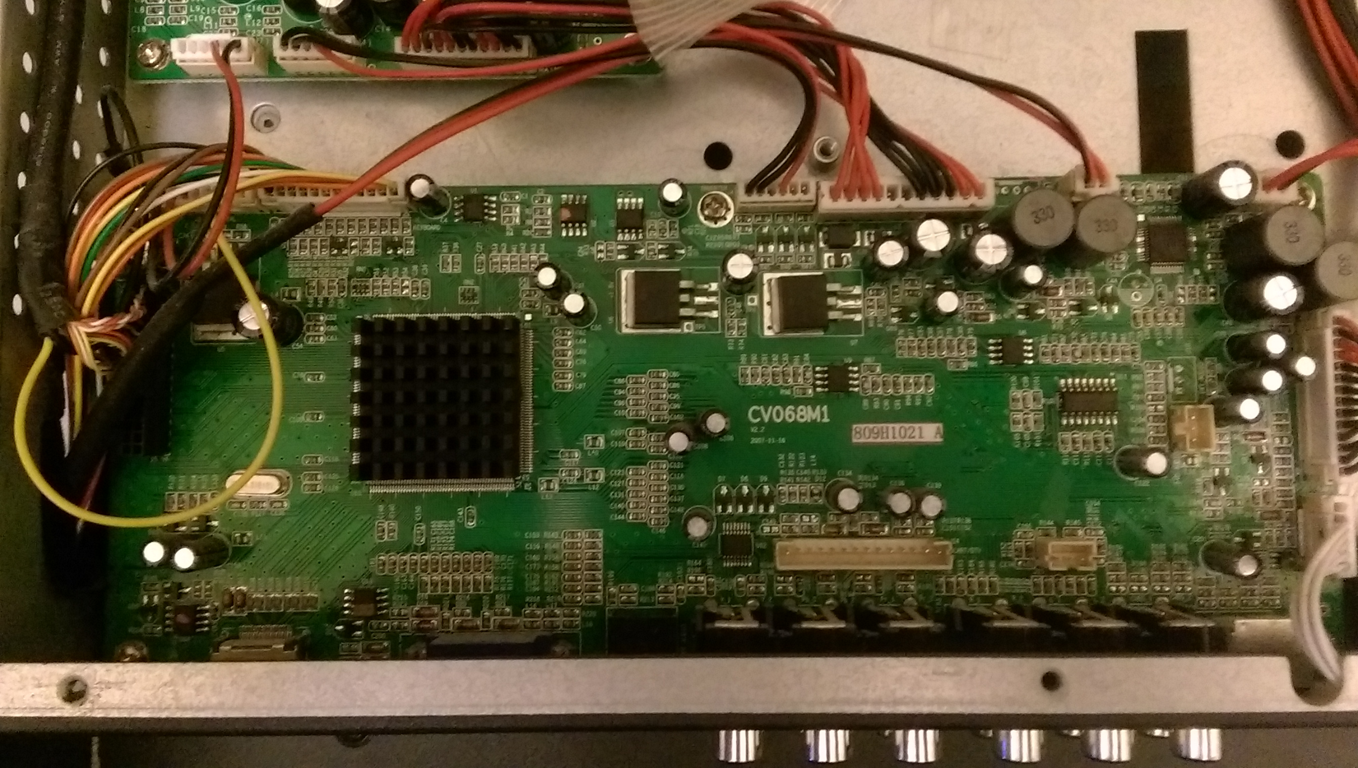

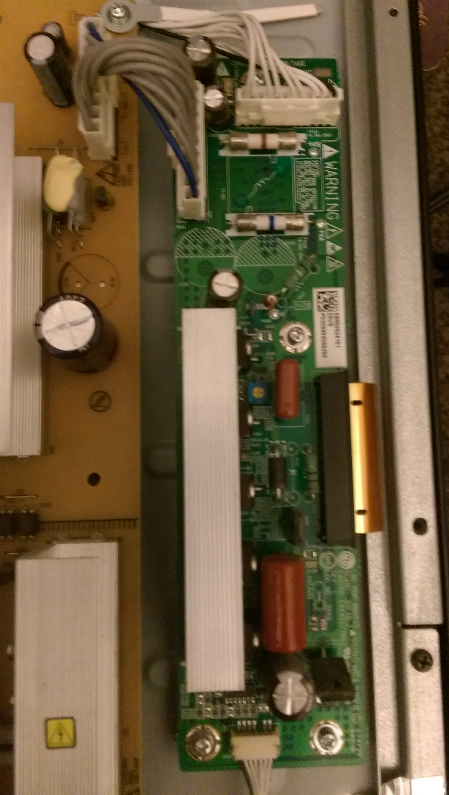

        Hope these help.
          So it looks like its an overheating issue, I had the heater on in my room and noticed it started getting more frequent (like every few minutes. I also noticed that the TV has a "Buzz sound". When I placed the fan over the vent on the outside by the YSUS the TV will stay on and the buzzing sound is no longer
          Could this be something as simple as needing more thermal paste on the heat-sinks as the old paste may have gone bad? It was run in a fairly hot environment previously.
