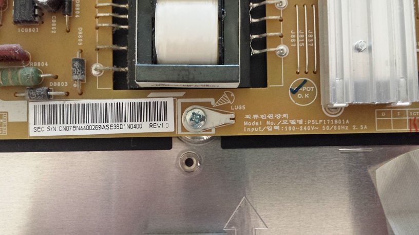

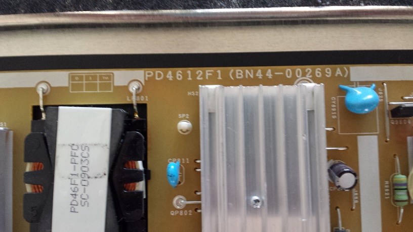

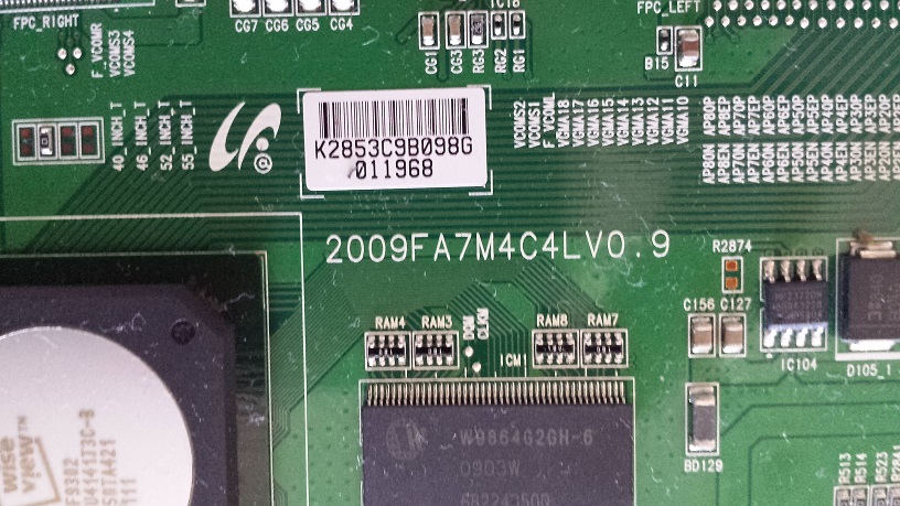

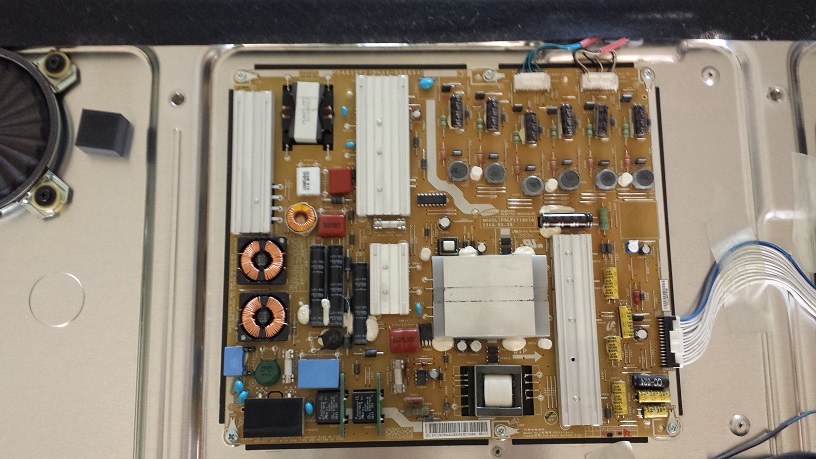

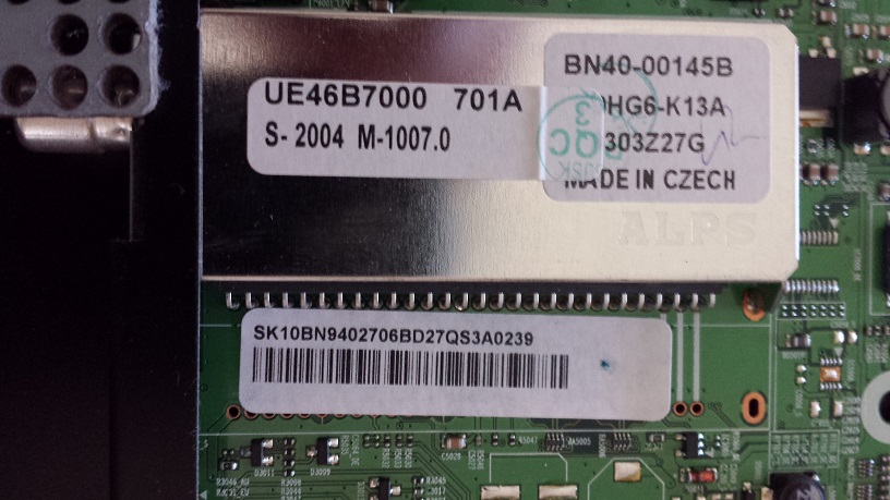

    Posting pictures of the back of your tv showing the boards with clear pictures may help you more with fixing your problem
    • viz123
      • Jul 2015
      • 5
      Re: Samsung UE46B7000 Picture Flashing
      Of course, rookie mistake! I've attached photos showing details of the Main, Power & T Con boards, hope this helps.

        Does anyone know the difference between the FRC Before DDR tests and FRC After DDR tests? What does it mean if the picture is faulty before but okay after?
          It means the Frame-Rate Corrector, on the T-con board, is faulty - so you have narrowed down the problem to the T-con.
          • viz123
            • Jul 2015
            • 5
            Thanks Tom. I've seen some T-con boards for sale, same part number, but for 40" displays. Is there any difference?
