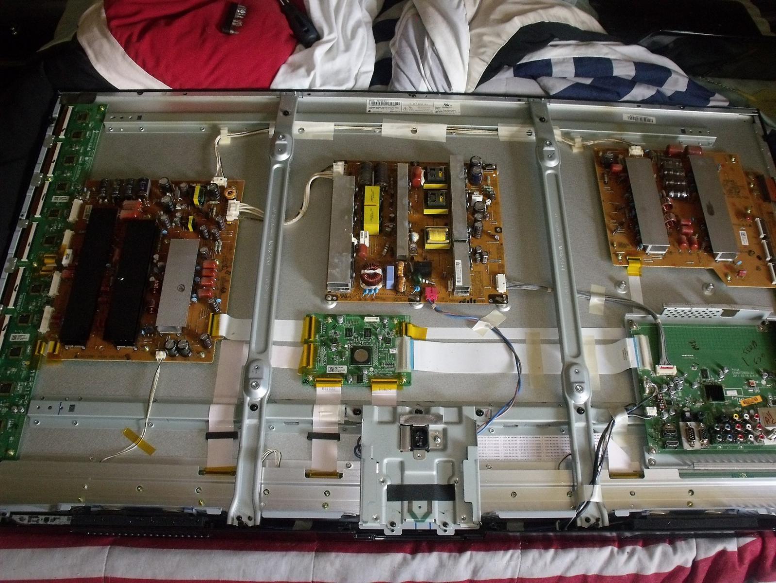

    LG 50PV400 Have Sound but No Picture
    Ok,about 2 weeks ago the tv all of a sudden had a dark thin vertical line from top to bottom,almost in the middle,just a little more to the left.It is a bedroom tv so didn't much care,as was still watchable.
    Well last night we were watching it and all of a sudden the display went dark,like it was turned off...but the sound was still working...uh oh....turned it off,left it for a minute,tried it again..same thing...sound works but nothing on the screen...all buttons work as usual,can turn vol up\down..tv turns on\off ok...just no picture..tried dif input,same thing.
    Doing some research this sounds like a bad y-sus or bad y-buffers,correct..??...I've got the back off the tv,and have used my DMM to test the fuses on the y-sus board,and the fuses on the PSU board,all ohm out fine.
    Can someone please chime in with some more tests i can perform before ordering some boards up...this has 2 buffer boards connected to each other with a small ribbon cable...is there a way to test the buffer boards

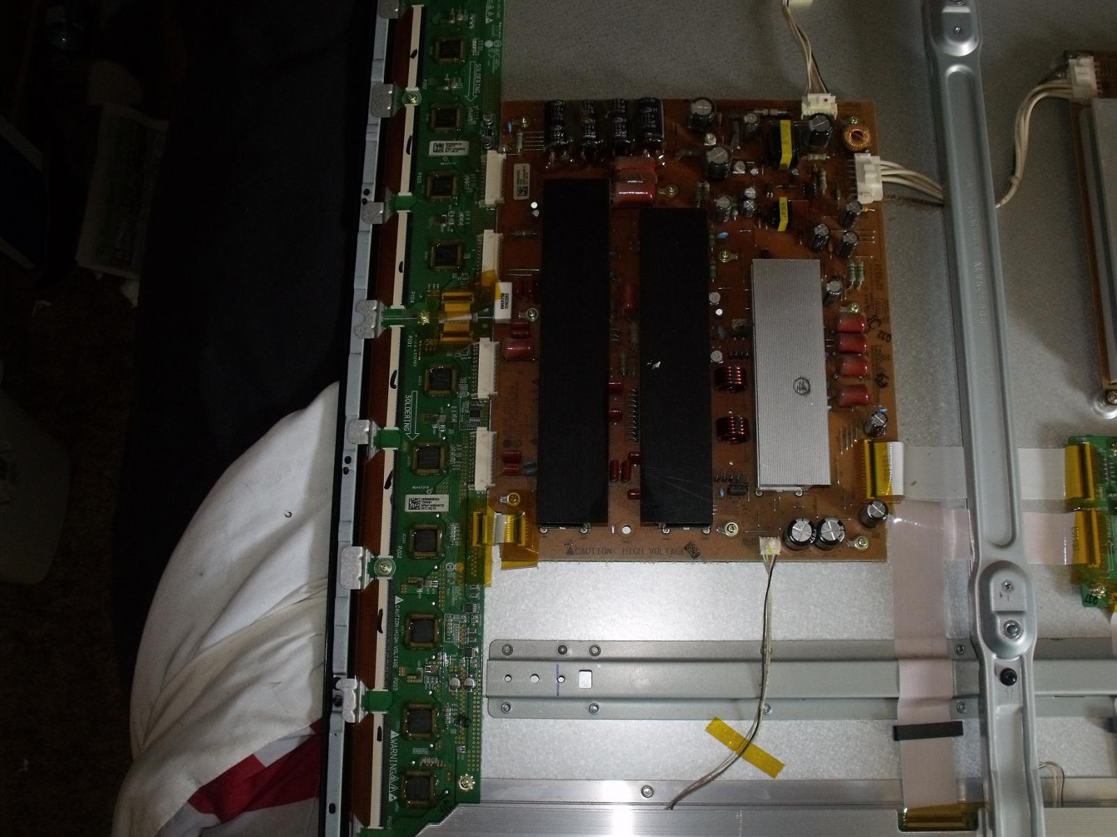

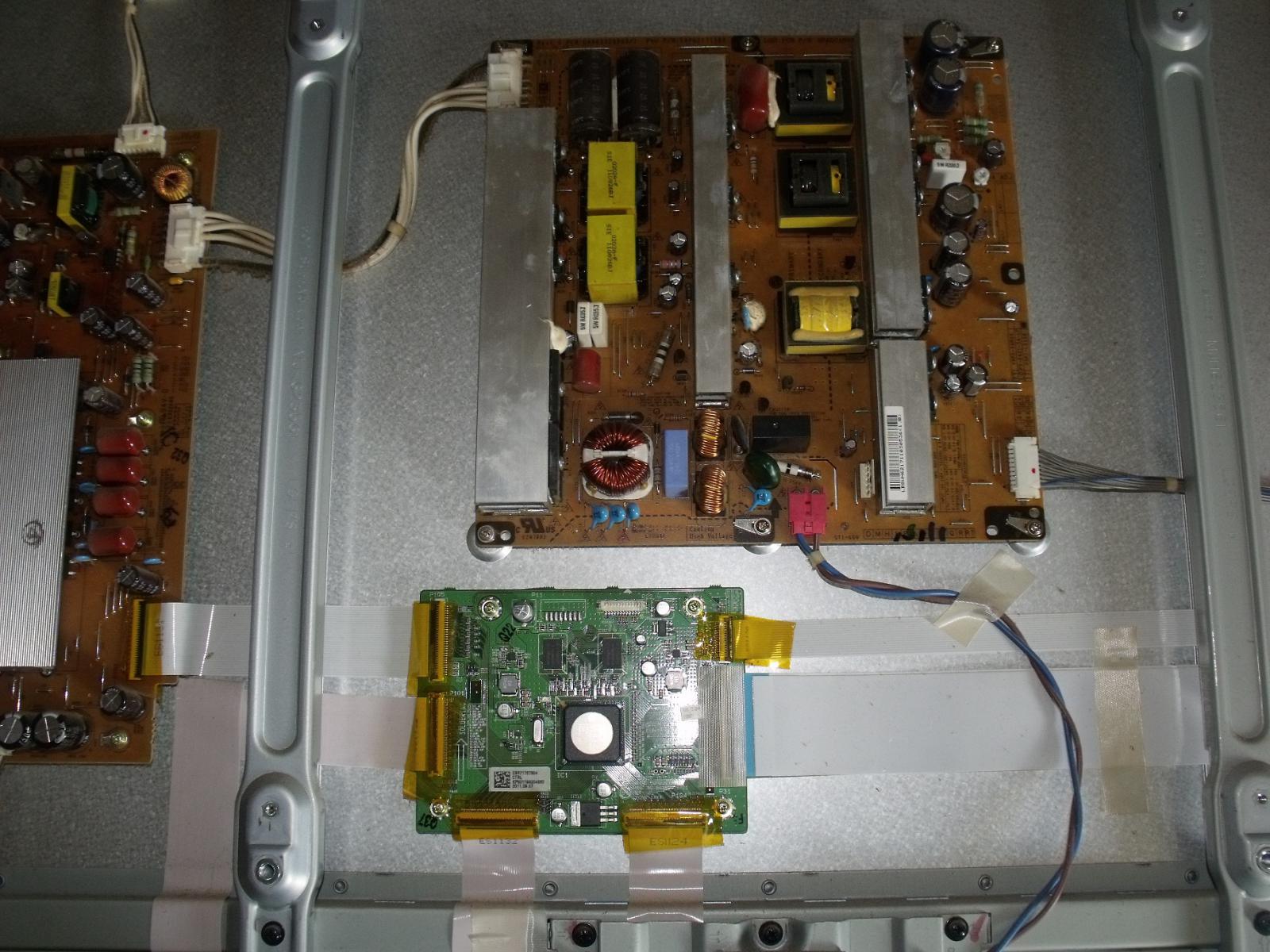

        Ok,have done some readings and this is what I have found.
        Power supply Vs tag reads 203v,I get 205...Va tag reads 55V,I get 55.2
        Y-Sus board VSC tag reads 150V,I get 191.3.....-Vy tag reads 190V,I get 190.2
        Z-Sus board Z-Bias tag reads 130V,I get 129.5
        So the only reading that appears to be off is the VSC on the Y-Sus board,and while keeping the meter probes on and trying to use the VSC adjust did nothing,maybe flick down to 191.2 but doing the whole sweep of the adj screw,really did nothing to change the voltage.
        Any ideas where to go now..??

          Can you disconnect the buffer boards from the y-sis and check the vsc, -vy voltages again.

              Ok......now I think we're getting somewere..!!..
              With both side Y-buffers totally removed,I got a reading of VSC-155V(remember I was playing with adj),and I was also able to adj the voltage this time,so put it to 150V where tag said it was supposed to be.
              -Vy stayed the same at 190.2V tag says 190V
              So do you think its safe to say I need to order up a set of Y-Buffers..??

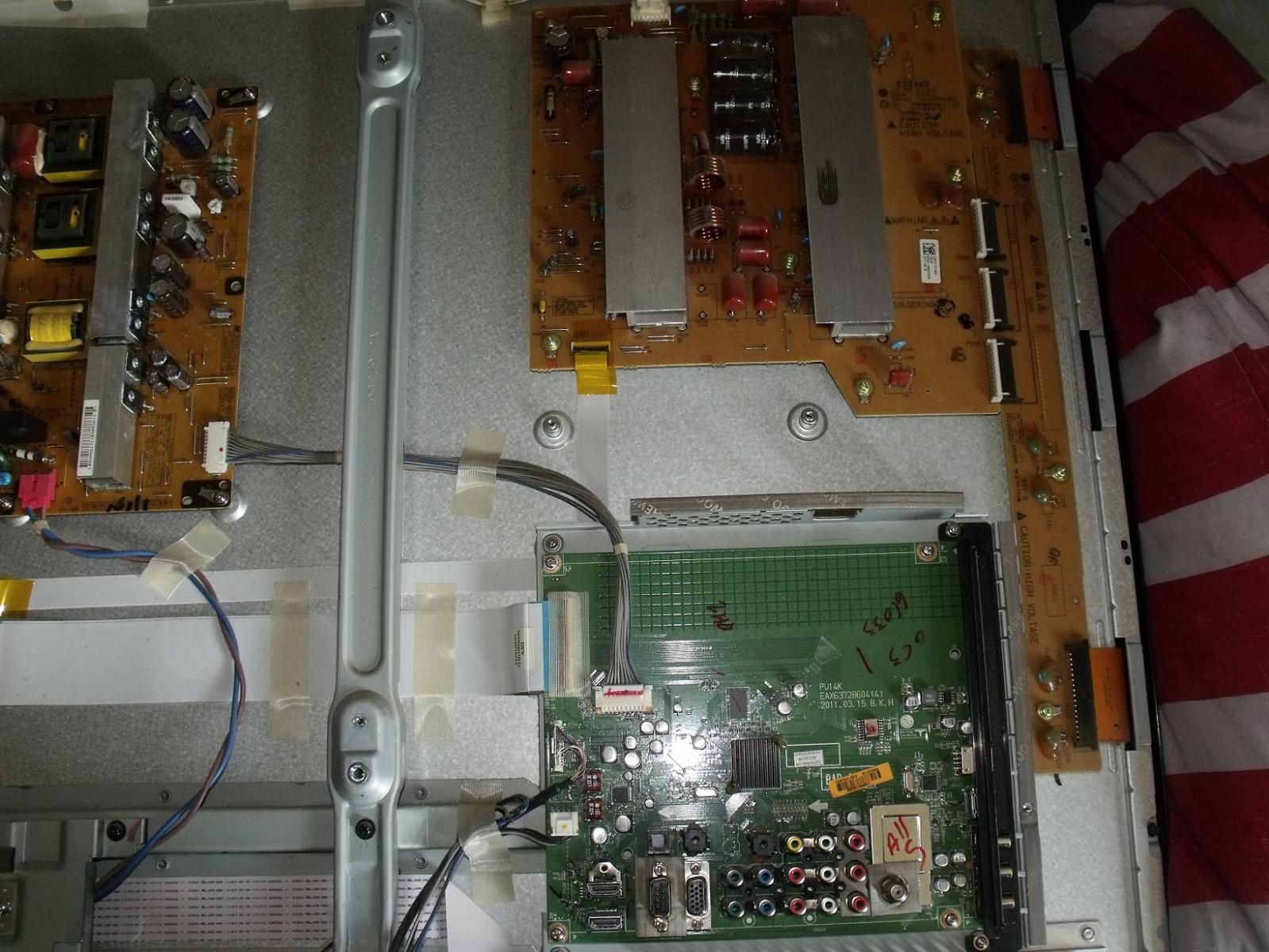

                      Can you send a pix of the bottom of the z sustain board ?

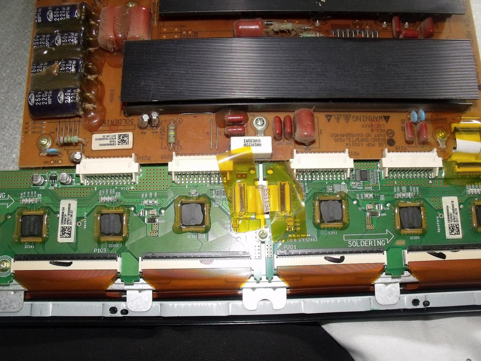

                        Ok,bringing this post back from the dead,lol,haven't had much time lately,but am ready to do some more testing.
                        I've checked the y-buffers for shorts and don't appear to have any,I also ordered a tested set from ebay,with no change when installed,still no picture at all.
                        VSC on the Y-sus board is supposed to read 150v as per sticker,but with either set of y-buffers I have,hooked up,the VSC jumps from 150v to 190v and is not adjustable with them hooked up.If I unhook the buffers,the VSC drops to the right 150V,and is adjustable at the pot....Which led me to believe the y-buffers were bad,but it acts the same with both sets of buffers I have.
                        Also have followed 5v from p supply to each board,as well as VS,all read good.
                        I also tried unhooking the LVDS cable from the control board and jumpered the auto_gen ports on the control board,powered on,and have no test patterns.
                        Where should I go from here..??
