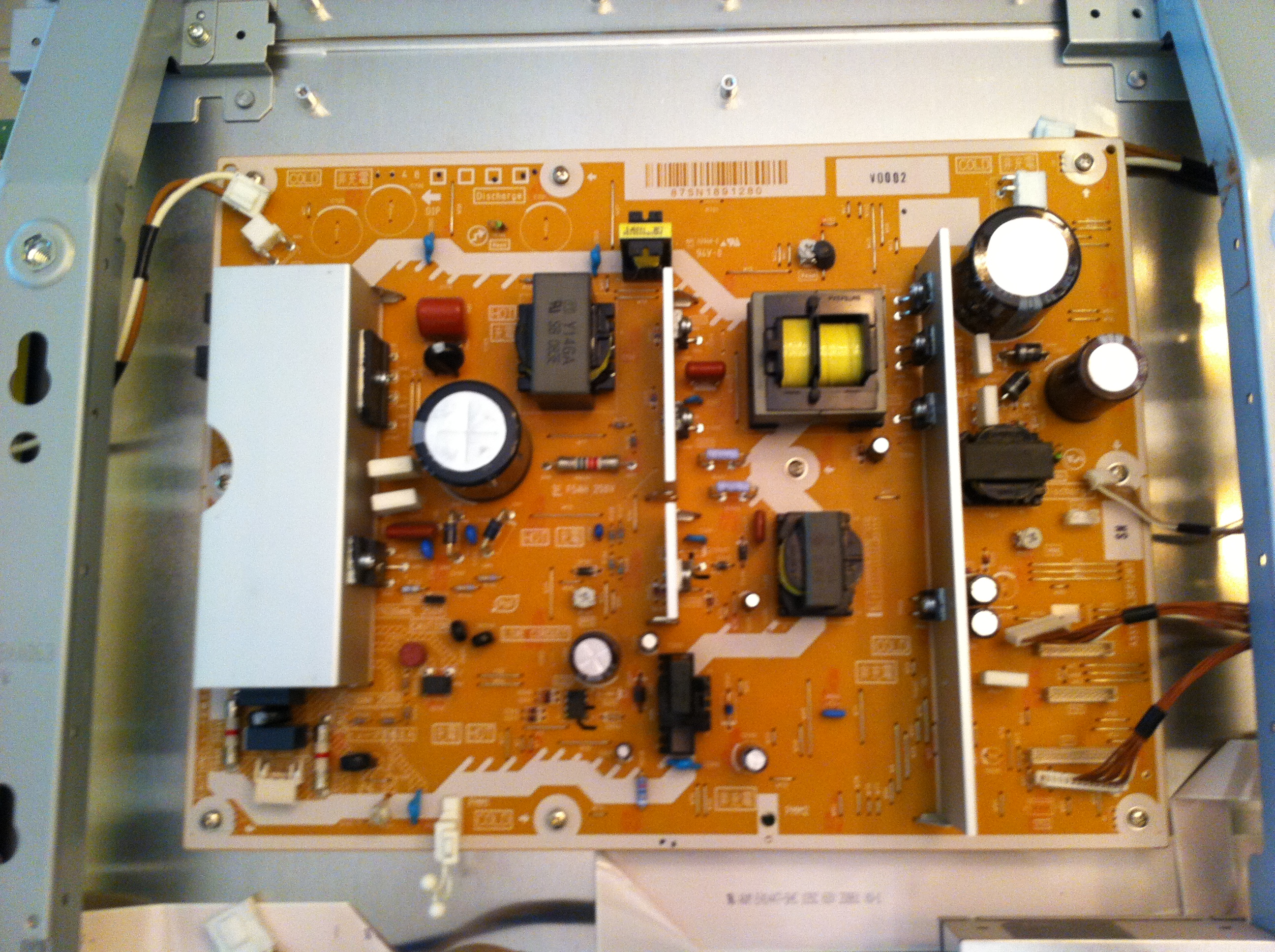

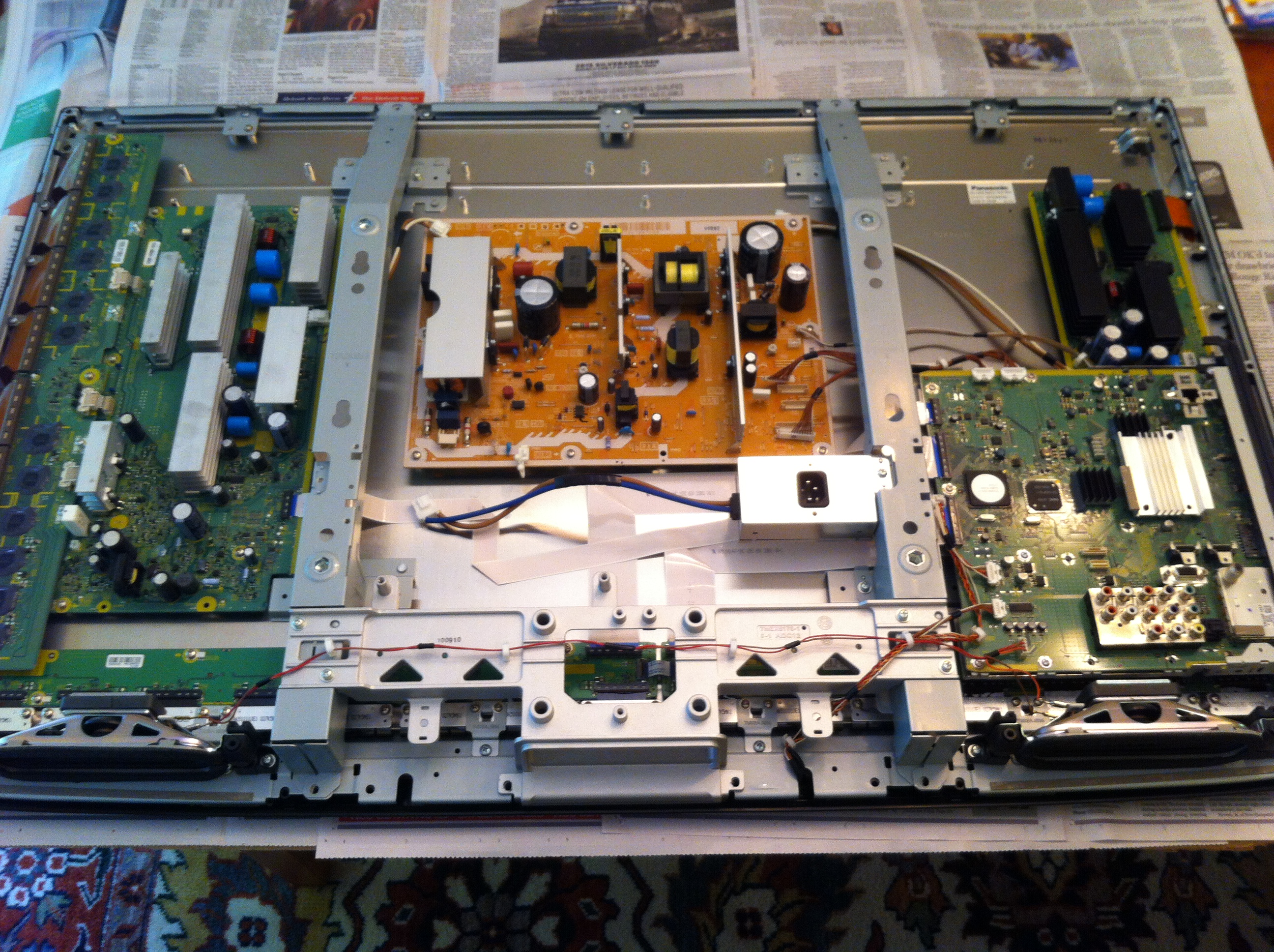

    Hello all, I'm new here and thought this would be a good place to get some advice on my Panasonic TC-P42GT25 3D plasma TV. It's a Nov 2010 model and about 3 months ago it started turning itself off after about 20 to 40 minutes of watching. It's been a good feature to minimize the kids' TV time, but I need to fix it. When this happens, it's unresponsive, won't turn back on, the remote and button on the side do nothing, no clicks, no flashing lights. If you leave it alone for about 15 minutes, you'll hear a click and voila, it comes back on!
    It sounds like a thermal relay of some kind, but I'm not sure where to start. I'm no electronics technician, but I know my way around a multimeter and a soldering iron. I've got the TV on it's face on the dining room table and the back is off - what next? I did search the site before posting, but couldn't find anyone with a similar problem. Thanks for any advice!

    I'm going to say it's most likely the A board and maybe one of the BGA chips has broken solders that go open with heat. these boards do run very hot on that processer under the heatsink. i have the 50" and I'm amazed mine has not quit yet because of how hot that chip gets.
    It'll probably take a pro to fix that board because specialised rework station would be need to get that chip off and maybe reball it and reflow it back to the board.
    or find a good used one but moduslinkpts do repair them . not exactly a cheap board to fix.
    next time it happens you could try freeze spraying the board and see if that brings it back straight away or heat it and see if it fails straight away but i can't think of any other board that would cause it .

      Thanks, so there's no thermal fuse that would cut power then reset once it cools? Noob question, but where's the A-board? I can see if the chip (micro?) looks like it got hot.

        A board is the board on the righthand side with all the HDMI/Scart connectors. Let it run and see if one of those chips gets very hot or not. ( With the heatsink ).
        Im also suspecting A board. You sure all capacitors look ok on the power supply?

          I took a closer look at the power board, removed it to look at the back, no signs of over-temp or swelled or leaking caps. Then I put everything back together except the back cover to do the heat test and now it doesn't turn on at all. Are there some power test points that I can check? Thanks.

            This sounds like the power supply board may have a bad solder connection somewhere, I would check to make sure your plugs on the power supply are connected properly first (no bent pins) and if they are I would have a close look at the solder connections, mostly around the components that are connected to the heat sinks. maybe some clear pictures of the solder side of the p.s. board would help.

              I never had any SOS codes, that I noticed at least. I just followed a trouble shooting flowchart that I found on Elektro Tanya: no relay click -> 5v standby voltage present -> unplug A1 on A-board, still no relay click -> replace the A-board. Argh! Not the answer I wanted. Now to see how much they are...
