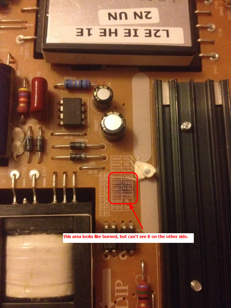

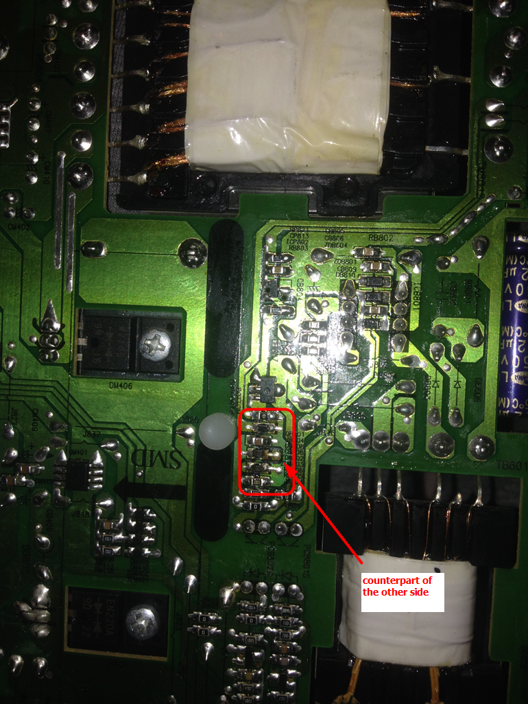

                                BTW, for the PSB, I noticed a small area looks like burned, not sure if it's where the problem is, seethe attached pics.

                                  I haven't, but I still have it.
                                  Did you force yours to turn on, without the mb?
                                  Mine turns on and the LEDs turn on as well.
