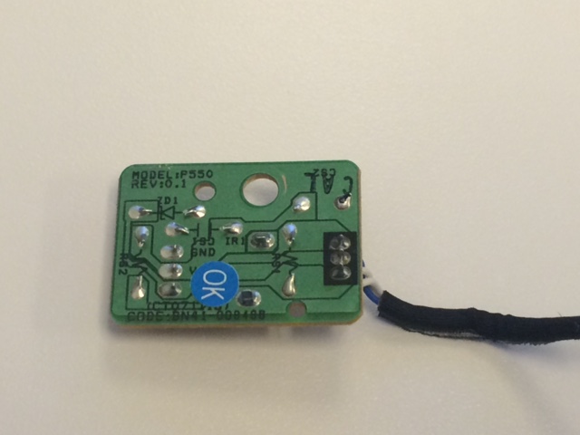

    My TV started acting odd yesterday. It doesn't respond to the remote, but it does power on with the button on the TV. Once it's on, I do get a picture, but an error message pops up that says "Not Available." I'm unable to do anything to remove the box. I can hit the menu button on the TV but it returns to the "Not Available" error message instantly. It's almost like there is a stuck button repeatedly triggering the error. I've removed the batteries from the remote, but that didn't help. I tried entering the service menu, but since the TV doesn't respond to the remote, I don't think that will work.

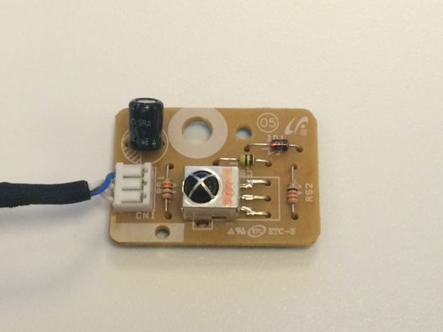

      Hamie, Thanks for the suggestion. On my set it looks like the IR sensor board connects to the button board. I disconnected the IR sensor from the button board and the error message is gone
      Now I'll need to figure out how to get the remote working again. Does it make since to replace the IR sensor board? The problem could be upstream, but that doesn't seem likely since removing this board cleared up the error message. Has anyone seen these sensors go bad out of the blue?
      Here are pictures of the sensor board. I did find some for sale on ebay.

        Hey Hamie, I ordered a replacement for the IR sensor board on eBay for $10. I put the new board in and everything is working great now. Thanks again for your help!
