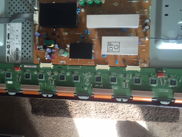

    Hi Guys,
    With your help last year, I successfully managed to track down and repair a zsus problem with this TV.

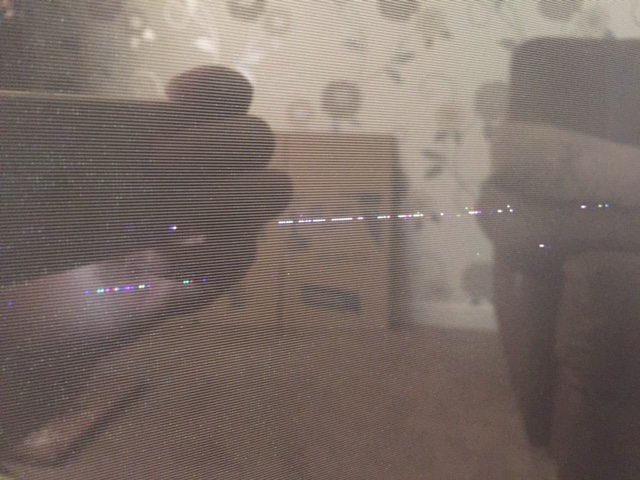

    The other night, I fell asleep whilst watching it to wake up to a blank screen with sound, and some unusual coloured dots in the top left hand corner as per image 1.
    I am about to take the same steps as I took last time to figure out what is at fault, but can anybody point me in the right direction?
    Thought it could be power related as the screen 'appears' to try to work?
    Please help - My 42" backup TV looks like a portable in comparison ....
  • Hamie
    • Apr 2014
    • 1383
    Re: Samsung PS51D550 - Sound but no picture

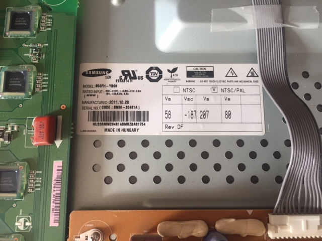

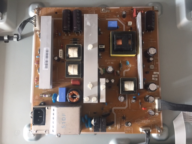

    You'll need to check and confirm voltages.
    Vs va located on the power supply.
    Vsc on the y-sus
    Ve on the x-main
    Match them to your panel sticker.
