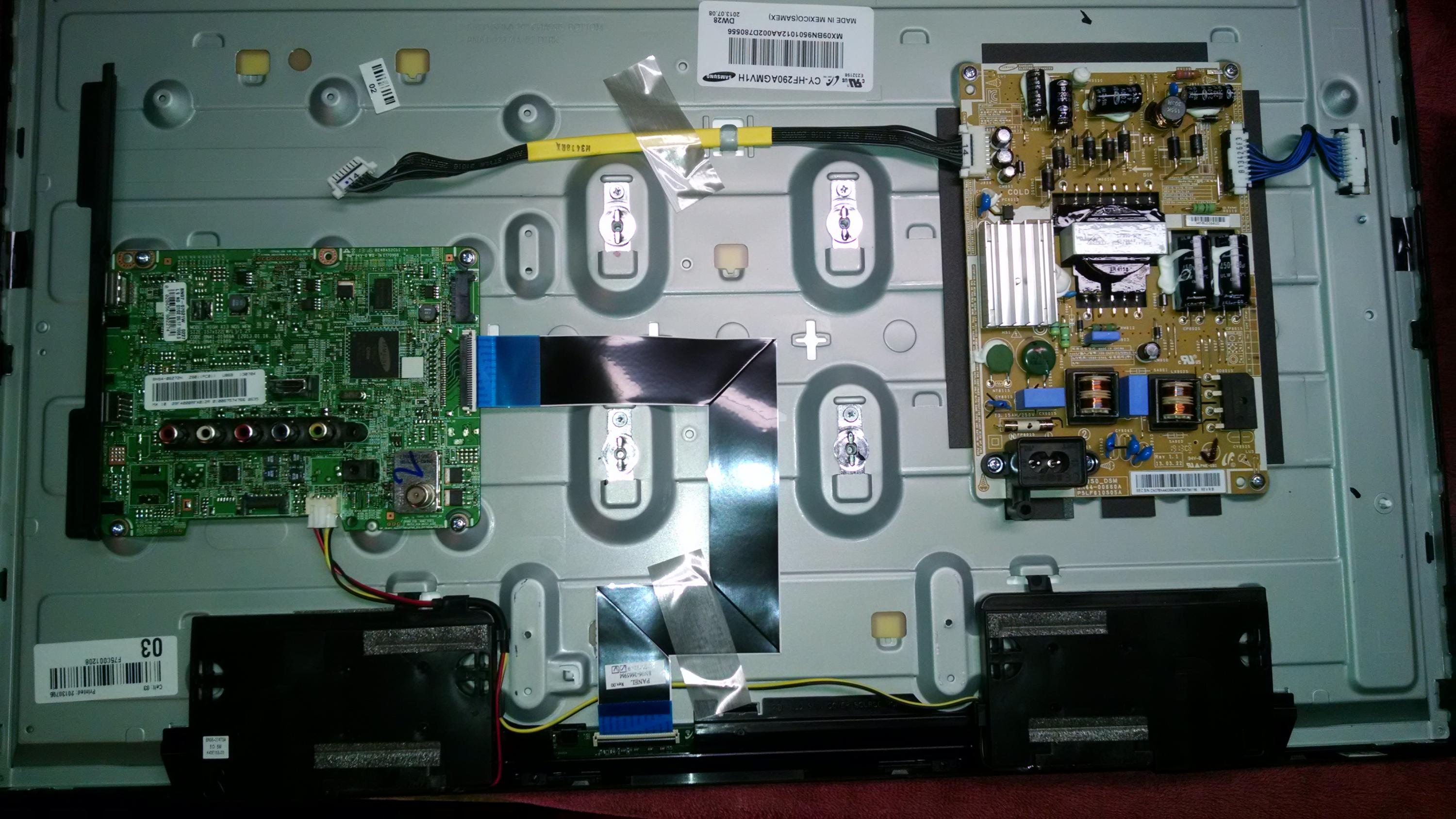

    Trying to help my neighbor out here. He has a Samsung UN29F4000AF LED TV that stopped working after a lightning storm. We've taken the back off and can't see anything obvious like a burnt area or something like that. The red light on the power button comes on when the unit is plugged in but that's it. There is no backlight as far as we can tell and we tried the flashlight trick to see an image on the screen but there appears to be nothing. It doesn't respond to the remote either. From other internet research I've done i'm guessing it's the main board but was hoping for a little guidance from someone here. Any input would be greatly appreciated.
    Thanks in advance
    Tim

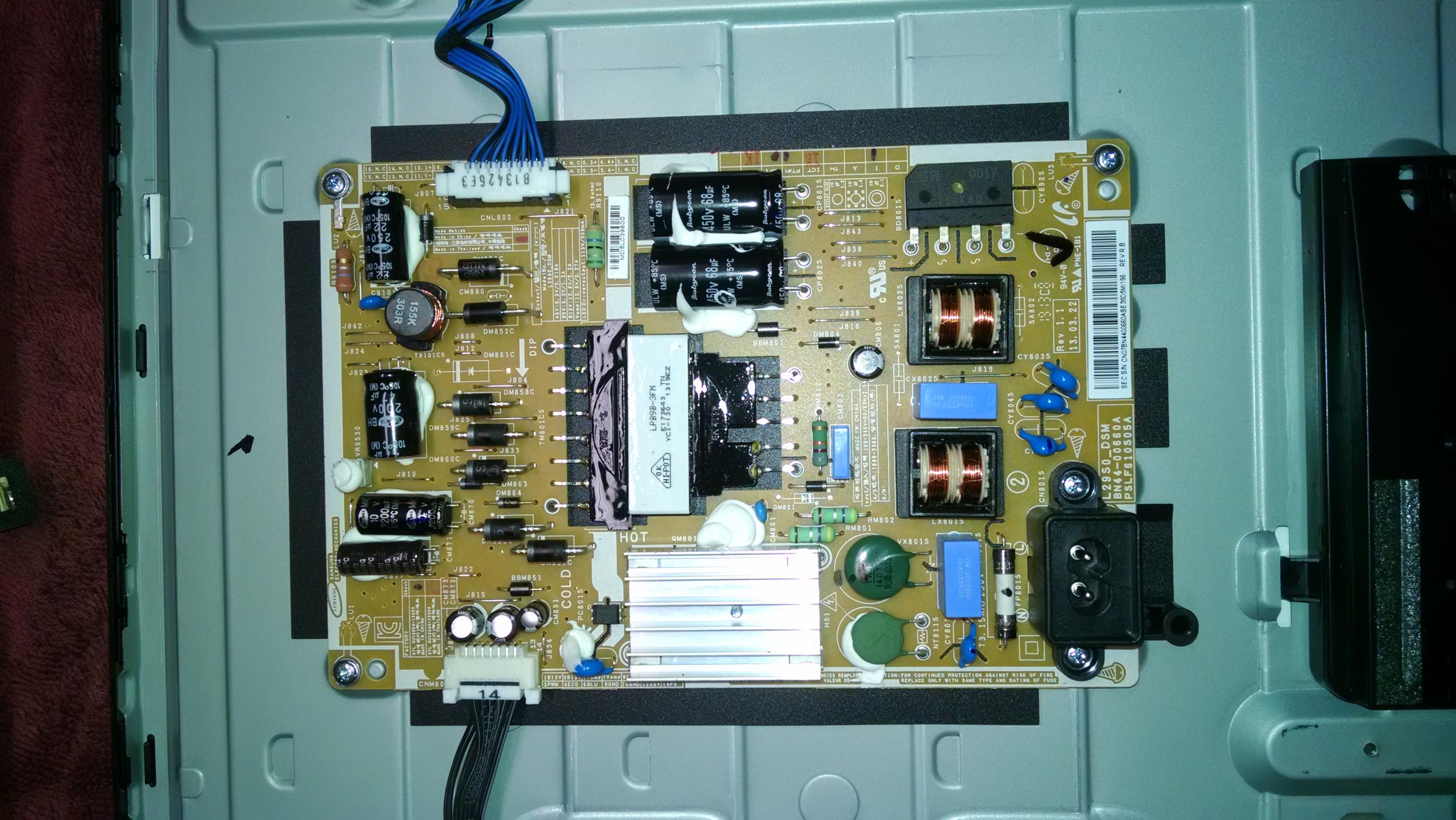

    The power supply look like this?
    http://www.paylesscomponents.com/med...91D401D26C.jpg
    Check the voltage outputs I unable to see the label from the picture what voltage supposed be.

              Ok the DirecTV box seems to be fine and it was connected to the TV with an HDMI cable. He did the test suggested by budm and the backlights came on. Checking with him to see if the boards are the same as those in the links.
                Re: Samsung UN29F4000AF Electrical Storm Damage.
                "He did the test suggested by budm and the backlights came on."
                That means you have main board problem.

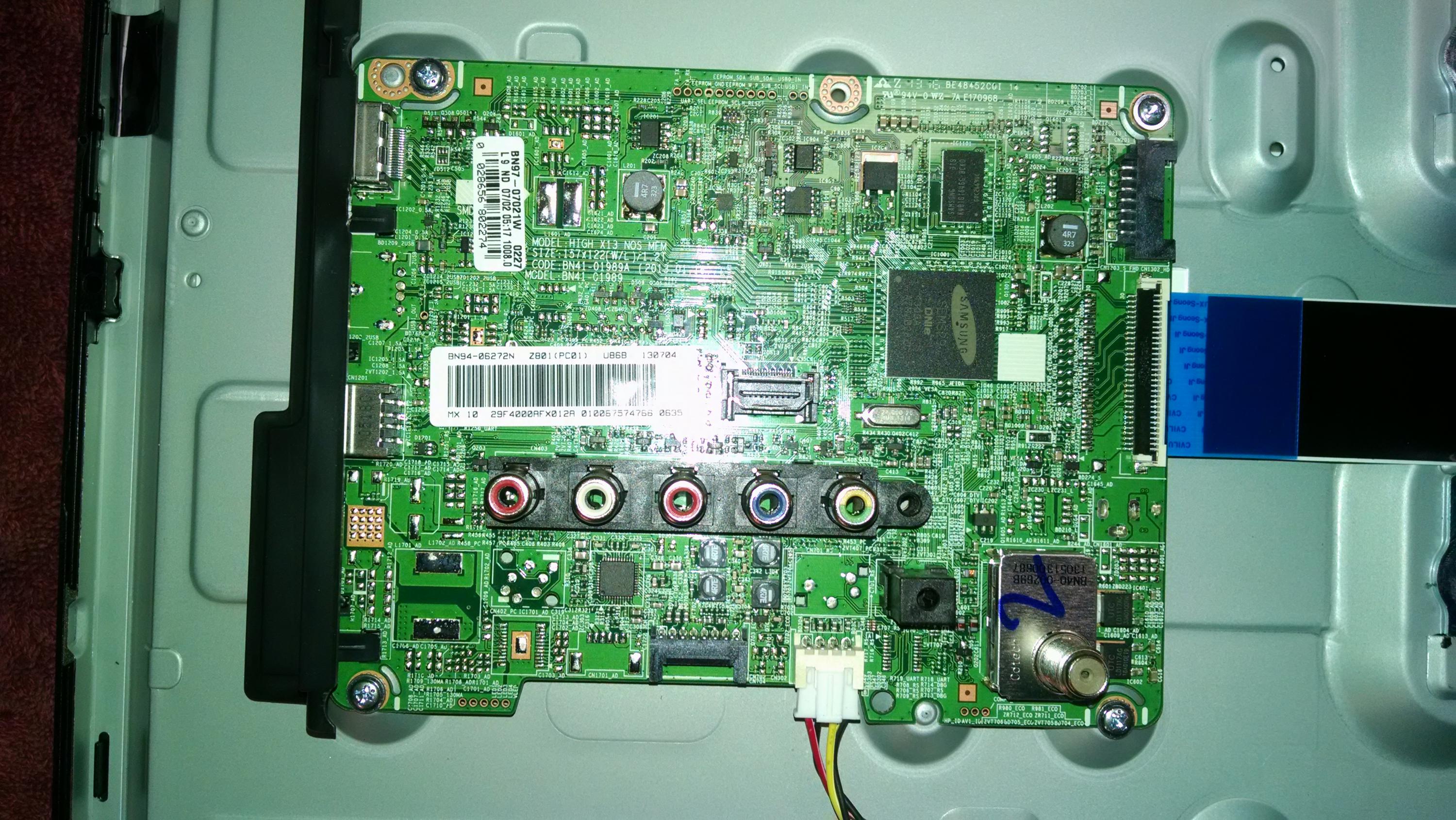

                  Here are some pics of his boards. Is it recommended to replace the mainboard at this point? If so, how do we go about determining the correct replacement. I had the same issue on a Panasonic and we had to figure the correct suffix I believe by reading a block of jumpers on the board. Would it be the same with this one?
                  • Moreno83
                    • Jun 2014
                    • 2008
                    • The Netherlands
                    You have to search for the white sticker on the mainboard.
