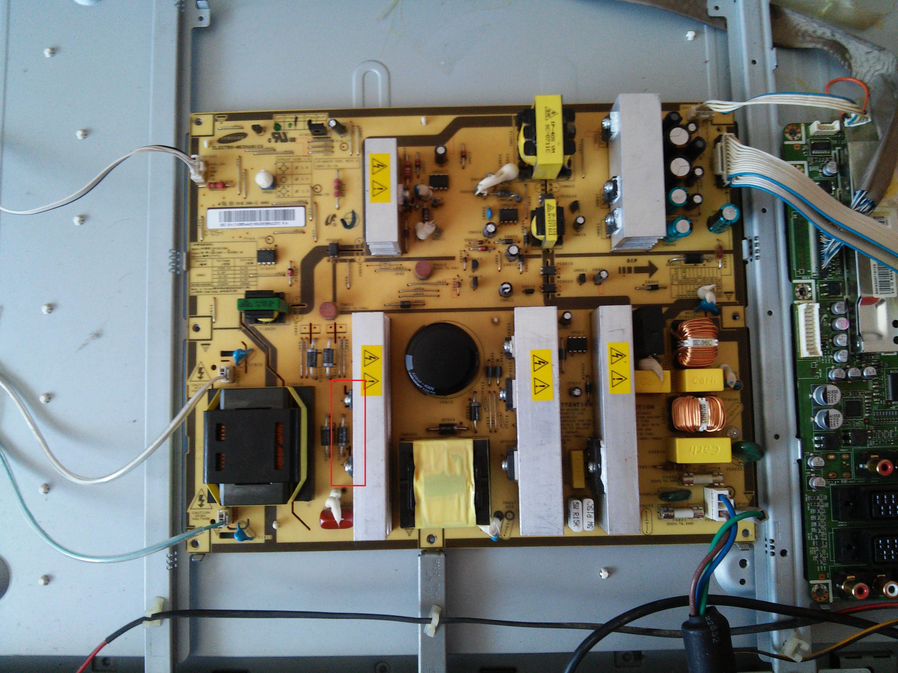

                              • synaesthesia
                                • Jul 2015
                                • 35
                                • United Kingdom
                                Re: Samsung LE40M87BDX - PSU Issue
                                The two marked here, can't remember the component numbers.
                                I had spent some time over the last couple of days learning how to test fets and diodes with limited kit and then also stumbled across a "repair kit" for this exact PSU which was for the inverter side of the board (I had seen plenty of the kits involving the caps and the mainboard eeprom but not this one) so I concentrated on testing the diodes and fets it mentioned. Can't find the list I saved annoyingly, if I do I'll post here; there were a few diodes underneath, the two fets above and the bridge rectifier.
                                  Those two Power MOSFETs are for the inverter transformer drivers.
                                    Indeed, I'd read into that and certainly explains the symptoms I had. Amusingly I had ordered a replacement PSU on eBay expecting delivery on Tuesday this week; still hasn't turned up and I'm up and running anyway
