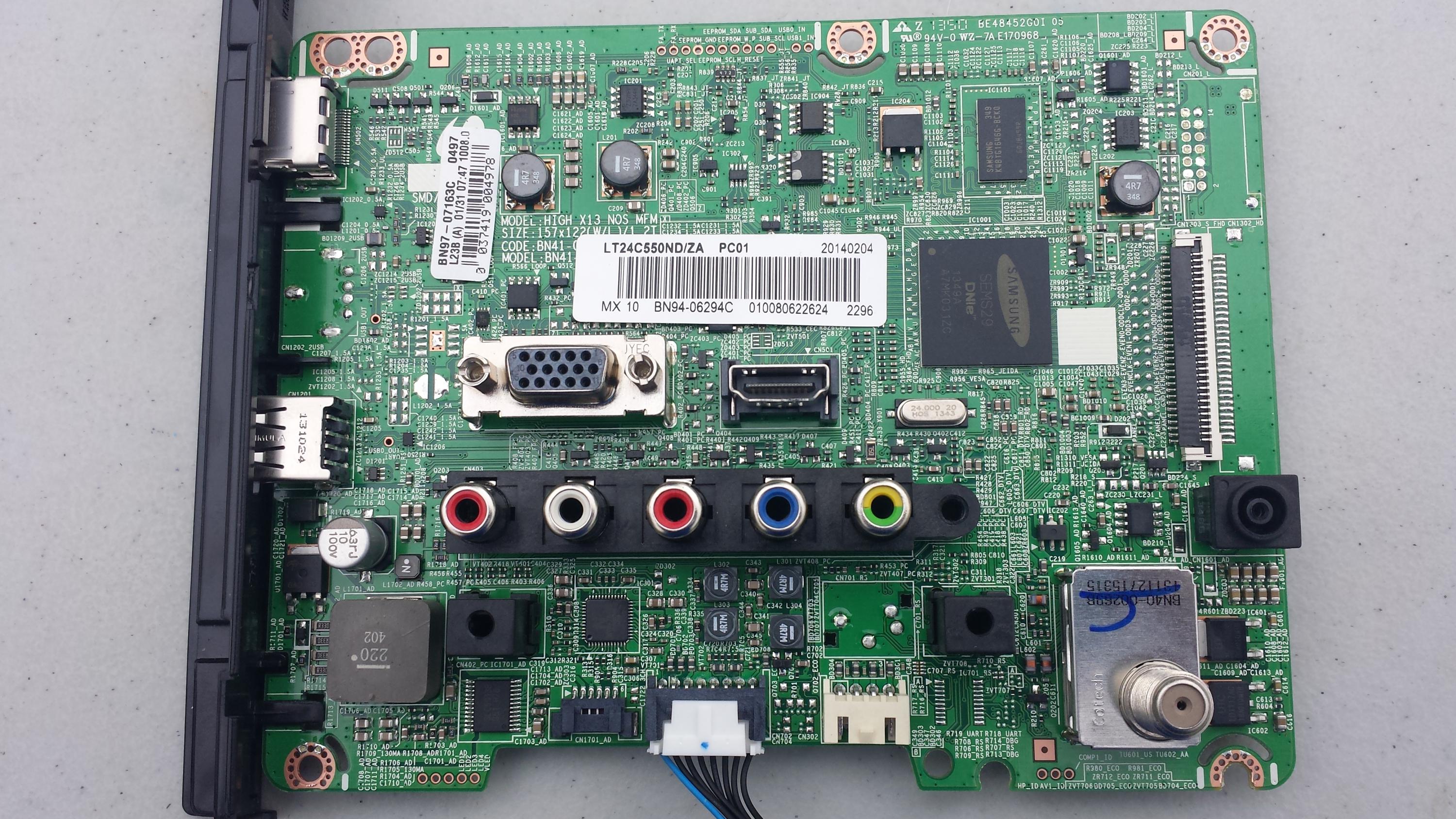

    Hello fellas.
    I have a 24 led tv/monitor with no power on.
    This tv was damage for storm and since then won't turn on.
    So far.
    I replace the power supply because the original show only 1.5volts.
    Now i have another give me 14volts.
    So, i check couple components next to power jack and i have those 14volts but the rest tv is like dead.
    Since this unit only have a power supply/main board i don't know what else need to check.
    Another thing do i check was the little power button connector and can identify any voltage on that..
    Any idea ????

    Re: Samsung t24c550 no power on
    do you have 3,3V on IC901 ?
    If yes, try to reprogram this chip !
    Read---> store ----->write the stored file again on the eeprom !
    good luck !
        0.05 volts leg 1 and 2 and 6 only
          pin 8 ---> vcc should be 3,3 ?
            pin 8 = 0volts
                    whats the name of IC901 ?
                    unfortunately i cant see it on the pic
                        winbond
                        250128fvsg
                        1349
                            Sorry no SM to find ! :o(
                            But first you have to find where the 3,3V come from.
