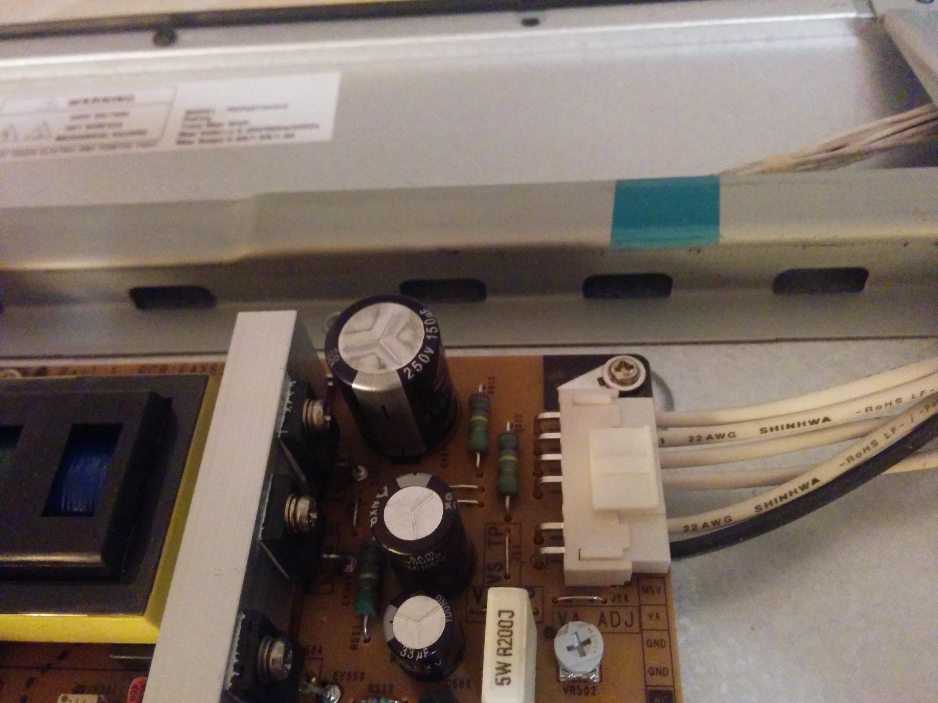

    Hi. In possession of an LG plasma, not working, and a shiny new multimeter. Am a newbie but keen to learn and hopefully rescue this TV, if possible, and sensible. Only previous experience since school is the occasional resoldering.
    Model LG42PT353K-ZA.BEKLLJP
    Manufactured 2011, Poland.
    Was working without fault till a audible pop/bang and picture failed. I wasn't using the TV at the time so don't have any more detail about the moment of failure.
    Now when try to use, the standby red light is lit, and powering on with remote results in a click, and a whirr, but a click 'off' again moments later back to standby.
    There is no picture during this.
    I have read tom66's excellent guide to troubleshotting plasmas and hence starting this thread.
    One of the first things I'm asked to establish is if the sound is working or not. To be honest I'm not sure how I would do that? How can I test if there's sound given the TV doesn't fully power up, and there is no picture? (As in, even if TV stayed 'on' how would I know I should be hearing anything?) The TV has been broken, unplugged and idle for months now.
    I've opened up the case and checked all recognisable fuses and they're all working. The only component that looks like it may have failed is a 150 microF capacitor on the top right of the power board, near the test points. The 3 sections are slightly raised to the touch, and discoloured. Photo attached. Should swapping out this component be my first course of action? (I only spotted this capacitor while writing this post- have waffled a bit if it is the only problem).
    Any help appreciated, even if it's just to say don't bother, but I hope not. I'd like to be able to diagnose the problem properly even if it's not worth fixing.

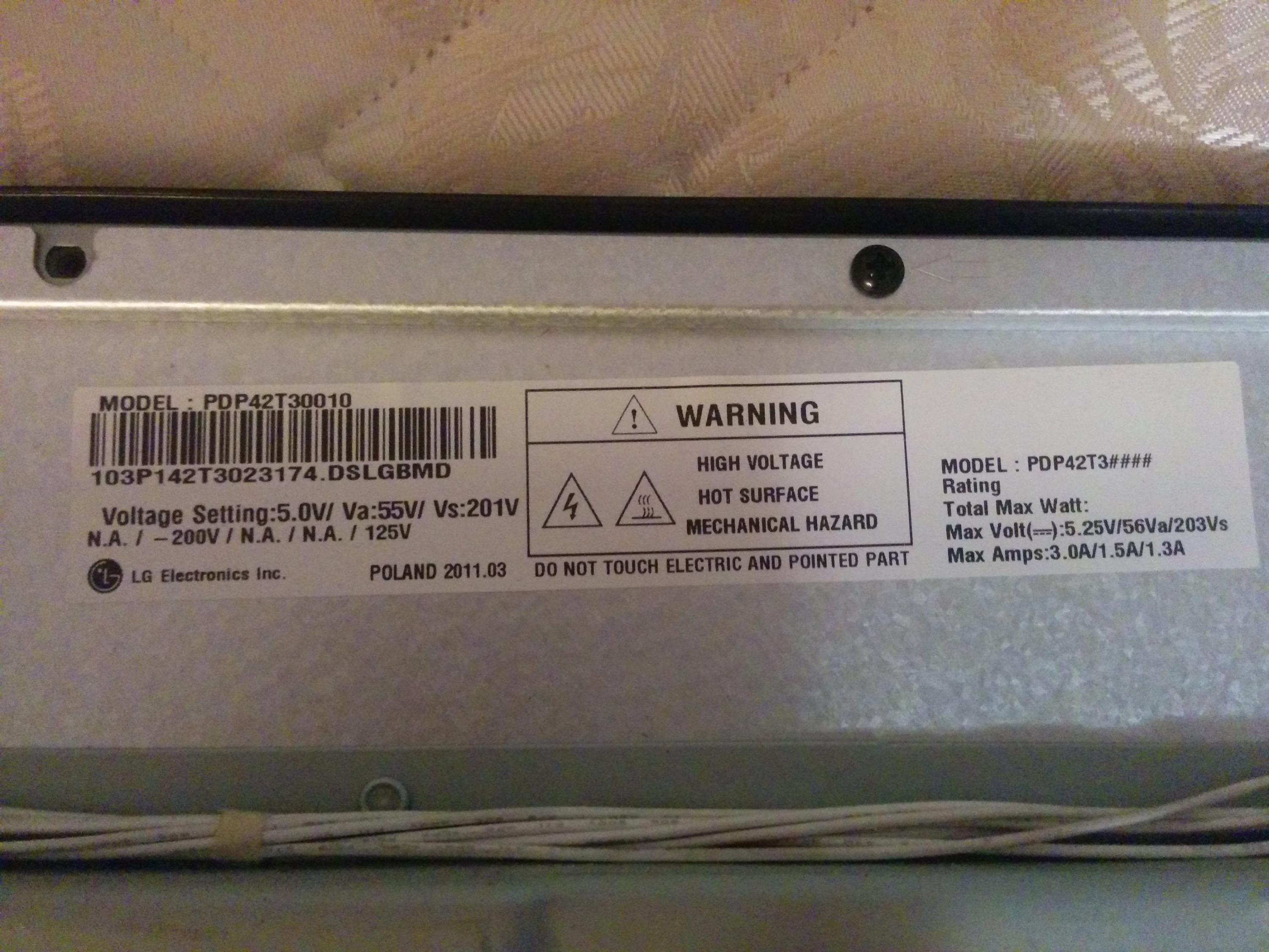

            With the y-sus still disconnected I tested at z-bias resistor, which was switching between 125.1V and 125.2V, so almost matching 125V on the sticker.
            I'll disconnect the buffers next, will need to unscrew the buffer board from chassis.
            What do you mean by 'cycle' though? As in it seems to switch on and stay on?
            The panel sticker has N.A. for VSC, if I'm reading it correctly (photo attached).
            I also can't see a VSC or VSCAN written anywhere.
            ReeceyBurger123, yes I have a multimeter with a diode/continuity test setting with beep. I'm not sure the procedure to test for shorts though.
              Re: LG42PT353K plasma troubleshooting
              Your -Vy is -200V. Vsc is not printed but is probably around 140-160V, that is a typical range. Vzbias is 125V.

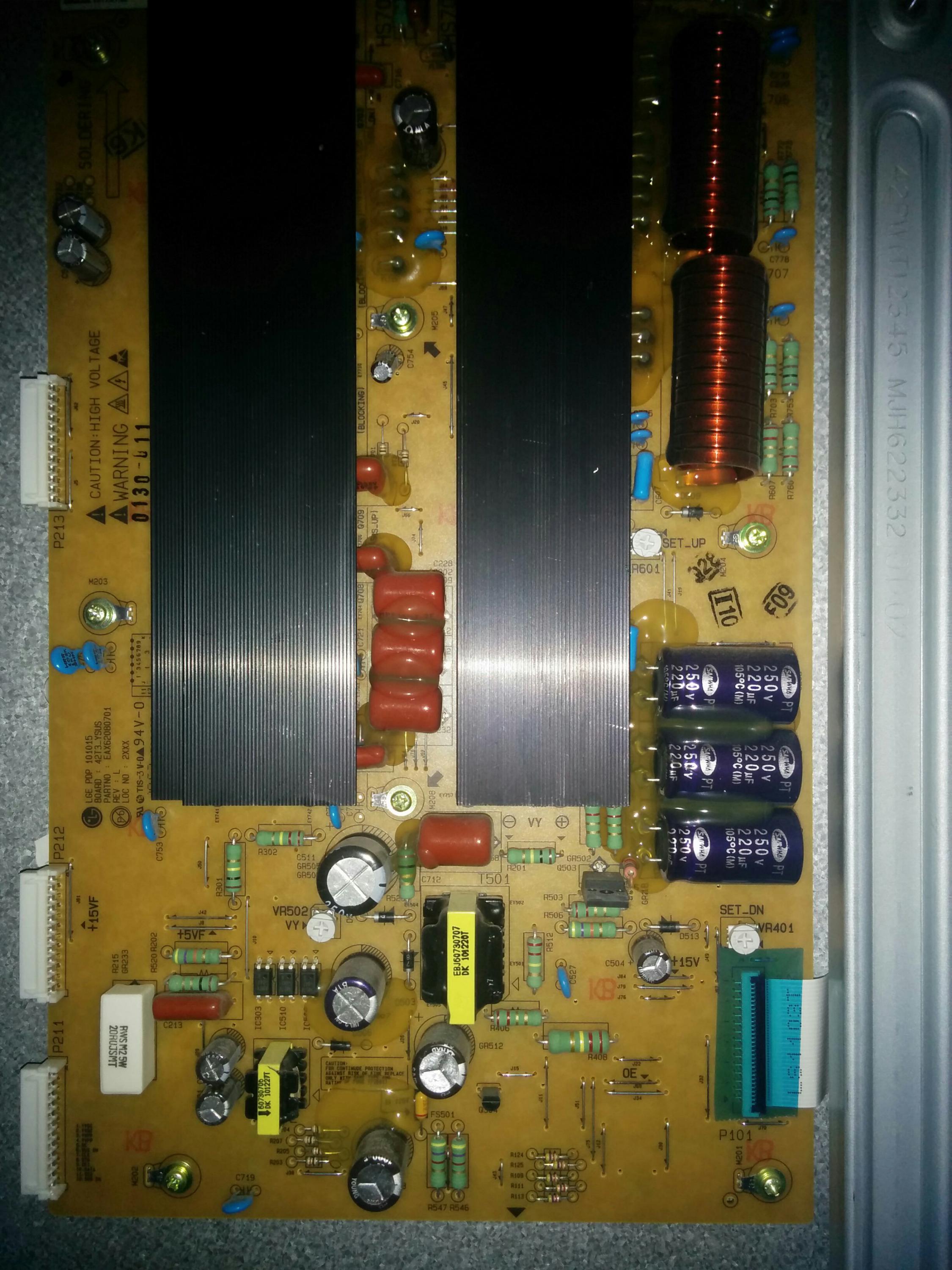

                Also I still don't know where to test for VSC on the board. I'll attach a photo.
                Would the reserve side of board be marked for this? I guess it would be less awkward to test on that side too.

                  You don't need to check -VY as the TV is still cycling.
                  The fault lies in the y-sus.
                  Take a picture of this board

                    • Hamie
                      • Apr 2014
                      • 1383
                      The 2 black heatsinks.
                      Get your meter in diode mode and touch the legs of all the diodes fets etc attached to the heatsink. If you get a short reading remove the parts and check them out of circuit.
                        Hi. Just to update.
                        I eventually removed one heatsink, with great difficulty and after purchasing a new soldering iron (I previously was still using my Grandad's iron from 1970s with the original, and non-replaceable tip). The solder just wouldn't get hot enough to wick/suck away, and I'm certain my desoldering technique needs work!
                        I'm very chuffed with my new iron though, it is amazing compared to how I've struggled for years when I was younger fixing guitars and the like with the old one. But still the solder wouldn't come away easily till 390-400degC which just seems far too high (is it?). I guess these boards aren't manufactured with any concern for manual tinkering later.
                        In the process of removing the first few transistors and diodes I snapped the drain pin of one, and the next think I may have burnt out just from the desoldering process itself.
                        I'm just back from holiday and now in the middle of moving house for myself and various family members so it wasn't the best time for this sort of tinkering.
                        I gave in a bit and swapped in a replacement Y-sustain board (£45) and the TV now works, good as ever. I slightly tweaked a couple of voltages to match the chassis label too before packing up, though they were all within 0.5V already.
                        I can use this duff Y-sustain board to learn on (when I'm done renovating my new place), and then, or if/when something else goes bang I'll be back I'm sure.
                        Have already learned a lot, enjoyed it, and saved a few quid.
                        Thanks everyone!
