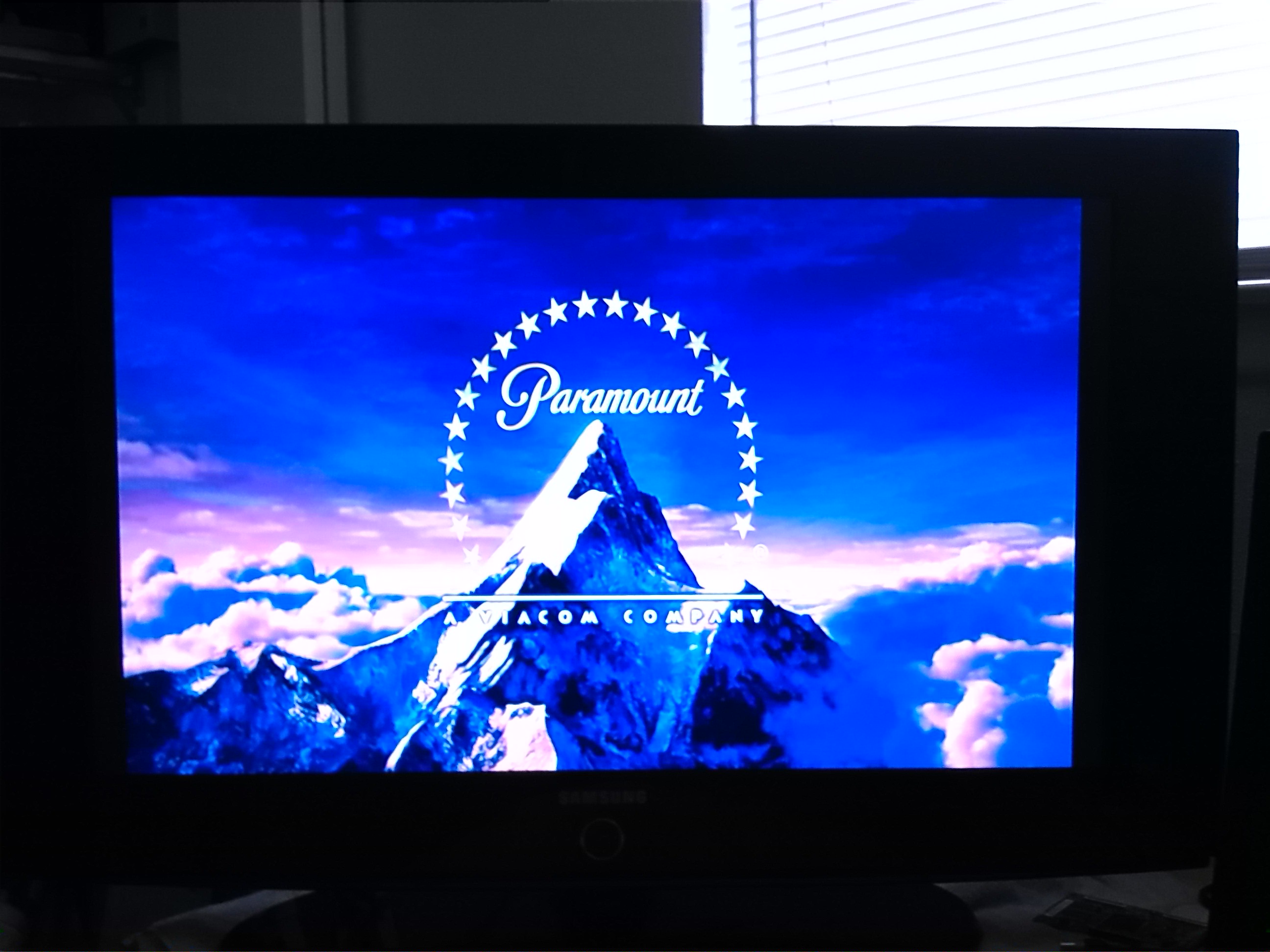

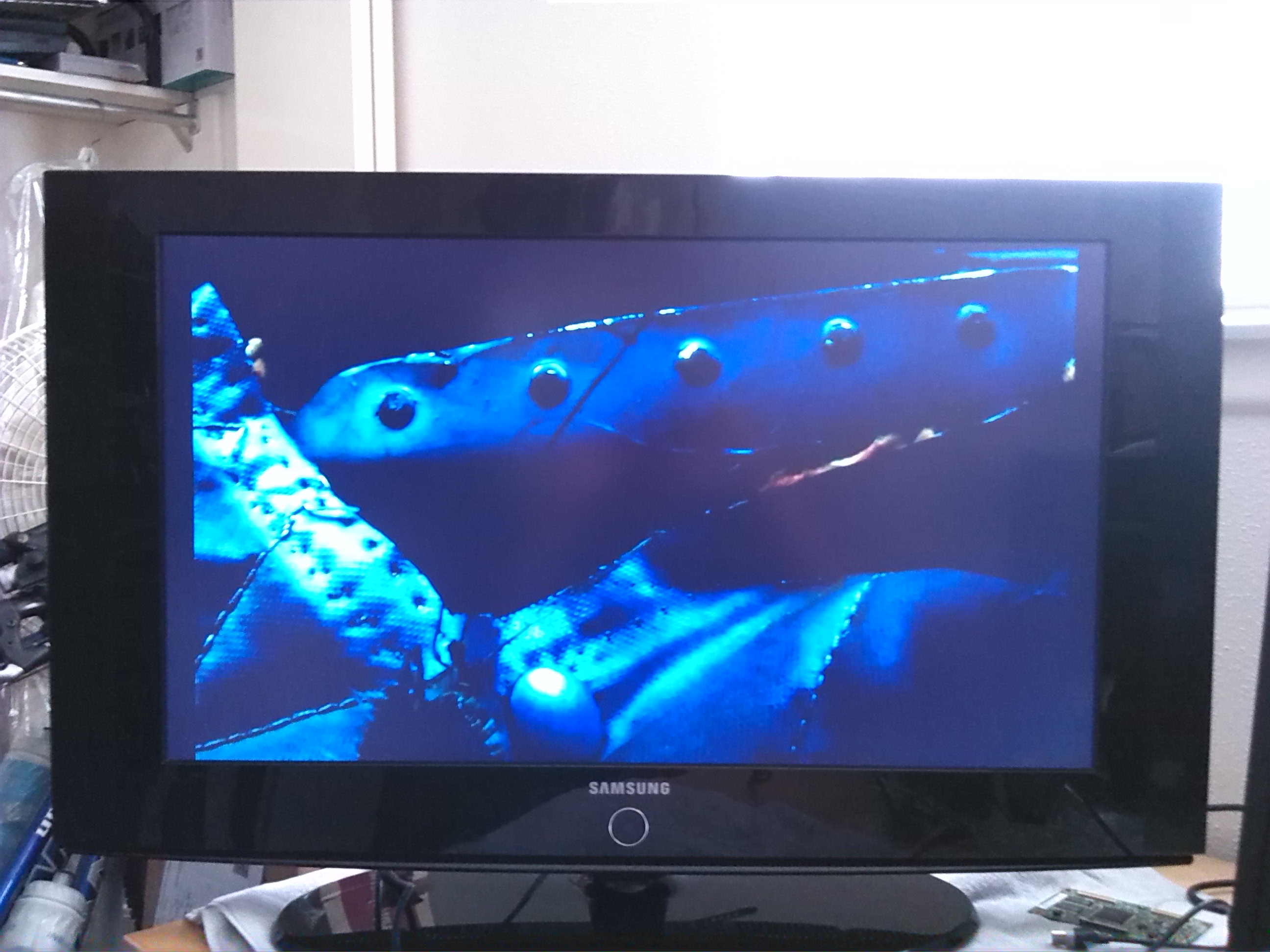

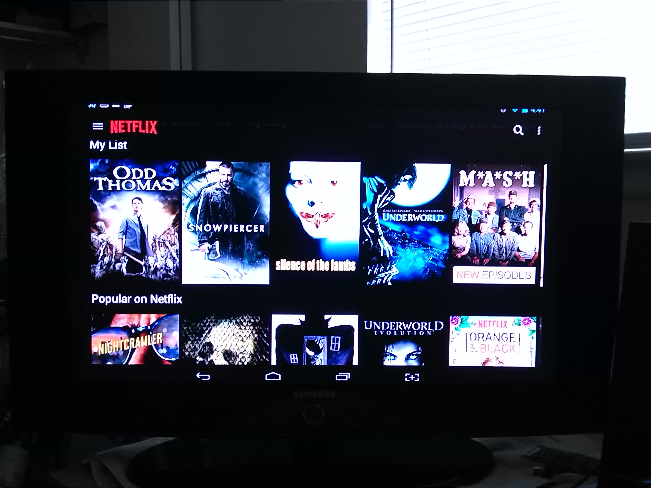

          Anyway, I figured that since there was no response from the volume or source buttons, the main board is probably bad. I ordered a main board off Ebay part# BN96-07892H which is a substitute part number. Plugged TV in and I heard the chime and the screen came on with snow, finally! I put the original T-CON back in that came with the TV, and it works fine.
          It must have been the main board all along.

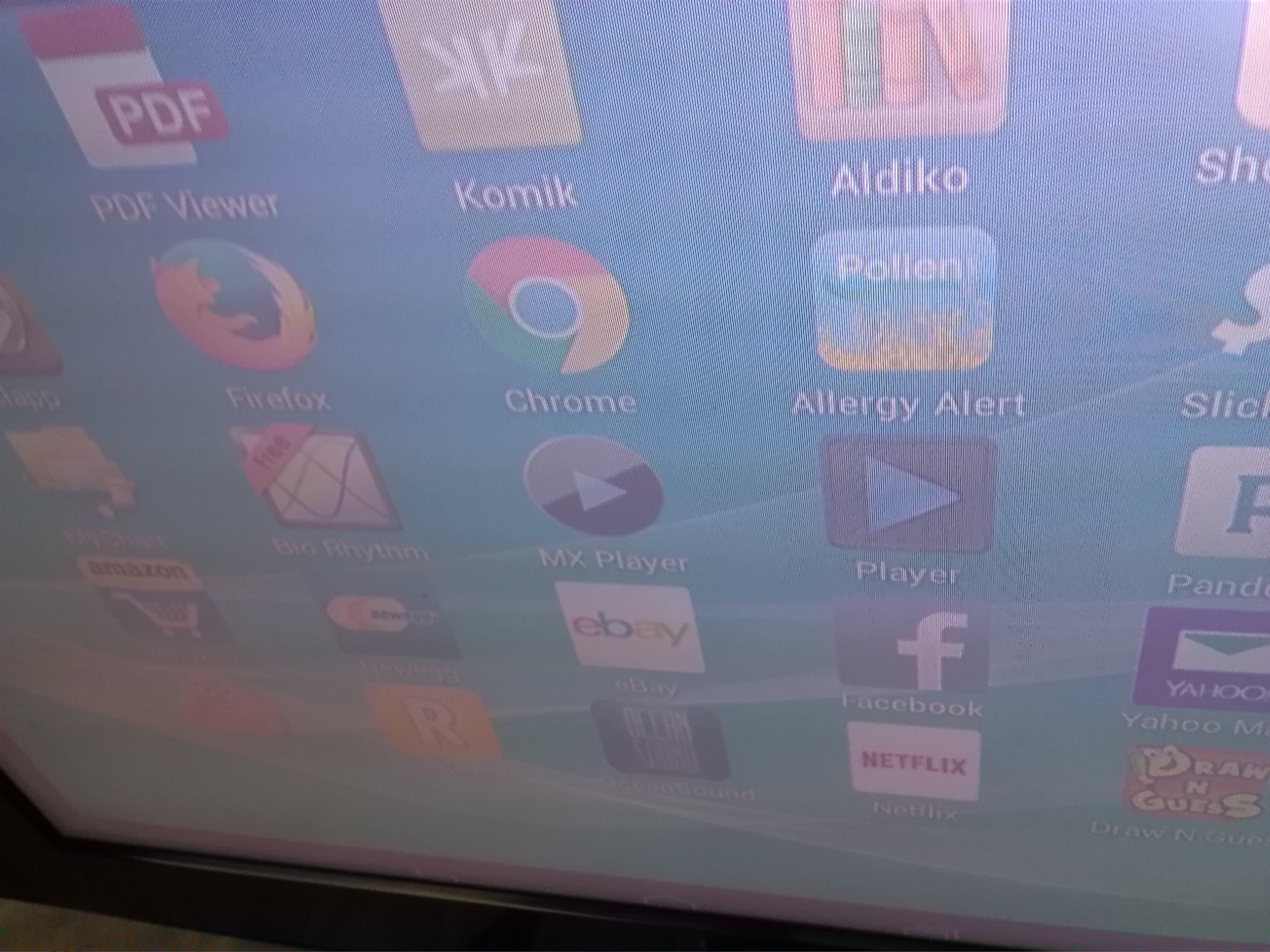

          I tested that first T-CON they sent me that showed an all white screen and it showed an image but like it was faded and all white. (Last picture). So it looks like we made the correct assumption that it was faulty.
