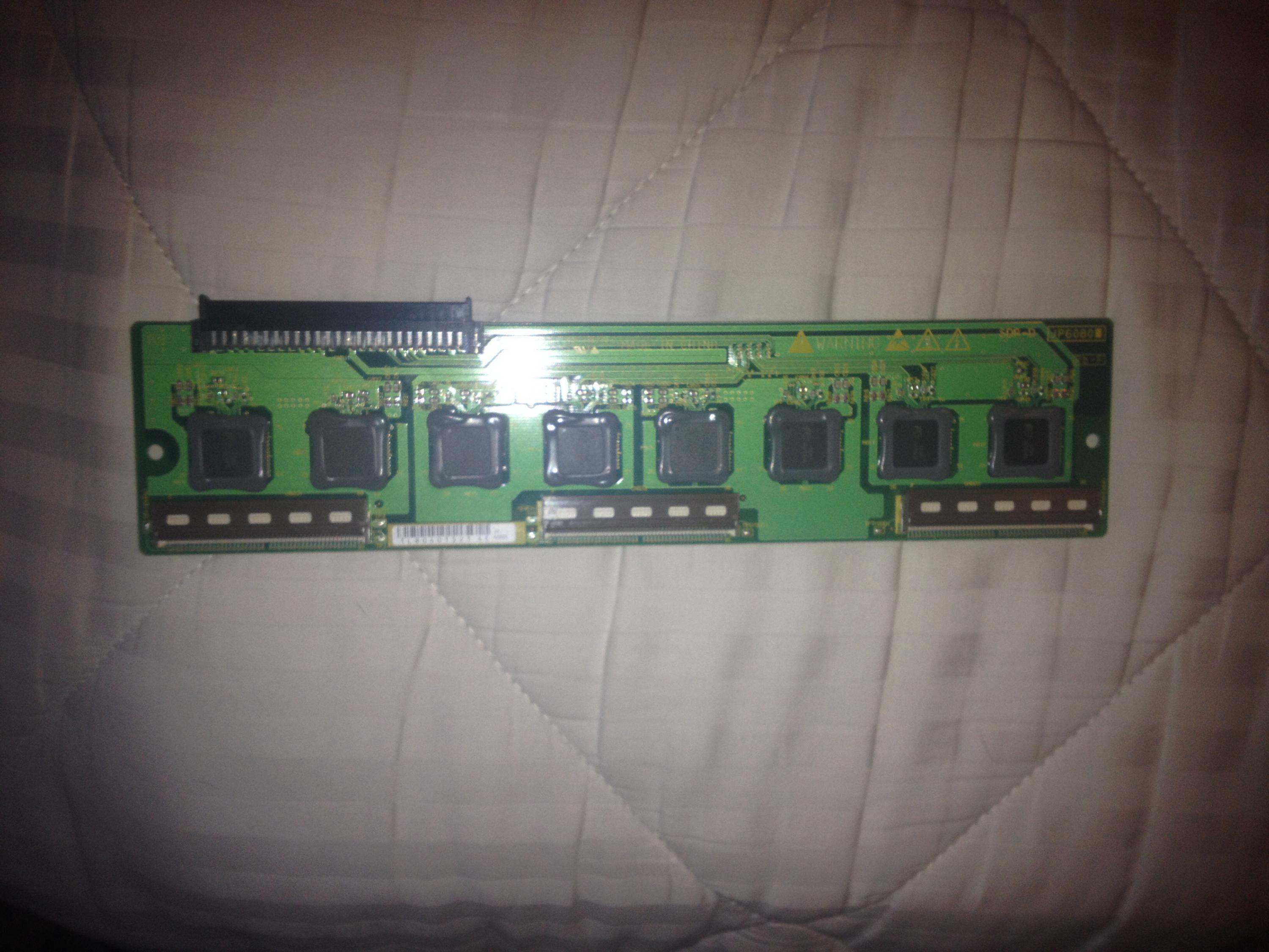

    Im going to attempt to repair this sdr d buffer off a Hitachi Plasma Im working. I have already verified the tv works with the board out of circuit. I am not finding and pin holes in any of the 8 ic's on the board. My question is how to I test which ic is bad? There is only 3 ribbon connections and 8 ics. I would understand there were 4 connections >2 ic's per connection.

    Re: Hitachi 50" Plasma Buffer board question
    https://www.youtube.com/watch?v=51SZsfH60EY
    Use the same procedure as shown ,your board will be slightly different but the same principle applies
