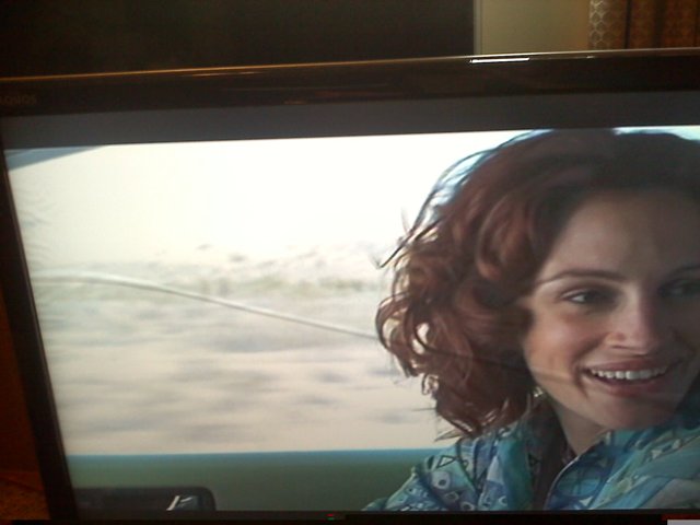

    Hi. I have a Sharp Aquos LC-42D64U with a line across the screen. I took it apart and the LCD screen is 100% intact and not cracked. Behind the screen there is a transparent backing of some type. Behind that are the actual back lights. This transparent backing is starting to separate and bubble. Down the whole left side of the screen it's starting to peel away as you can see in my picture. I've seen some TV's where there are multiple backing layers but this one just has a big thick one. Does anyone know where you can buy a sheet of this stuff and have it cut to size? Thanks.

    Probably nowhere.
    I had missing those, in a 65" that I have picked up and repaired, and I could not find these diffuser sheets anywhere.
    The back light tubes, were showing through the LCD, without them.
    Since yours is much smaller, you could try another broken screen TV's sheets.
