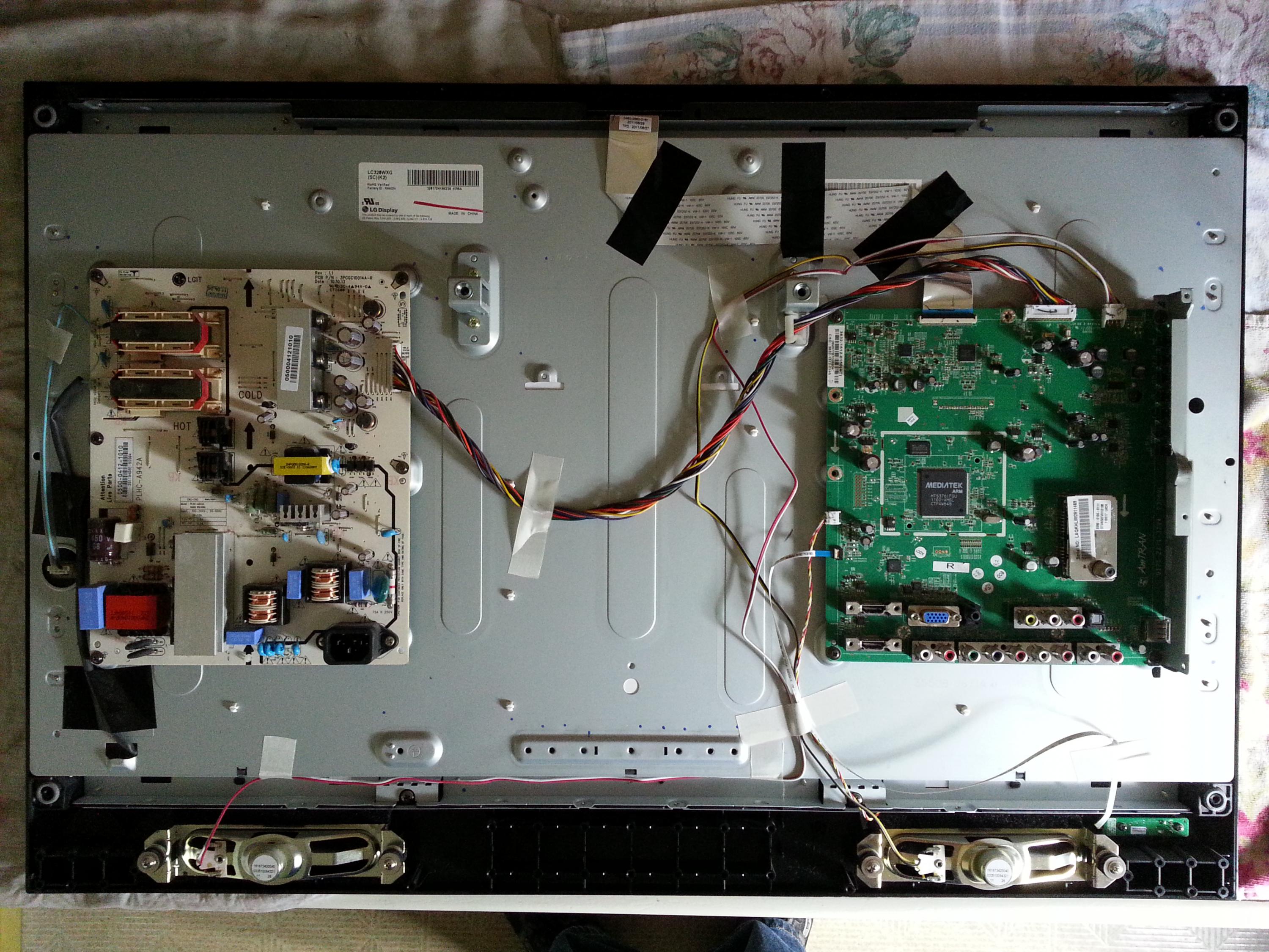

    I'm working on a Vizio E321VL LCD television that powers on and off okay and lights the backlight, but doesn't put anything on the screen. Could this be a T Con issue? If so, I'm having trouble locating the T Con board on this unit and was wondering if anyone could help point me in the right direction.

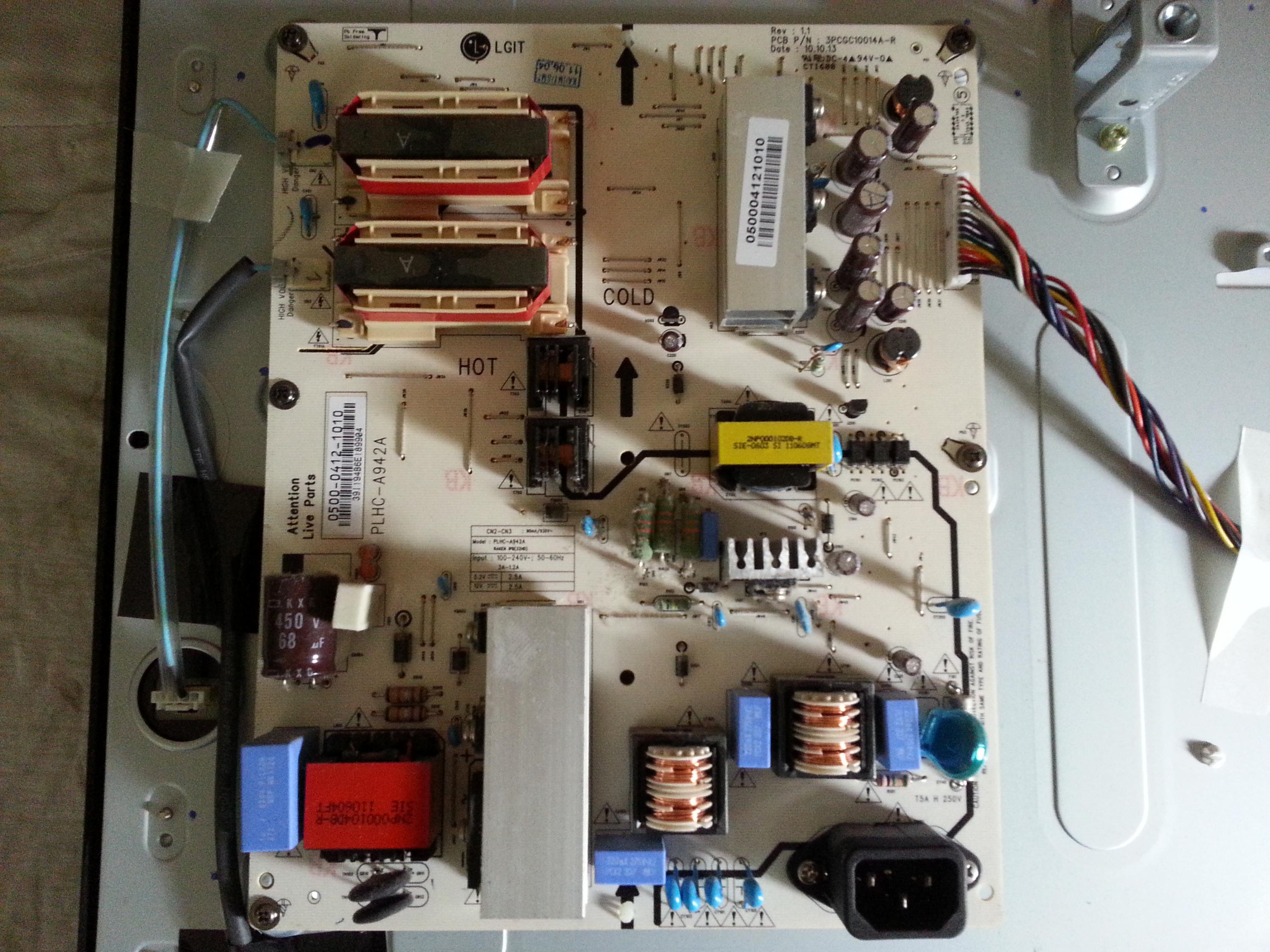

    It has integarted T-CON into the LCD panel assembly.
    You can try and see if you do have 12Vdc at least at one of the pin of the connector that goes to the LCD panel when TV is tured on.

      Pins
      How do I know which pin to test?

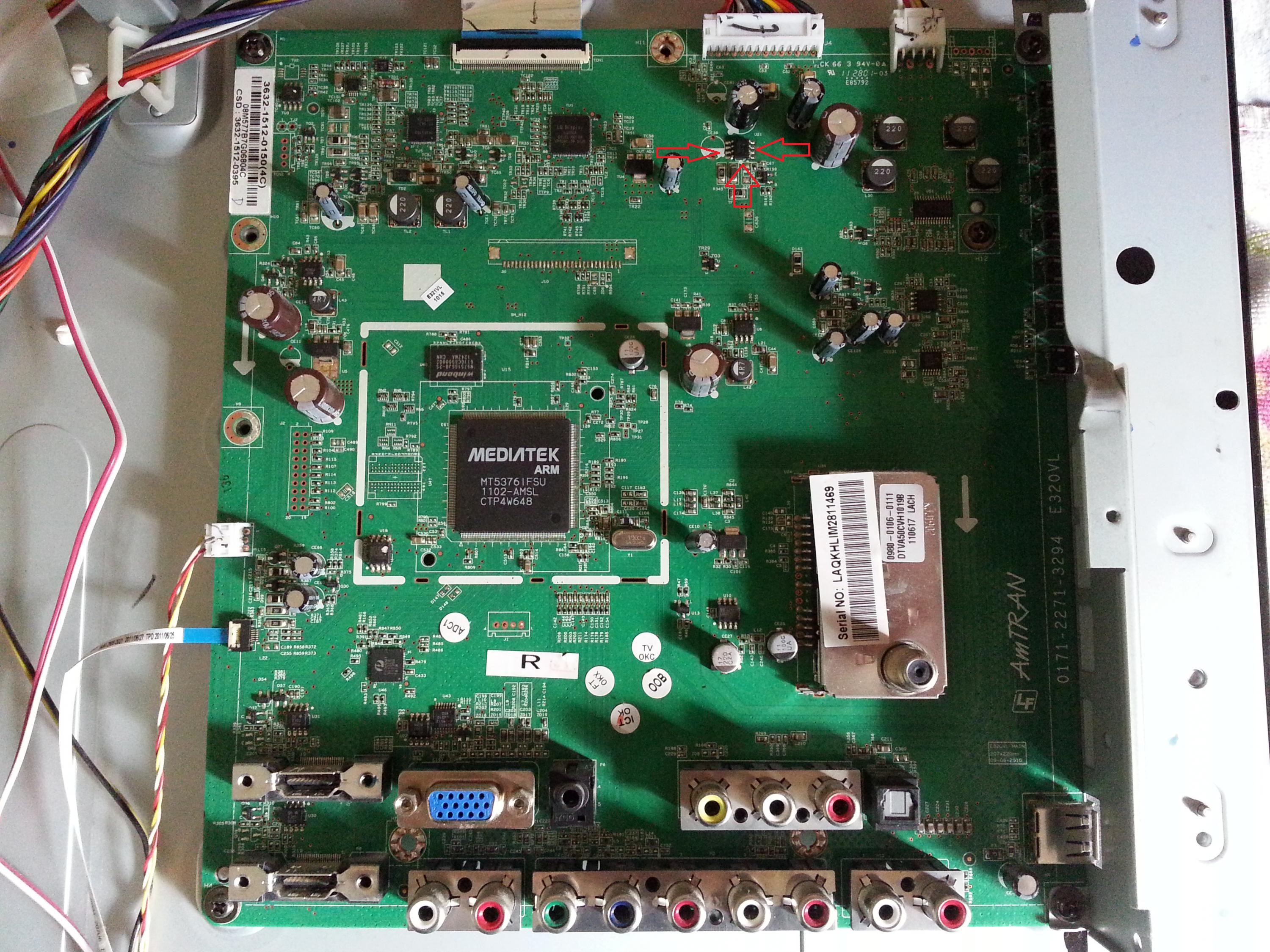

        You may have EEPROM problem.
        http://www.shopjimmy.com/vizio-3632-...repair-kit.htm
        Verify your board P/N.

          Check U21 its a MOSFET pin 5 to 8 is all connected, I believe is feed the T-CON circuit.
          do you get any sound?

            differential diagnosis
            Originally posted by ecking767
            if your TV is turning off and on it may not be eeprom related.
            I'm sorry, I should have been more specific. I meant to say that the set responds normally to the power button.
            Check U21 is a MOSFET pin 5 to 8 is all connected, I believe is feed the T-CON circuit.
            How would I go about checking those pins?

              Re: Vizio E321VL LCD - has backlight, but no video
              So it doesn't power off by pressing the power button?
              you need a multimeter to check voltages on that MOSFET
              To check for sound ,connect something to one of the HDMI PORT and power on TV, wait about 20 second to allow the TV to pick up any signal, turn up the volume. then do the following:
              using your remote you can scroll through the inputs:
              press "input" then the down arrow, then enter. wait about 5 to 10 seconds.
              do this about 5 time (5 INPUTS)

                  if the TV is powering ON and OFF then trying to get sound will help a lot in troubleshooting
                  No remote then press the input button twice and then wait 10 sec.
                  red probe on any pin 5 to 8 of the MOSFET and black probe to ground

                    Results
                    All right, now we're getting somewhere. Using that technique, I was able to confirm that sound is indeed working. After testing, the MOSFET at U21 is showing no voltage on pins 5 through 8. Does this mean the component is bad and that I should get the replacement unit from ShopJimmy?
                      It may mean that the MOSFET is not getting the signal from the processor to turn it on, or there is no Voltage on the input side of the MOSFET.

                        diagnosis confirmation
                        Does that mean I'm looking at a bad mainboard then?
                          You can try to verify the MOSFET further but you need to get the spec sheet to get the pin out and see which pin is the Gate, which pin is the Drain, and which pin is the Source.
                          At this point you do have problem with the main board.
                          • SurrealMustard
                            • Jan 2015
                            • 486
                            • The United States of America
                            Win!
                            Good call, mainboard was the culprit.
