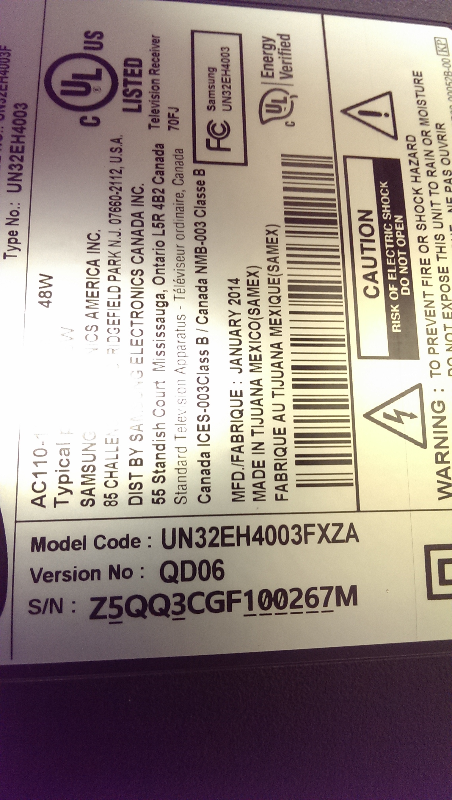

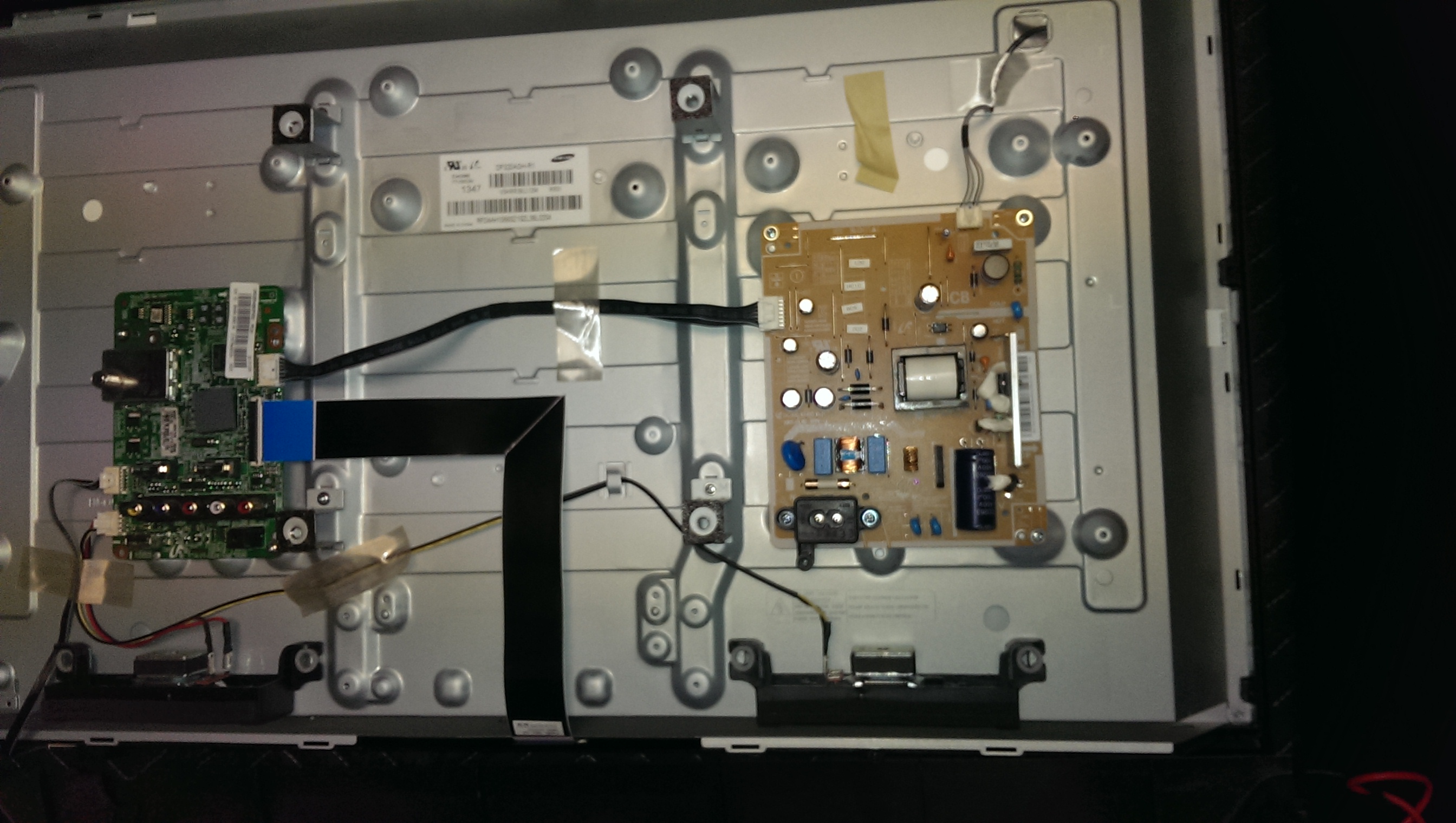

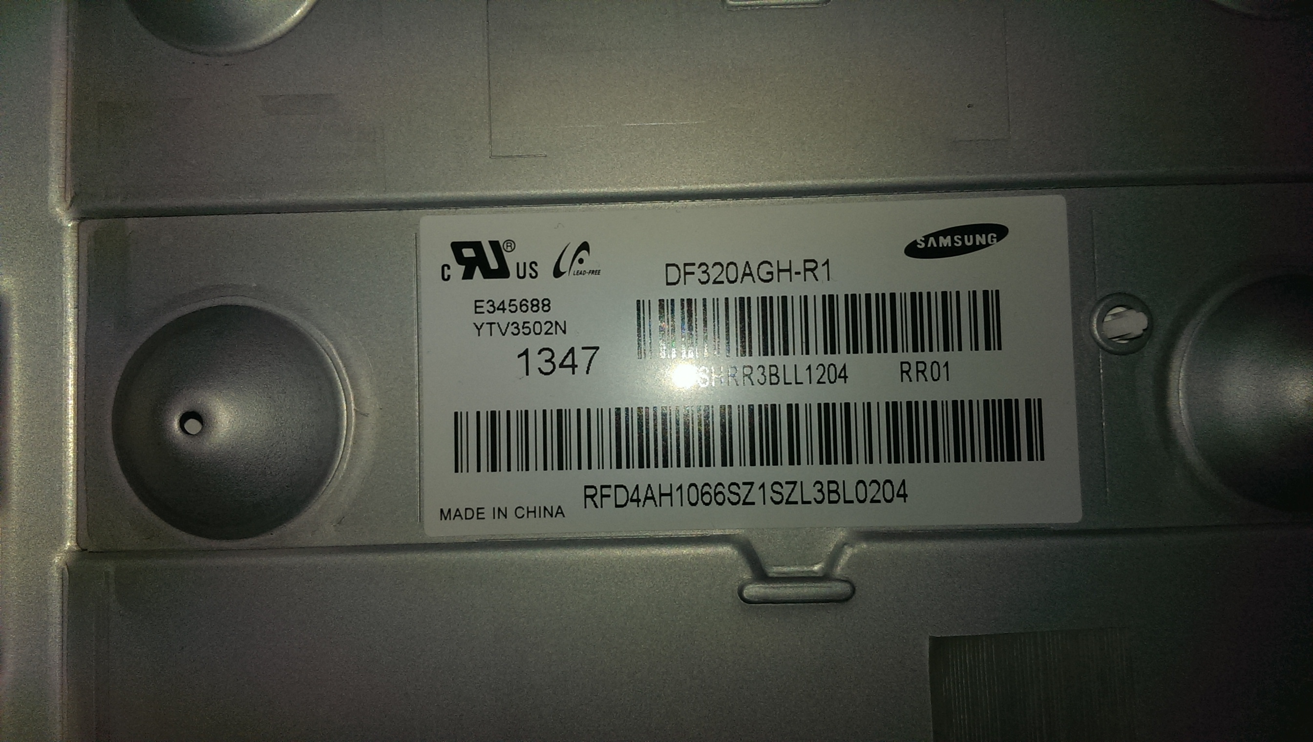

    Have this 32 inch sammy, no backlight I can faintly see static. Changed the power supply and main board no change. Could the backlight itself be out? Tried getting the backlight to come on by disconnecting the mainboard cable from the power supply also nothing.
    Re: Samsung UN32EH4003FXZA no backlight
    Most likely the LED strips have failed
