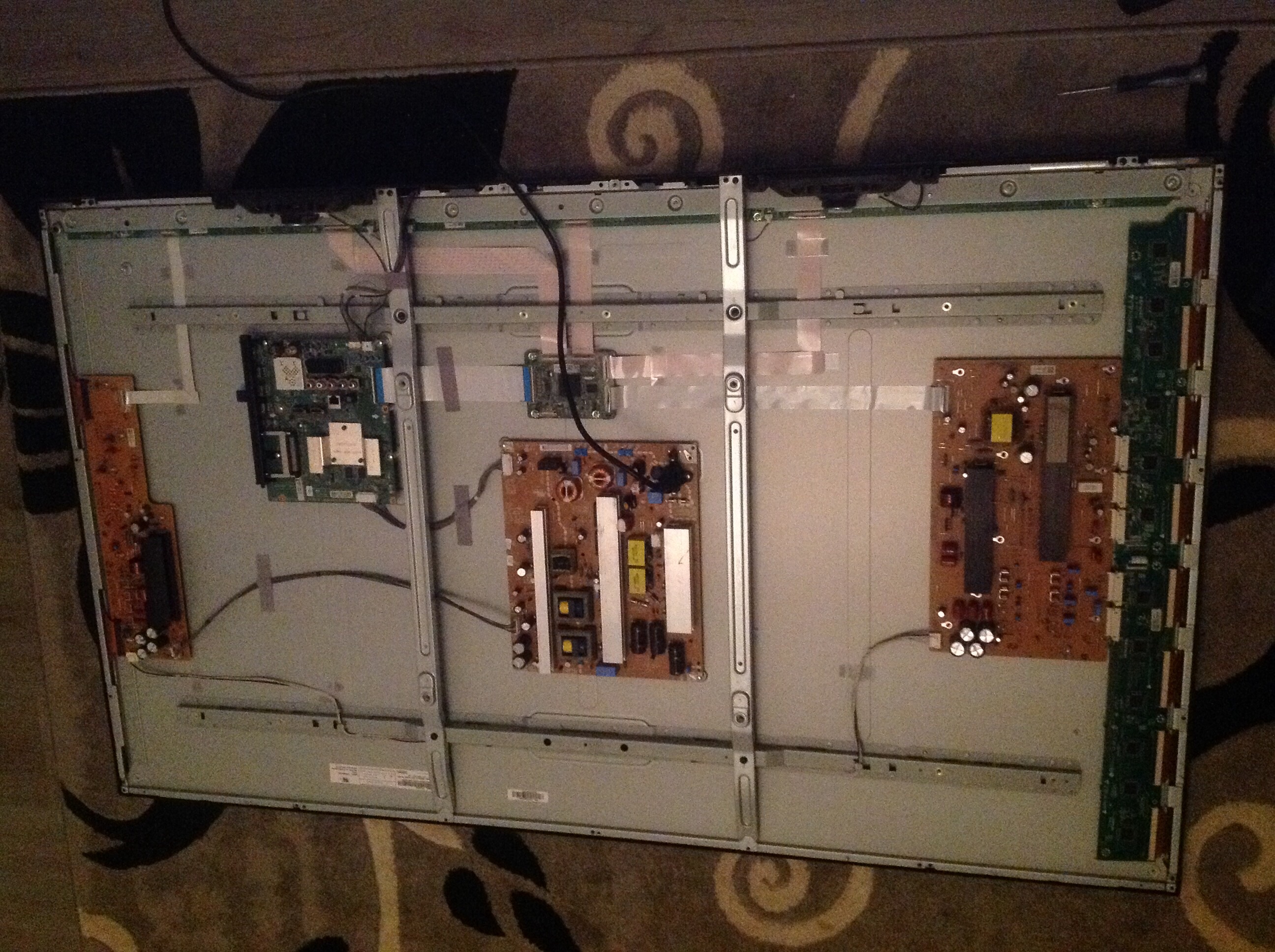

    Re: Who's good with plasmas. Description below Lg60pb6600v plasma tv
    Ysus is shot.
    Pics of your boards and overall layout
      Pic

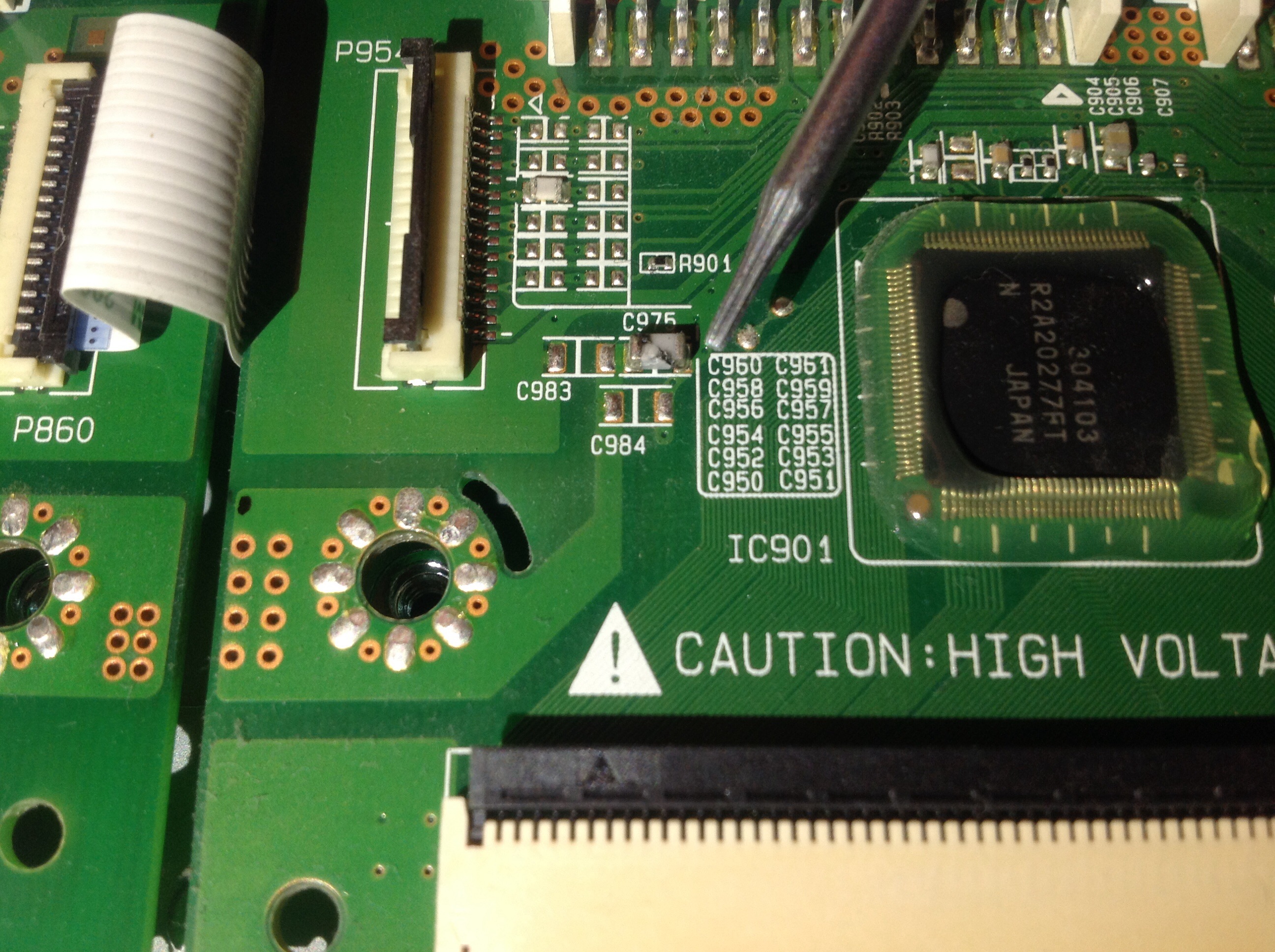

        Small cap looks busted on lower buffer board could that cause tv to shutdown

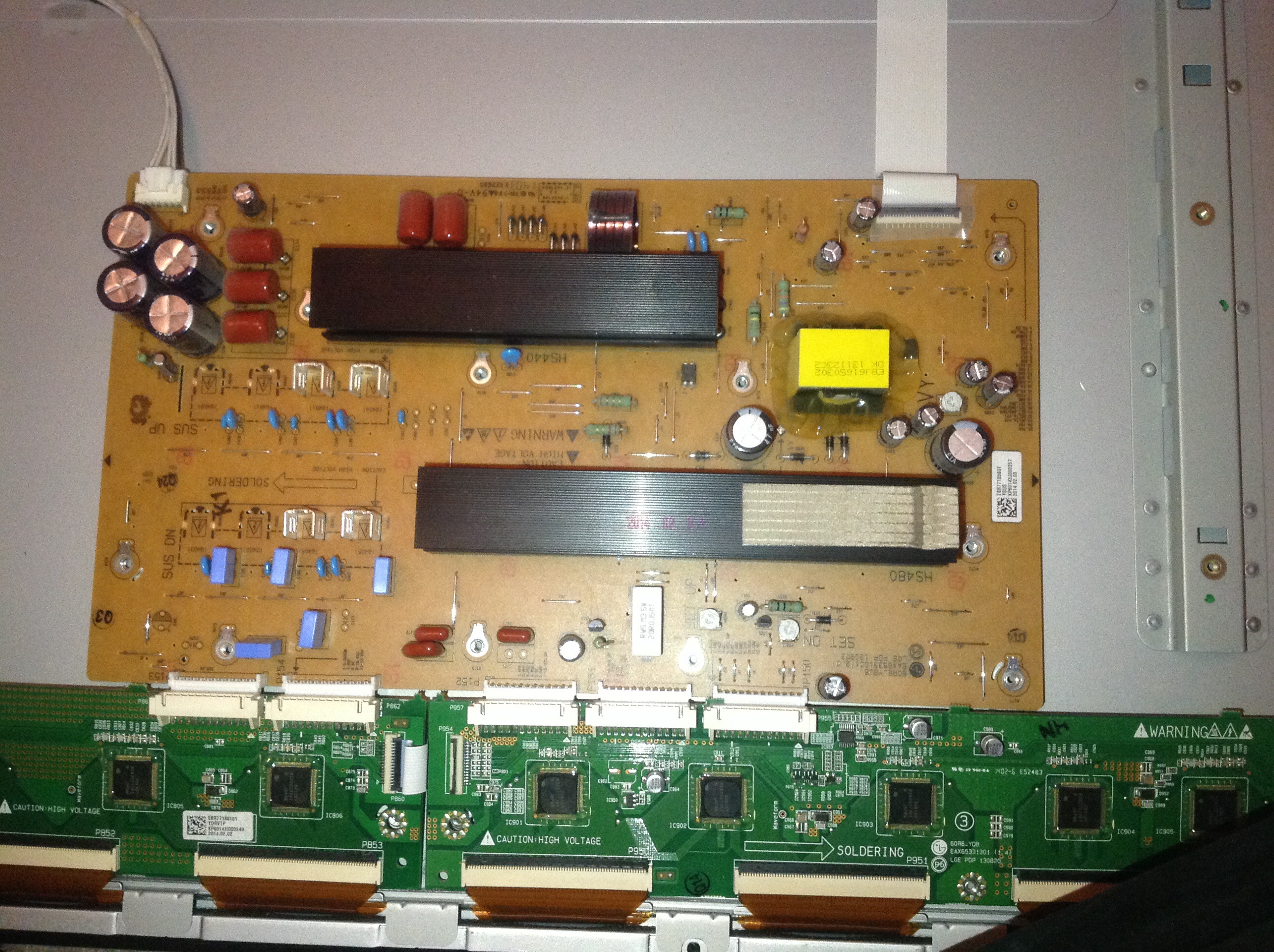

          Ysus
          • newtothis
            • Mar 2013
            • 1556
            • england
            Yeah that is definitely busted.
              busted and burnt so across that maybe short. I'd remove that and check the buffers for shorted buffer ics, ysus may also be damaged .
              not a LG specialist so a little unsure what you can get away with whether these can run with that buffer fully removed and get just picture on the top half.
              Would have to try and find a training guide or someone here has more on the LG stuff.
                Do you have audio ? The fact that you have a burned cap on a buffer and with the Y-sustain disconnected the set stays up is a pretty good indication that the problem is there. Might just be a buffer but it is always best to replace those 3 together. Both buffers and Y-sustain
                  I have audio when ysus disconnected it's only time it will stay on I've tried disconnection 1 buffer board but it shuts down also I'll get the buffers off and test the ic chips for shorts is there a way of repairing the ysus surly the full board isn't knackered
