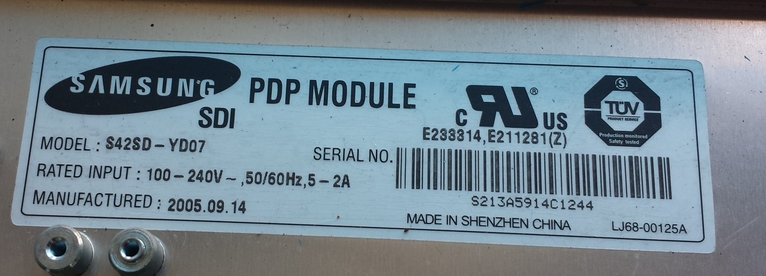

Plasma Tv 42" Hot point No picture no sound
  • ryann2k1
    • Apr 2015
    • 18

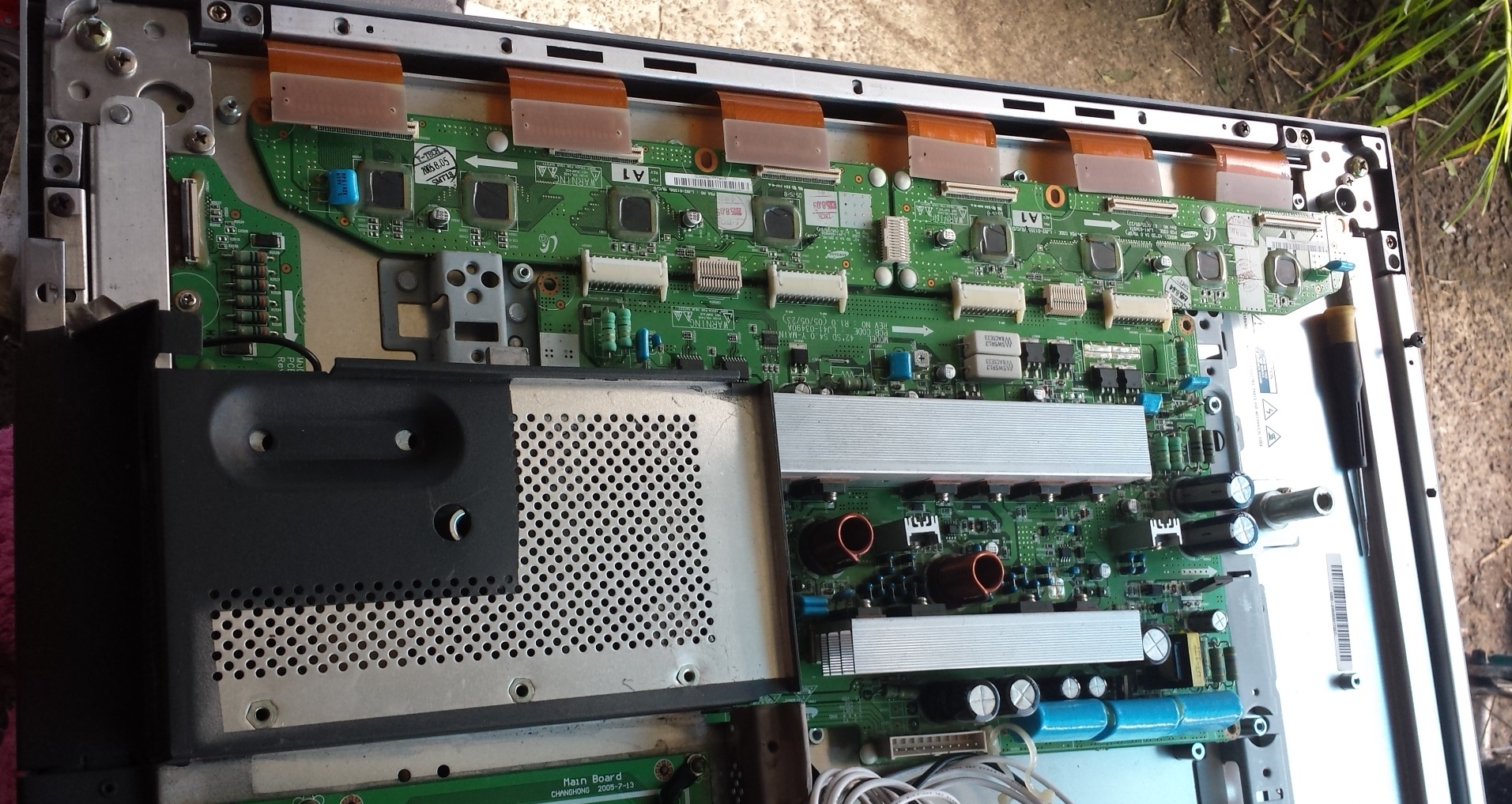

    I have a 42" plasma tv brand Hotpoint (it seems the boards are samsung made). When plugging the power source, tv turns on with green light turns on, but no picture and sound. A few second later, it indicator turns to red(stand by mode). After turning on with remote, tv indicator turn to green but still no picture and sound at all. There is one green light on the logic board (i think) which keeps blinking (see attachment). I have tried to unplug the X-board and Y-board( one at a time and all simultaneously) but the problem remains. I have measured Va, Ve, Vset, Vs, all are in normal rating voltage as shown in the specification attached on the back of the panel. Only Vscan which is supposed to be -182v, and the measure one is only -50v. i think this it the problem but i don't know how to further diagnose as i don't have the schematic diagram. Any help would be great. Thanks

    Re: Plasma Tv 42" Hot point No picture no sound
    Unplug the buffers from the y-sus and check the vsc voltages again.
    • ryann2k1
      • Apr 2015
      • 18
      I have done that, I unplug y-sus and measured, vsc measured at 0v (no voltage), Va,Ve and others are in normal range. I forgot to mention that I have replaced one capacitor at power supply unit, 47uF/50v. I thought that was the problem as the capacitor looks already bulging, but I was wrong, the problem still remains..
        The vsc voltage might only appear for a few seconds then drop to 0.
        You'll need to quickly measure it as soon as the TV is plugged in.

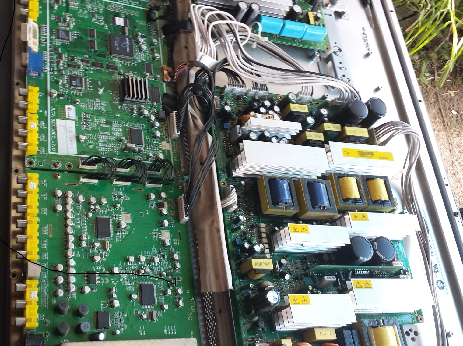

            Unlike later sets this one has the -Vy, VSC, VSCAN,, VE etc generated on the PSU board, along with the Va and Vs supplies.
            Some of these supplies are derived from the Vs supply but on the PSU, so any issues with the Vs supply, the PFC etc will give none of the other rails....
            A common fault (It appears) is the PFC and Vs Controller chip can fail--which apparently is rarer than hens-teeth--uses same chip for both jobs--Bit weird.....
            Unless its just for experience--I wouldn't waste any time on this 480i EDTV set, that has no HDMI or DTV....

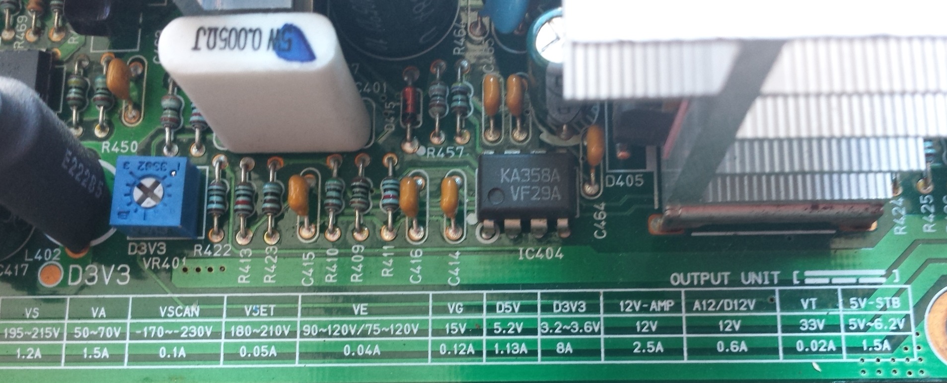

                  the voltage for Vscan is 0-no voltage ( y sus is unplugged). My question is that does the Vscan voltage only appears once in closed loop, unlike Ve, Va, and others?

                    the voltage for Vscan is measured from -50 (supposed to be lower than -100v) than gradually decreased to 0 v( y sus is unplugged). My other question is that does the Vscan voltage only appears once in closed loop, unlike Ve, Va, and others?
                        VScan is derived from either Vs or Va on that chassis--cant remember which--But Isnt closed loop as I recall....
                        IF however--There's a fault on Y, then this could be picked up by the control-system/Fault det, that then shuts down the PSU, but not as in closed-loop regulation etc--Unplugging PSU may actually Cause the observed results on an otherwise normal set...
                        --This tends to shut most of the PSU down though....
                        Is Va and Vs present and correct while on?--IF these are wrong/not present then Vscan wont be right anyway, as it is derived from one or the other ...
                          Thank you for responding. Vs and Va are in normal range. I am still wondering, if vscan is not close loop...the measured voltage is supposed to be the same, when unplugging the Y sustain and when plugged. When i plug, Vscan around less than -50v but when i unplugged, Vscan = 0v.
