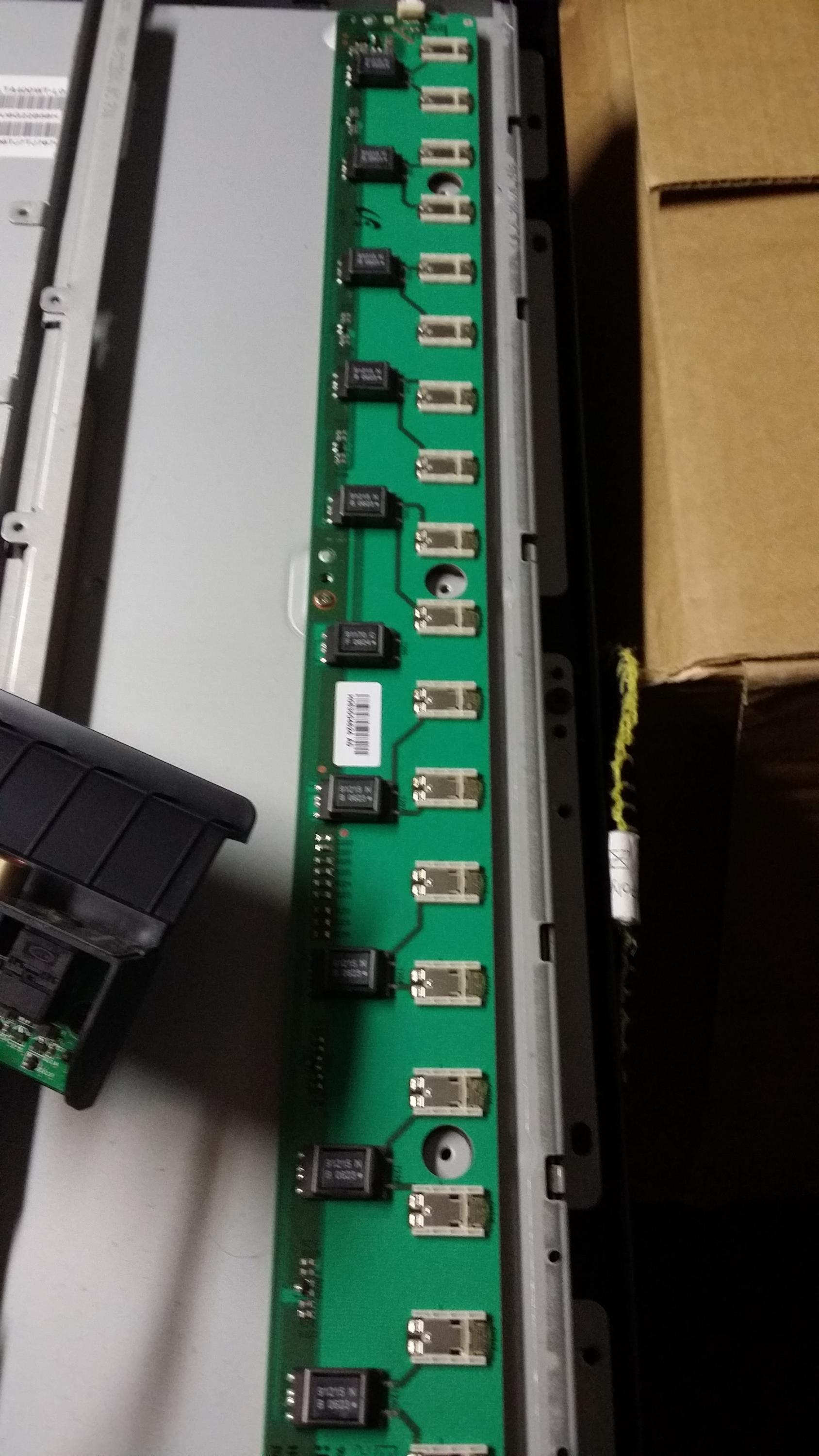

    i have tested with the lamp and number five from the bottom looks a little darker.
    I took a photo in the dark and there it is visible to just before it shuts down the light.
    I will try the dc test tomorrow.
    Edit: Number 5 from the right. The photo became wrong way.

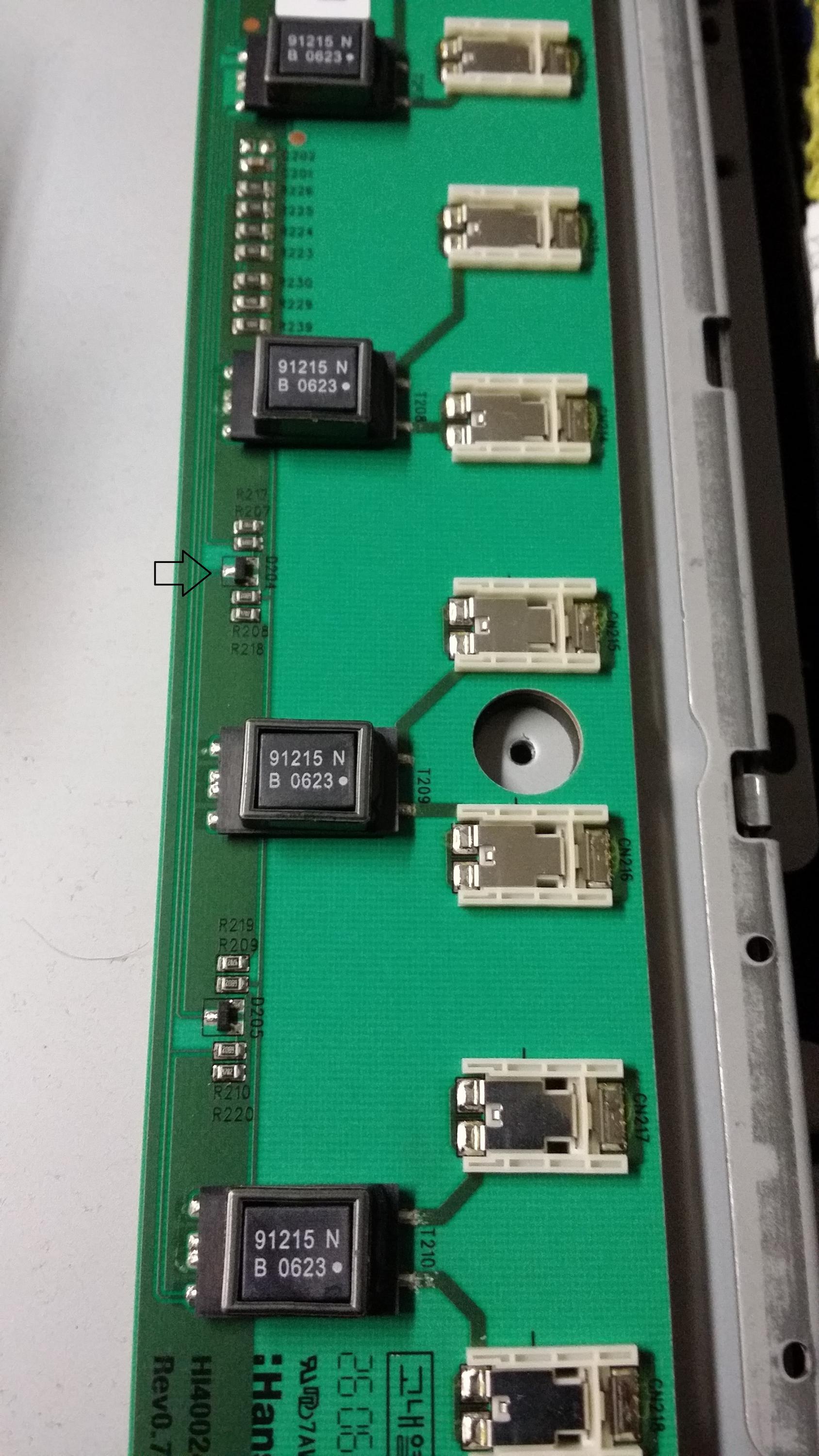

        Have tested with dc now.
        red probe on single point like arrow in photo.
        black probe on gnd.
        about 7.35 volt on every diod

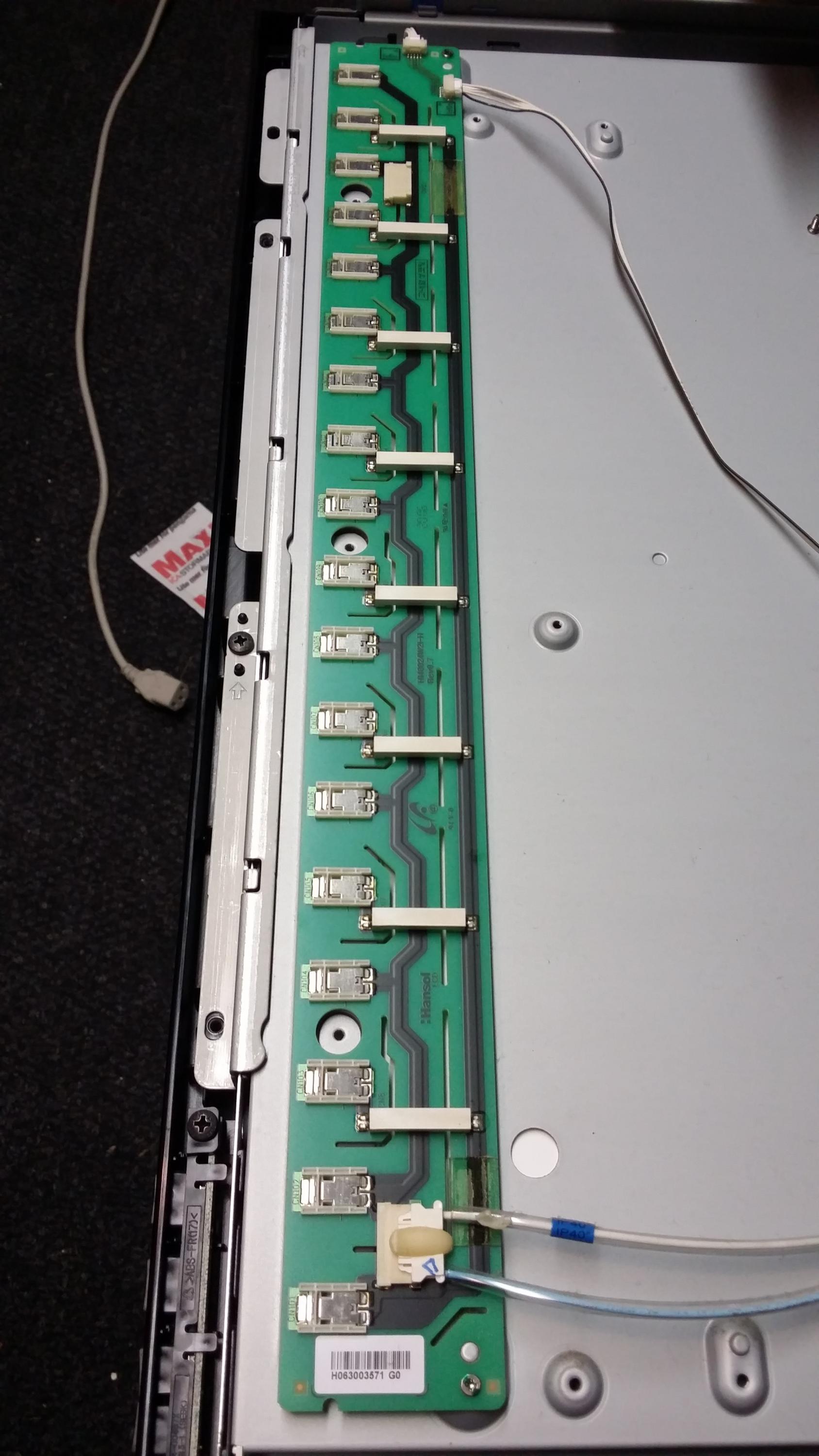

        You mean reseat the tube?
        Disassamble everything like in video number 2?????
        Cant I do the jumperthing like he does?
        It seems like I do not have a transformer for every tube like he did?
        Or is it one transformer for 2 tubes in my case?

          Those are the correct Diode, I expect the one with bad lamp will show higher reading than the rest.
          I really do not like to have you take the panel completely apart to get to the lamp due to more chance of breaking the lamp or the screen.
          Not sure abut the jumping the transformer, I need to look at the pictures of the board that I download to see how they are connected first.

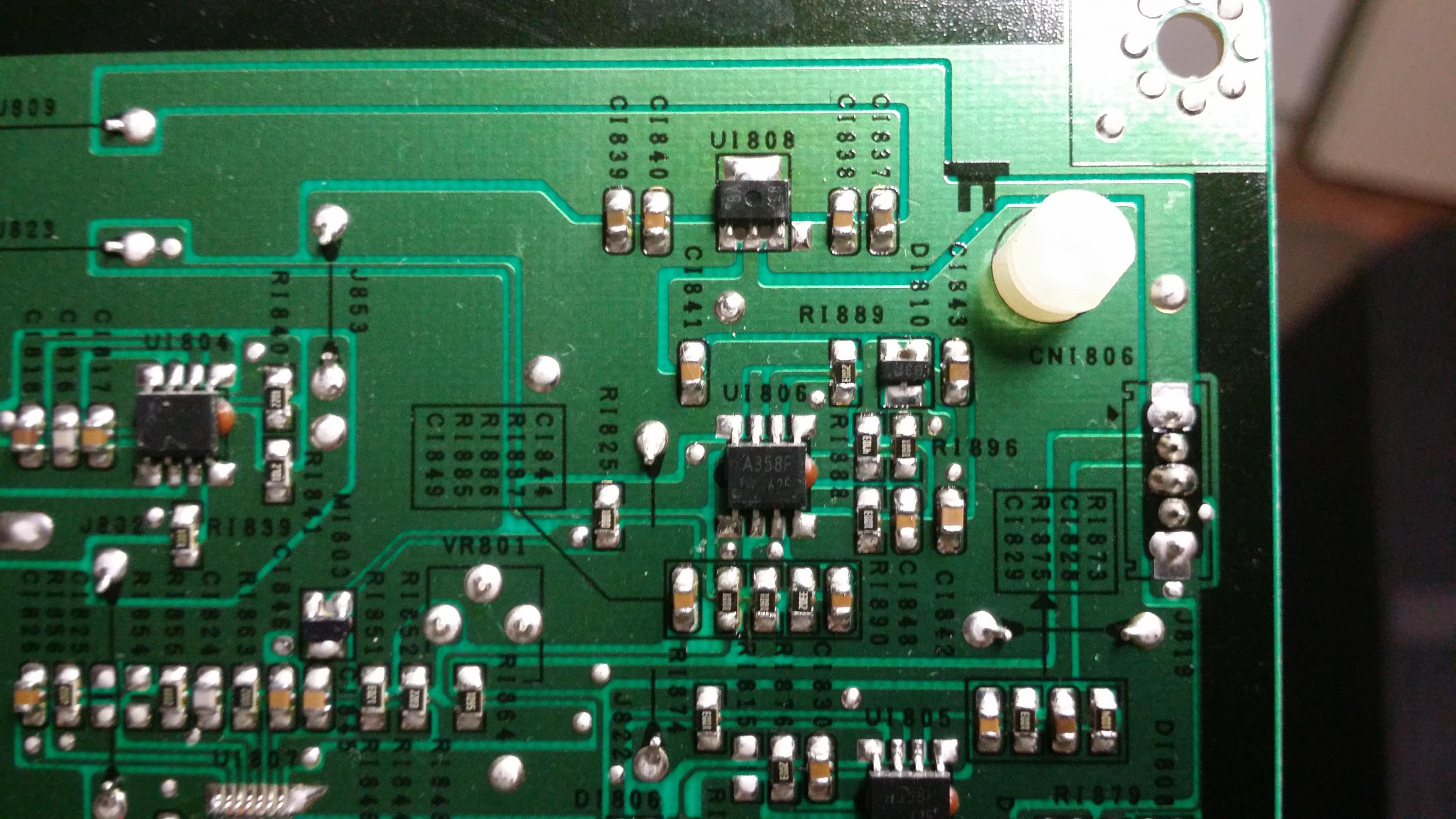

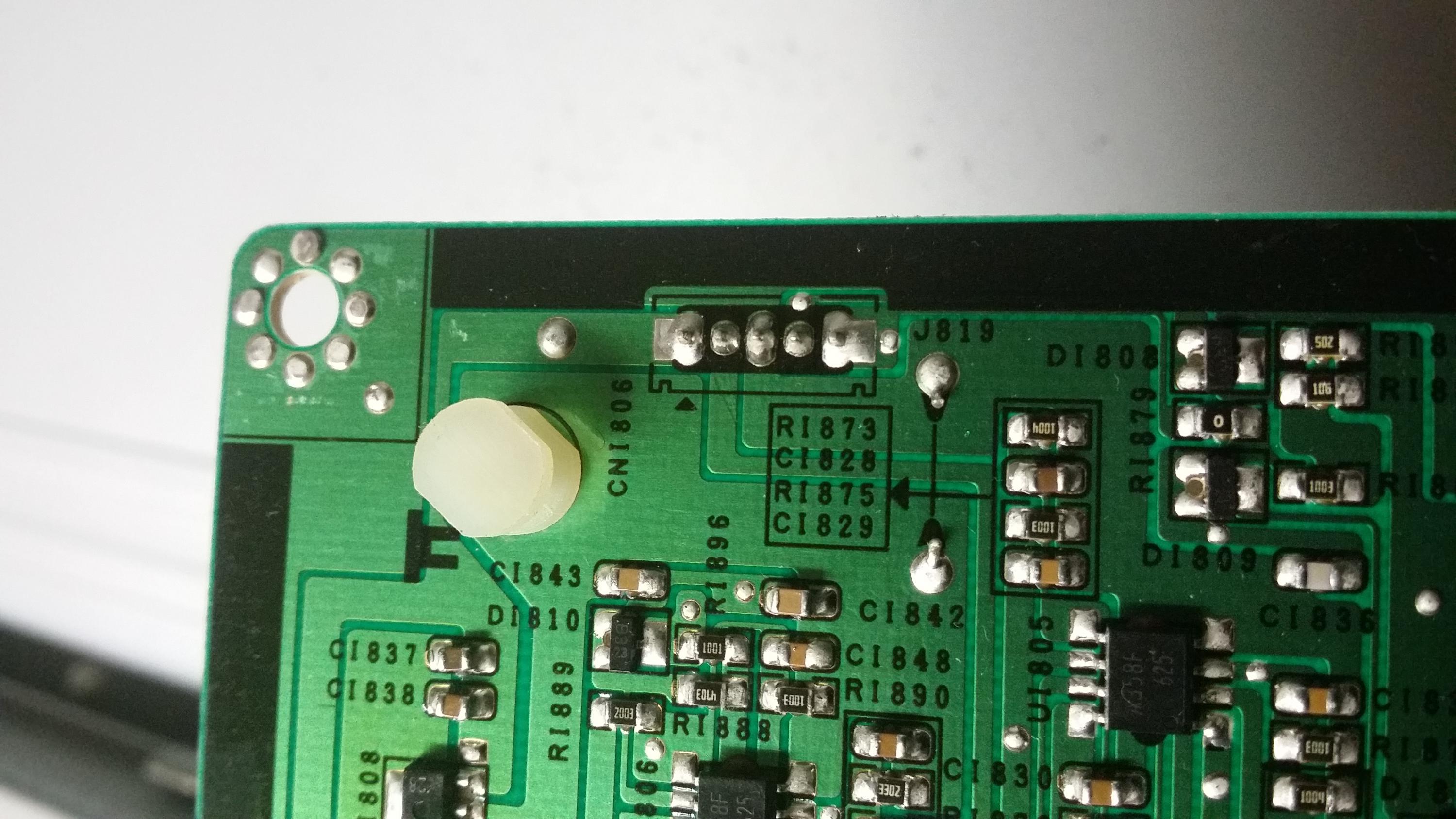

                  1) Can I get really clear straight shot of the this connector to see where LD pin connection goes to?
                  2) Please put the DCV meter on the LD pin and see when power switch is activated it is at 12VDC and then see if it drops down when the backlghts go off.

                    The reading on LD pin is 6.5V when I turn on the set. When the backlight lid it goes to 0V for 0.5 seconds then goes back to 6.5V when the backlight fail.
                    did not see that when I did reading earlier. Sorry.
