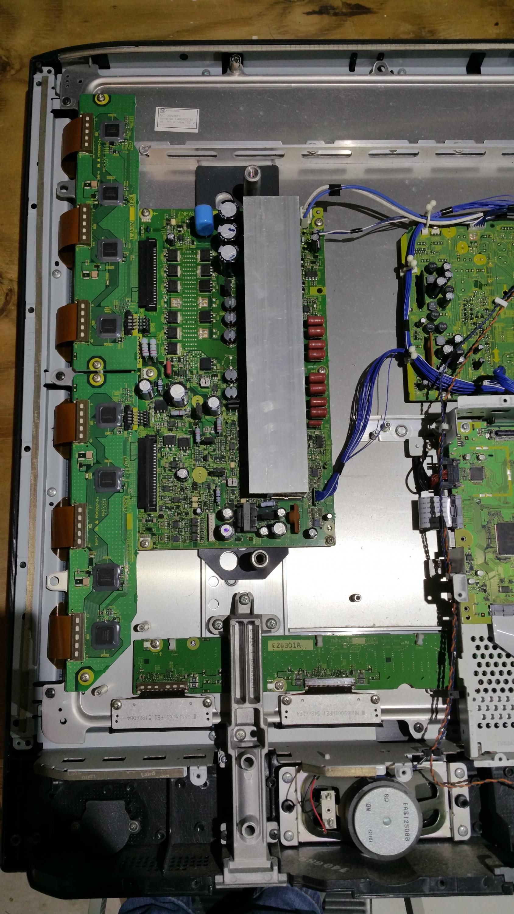

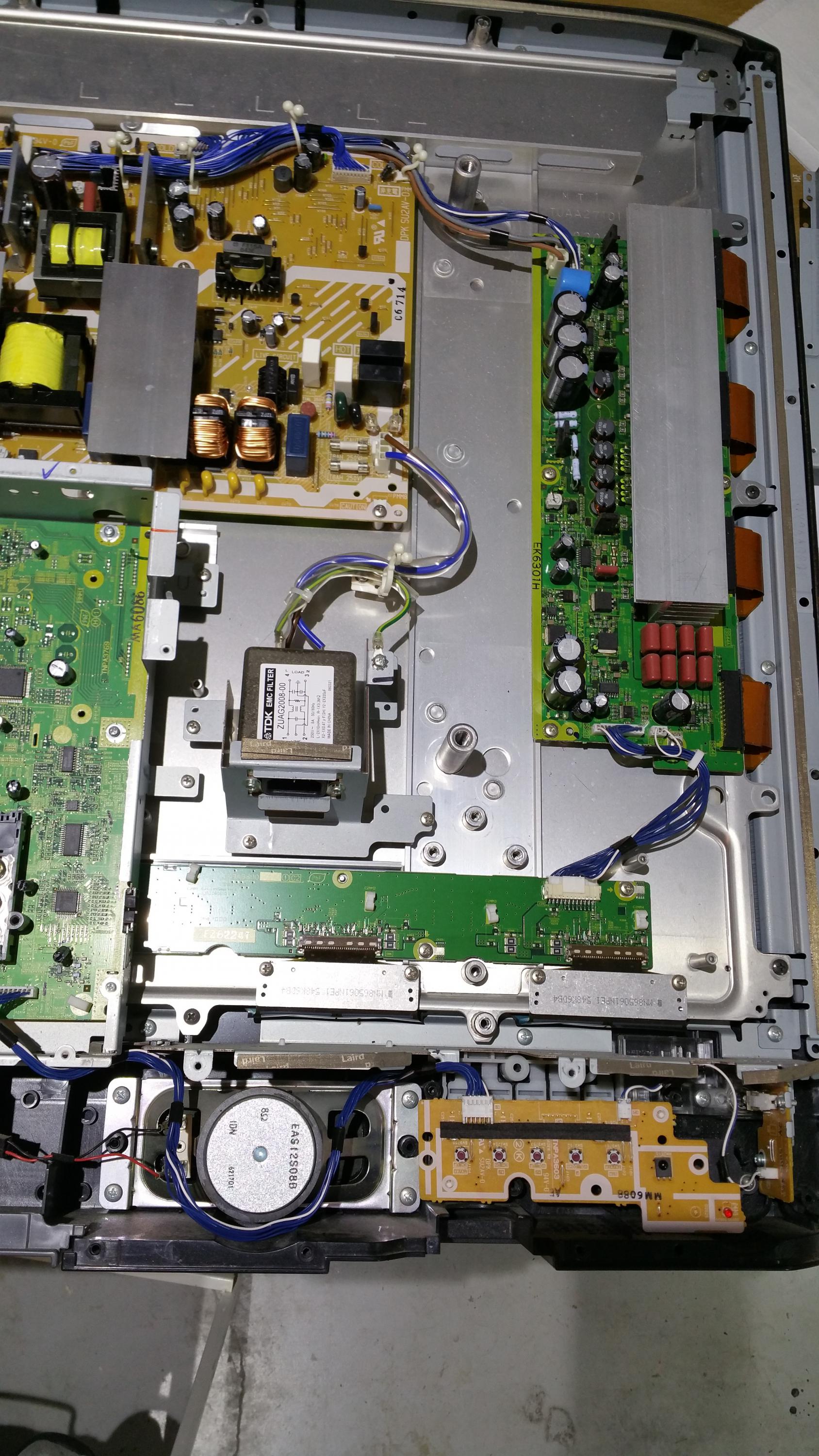

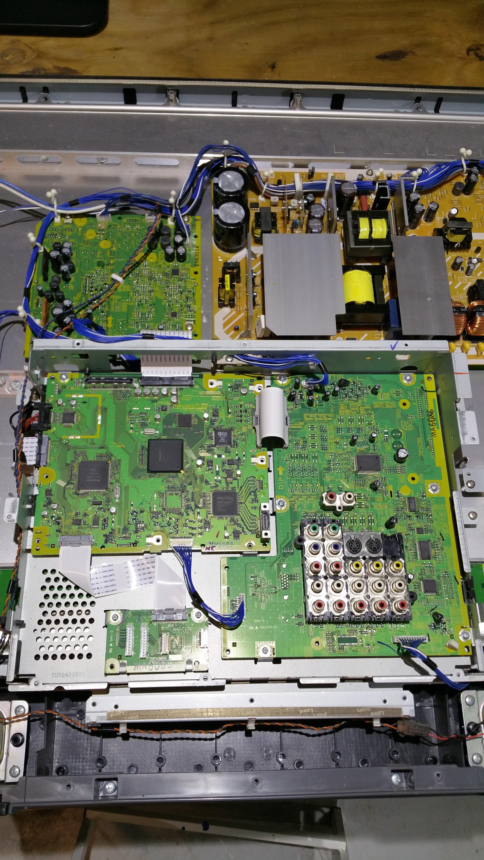

    Symptoms:
    Red light on front will not light up when plugged into power
    TV will not turn on.
    After leaving it unplugged for a while, and then plugging it back in, you will hear relay clicks, but still nothing.
    Checked continuity to all (3) fuses on the power board.
    Did a power board repair kit.
    Replaced whole power board.
    Replaced power and source/input selection board.
    Still no luck and kind of shooting in the dark at this point. All of these items above have been 'fixes' I've read that have 'solved' this issue for other people, but after reading some threads on here, it seems like there are many more people on here that are better versed on the subject than I.
    Help?

      Newtothis: what would you like pictures of? Let me know and I will have them uploaded soon. Thanks!

        Re: Panasonic TH-42PD60U (Banging my head against a wall.)
        Welcome! Pictures of the TV , especially of the back of the tv.
        Clear pictures of the power supply/mainboard etc.
        You need to use the " go advanced " option and use the attachment option.
            Sorry for the delay gentlemen, here are the pictures of the base boards (sans the RF and Optical input assembly)
              Before you power the set up again,make sure all board hold down screws are in and tight.
                Thanks, but we've done that (x3)
