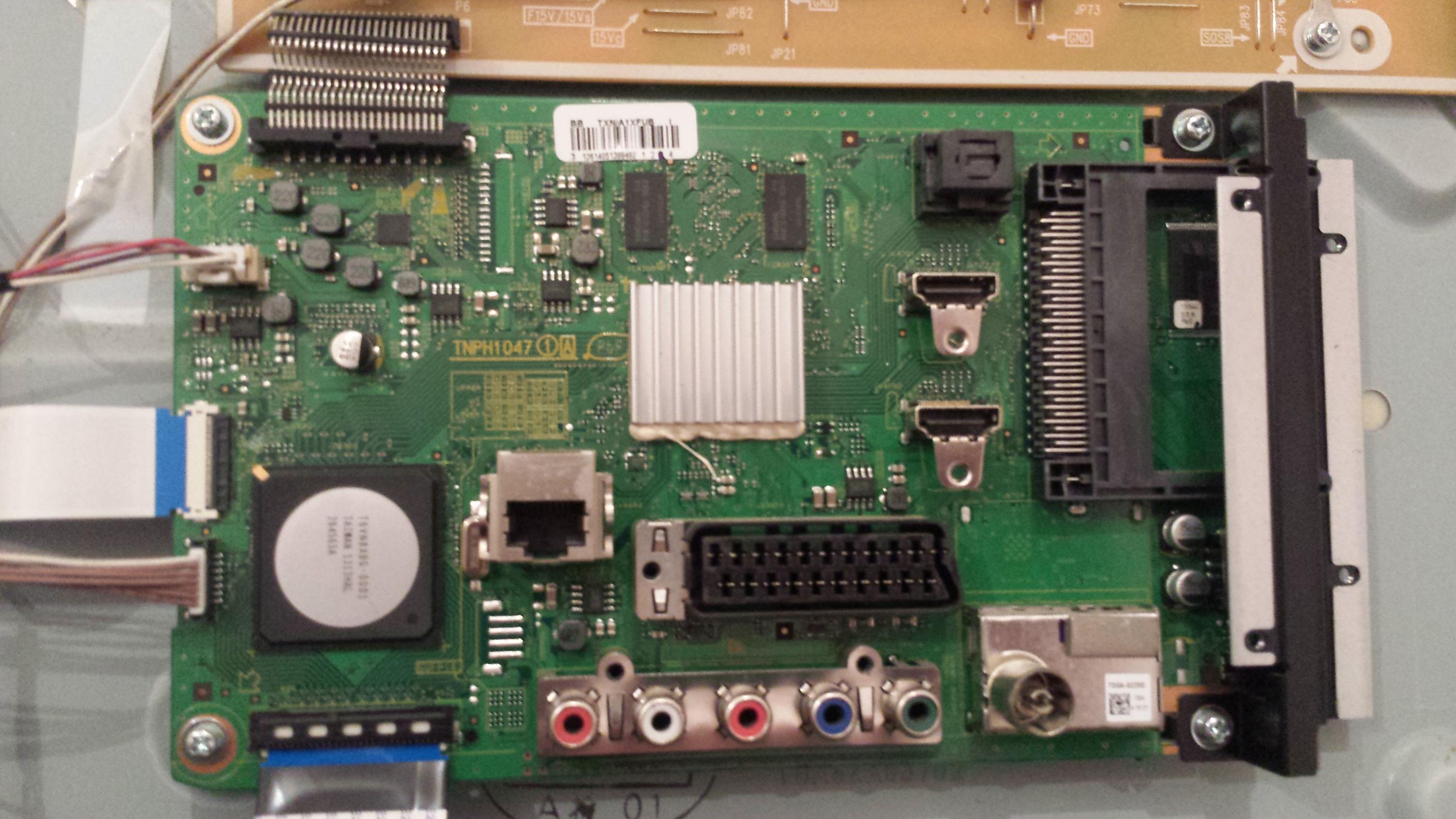

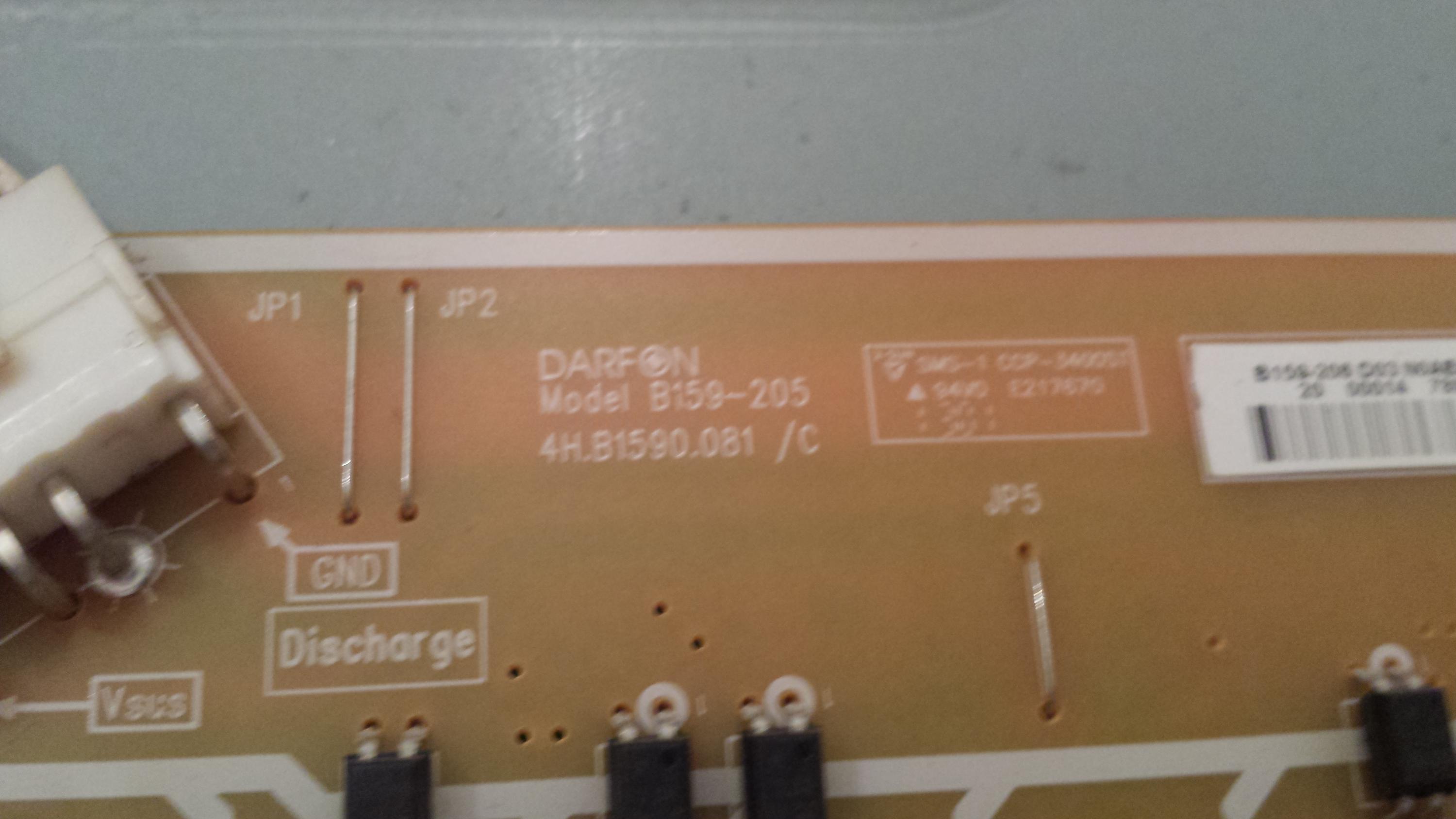

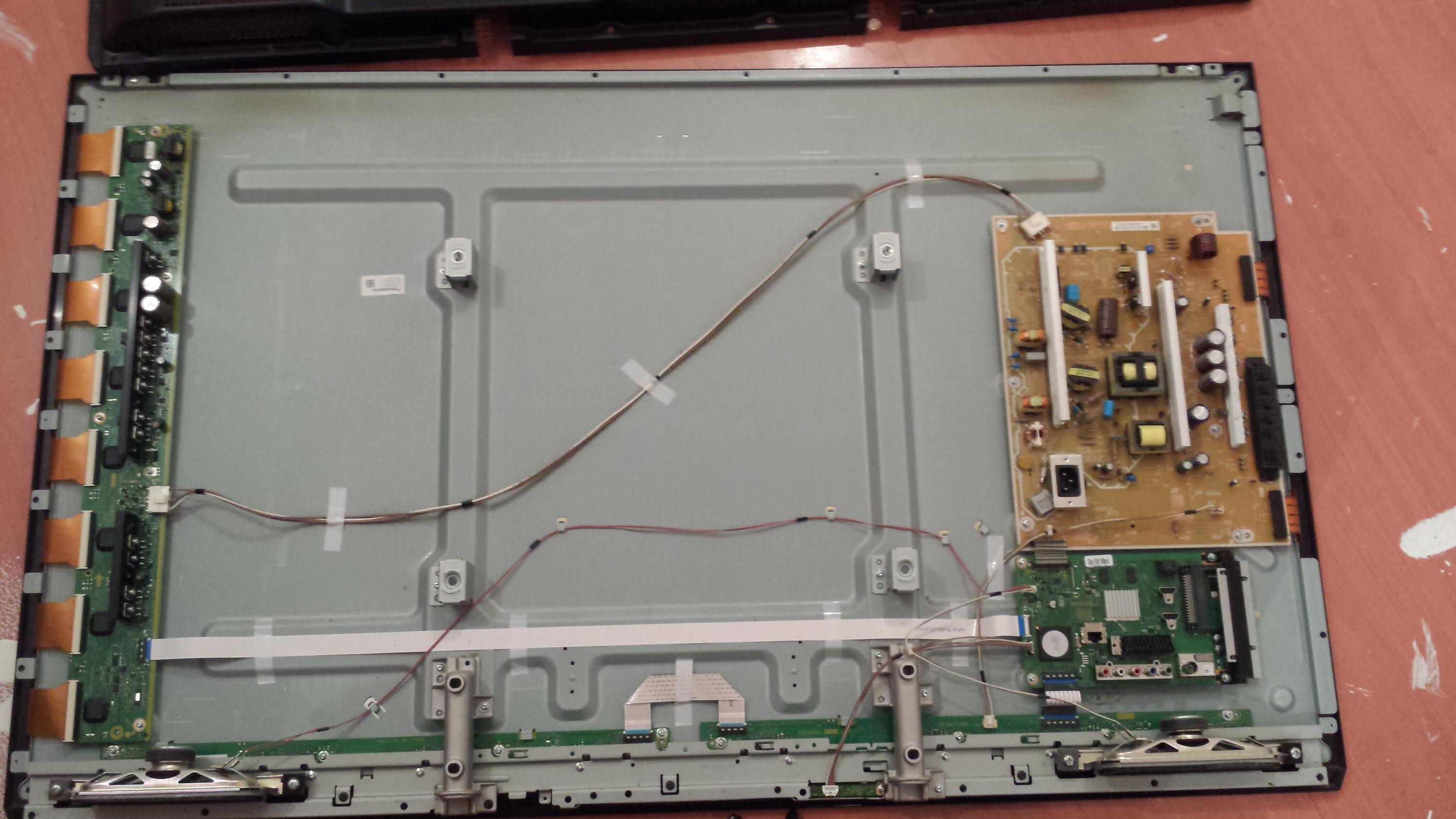

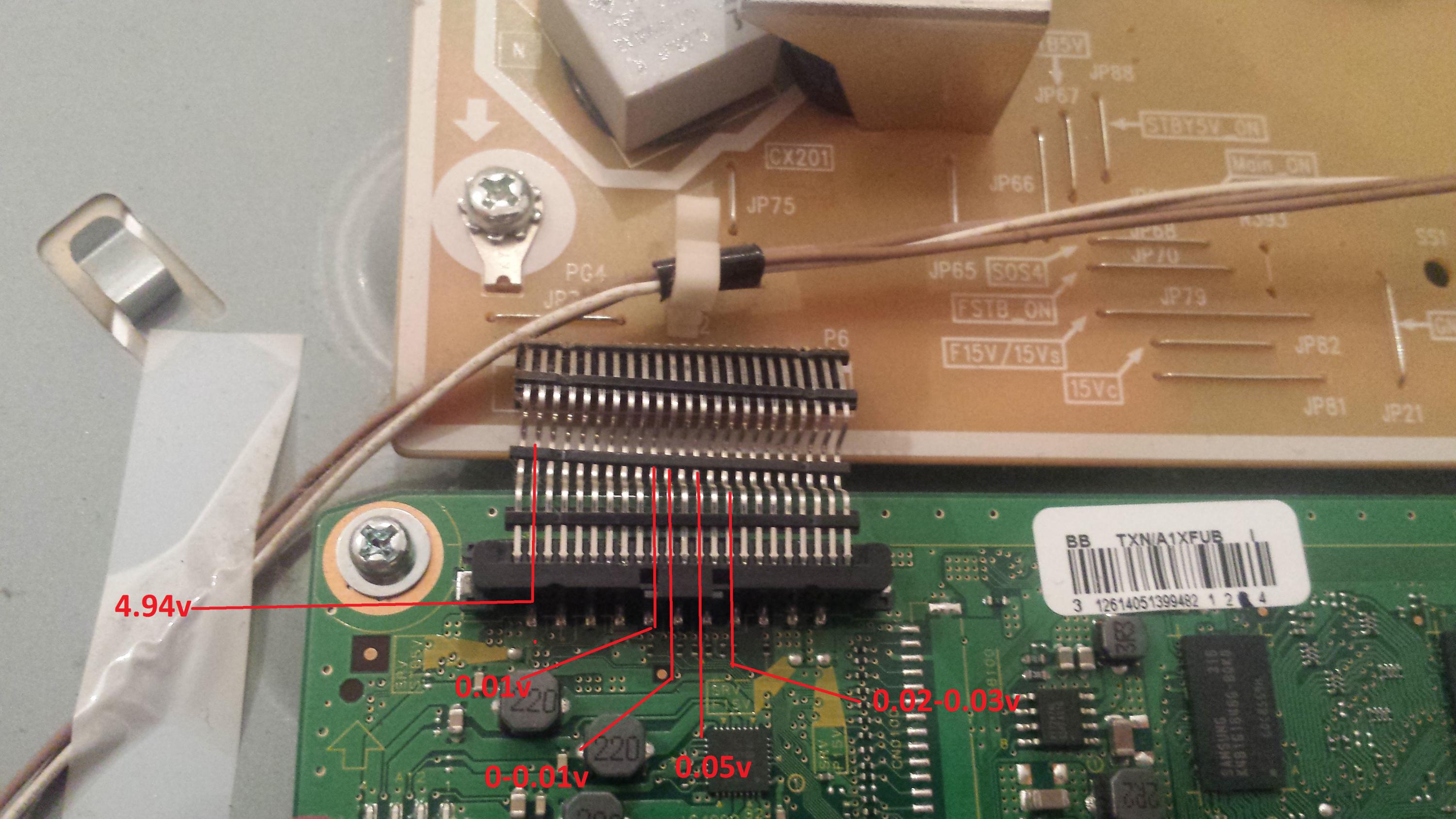

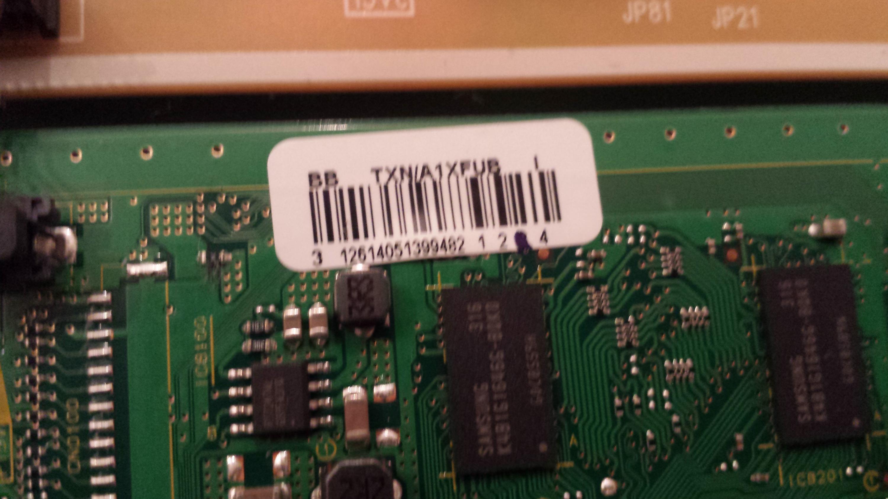

    I have a Panasonic TXP50X60B which acts as if no power, the person i purchased it from said they plugged a tablet into the USB socket and it shut off the tv and the tablet and neither would come back on, fortunatly he was still under warranty with the tablet. i have plugged it up and no red stby LED from what i can see. i have tested voltages going to mainboard and have attached a picture showing voltages. 2 of those voltages tested jump between .01 of a volt.. im guessing something has went on mainboard but how can i be sure.

    would probably help to add pictures !! Badcaps wont let me upload using attachment manager..

      heres the pics....

        Re: No Power on Panasonic Plasma
        Sorry missed the bit about the LED.
        Voltage across PFC cap?

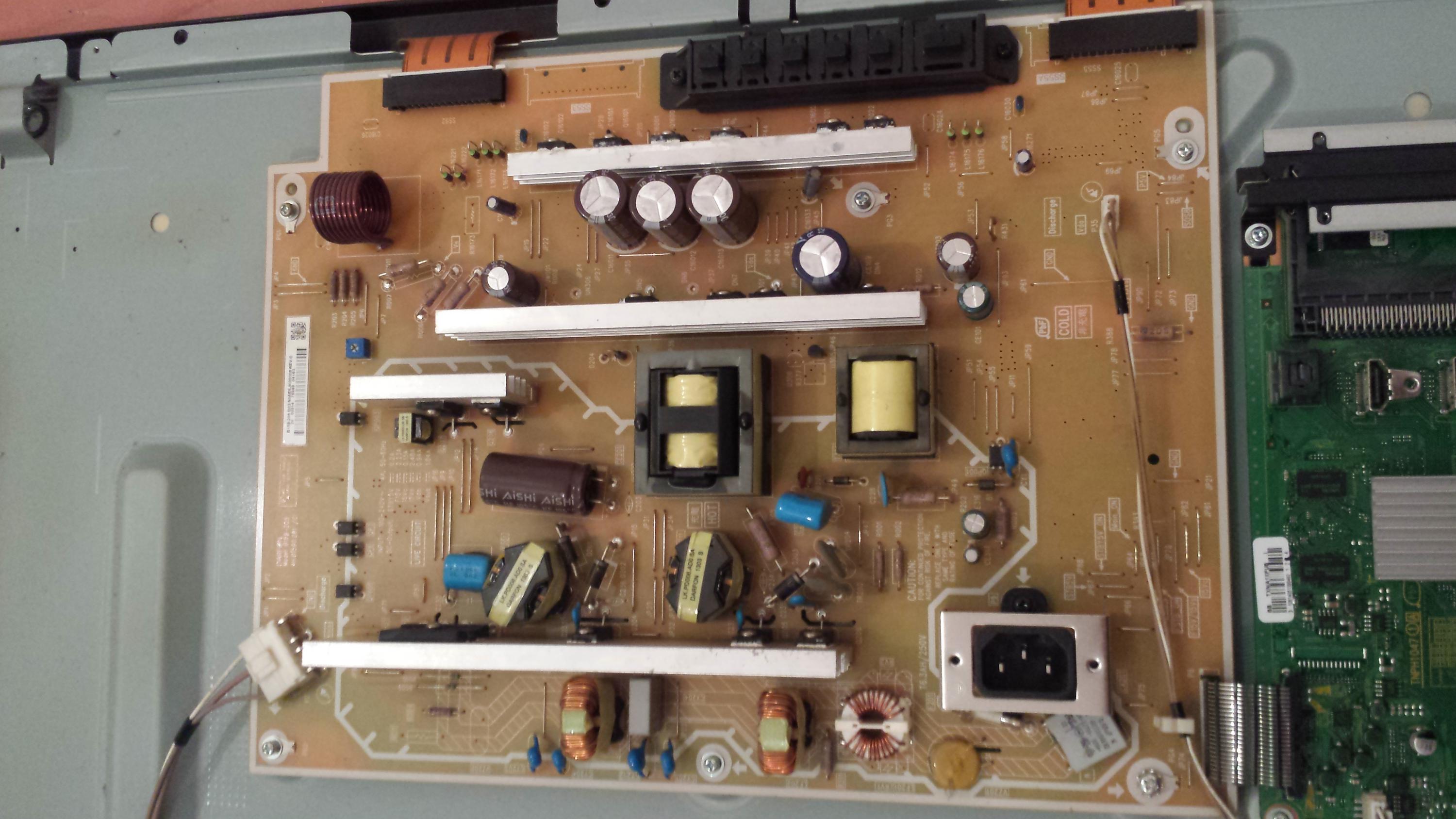

                      Hm no power at all i was going to ask if he heard the relay click while plugging in but i don't see a relay at all on the PSU. I guess the BR just gets power off the shot on plug in. This looks pretty cheaply built comparative to what i typically see in the Pannys i get in my shop
                      If you get nothing, newtothis is suggesting the right stuff, start on the hot side see if its ok, IE: blown fuse and go on from there to the secondary.
                        99% bad standby control IC on bottom of board. Cheap part on eBay, SMD soldered. See other threads on this forum.
                            would that be this one thats circled ??
                              i would of thought by what tom has wrote its on the underside of the psu the board you have posted looks like a mainboard too me.
                                Yes, it's on the power board. Have a search on this forum. post re: tw2005 regarding it (Panasonic svc bulletin)

                                    have purchased U203 and hopefully will solve my problem, will update you guys when replaced.
                                      changed U203 and still no power LED or anything ? what else can i try ? is there a way to test U203 ?
                                        control Voltage across pin 6 off U203 if not control the diode sending this vcc
