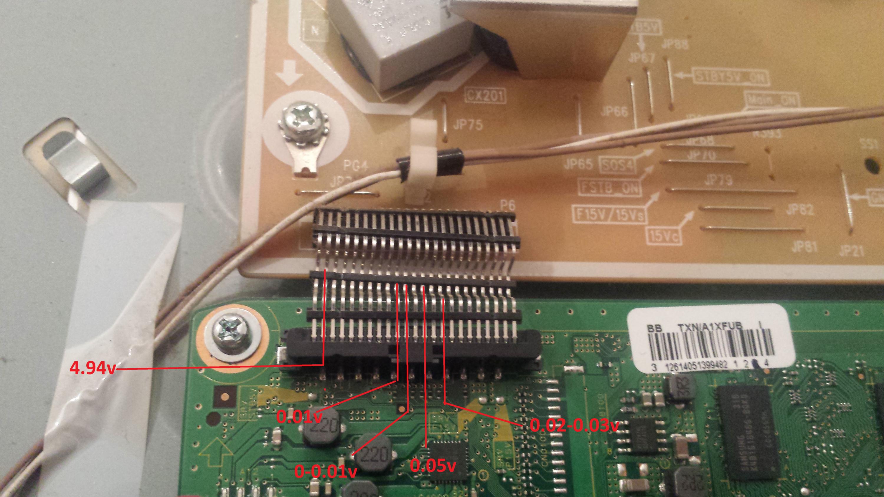

            mainboards look similar so hoping the pinout is too. Can't find a manual. both have the same style connector and 23 pins
            1.15Vs(S15V)
            2.15Vc(P15V)
            3.F_STBY(F15V)
            4.F_STBY(F15V)
            5.GND
            6.F_STBY_ON
            7.GND
            8.SOS4 (GND)
            9.STBY5V_SW
            10.S0
            11.KEY POWER
            12.S1
            13.KEYSCAN
            14.Panel_Main_On
            15.GND
            16.GND
            17UML
            18.GND
            19.UMH
            20.UEH
            21.SOS8
            22.STB5V
            23.P5V

              here is what i tested.

                  yes the 5v is there . what now ?

                      If PSU is producing 5V but the TV still seems dead where do you think the fault is? What controls the power led? If unsure trace the wires to it.

                        i was thinking of mainboard but didnt want to put it forward incase it sounded daft ? would i be correct of faulty mainboard ?..would make sense since the guy i got it from said it happened when he plugged in a tablet...
                          #32
                          Re: No Power on Panasonic Plasma
                          I'd be thinking mainboard but with a tablet if it was plugged into the TV I'm also thinking the current draw would be too high and maybe blew a fuse or something. weird how both tablet and tv died
                          again this is from the s60 chart.
                          Place the meter’s positive lead on pin 6
                          of connector A6 on the A board and
                          press the power switch on the TV.
                          Is there
                          1.5V~3V
                          present?
                          no = main
                          yes = PSS
                          I've never seen these sets so best I can do is quote the guide.

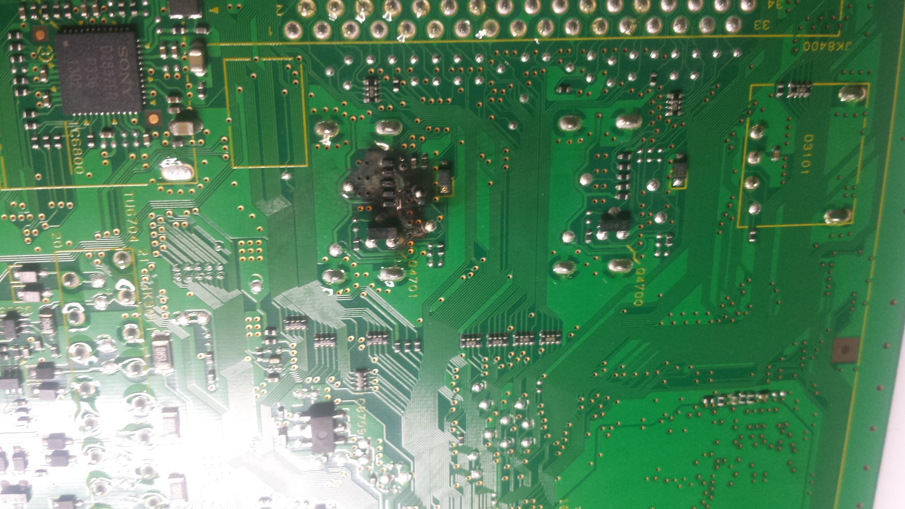

                                    ok should have checked before but must be the mainboard as there was this burn mark behind HDMI 2 connection.. so i will order one and replace and hopefully it works but will update.

                                      Ah, ok. that explains the tablet dying. i thought it was via USB. May be able to fault find it and remove the short and this work but may have only 1 hdmi or none.
                                      I've never done it but pretty sure someone has . Of course a main may be easy and cheap.

                                          tw i had a look on ebay and can get main for just less than £10 which is a good buy if itl sort out the tv. will give it a try with another board and update you guys, thanks
