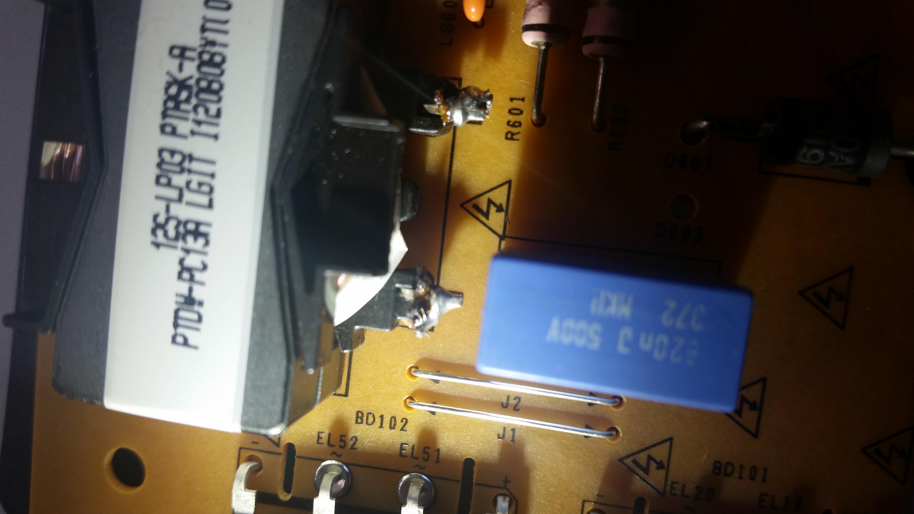

    Hi. I have a two year old LG TV [1] that I used a few hours a day.
    Last week while playing a videogame, the TV made a clicking sound and shut off. I tried to turn it on again but the display was not visible. At the same time I smelled something burning so I disconnected the power cable from the TV. A few hours later I re-connected the power cable but the display still would not turn on.

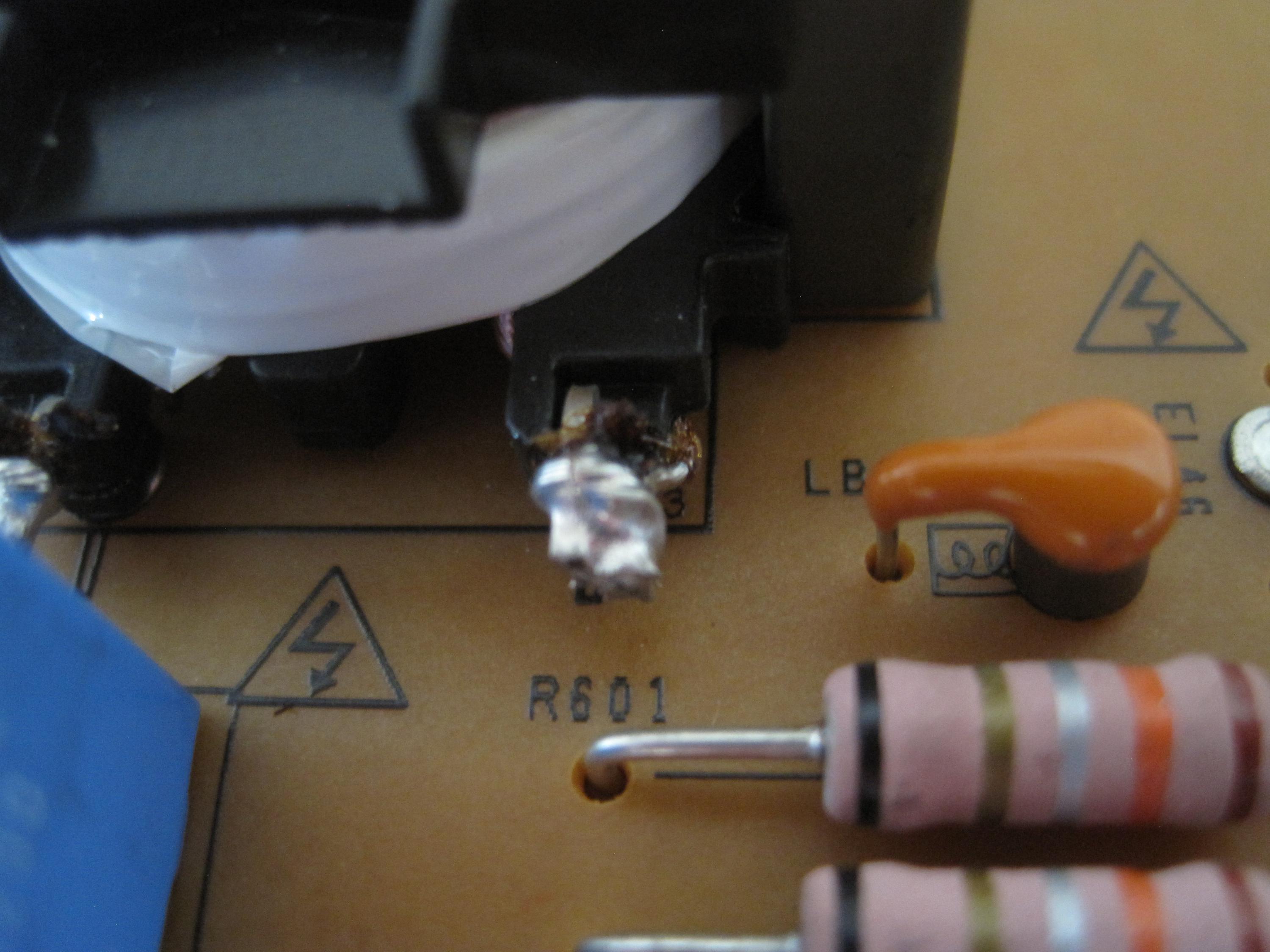

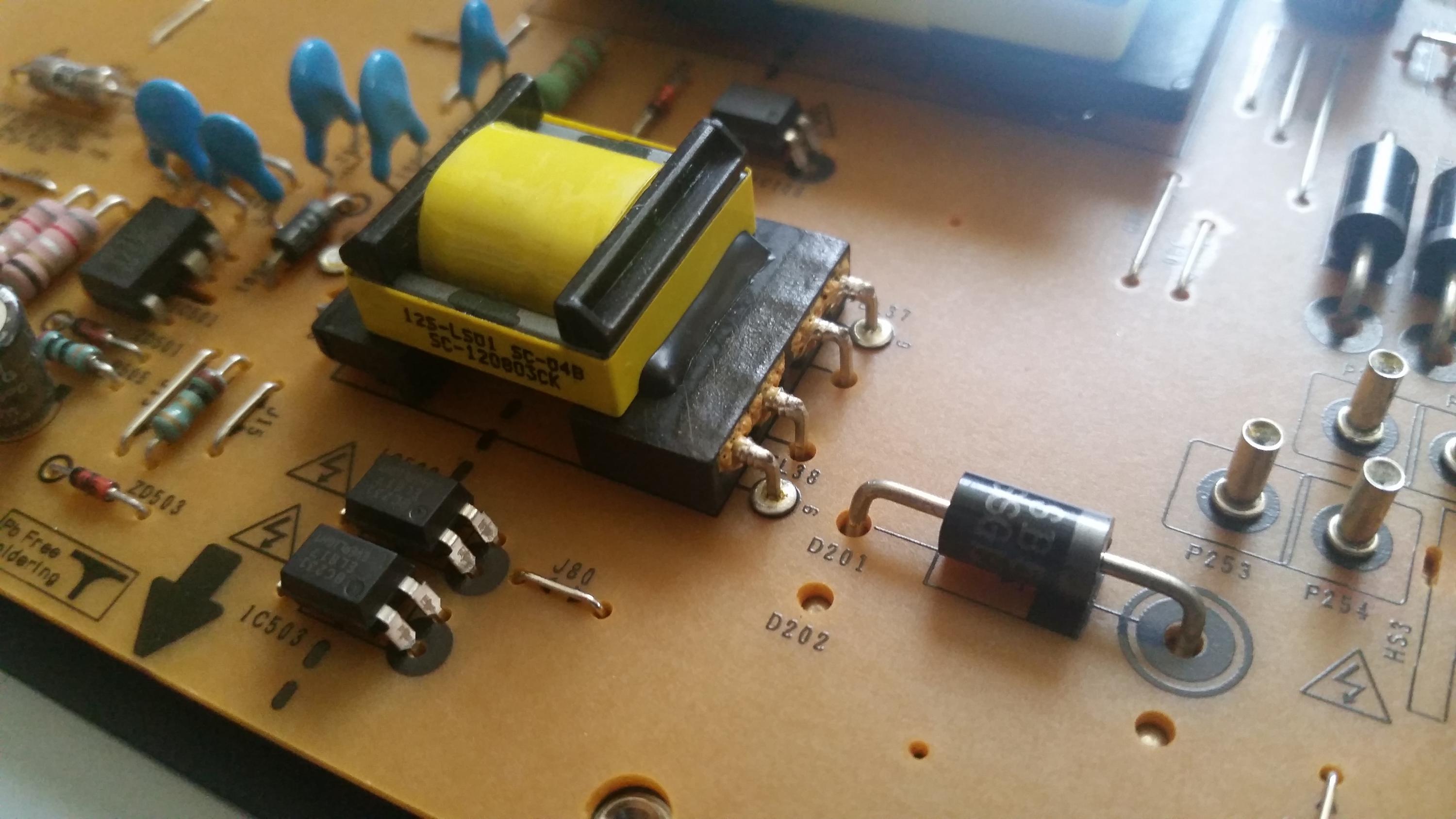

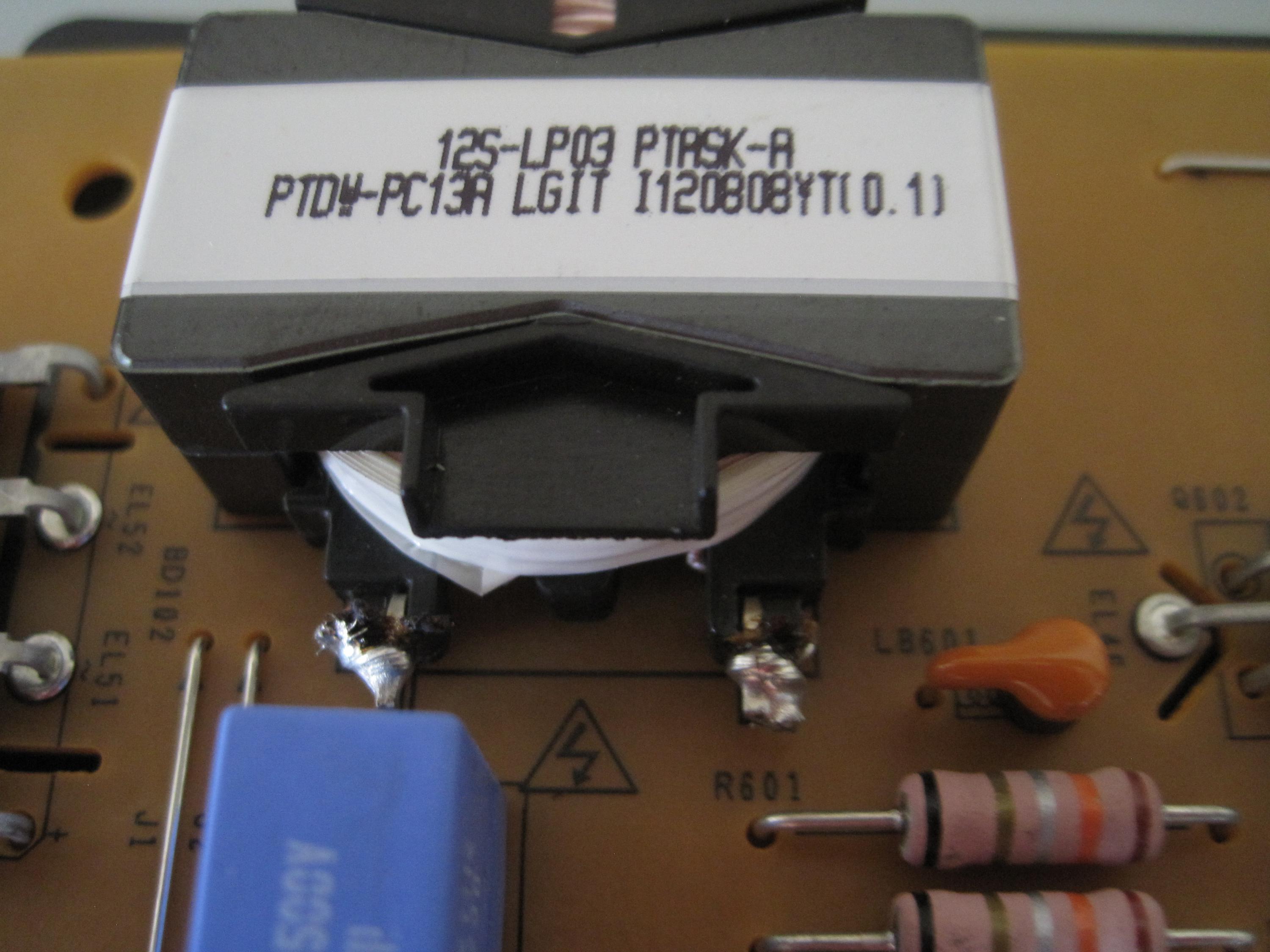

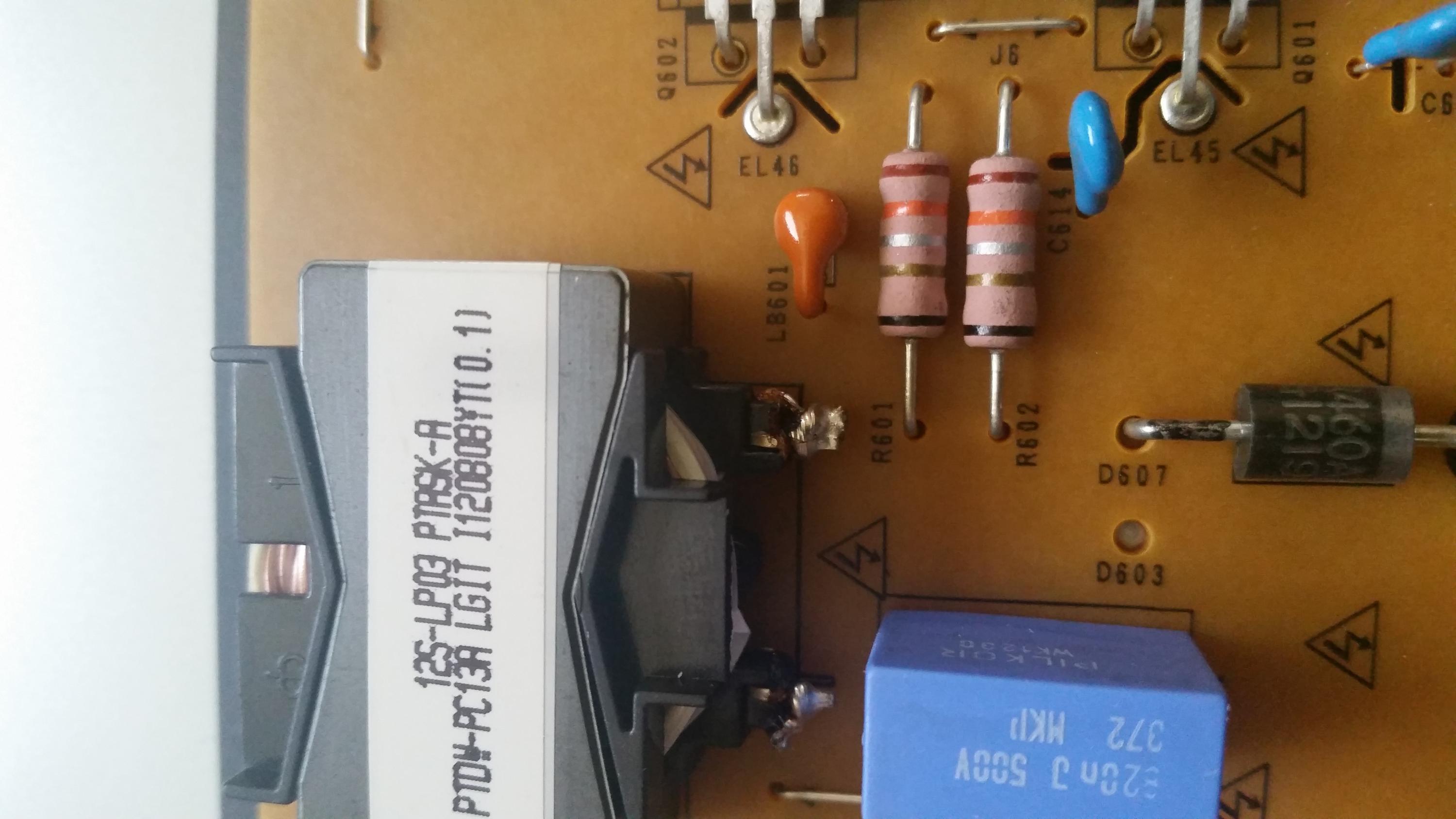

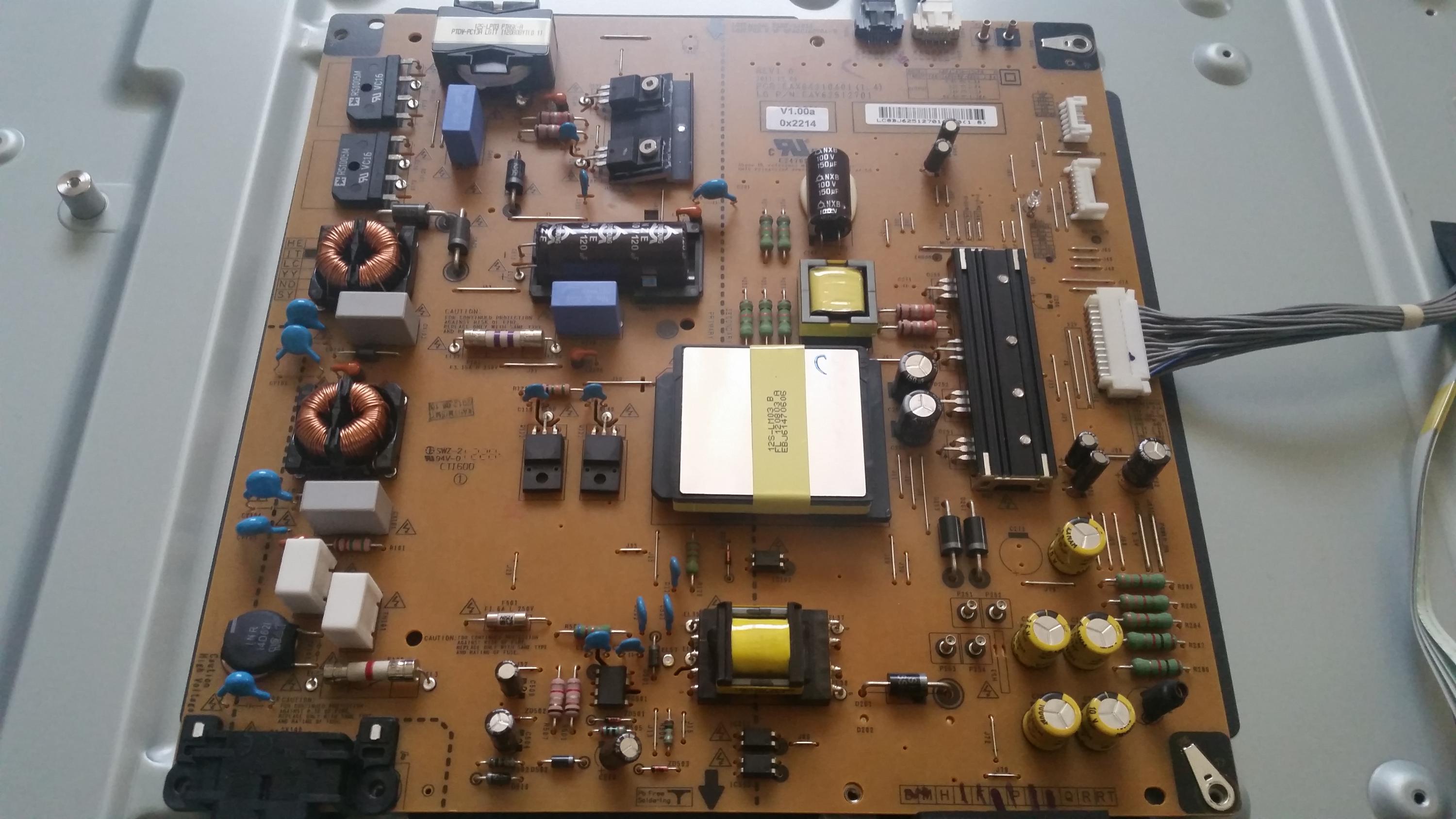

    Yesterday I opened the TV and did a visual inspection on the main boards (front and back side). I could not find any damaged capacitors. However, there were two components that looked suspicious. I don't have any experience with electronics hardware so I'm not sure if this is normal. I can't follow the burning smell because it's been over a week since it failed.
    I'm uploading pictures of the power supply board and close up shots of the suspicious components. Note: I was having problems uploading the images to the forums (timed out twice) so I uploaded to imugr instead:
    https://imgur.com/a/adjav
    1. white/black component. Brownish substance near both silver connectors.
    2. yellow/black component. Yellowish bubbling near on right side of silver connectors.
    I found what appears to be the same board on shopjimmy.com. It contains a higher resolution picture of the board:
    http://www.shopjimmy.com/lg-eay62512...-led-board.htm
    Current symptoms:
    1. I'm able to plug the power into the TV and the RED power light comes on in front of the TV. If I turn on the power button on the TV, the red light blinks three times then stops. The display does not turn on.
    2. If I press any buttons on the remote control, the RED LED blinks.
    At this point I'm not sure what part of the TV is damaged. Perhaps it's sufficient to just buy a replacement board from shopjimmy? I'm hoping someone can help point me in the right direction.

      It looks like I had a set with the same symptoms and same power board. Check this out.
      https://www.badcaps.net/forum/showthread.php?t=44945

          You will need at least Digital meter to find out if the power supply is putting out correct Voltages and if the main board is sending out correct signals.
          the flux on the transformer legs can be cleaned off.
          You need to look at the bottom side of the board, and inspect the solder joints really well especially around transformer' legs where they are soldered to the board.
