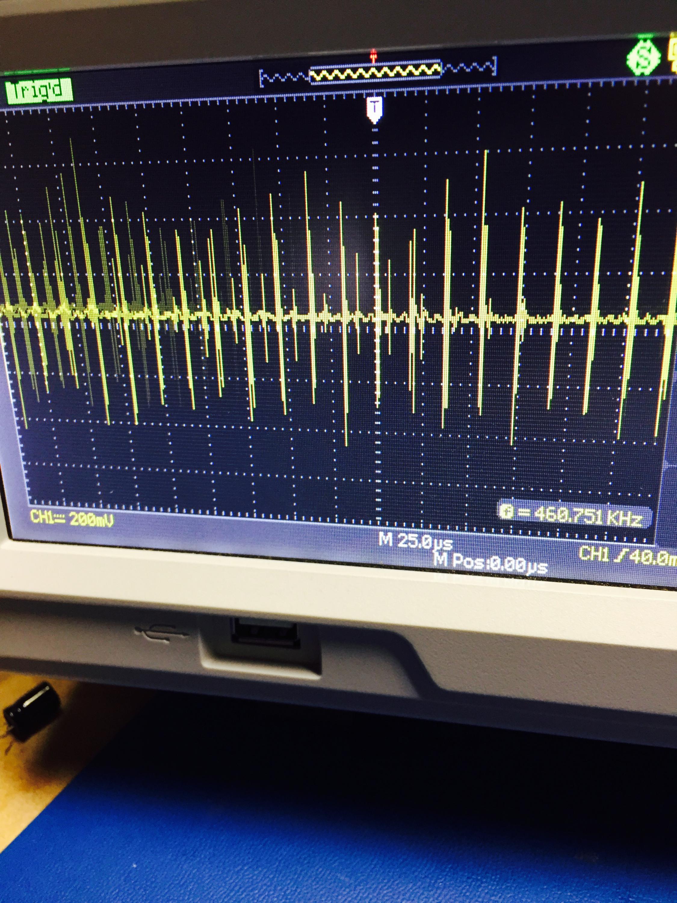

    I don't have much experience with viewing switching pulses in SMPS power supplies. I have a tv with no VS voltage and want to test the pulses on the mosfets that control the VS. What kind of shape should I see. I have a pic below of what I am seeing but it looks more like spikes then pulses. Any help would be greatly appreciated.?

    Are these the PFC or the Main PSU MOSFETS?
    What other tests have you done...?
    In all the sets Ive done--cant ever say Ive checked the drive on the Gates of a PSU MOSFET.
    --Probably as they can be touchy devices and years ago testing such places has caused severe blow-ups due to the scope-probe adding load/changing drive to the Gate....
    They are something I never touch--never the Gate directly when powered....
    I would expect a drive signal of around 10-15V square-wave rather than 0.6v as you have
    Prolly either the Chip or the MOSFETS themselves.
    You dont say what set or what model--so its not possible to help much further....

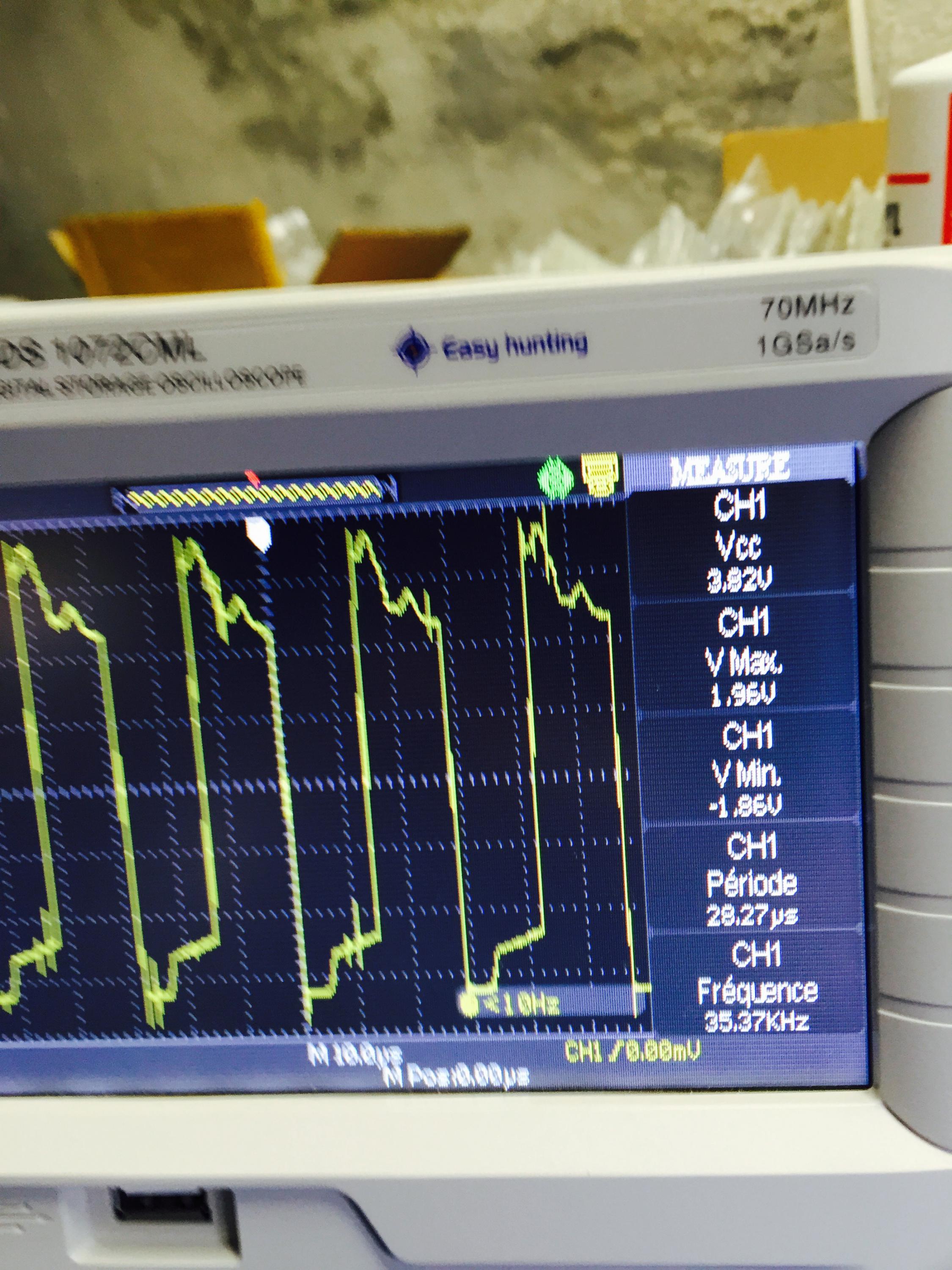

                  ok I checked the switching pulses on QX801 and 802, which controls the VA and I get VA voltage. I get this(see pic below). I get noise/spikes on QS801 and 802, which controls the VS. Should I just replace QS801/QS802.

                    Set your scope to DC coupled for looking at the pulses. Are you using an isolation transformer for this test?
                    The pulses look reasonable, but they are quite large, over 30Vp-p, which is abnormal for a driver circuit.
                    It is possible you are looking at a transformer gate drive output, which would have a higher amplitude than the switching pulses to the transistors. The pulses at the transistors shouldn't exceed 25V peak and more than about 20V continuously, or they can be damaged. A good design won't even need to go above 20V - the transistors will be well and truly saturated around the 11-12V mark - the higher voltage helps improve the switching time, but not much else.
                    If you are getting gate drive pulses and no fuses are blowing, your transistors are probably ok -- there are some exceptions, but in general transistors usually fail shorted or leaky, which will blow fuses. It is very rare -- not impossible, but rare -- for MOSFETs to fail in other ways (BJTs tend to fail more often with leaky junctions, but my experience of FETs has been in all but one case the transistor shorts, and in that one unusual case the transistor was used in a linear regulation application for which it was not designed.) I'd then focus on the coupling cap for the half bridge driver, as that's a common failure point on Samsung plasma PSUs. Seen quite a few fail, will cause no Vs/Va but everything else appears to work.

                      I took the pulse reading off of the gate of the mosfets. So the spikes I am getting on the gate of QS801/802 is ok and I should not replace them. At the start of the repair, there were 2 domed caps in the p/s so I replaced them and I tested all of the electrotytic caps with an ESR meter and the tv worked for 2 days then it crapped out again.

                        How are you not using an isolation transformer? Are you floating your 'scope? Yeah, that's pretty dangerous, if you are, as anything on your scope is now LIVE and that includes the thin plastic case not designed for non-earthed applications. I picked up an isolation transformer for about £25 in the UK, from a test equipment reseller. Maybe check around building site auctions etc - they tend to use a lot of them...
                        That waveform is not normal for the gate of a FET, it is way too large in amplitude and as I said, could damage the FET.
                        Coupling cap is connected to the transformer, usually where the transistors meet or on the other side. Its basically ac-coupling the transformer drive so you don't get flux-walking effects.

                          Ok I will buy an isolation transformer. I did some reading on the gates of the mosfets and now I get about 4v p-p(see pic below)
                          Maybe I had did something wrong the first time. I get nothing but small spikes on the gate of QS801/802.
