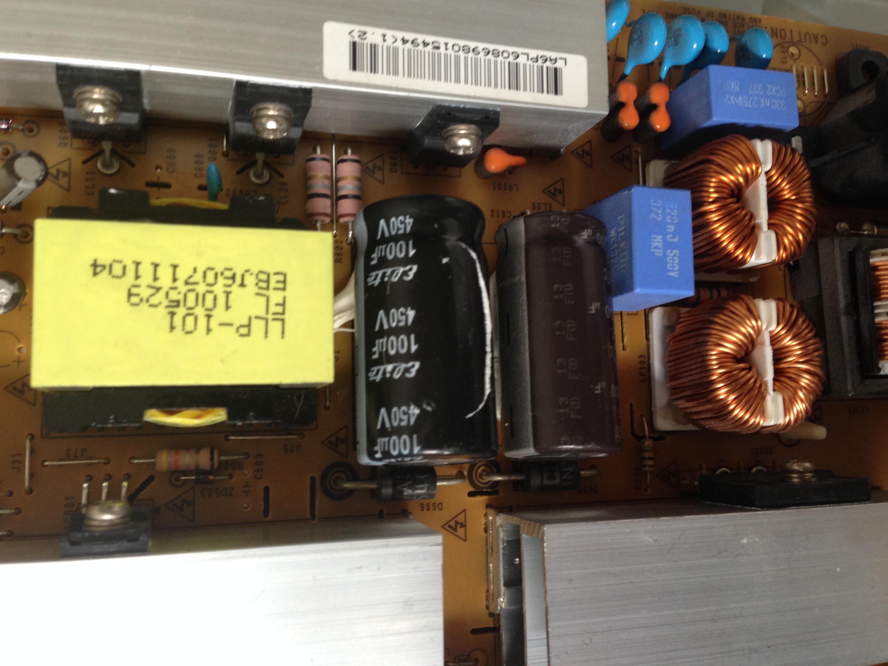

    I open the case and see that someone did replace the capacitors, now are big one 250V 100uF. and other smallers are the same 470uF 63V and 1000uF 35V.
    on the pictures on the net i saw that there are the big ones 82uF, and so on.
    What do you think what i should to do, to this tv work again

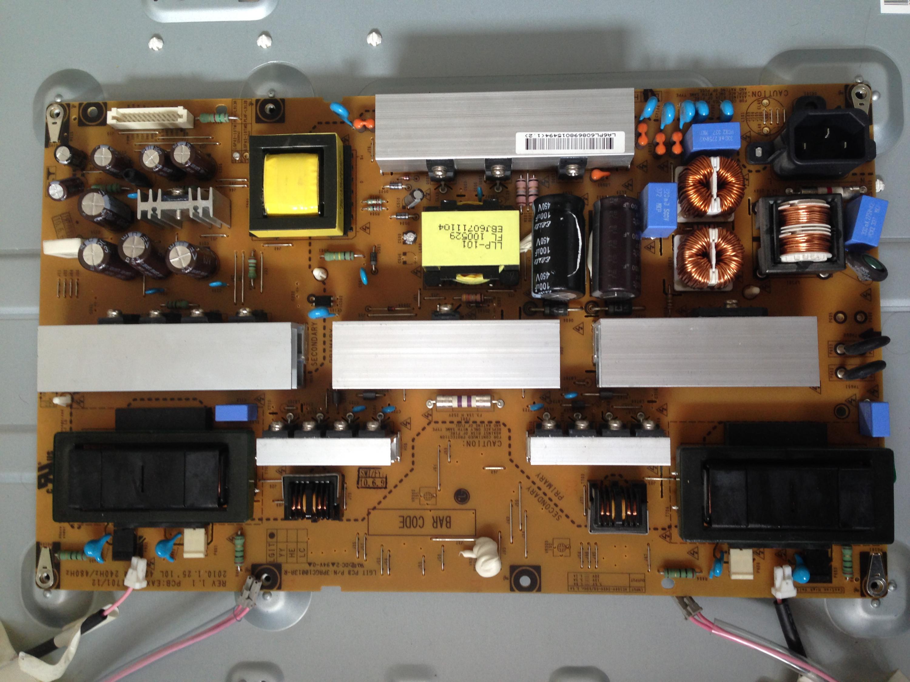

    Re: LG 42LD750 - only Lg logo thengoes black

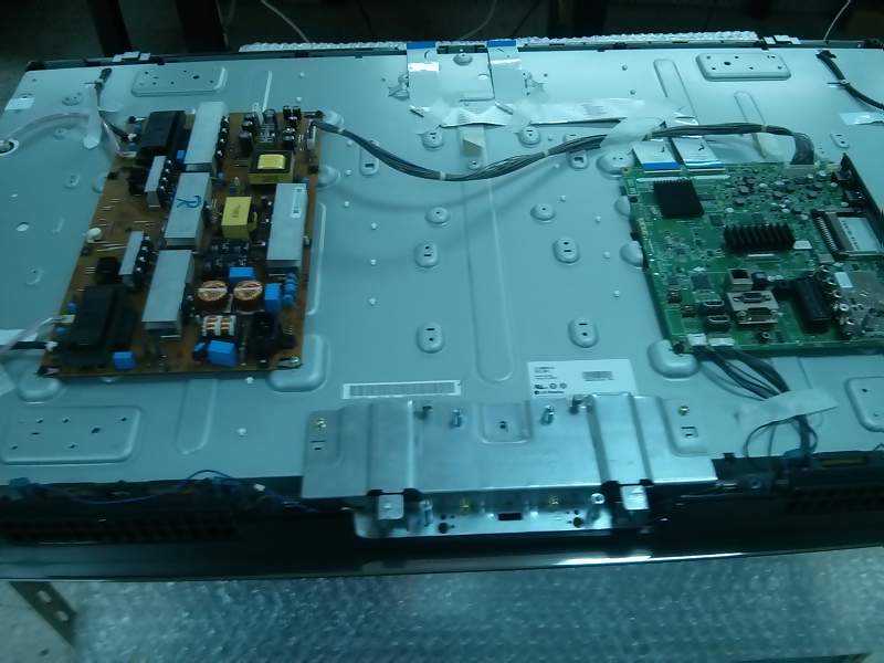

    First step is to post pictures of the inside. high quality ones.

        I will post photos later. There aren any blown caps, just replaced ones.

        • paulstef
          • Dec 2013
          • 724
          Here is a (pretty incomplete) service manual:http://elektrotanya.com/lg_42ld750-z.../download.html
          Found this pic on the net:
          It seems power supply and inverter are on the same board.
          There is a cable going from the PSU to the control/main board.
          I would first measure signals and voltages on this connector. There must be some kind of BL or STB SB or PWM or DIM signal and 5V, 12V or similar.
          Take a picture of that connector if a description is printed on the PCB near the connector.
          You need to find out if the mainboard commands the backlight off or if the problem is on the PSU board.
          Then we go from there.

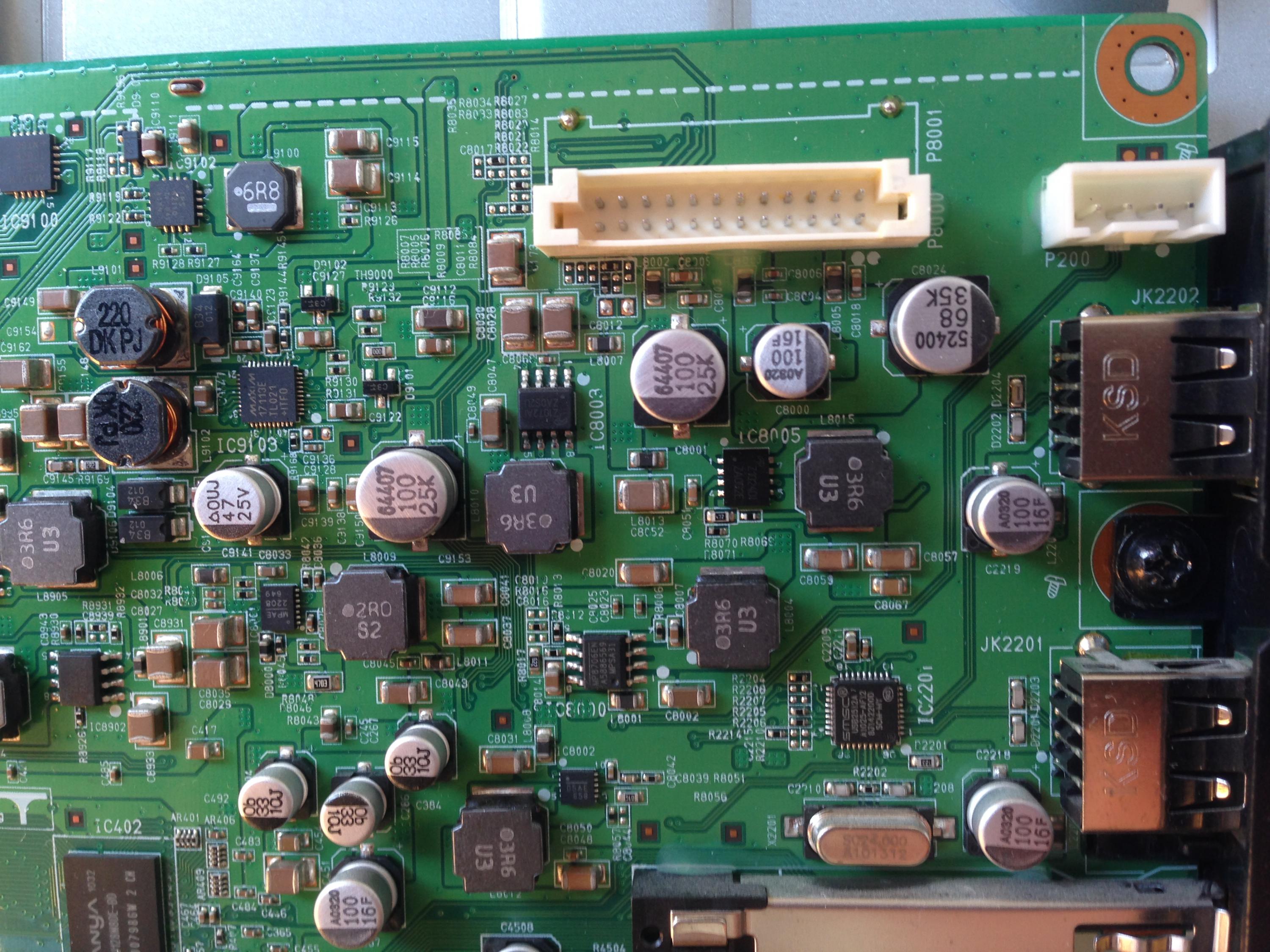

          • paulstef
            • Dec 2013
            • 724
            It seems to be P8000 (page 28 of the pdf) . Check INV_ON and PWR_ON and if you have a scope observe also DIM1, DIM2, A.DIM and also measure the voltages 24V, 3.5V, 12V.

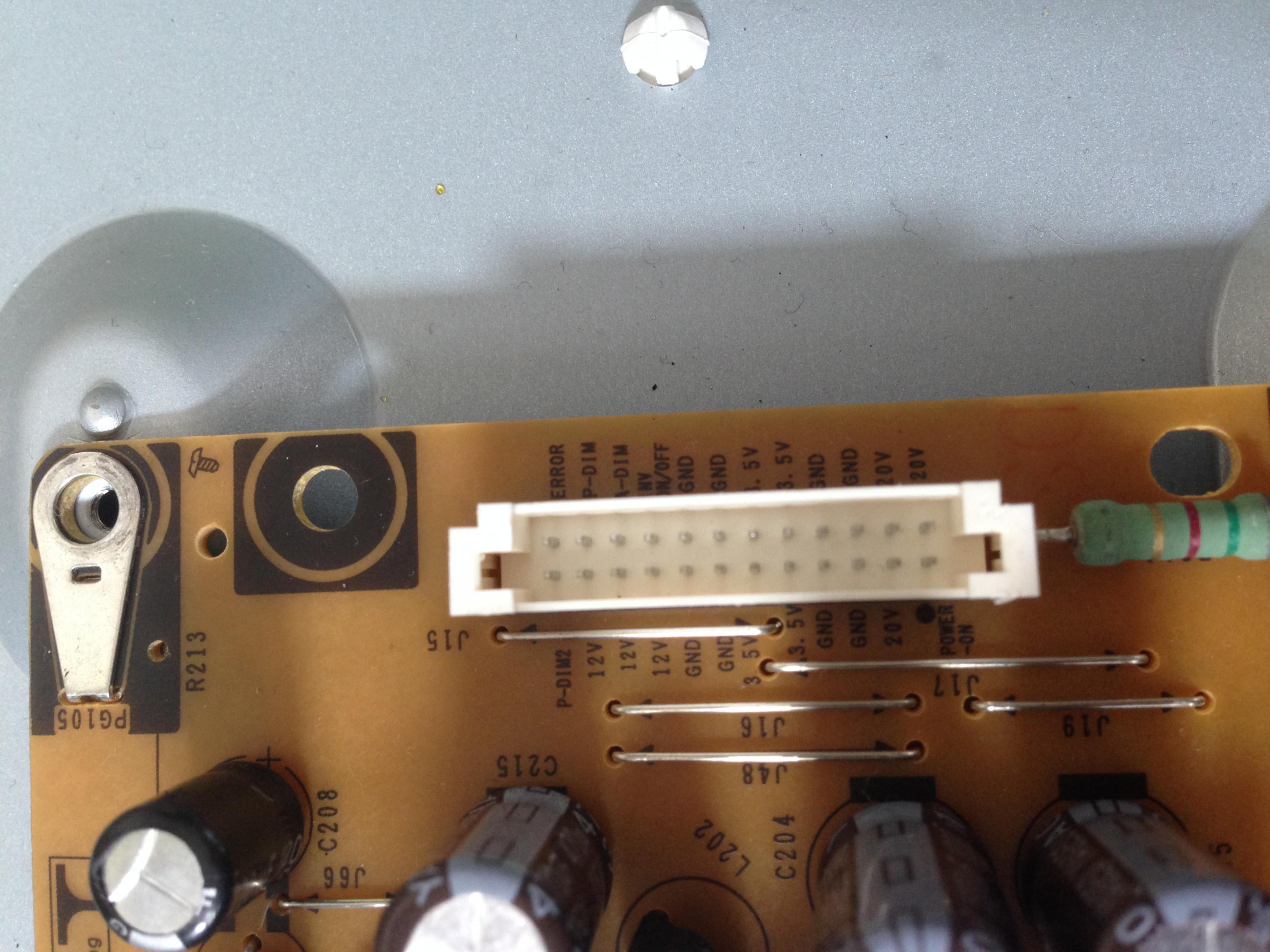

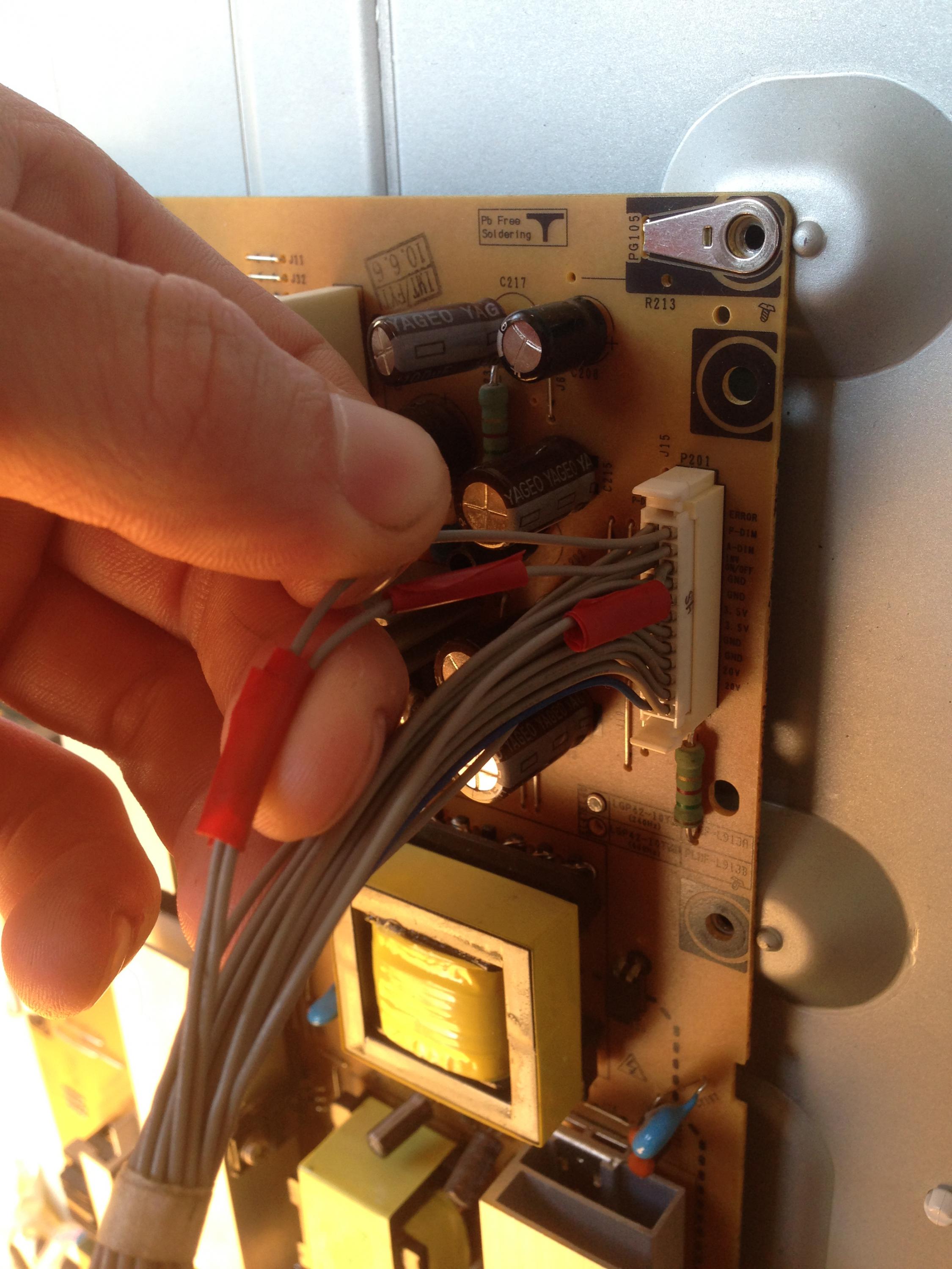

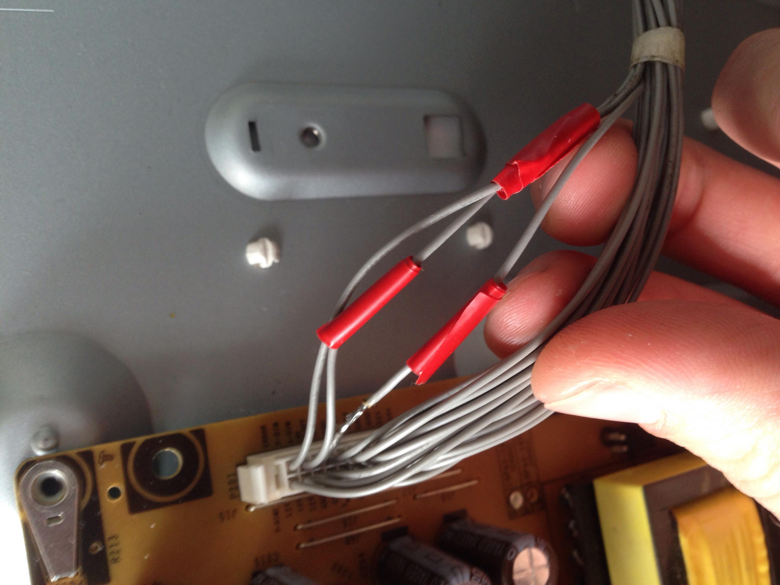

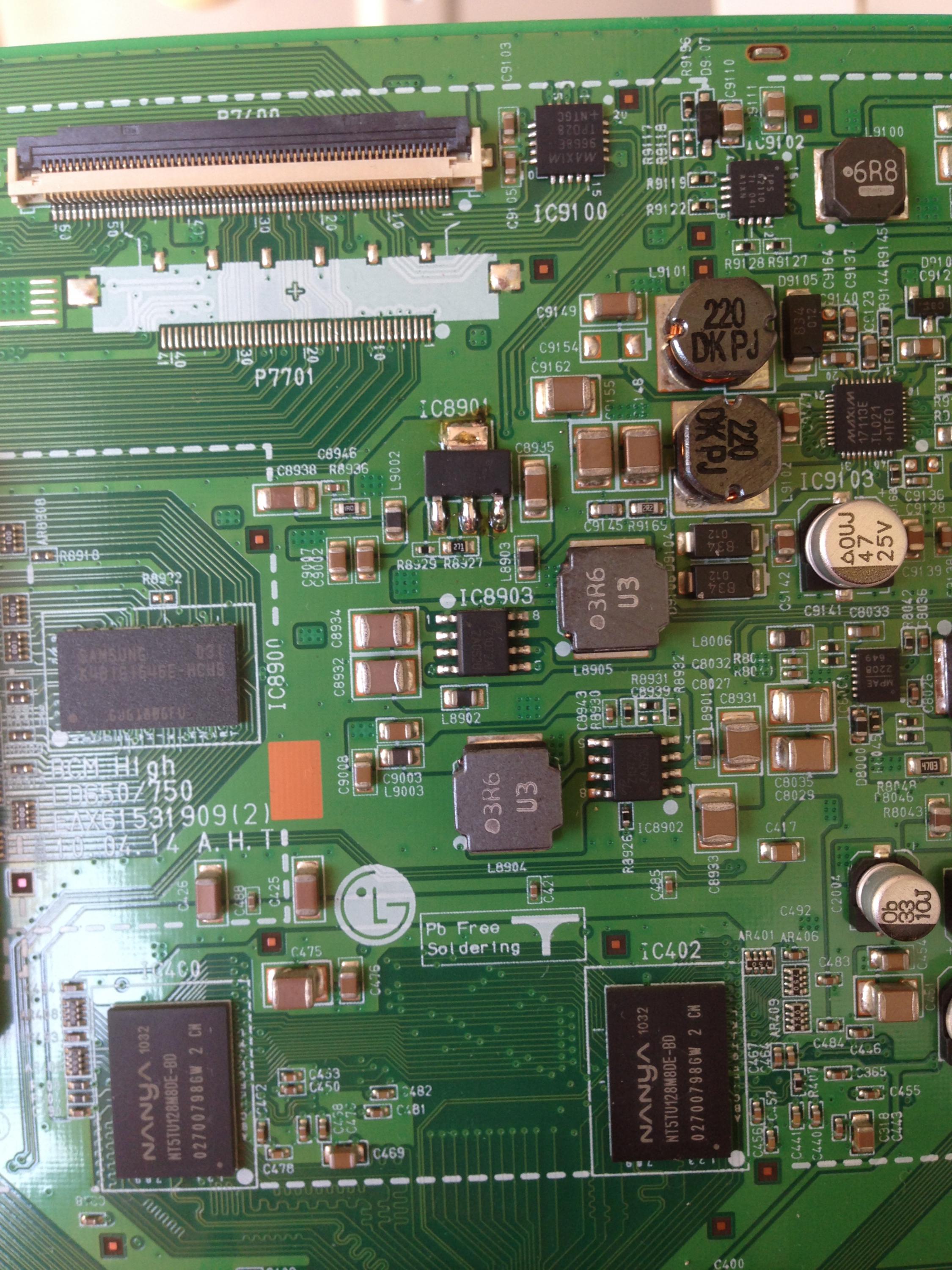

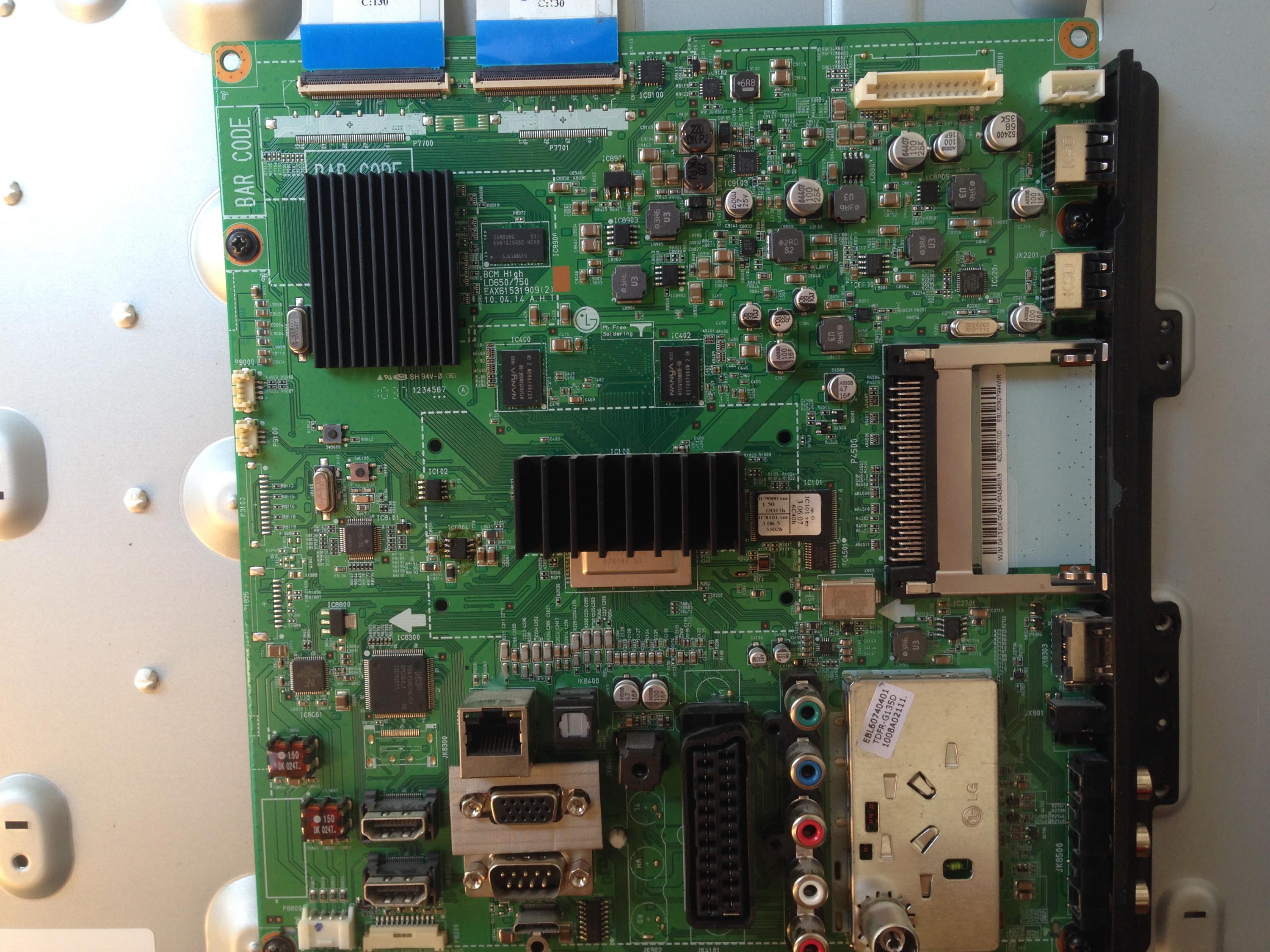

                Okey, here are the pics. What i must to measure now, to check where is the problem, i have basic skill from this, so i need a litlle help and i think taht together we cuold solve the problem
                • domix
                  • Jan 2014
                  • 168
                  • Slovenia

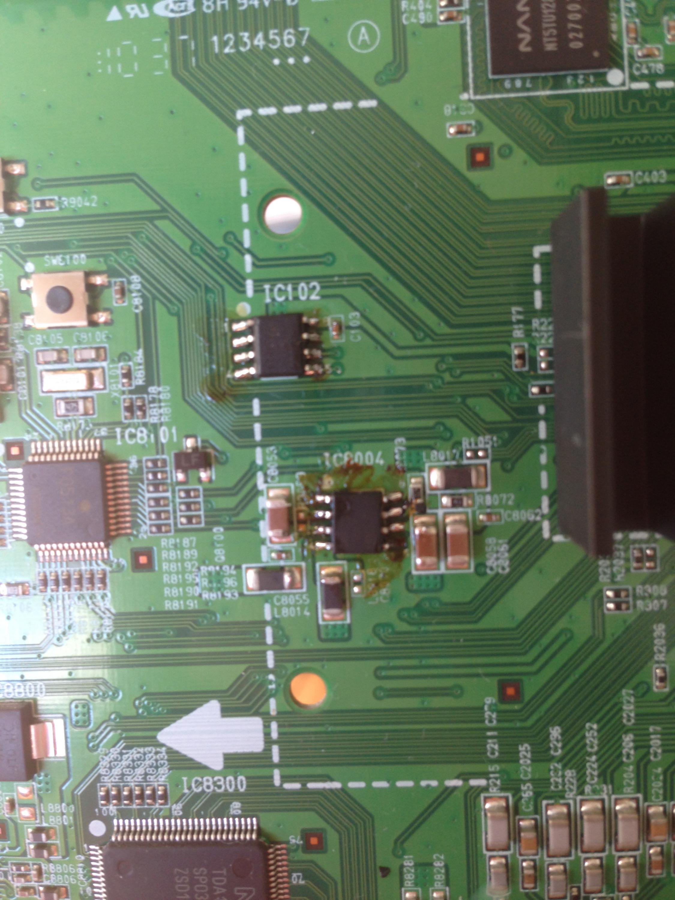

                  I see that someene, previus user did some solder work here, why i dont know?
                    The mainboard is faulty thats the reason it does not start.
                    You could try and see if you can find some cold solder joints or bake the mainboard in the oven @ 385 degrees for 9.5 minutes.
                    Problem is 100% mainboard!

                        if i turn it on and press menu button it show menu but for a second aor two then goes black as before, it it this faulty mainboard, if all functions wokrs but ther a bleck screen and no backlights
                        and previus user has tv on service and now i see that solder together ERROR and P-DIM look at pic before

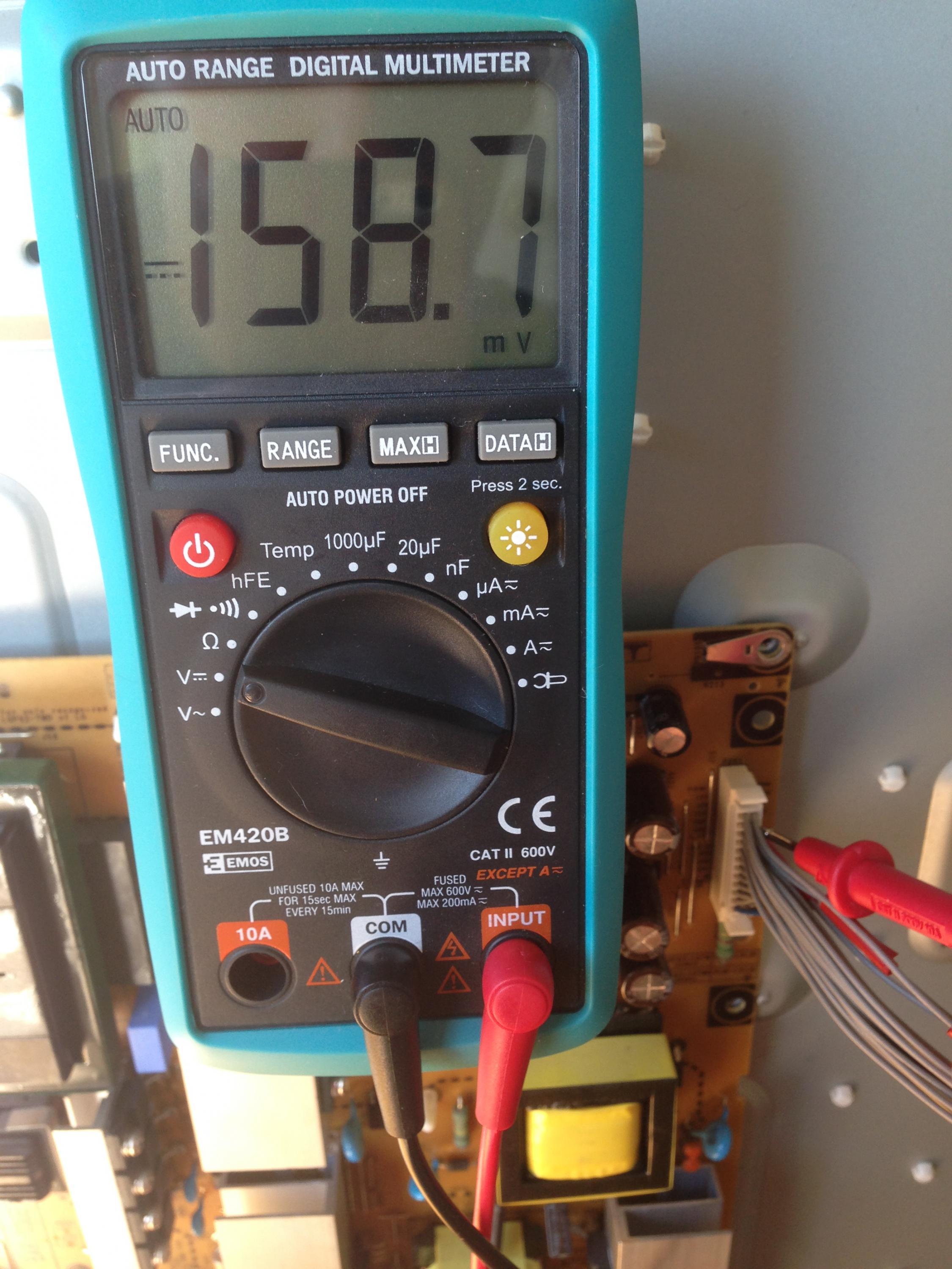

                        • domix
                          • Jan 2014
                          • 168
                          • Slovenia
                          INV_ON 3,34
                          PWR_ON 3,16V
                          A.DIM 1.69V
                          20V are all 20.7 - 20.8V
                          3.5V are 3.38V
                          12V are 12.34
                          P.DIM 159.8V
                          P.DIM2 159.9V

                            • domix
                              • Jan 2014
                              • 168
                              • Slovenia
                              when turn on and lg logo shows with backlight
                              Backlight....ON.......OFF
                              ......P.DIM..33.4V...152.2V
                              ......A.DIM..3.15V...1.68V it drops 1 second before backlight went off
                              INV.on/off..3.33V...3.33V
                              ..P. DIM2...33.4V...159V

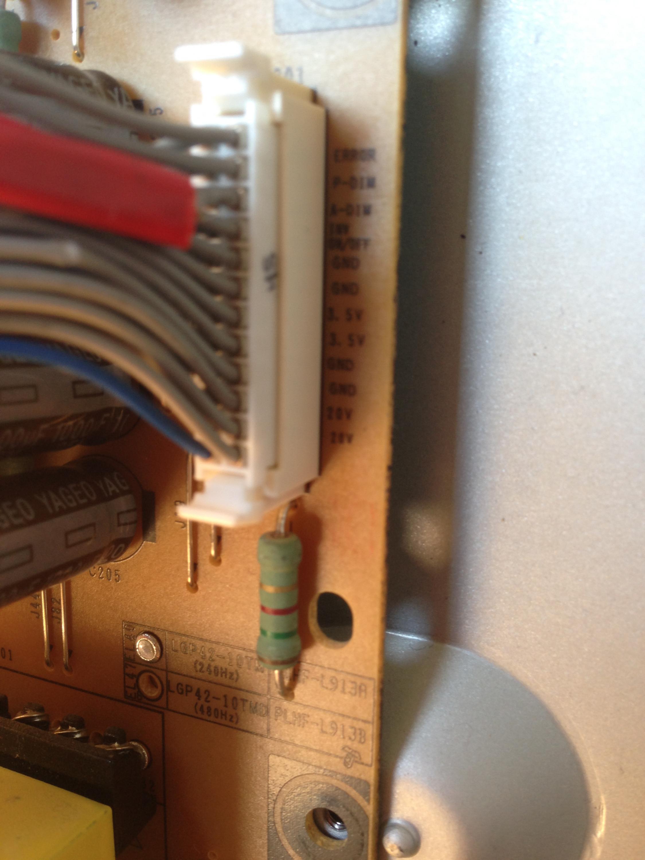

                                  To have 160V on this connector seems weird.
                                  Also if you look at the schematic, ERR_OUT (pin24 of the P8000 connector) goes via a 0 (?) Ohm resistor directly to ground? That can't be true if ERR_OUT and P_DIM1 are connected together and you measure 160V and P_DIM1.
                                  I think we need to find out first if this is the right schematic and which of these components are populated. Take a good picture of the top and bottom side of the area where this connector is on the mainboard.
                                    P.DIM is almost 160 yes. look at pictures

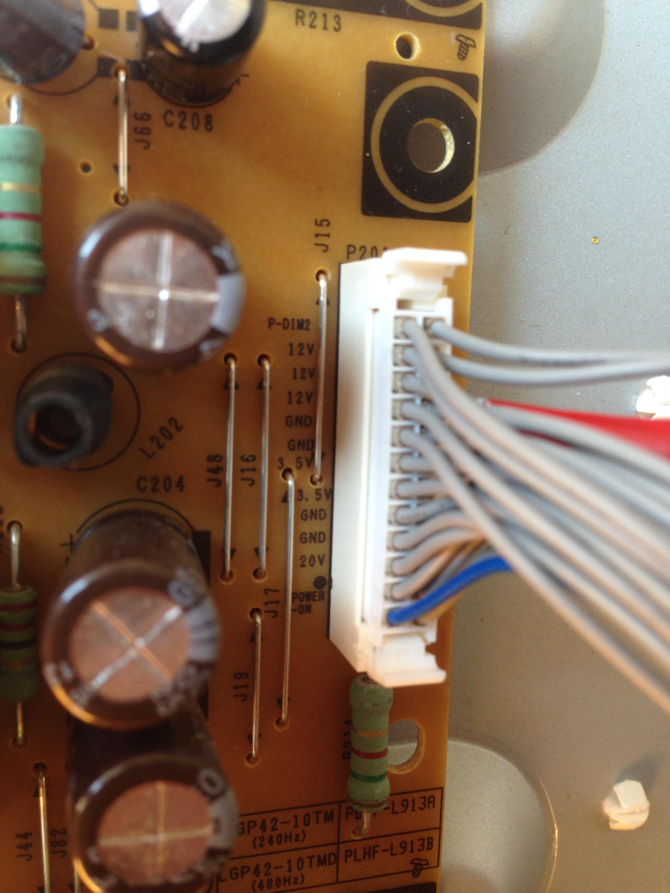

                                      • 724

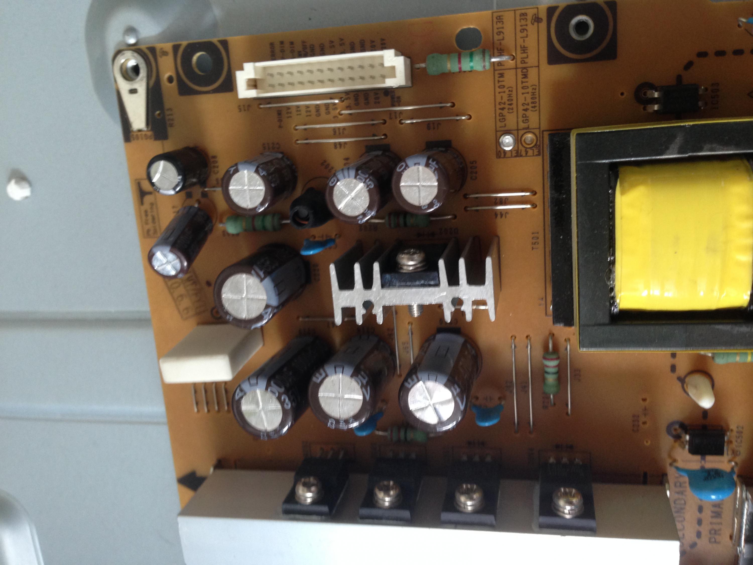

                                      Pics of TOP and BOTTOM of the other board near the connector P8000 please.
                                      And you didn't post the voltages for PWR_ON with backlight on / off.
                                      • domix
                                        • Jan 2014
                                        • 168
                                        • Slovenia

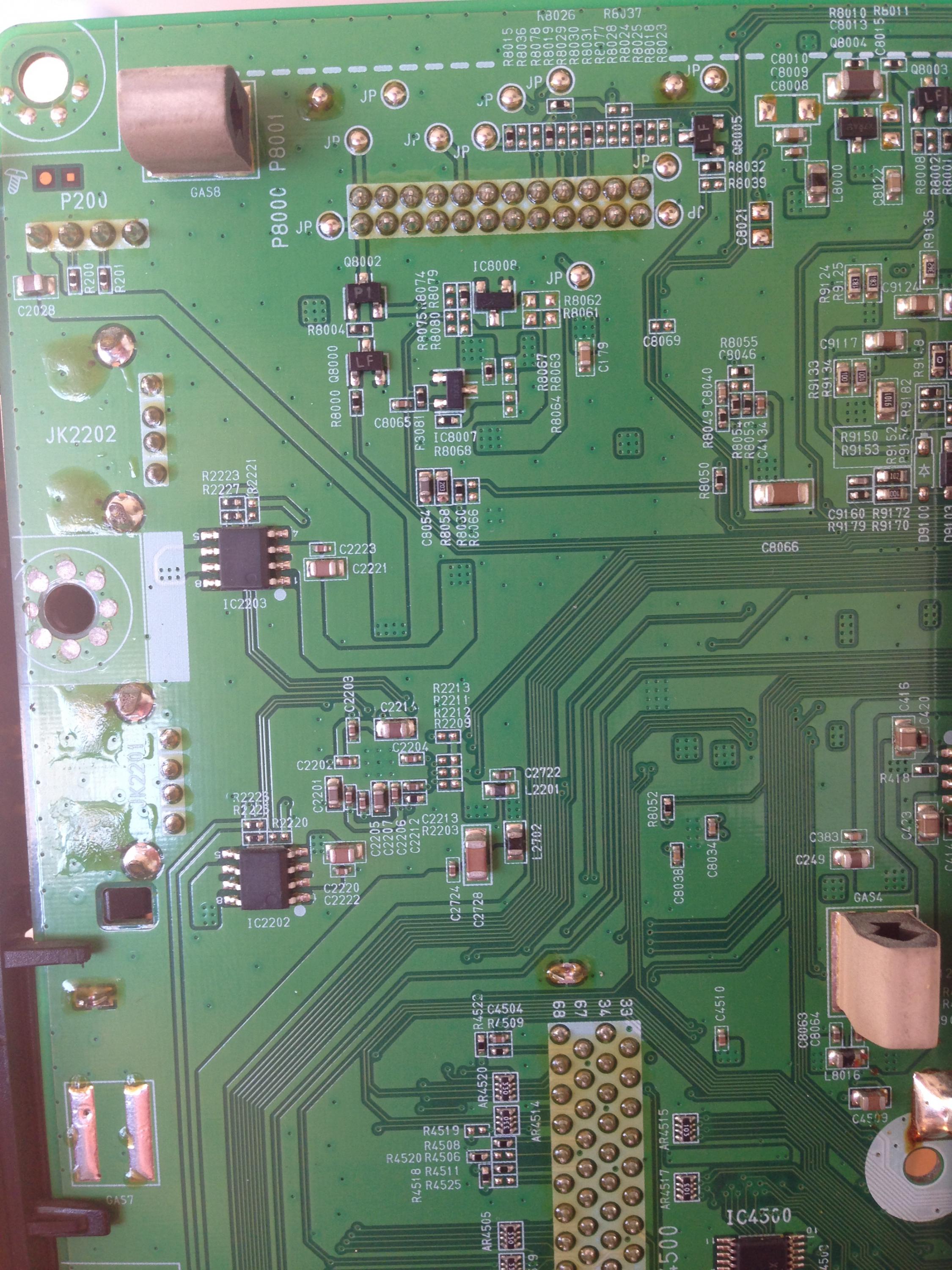

                                        here they are. i found something on this moss on pic, they were replaced or ?
                                        PWR_ON is 3.16V with and without backlight
