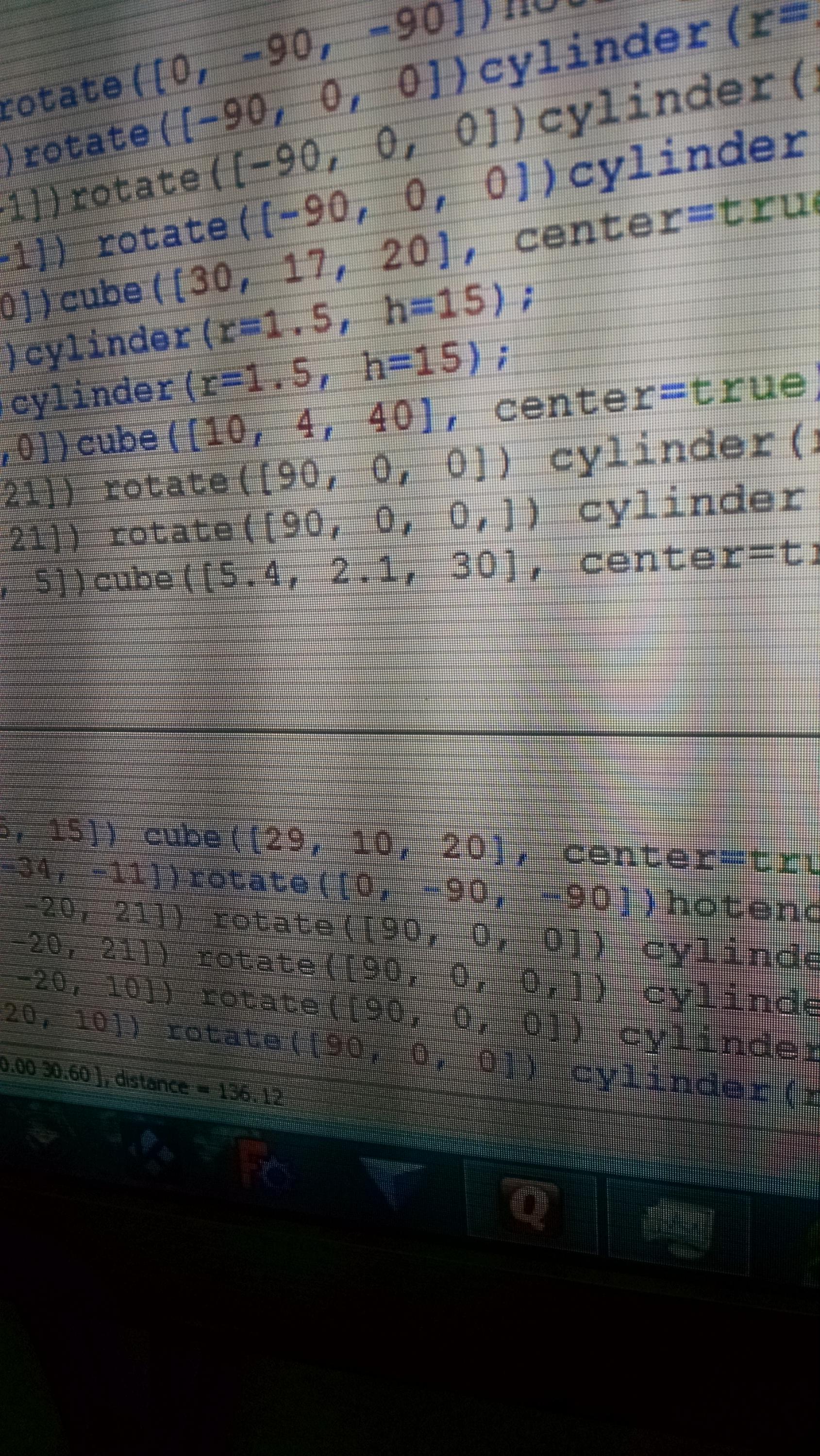

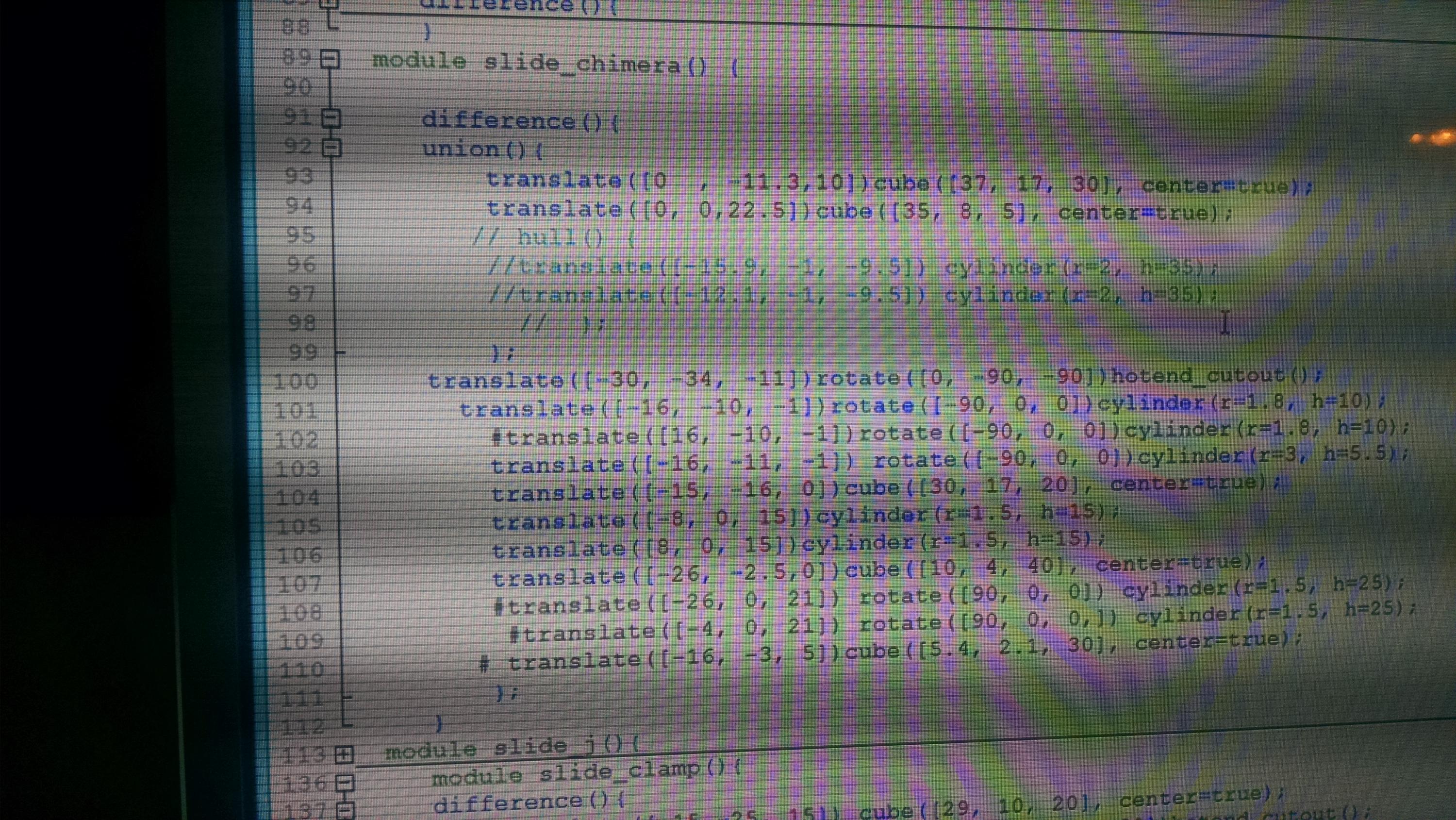

    Hello all, having some issues with my LG 47G2-UG Google TV. I have persistant horizontal lines that seem to "fade" from left to right. Basically seems to be from left side to about middle of screen but maybe more in the 2/3's range, far right is clear as day. Theese lines are evenly spaced from top to bottom at about I am guessing few mm or maybe 10px. The are probably only 1 px thick. Based on what I have read in other threads this will either be a T con or a panel issue. Is there any tests I can perform to confirm one or the other? Really don't want to order a t con just guessing Thanks in advance

      Most likely bad panel... Give is a pic of just the screen showing the fault

        Re: LG 47G2-UG Horizontal Lines
        Hope these help, sorry for my haste and not helping you, help me. I have a video uploading to YouTube at the moment I will attach a link once it's processed. Thanks again
            Sorry but to me that looks like a panel fault, No doubt someone will concur
              I concur...
              Most likely the panel is bad.
                That's what I was afraid of but better knowing then throwing 50 bucks down the drain
