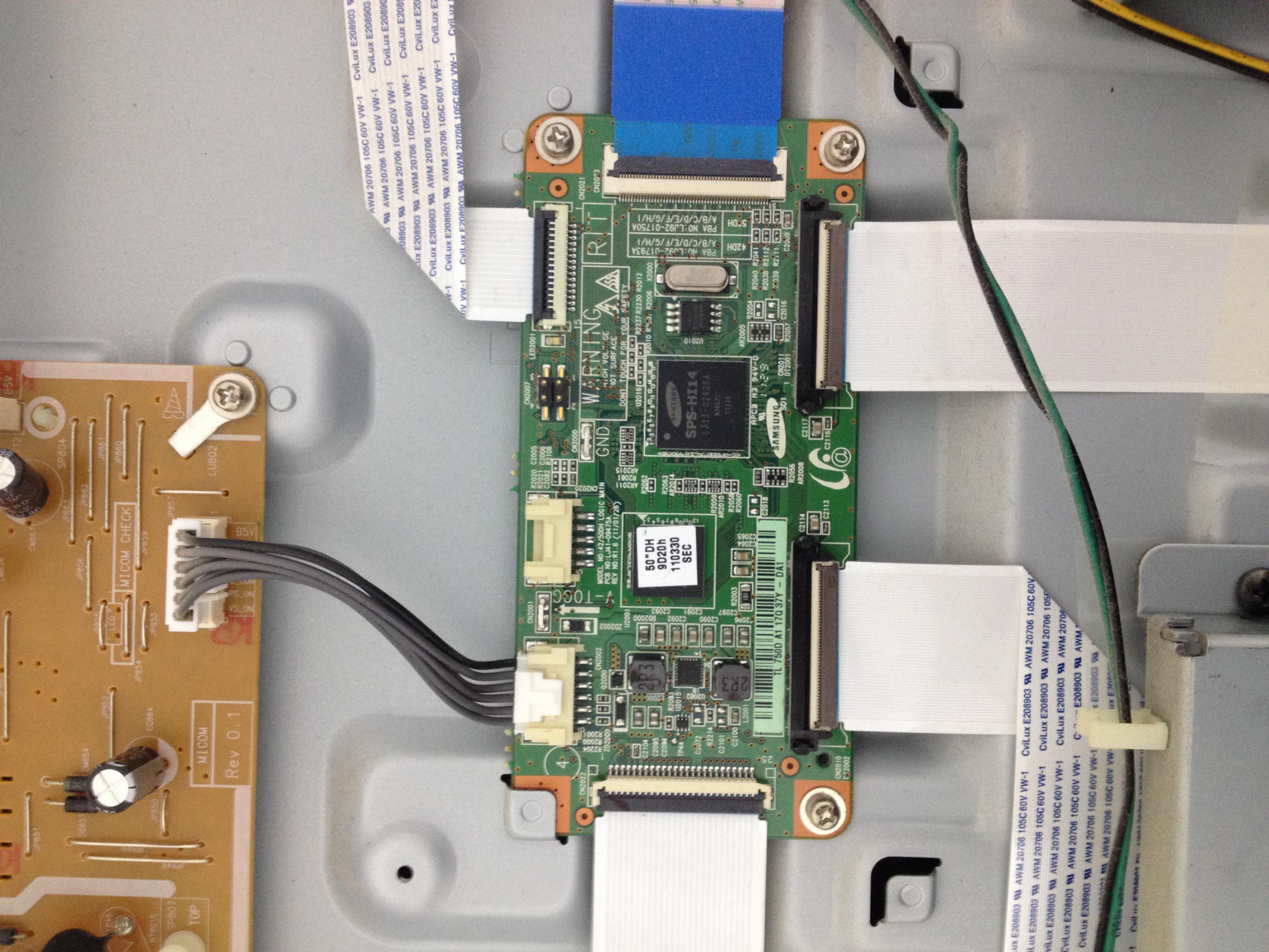

    Opened up it and i can see that i have a green light on on the tcon board.
    (The light on the Tcon board randomly turns on and off)
    and i can hear small ticking as there is a load or a short to the psu.

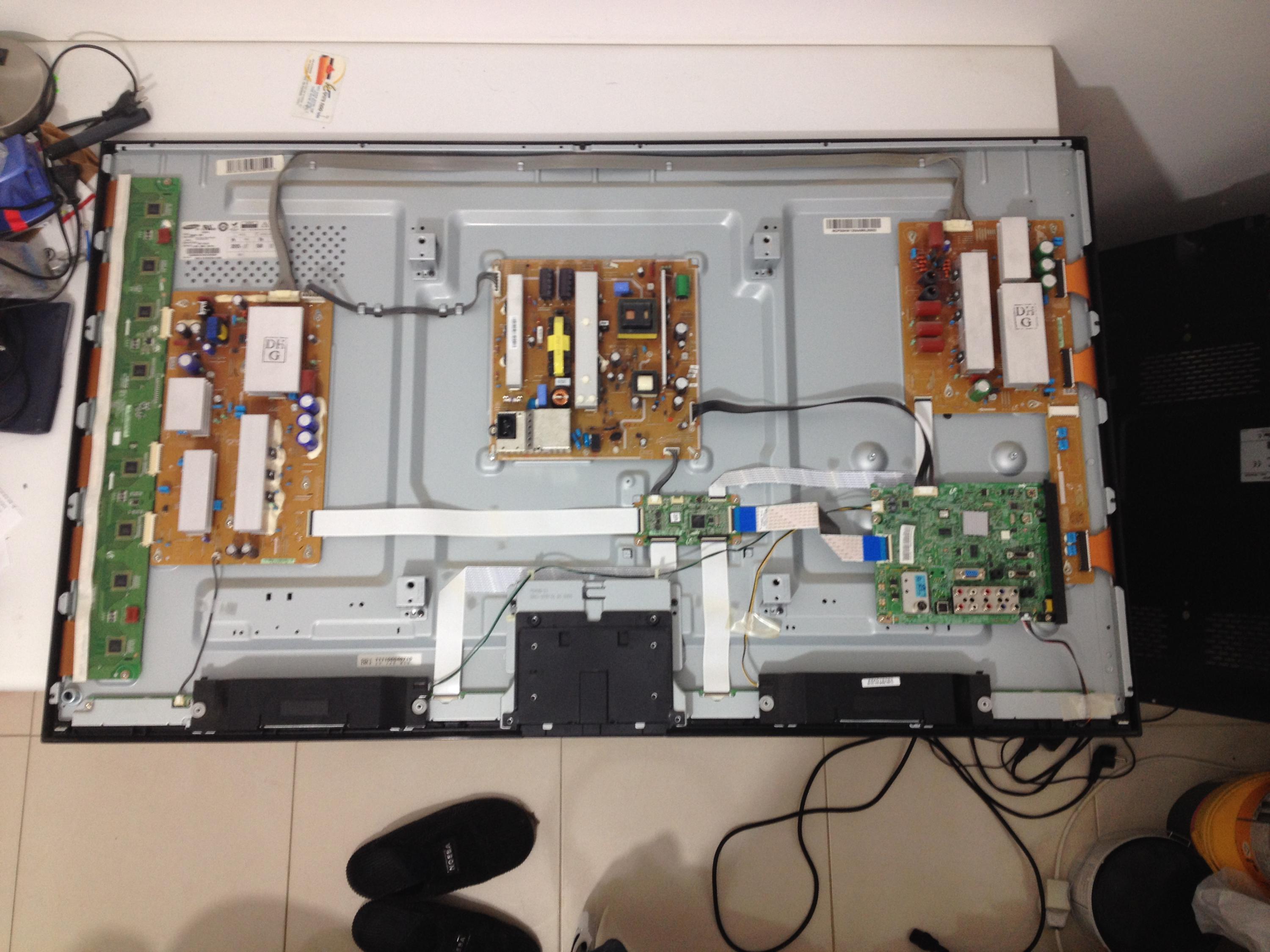

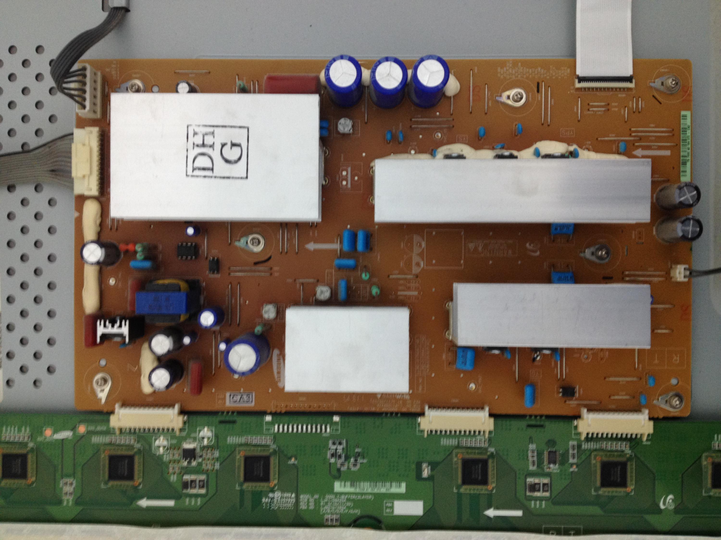

    Visual inspection showed heating signs on 2 boards (not the psu, main, tcon, buffer board) im sorry but i don't know their technical names (YSUS VSUS maybe).
    I searched the forum and found Tom66 post, (he had a bad mainboard)
    Some testing tips on plasma would be great,

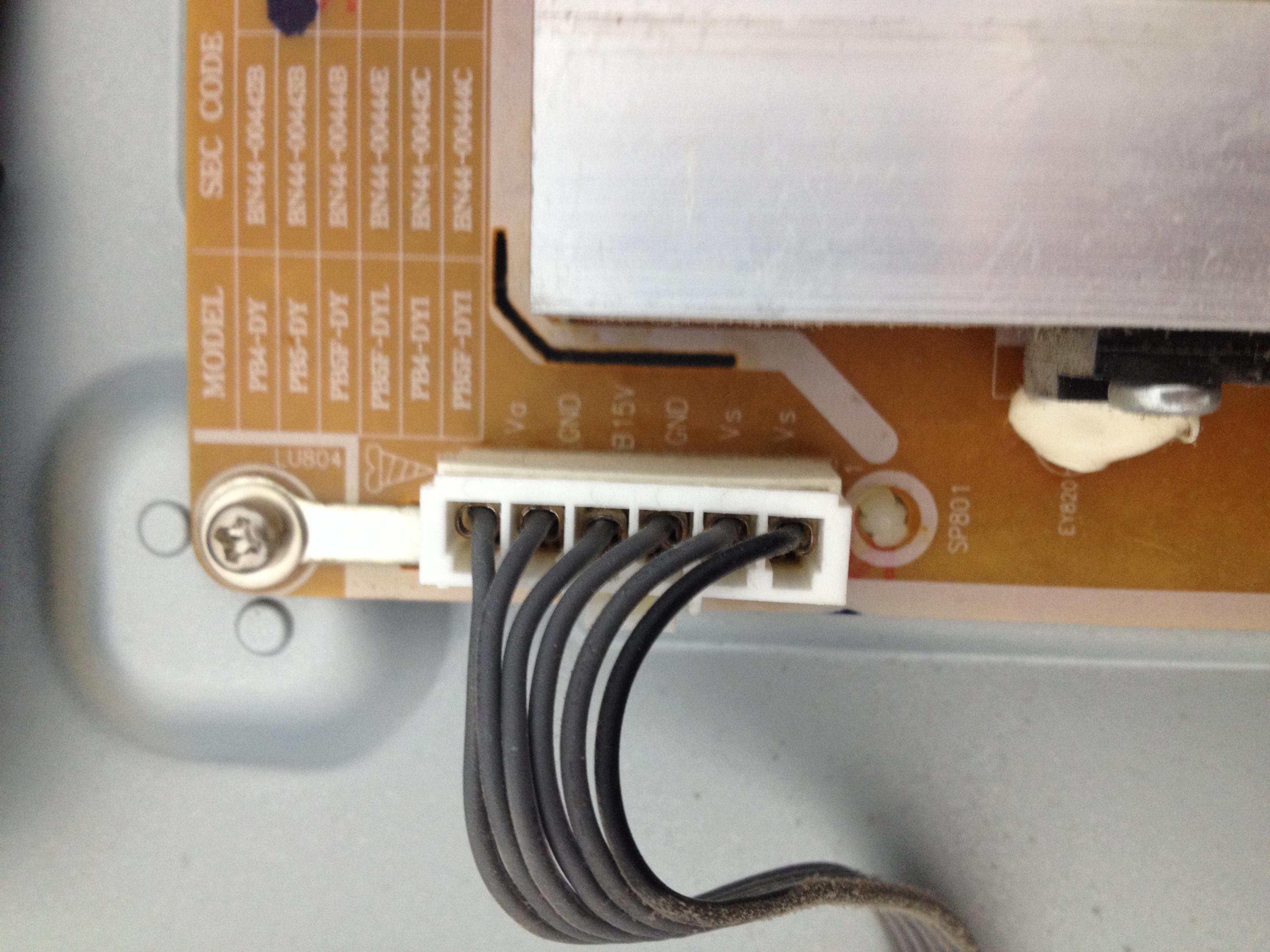

    PSU Board :BN44-00443B
    Main Board: BN94-04644A

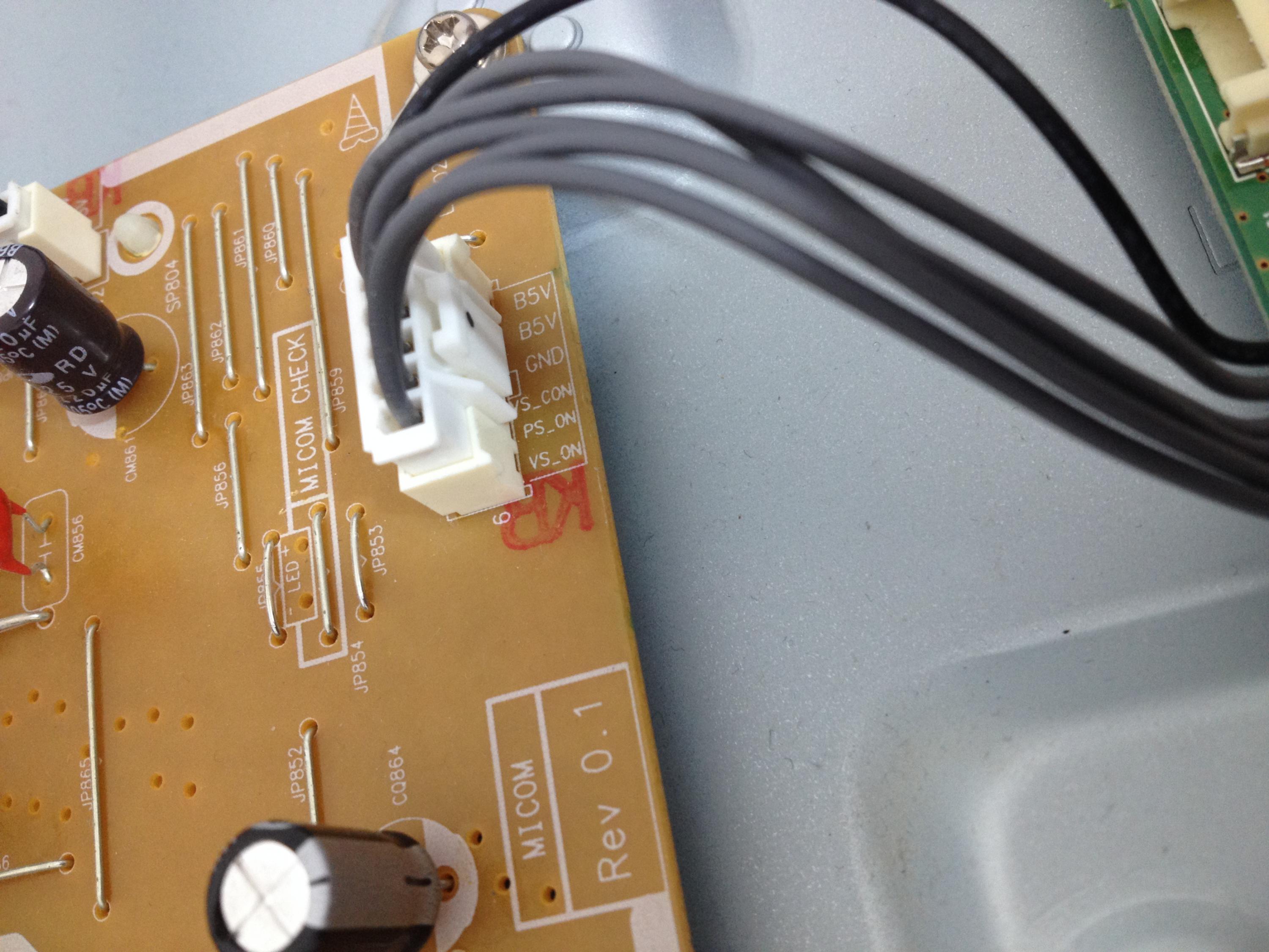

    I have 5.21v Stby voltage, and 395vdc on 2 main filter caps.
    I don't know how to force start a plasma psu, is it the same as in LCD?
    Use a 1k resistor from 5v to pson with nothing connected to psu but the ac?

      Control board LED should flash in operation about once every 1-2 seconds. If fault is detected, it will be 5-7 seconds.

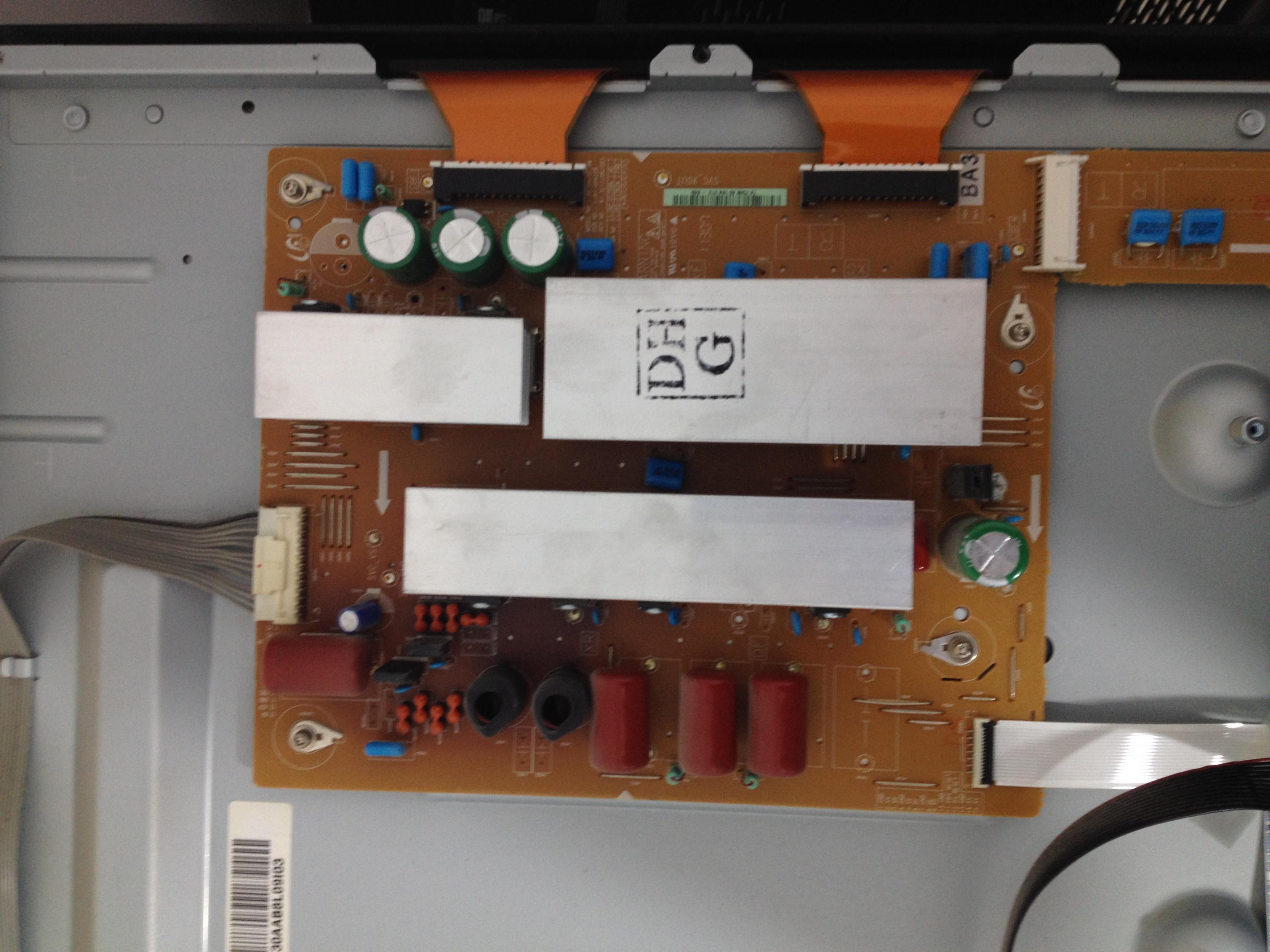

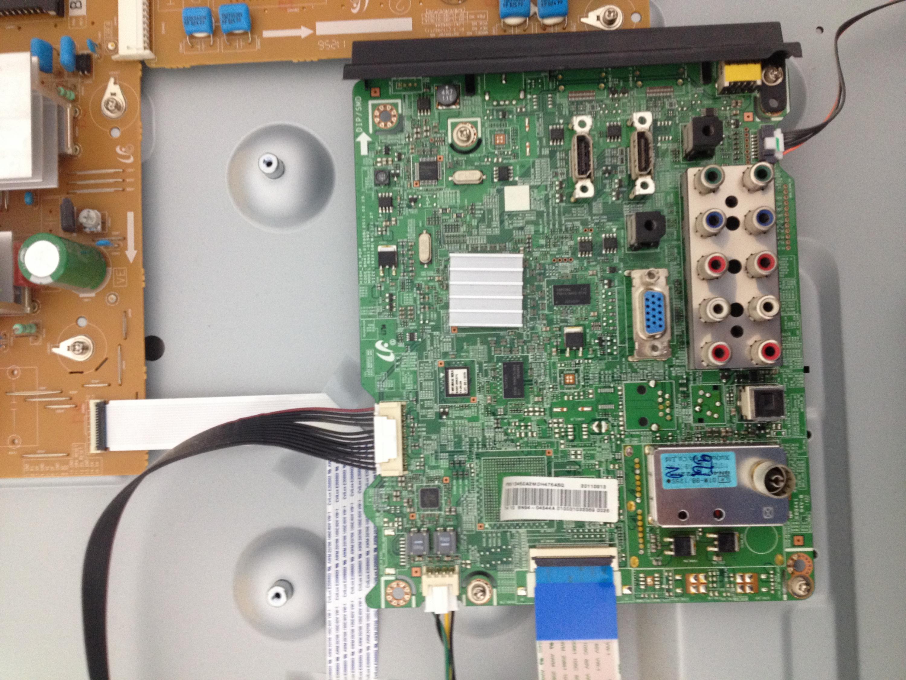

      Boards from 3rd image: X-main, Y-main, control/T-con/logic, main AV board
      These sets can be easily upgraded to the 3D model, although the 3D performance in my case was lacklustre (but I've never seen a 3D TV I liked to be honest.)

            on your power board try testing your VA/VS voltages to see if you have any readings it should match up with your panel sticker
              Samsung sets use PS_ON low, so you want to use 1k from PS ON to GND.
              Then if lower voltages come up, jumper VS ON to 5V and check Vs/Va (200V and 60V each, approximately, exact values on panel sticker)

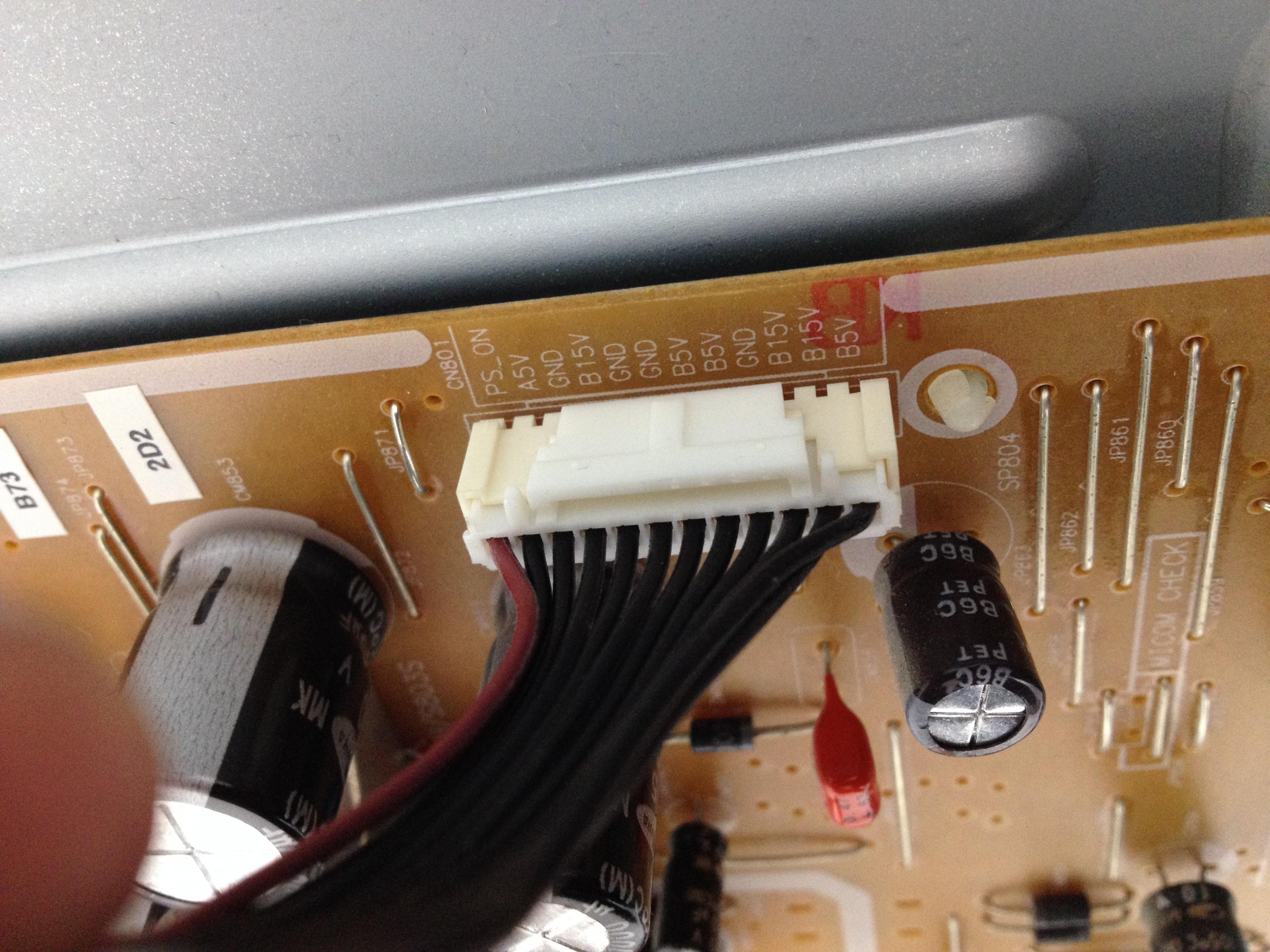

                  So,
                  I disconnected the cable from the psu to the AV board from the AV board side,
                  plugged a 1k resistor between pin 1 PS_ON to pin 3 GND.
                  It didn't start.
                  But if i jumpered it without the resistor the psu started and i could hear the high voltage whining as i have a short or load.
                  Is it safe to start it without the resistor,
                  if i understand correctly, the resistor acts as a voltage divider or a current limiter?
                  should i disconnect the cable from the psu to the tcon? ( i left it connected)
                    Re: Samsung 51" Plasma PS51D450A2M
                    1k might be too high. I use 100 ohm. I recommend using a resistor in case the power board does not have a resistance built in. Most of these sets do... but it's better to be safe rather than sorry...
                    You will need to check the B5V, etc to see if they work rather than just listening to whining sound, whining could mean anything.
