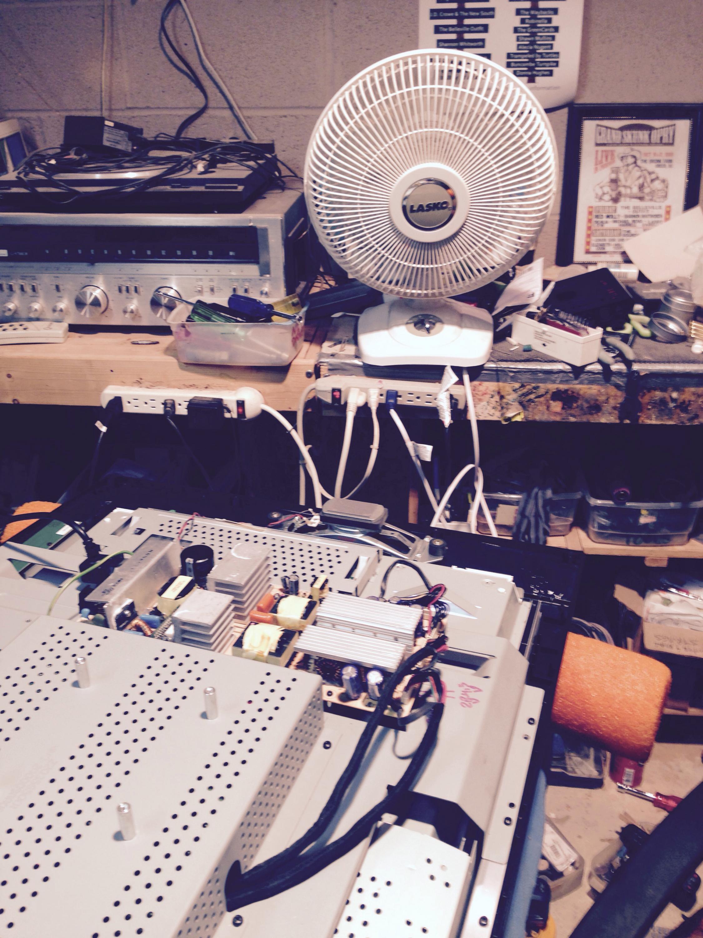

                Re: Olevia 237-S11 controls locking up losing sound etc etc
                Just put fan on it to cool down power supply. Still playing. It was getting hot.
                • Taterbug
                  • Dec 2013
                  • 114
                  If that's the problem I've got to figure out how to cool it down or figure out what's causing the over heating problem.
                    So its running for longer under cooling?
                    So should fail quicker under heat, Use a hairdryer to narrow down the area that is failing.

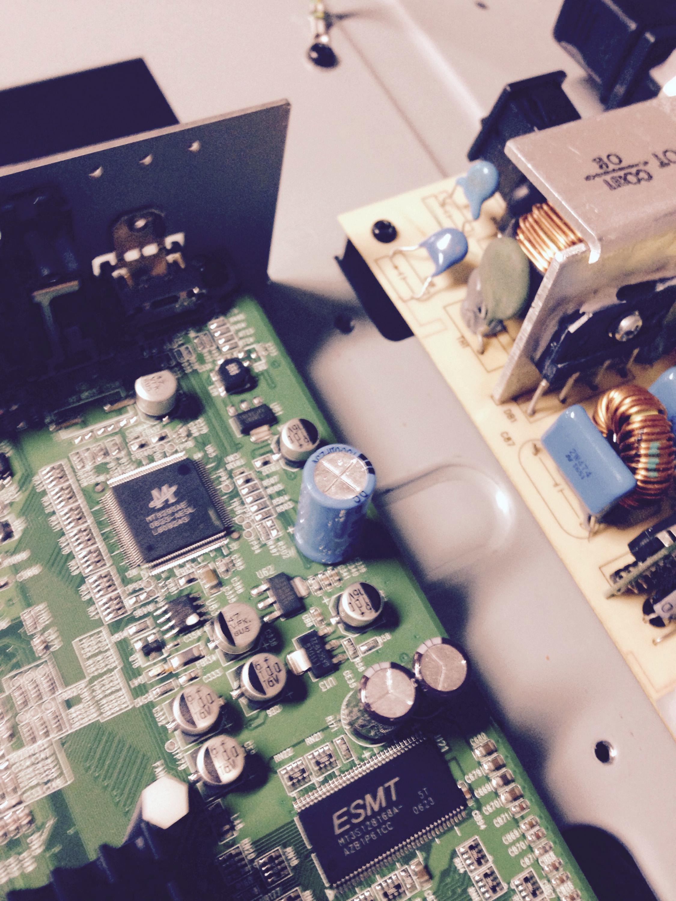

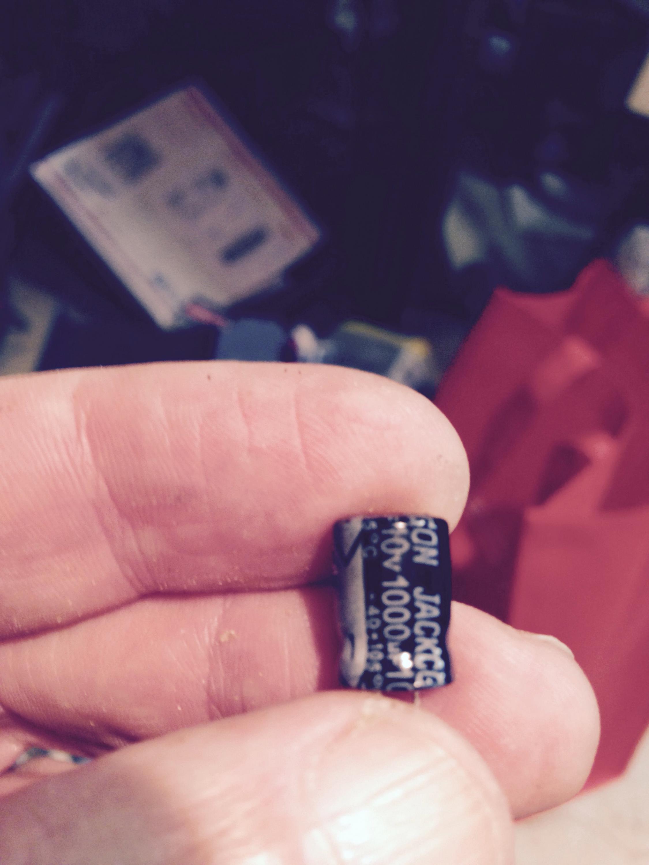

                        Finally Fixed it !!! It was a bad cap on main board. 1000 mfd 35 volt. Jackson. ( see photos for location I replaced it with the big blue cap.
                          Here is what I replaced it with and location on board
                            Is the top bulged on that cap?
                            • Taterbug
                              • Dec 2013
                              • 114
                              No , it was a nightmare to fix. I replaced EVERY cap in the power supply. It kept acting like a cap problem so I went for that one since it was tied to the microprocessor.
