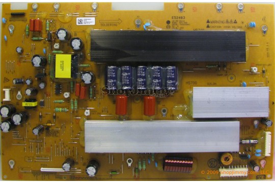

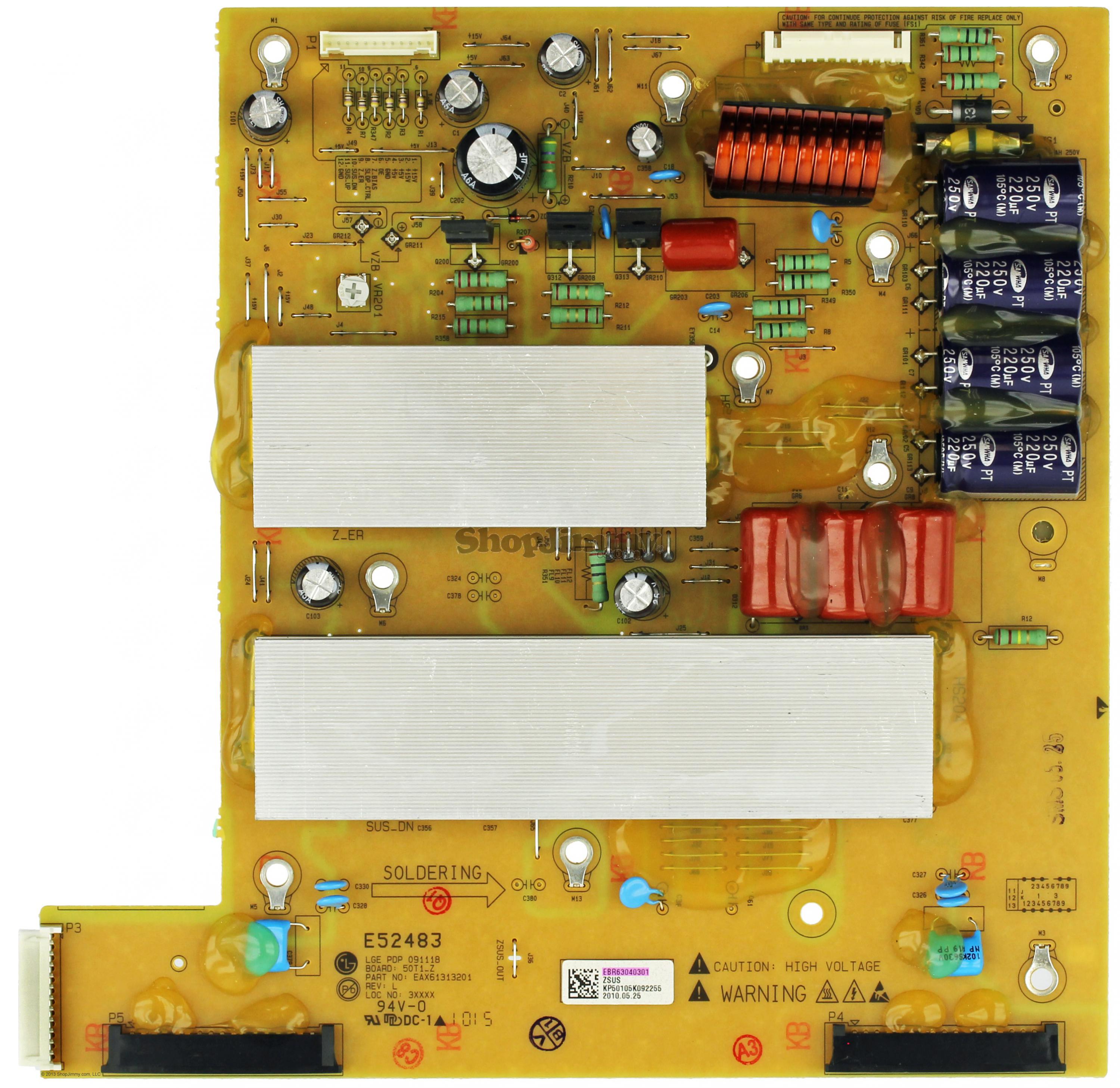

    Hi all, I am wondering if anyone can help me with a problem? A customer brought in an LG Tv 50PJ550 for repair, after inspection of the TV I realized that the TV had been worked on by someone else and found that a few FETS are missing from the Ysustain and Zsustain boards. Can anyone help me identify the part numbers?
    Ysustain: EBR63039802
    Part Locations: Q02,Q03,Q22,Q24
    Zsustain:EBR63040301
    Part Locations: Q21,Q22,Q23,Q24
    If anyone can tell me the part numbers, that would be awesome! Thanks in advance.

          Well--The 42" version (Which looks Very similar to the one pictured) uses 30J124 and 30F124 for the 'SUS_Up and SUS_Dn' IGBTS (That always seem to fail in this series)--Although I cant remember which is which offhand and haven't any data/diagrams.....
          I expect that the 50" uses much the same--but with an additional one in parallel, so three for each function (There's a place on the 42" version for the additional IGBT)....
          Dunno what ones your schematic ref numbers refer to though.....

            They will be 51N25, 30F124 and RJP63F3
            Also worth checking all the RD2003 diodes. Replacing both ceramic caps located on the ysus. Think they are 102j

                      HI ALL, DOES ANYONE HAVE THIS YSUSTAIN BOARD(EBR63039802)ON HAND OR KNOW THE THE ORIENTATION OF THE COMPONENTS Q02,Q03,Q22,Q24?
                      I KNOW THE PART NUMBERS (51N25, 30F124 and RJP63F3) BUT I DO NOT KNOW WHAT ORDER THEY GO IN. ANY HELP WOULD BE MUCH APPRECIATED. THANK YOU!!!

                        Q22,24 = RJP63f3
                        Q26,28 = FDPF51n25
                        Q02,03 = 30f124

                            Thank you for your help, I would like to know if anyone has the information of q21 because they already said of q22 and q 24, I hope you can help me
