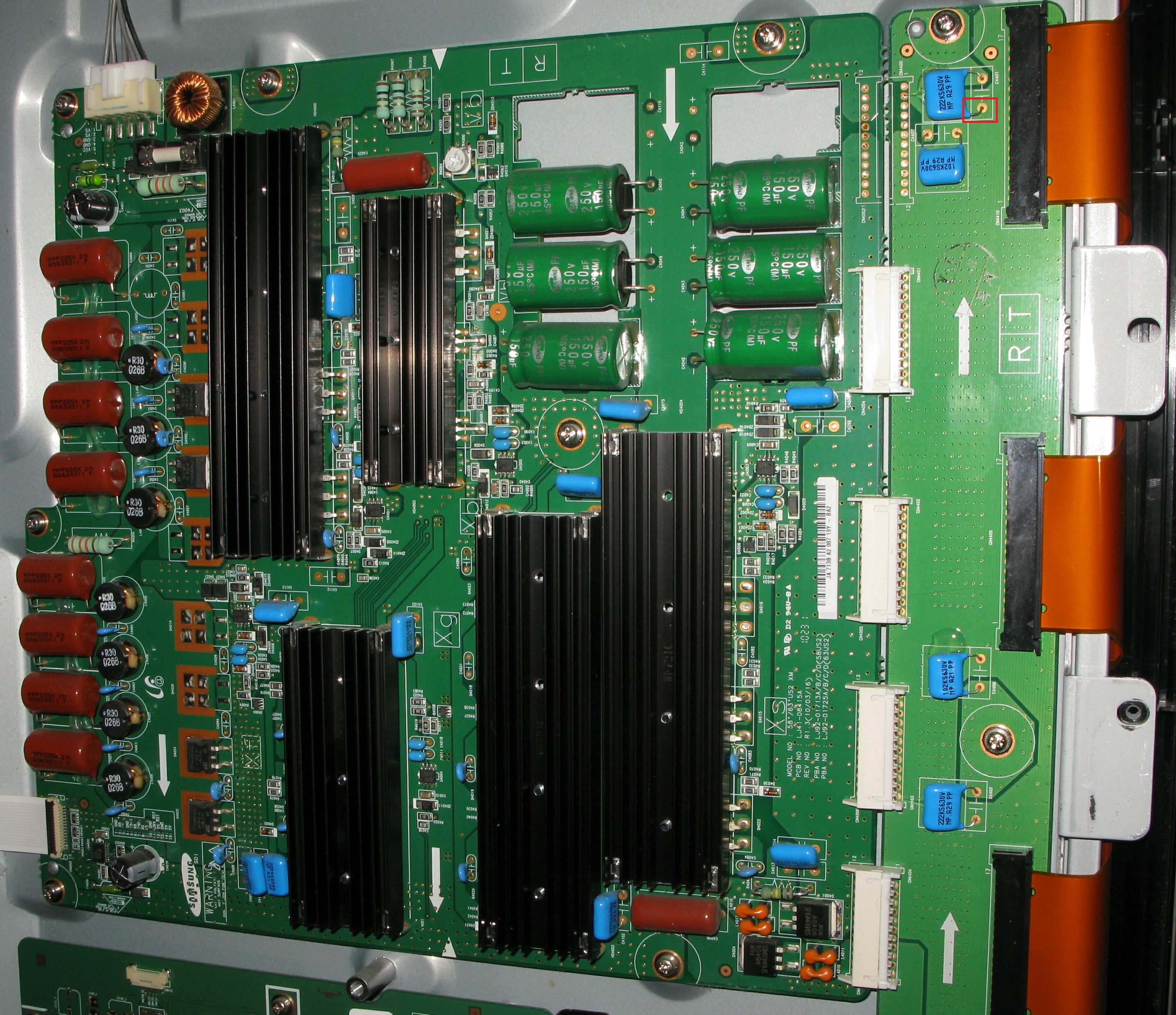

Samsung PS58C7000YFXXY - Sound but no picture
    Re: Samsung PS58C7000YFXXY - Sound but no picture
    I have highlighted the probe point here.
      OK - I hooked up the CRO as indicated and this is the result...
      50v/div @ I think .5ms/div
      You can see the reading jump to about 15v when the TV is turned on, then a small burst of activity.
      http://youtu.be/WIb9l8gVRuY
        Both waveforms look good. It's hard to see if there's anything obviously wrong because the pulse is so brief, so it could be a case of the control board shutting the set down.
        Is there any way you could borrow a digital scope so you can capture the waveform and look at it more closely?
          I'll see what I can do about a digital scope although it might take a week or so. Stay tuned
